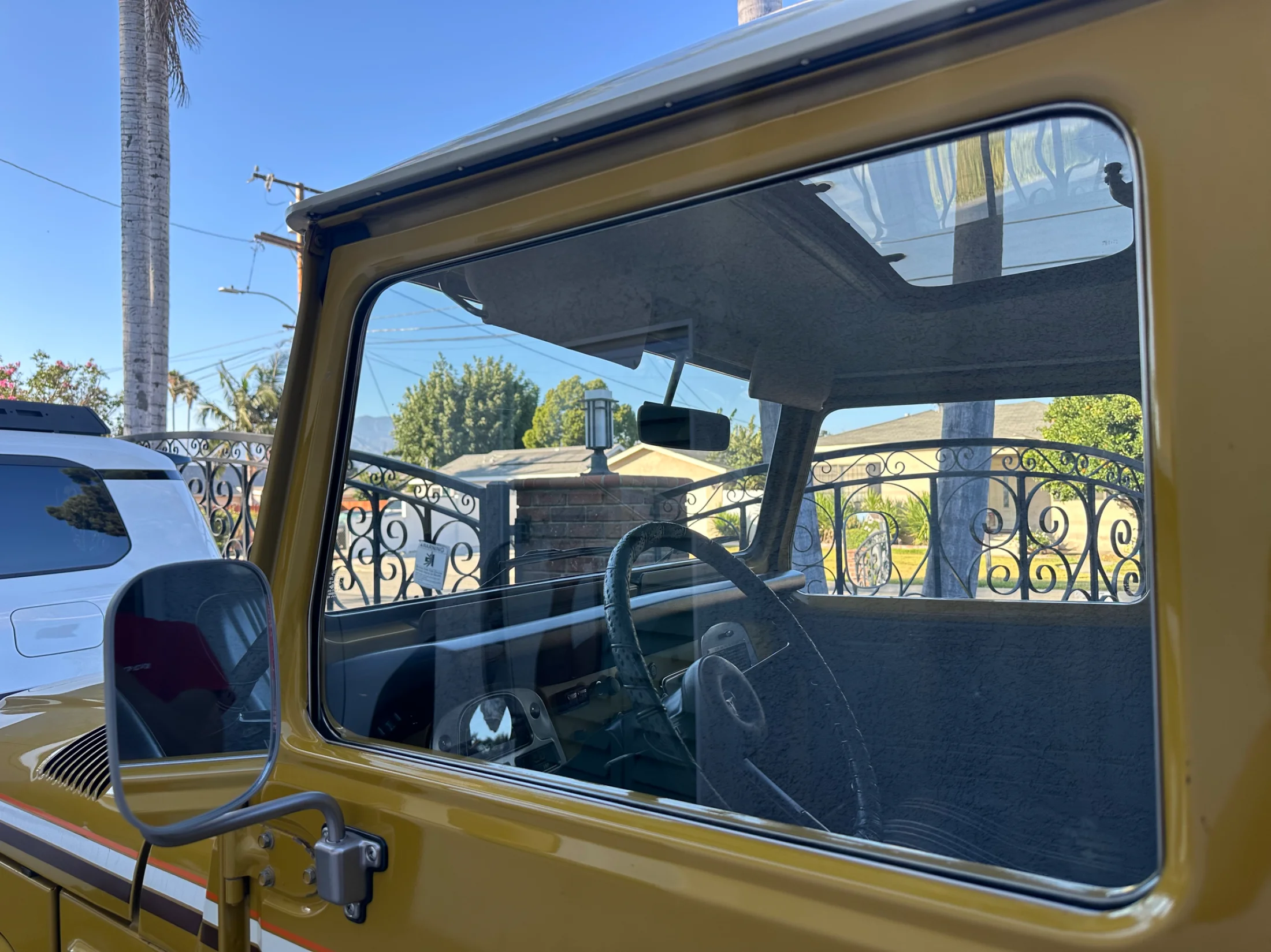

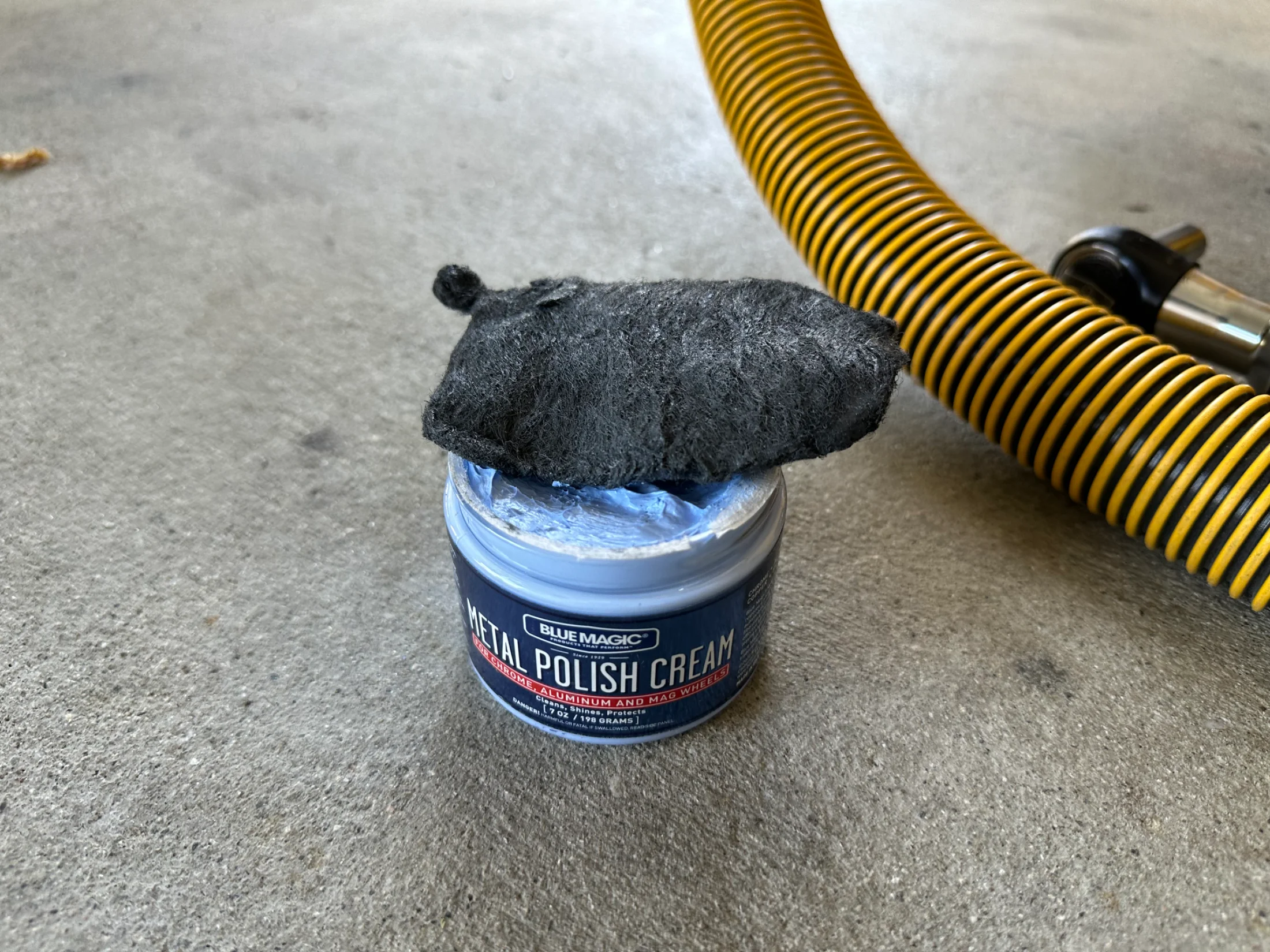

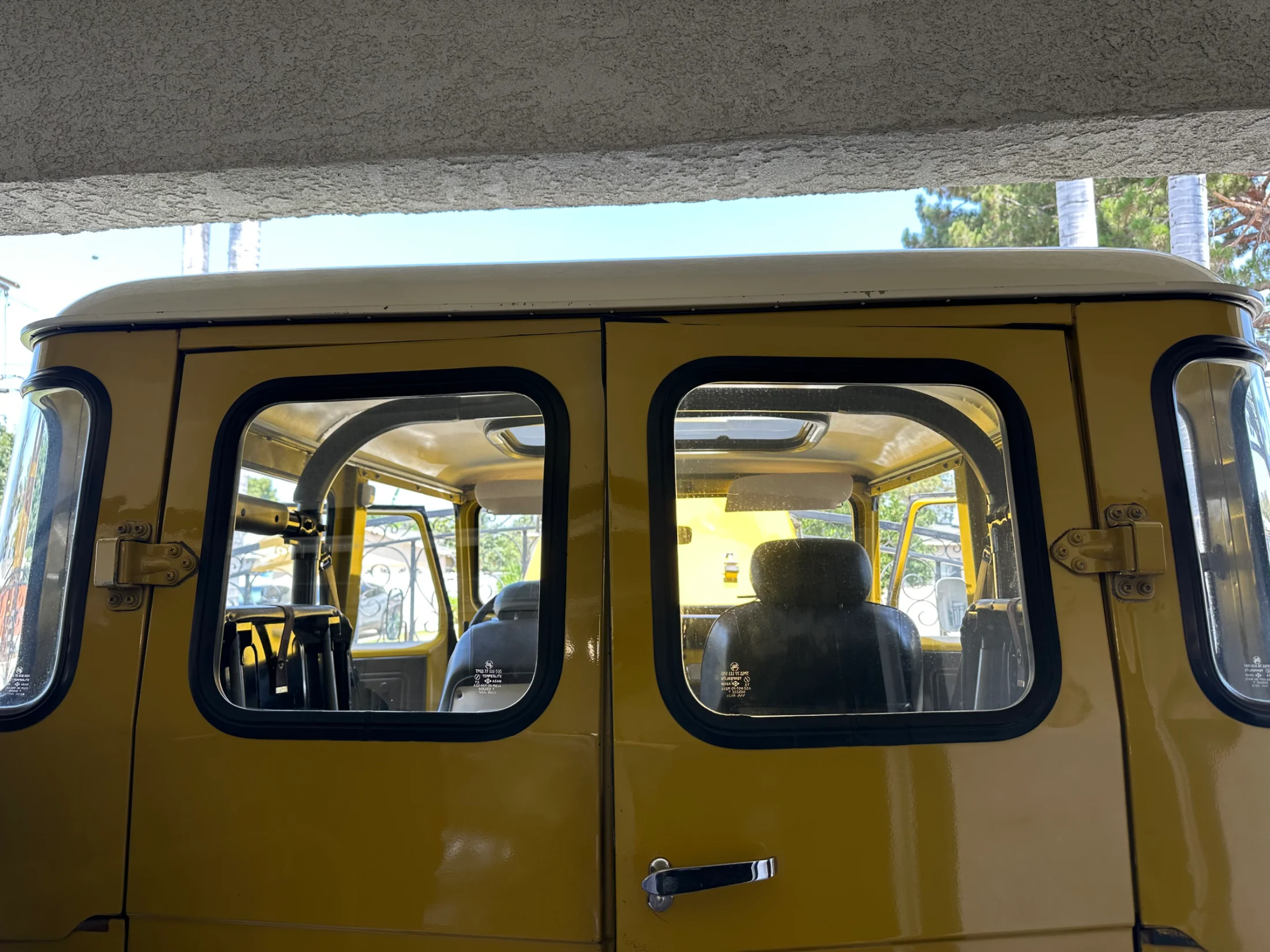

Finally got around to taking the hard water spots off the windows. Some 0000 steel wool, blue magic metal polish and lots of elbow grease!

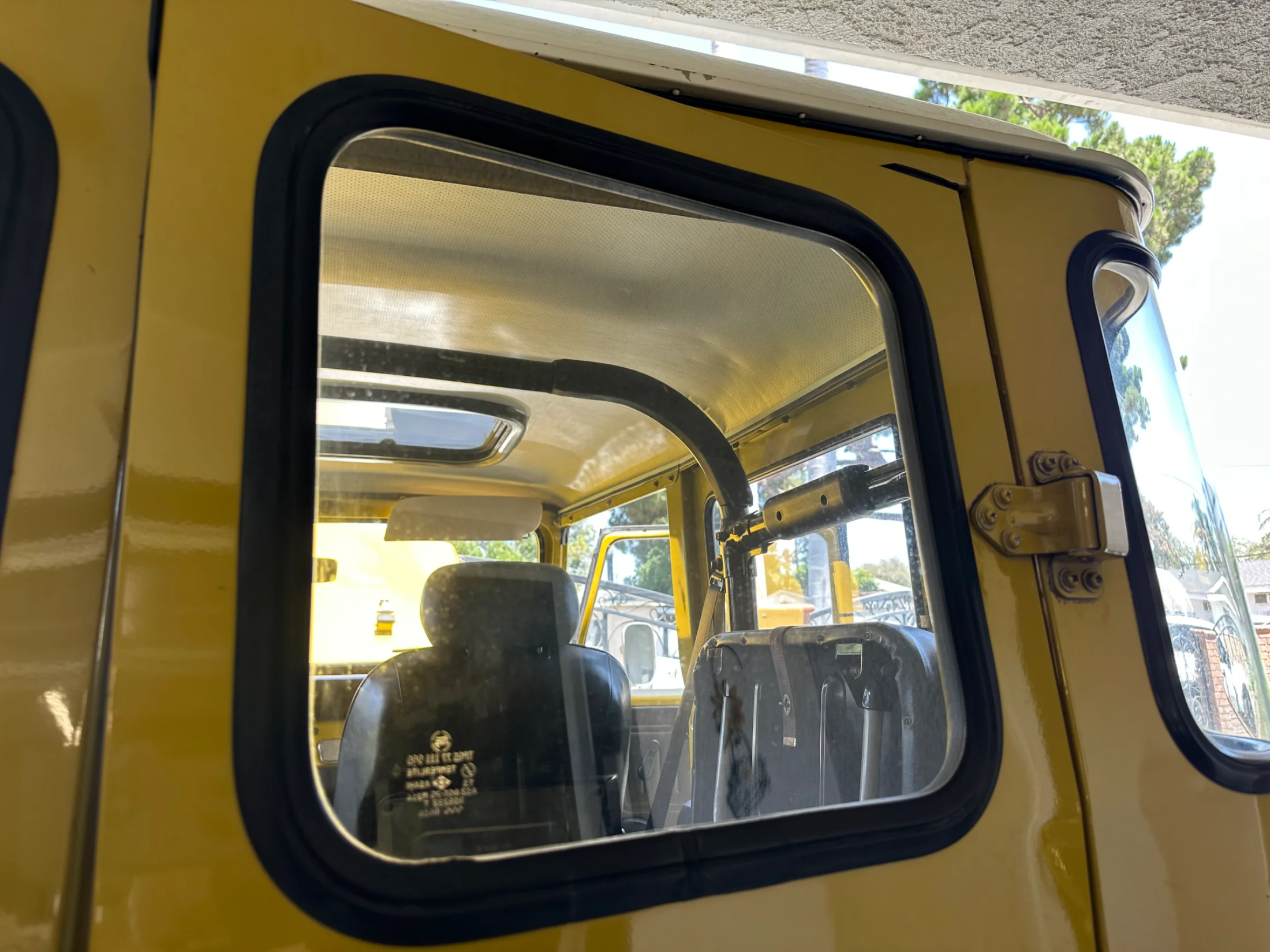

I also did a quick pass on the inside to make them crystal clear. Well worth all the work!
Thanks for the tip! I'm keeping the OEM glass other than the windshield in my rebuild and have been scratching my head on how to get rid of the hard stains. I'm excited to try this. Looks like yours are back to new!

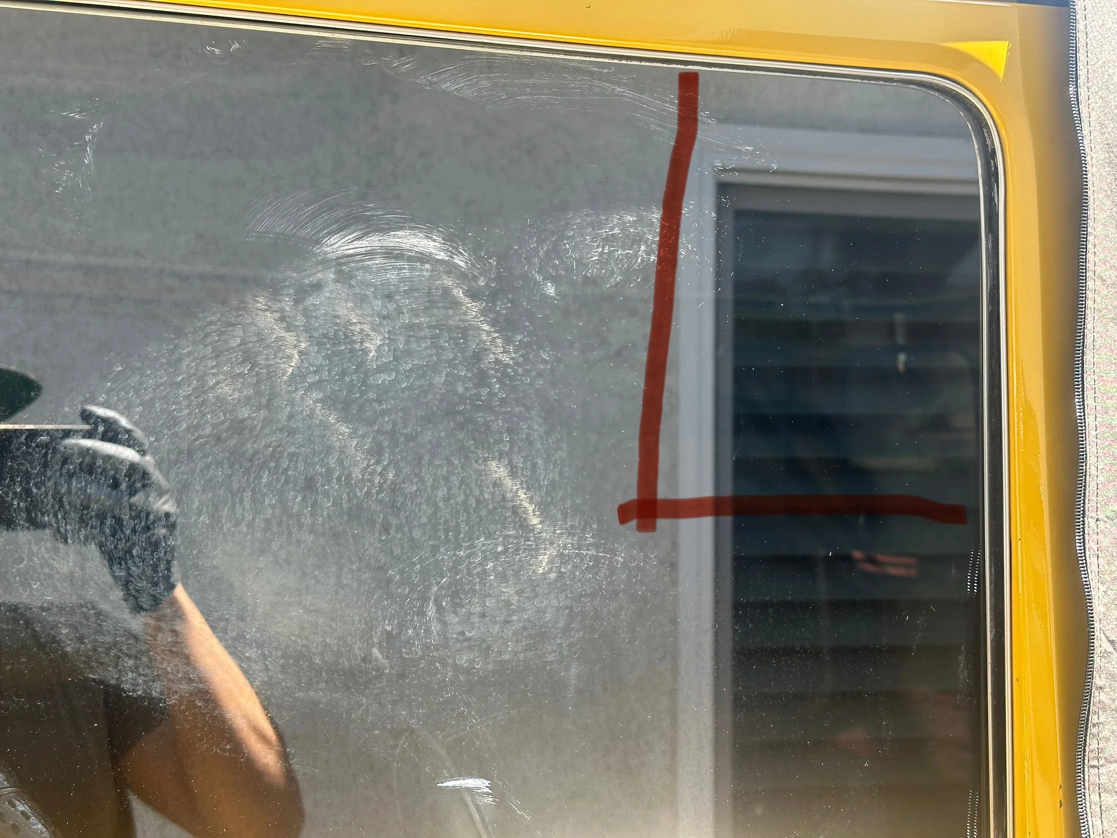

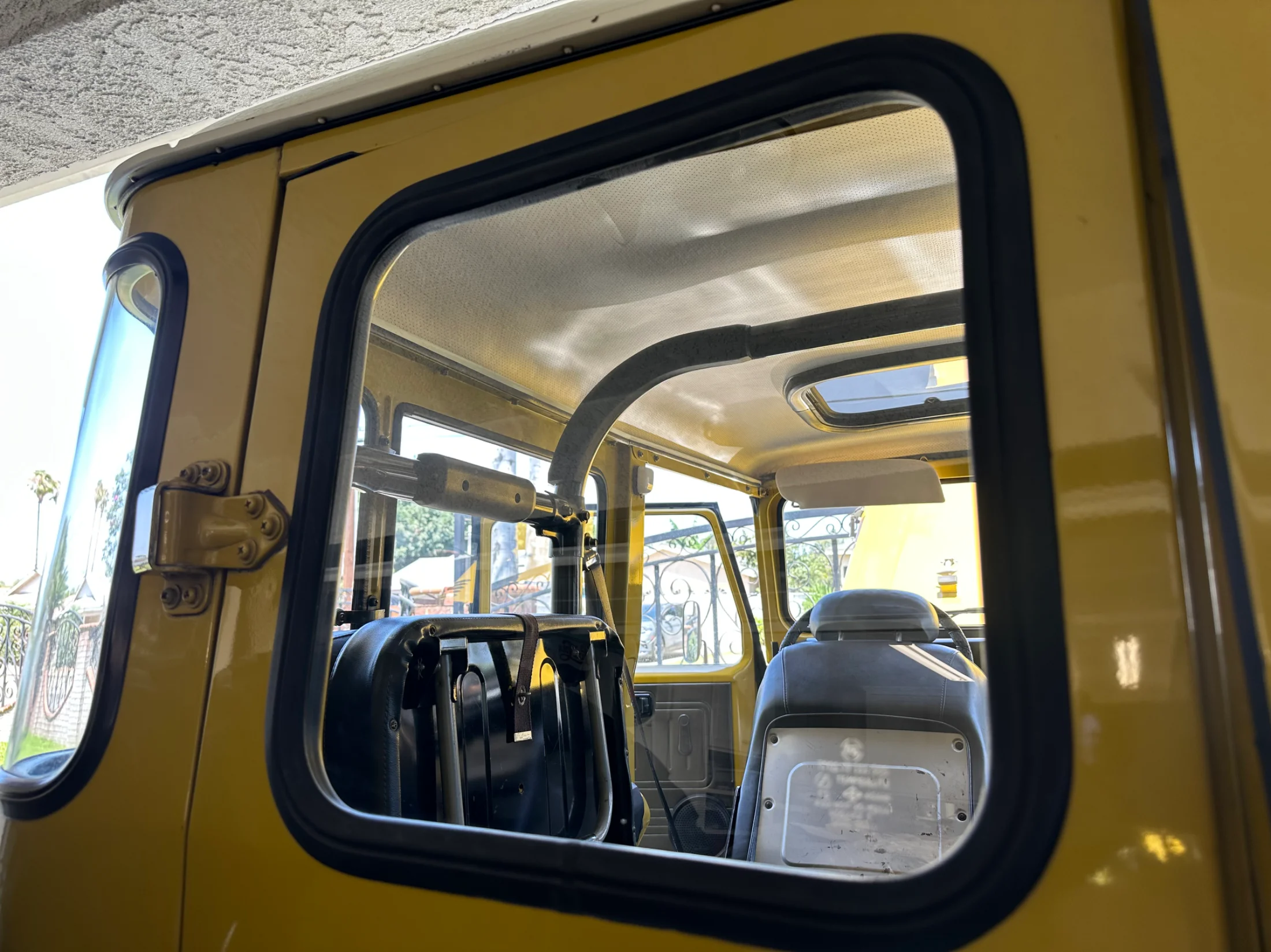

Here’s a better shot I took showing how much was on the glass. I swiped it lightly with the blue magic to make it show up on the camera. Top right corner outlined in red is a section I cleaned.
@MAR FJ40 no problem! Glad this info helped
Looks great. Blue magic delivered today, looking forward to trying it out. Thanks again.
