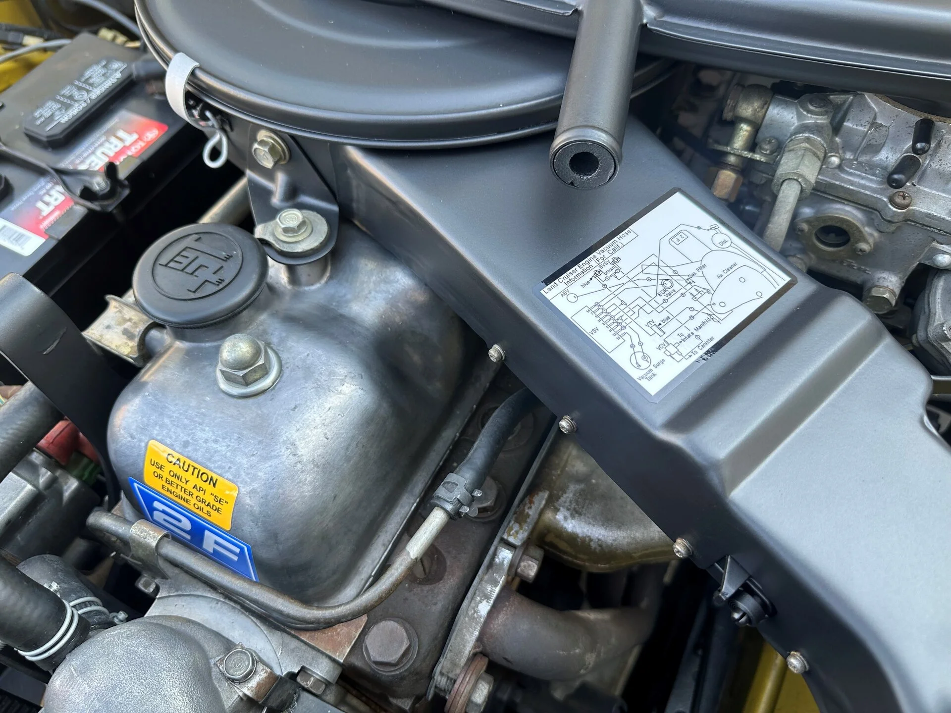

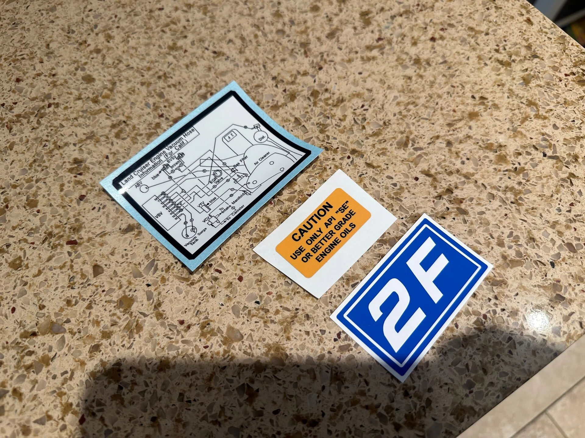

Took a gamble and ordered the top two decals from cruiserparts.net, but they are the only seller I could find with the CA vacuum emissions decal. Fortunately they came within a week! Ordered up the 2f decal off ebay and now I'm done with all that.

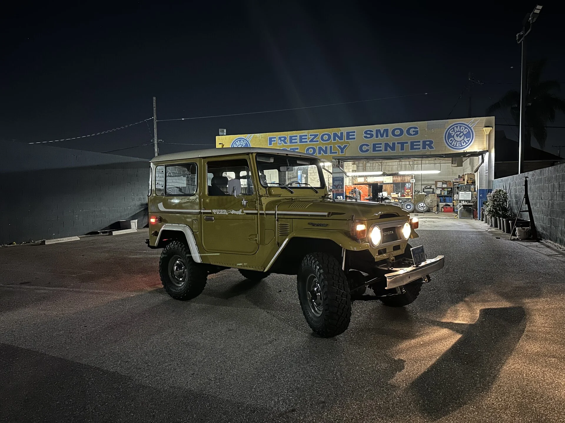

Welp, she failed smog pre-test but not by much! A little fine tuning sorted out co2, hc & o2 readings, but we couldn’t get the co reading any lower than 2.0 (max allowable is 1.59).
He is confident this old pile o’ parts that came with the Land Cruiser will sort out the co readings. I guess the thermal reactor exhaust manifold is the grandad catalytic and helps burn off fuel from the exhaust. Also, the air pump will help lean out the mixture while on the rollers. The silver lining is that it would be all legal again and shouldn’t be an issue smogging in the future…

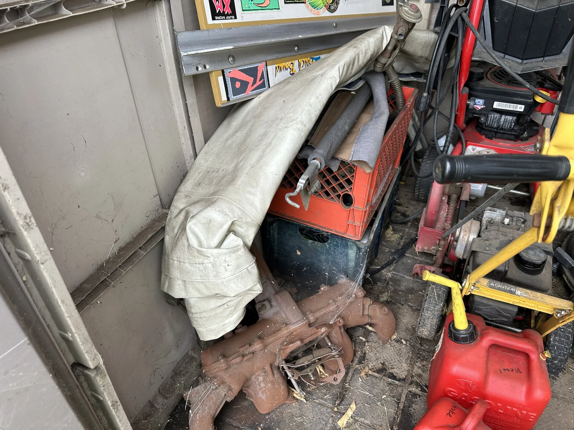

Just opened up the shed to dig out the goods and let the insects find their way out 😂
After doing lots of reading on this forum I did a quick check of some key issues. No cracks on manifold, flapper valve is not stuck, air pump is not seized. However I will need a flange from the exhaust to manifold…

It would have failed visual but that's much easier to find someone who would let it slide. The rollers have inputs for gvwr and they will know if another car is trying to be used to pass the sniffer instead of the Land Cruiser, so finding someone to get the sniffer passed is the true obstacle. I did get a few referrals but they cost a lot and I'd rather put that money into getting it right.

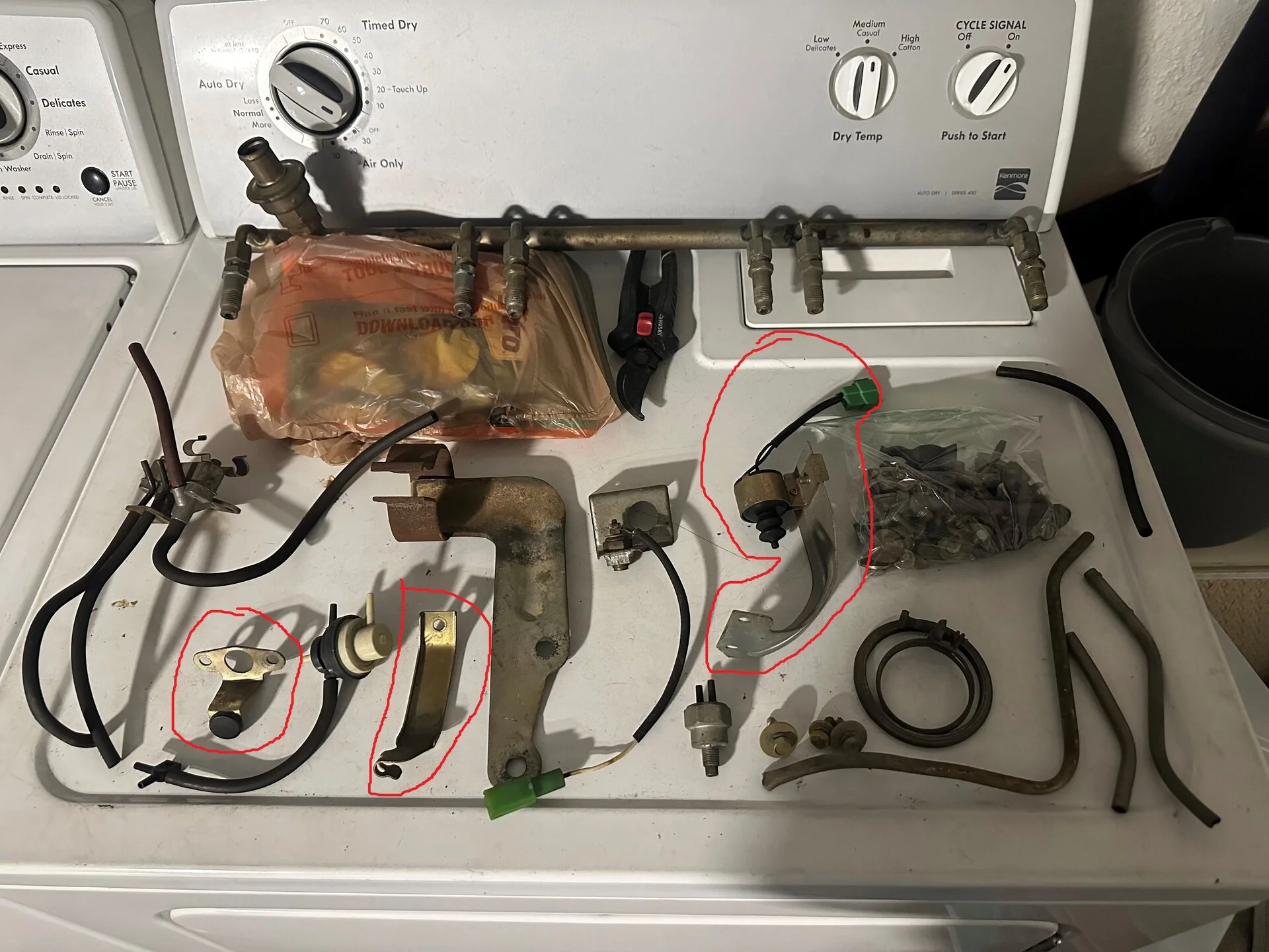

That's pretty smart lol, but I'm confident I have all the hard to find parts. It seems like literally every thing including nuts & bolts that were removed were saved. I found the mounts and rubber o-ring for the tool bag, and even the yellow color matched bolts missing from the engine bay.
Can anyone tell me where the parts circled in red go?

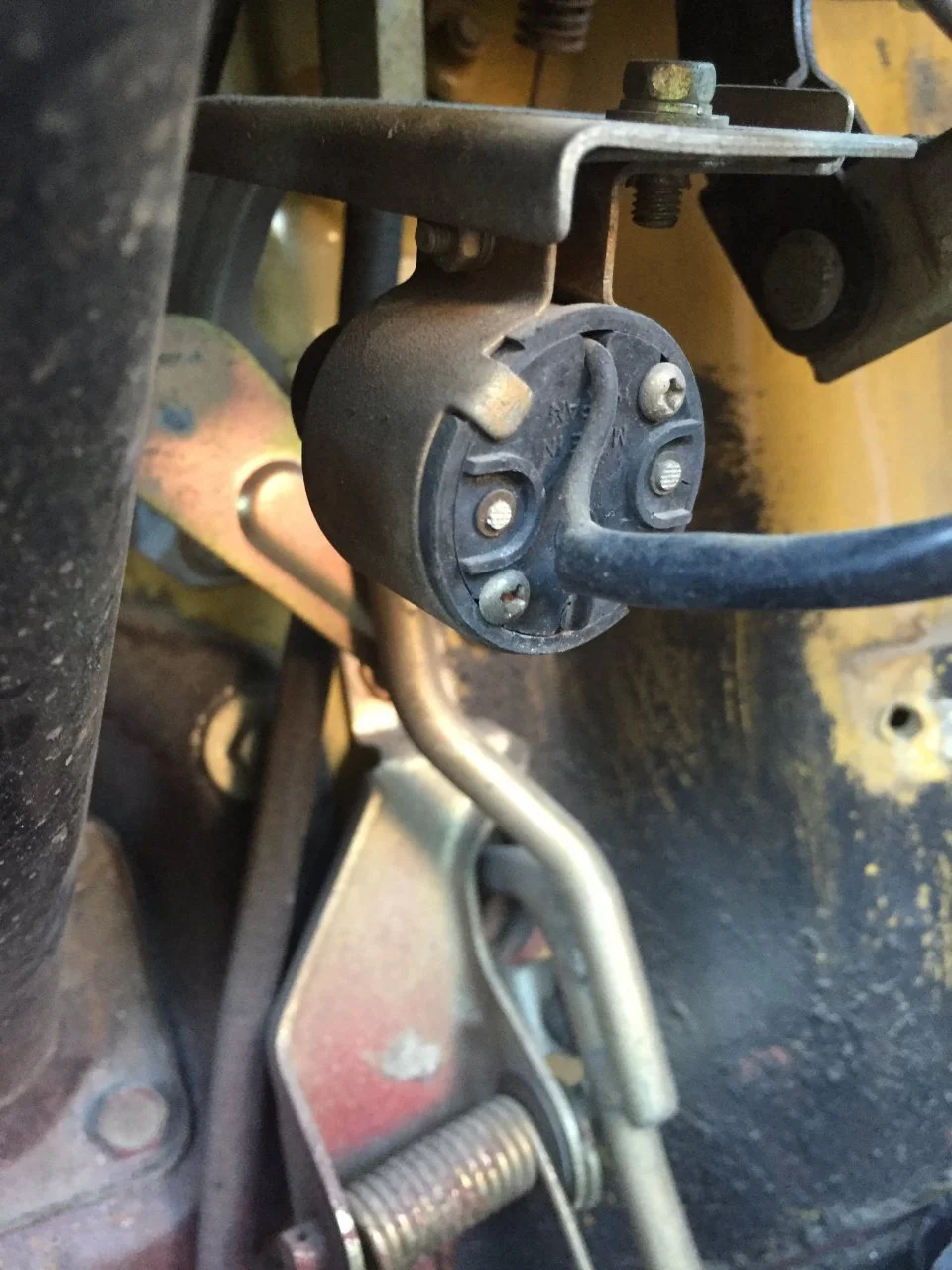

The switch on the right is throttle position switch.
It attaches in front of the gas pedal. Pedal should have a paddle like piece to left that activates it.
Awesome, one mystery solved!
