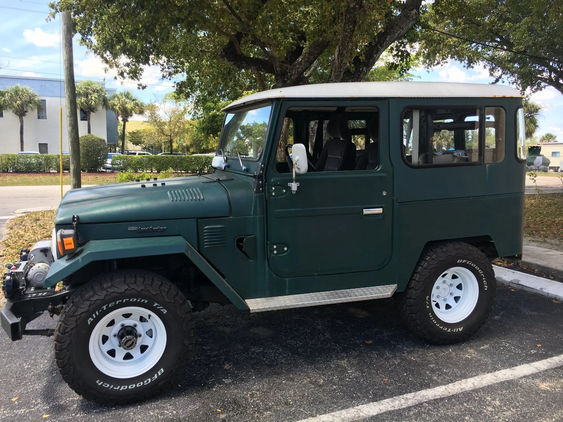

Hi guys. I just got new wheels and the offset is a little different and sticks out a little.

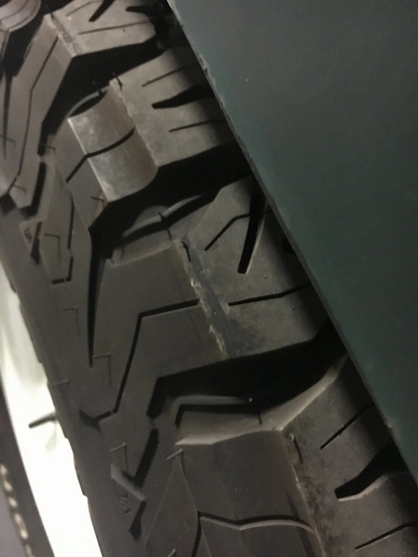

Where ever I hit a bump, I'm touching the fenders.
Im on stock suspension and clearly need to do a lift.
What would you recommend without breaking the bank?
Tires are BF Goodrich A/T 31x10.5x15.
Thanks in advance.
Rear fender flares (cut-outs) allow you to trim about 1" off the front and rear edges of the rear fender opening, and about 2" across the top. If you don't mind molesting the body, this (and longer spring shackles) is the way to go.

New shackles in the rear will be the cheapest option.
I just installed the skyjacker 2.5" kit with stock shackles and am happy with the results, it was very affordable.

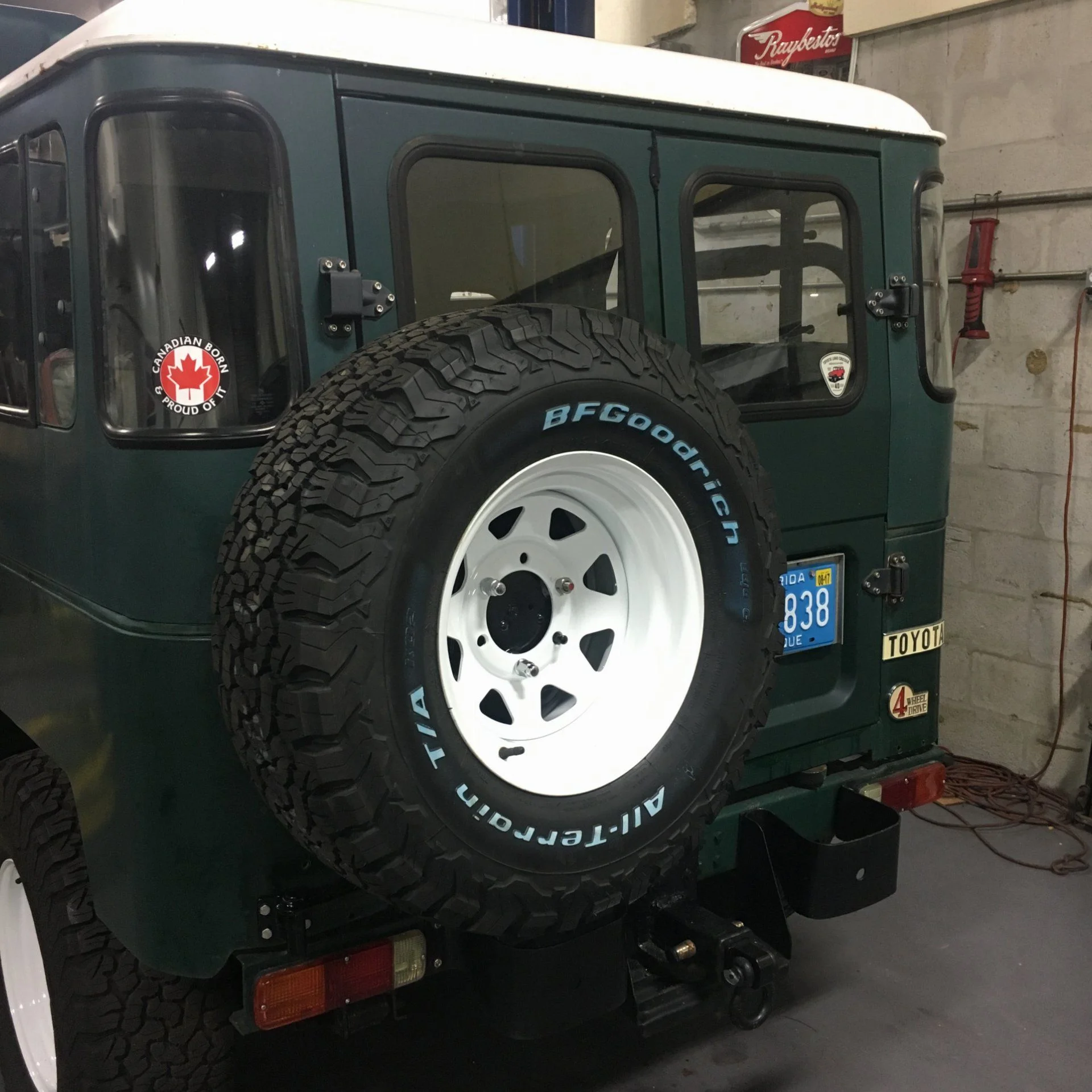

Previous owner fabricated the rear fenders. New sheet metal. They don't look proper size. He made the front fenders also.

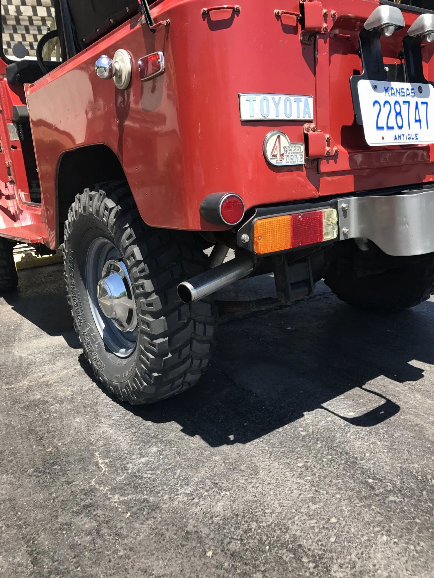

I have stock shackles on the front and 1.5 over stock on the rear done from PO as well as fender flares... currently running 33 x 12.50 with no issue...
I'll be going @Flatlanderfj40 's route as soon as I figure a way to scare up the funds for it.... along with my nearly finished steelies w/33 x 10.50 KM2s
If you do go rear fender flares, don't cut the body until you get the flares, then use the flares as the templet. I guess this all sounds very obvious!!!!!

Crazy looking quarters, they look to tight against the tire..... and fenders look crazy too!!
Id try and cut quarters to factory spec so you can gain some clearance around tire.
Id say you would have never had a problem, if PO had kept the original clearance around rear tire when he fabbed up quarters.

Was thinking about cutting to factory specs as well. Would you know where I can get a template for it or just get dimensions?

Find an "original" 40 near you and see if the owner will let you get a pattern off their rig. I would hang some craft paper squaring it up at the front and top. Taping it around the edges of the quarter and draw/shade with charcoal pencil to transfer the dimensions to the craft paper.
Once on the paper you can take it back to your rig and transfer it to your quarters. And start cutting.....
Don't forget the folded lip around wheel well. Leave your self enough material to make that bend.
