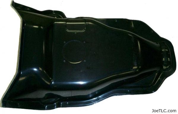

Has anyone used the jt fiberglass trans tunnel it's the cheapest new replacement out there and I figured I can fix my current trans tunnel in a year or two as I get a welder and garage but for now I need something and I would like it to be kinda nice.
http://www.jtoutfitters.com/transmission-hump-cover-7378-toyota-land-cruiser-fj40-p-2587.html

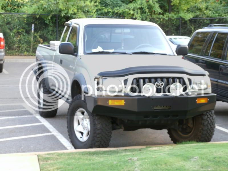

I ll start by showing my past Toyotas and pictures telling their stories since i have just started with my FJ ownership
My first Toyota i got at the age of 16 after working for 2 years at a family owned grocery store to save for the down payment
1998 Toyota Tacoma V6 3.4
it had a revtek lift kit and 32 in mt tires, also added a TRD sticker to it(actually got more from insurance when they totaled it out because they thought it was a real trd so the 25 buck sticker ended up getting me an extra 775)

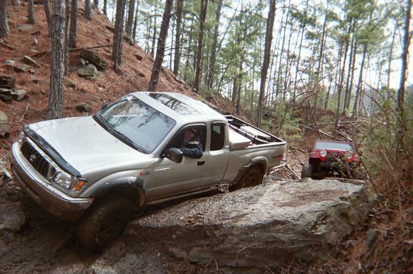

my second toyota was another tacoma
a 2001 tacoma v6 trd with man trans
this thing was sweet it was built with all the right parts from the factory: rear push button locker from the factory (used to be very rare in vehicles) manual trans, strong motor, 4.10 gearing
modded this a little bit more
TJM front bumper, all-pro rear bumper, demello sliders, sway a way coil-overs, 285 bfg mts
more wheeling

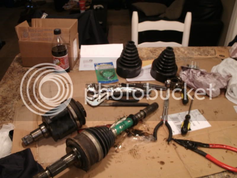

would have one of the cv's crap out about every 2 months, towards the end, only had the swayaways set to 2in but something was off i think the frame was slightly bent from before i owned it and time and bigger parts made it really show. With help from a guy on ttora i wold find ways to make it better and he would help me install them, great guy. I even tried a manual hub conversion but the nickel and dimming of all the small parts and then needing new wheel bearings (apparently early tacos had wheel bearings pressed in so tight only a few places could do it 25 or 40 k pounds i cant remember) but no one could press the new bearings in the spindle so i parted the man hub stuff back out.
