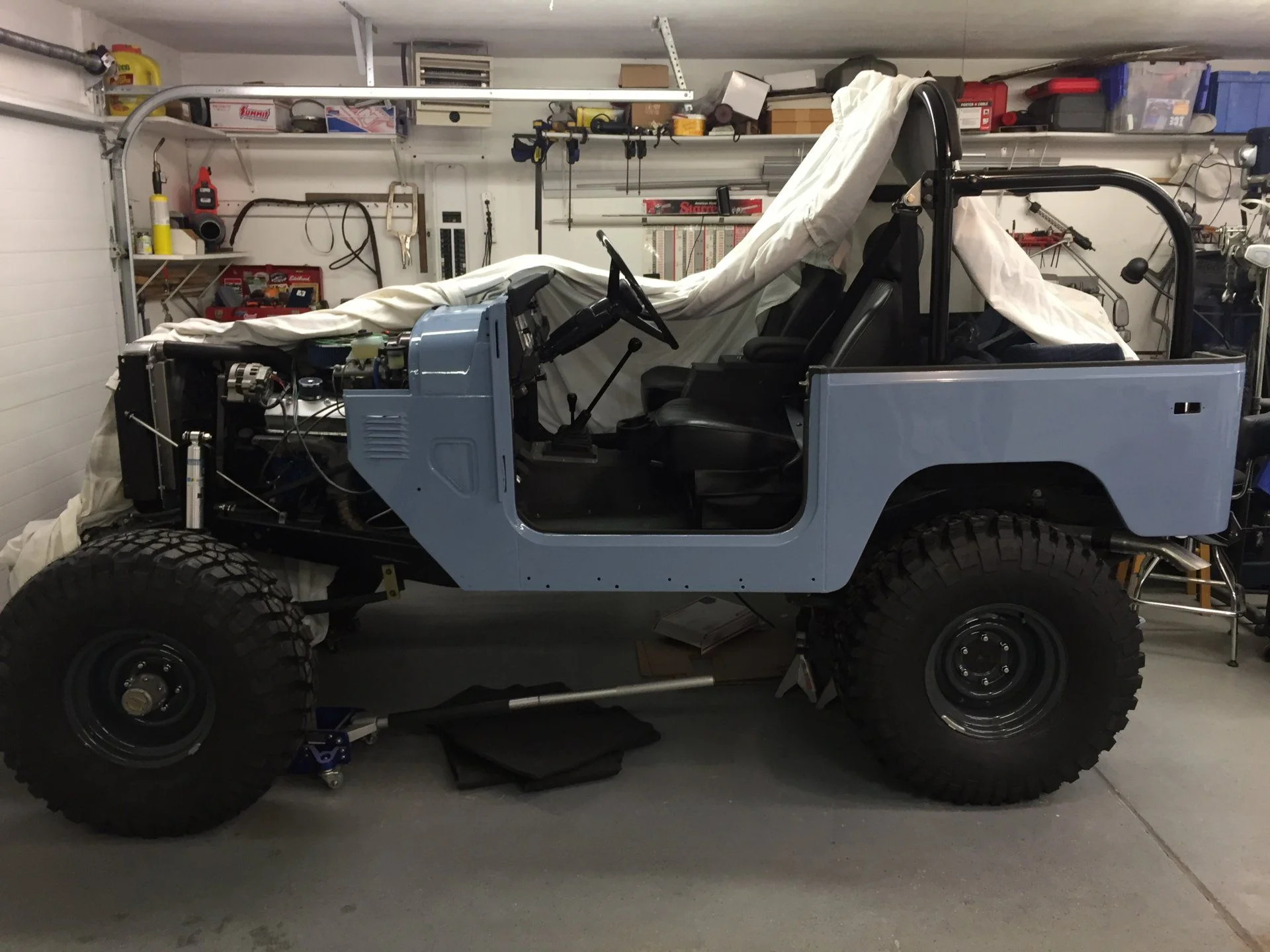

Amazing what a freshly painted tub and a new pair of shoes will do!
So talk to me about the wheel and tires sizes... Do they require spacers? Do you happen to have a link from where you purchased them? These are exactly what I’m looking for, for my frame-off rebuild.
I have contacted Wheel Vintiques about their 62 series wheels. The have a 15 x 10 which is the size I want and can build the correct 3.5" back spacing. The pricing is higher than I wanted but this is the look that I want.
  • Like
Reactions: SMG

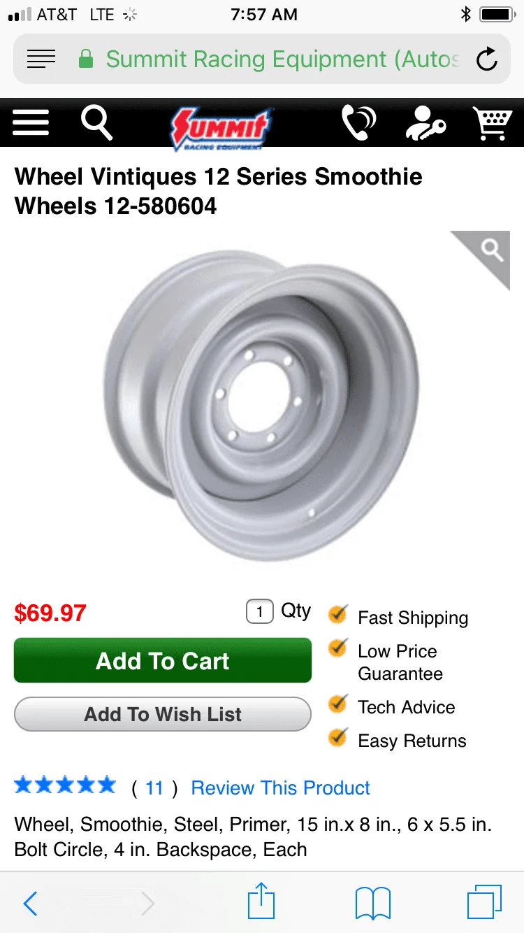

The wheels are 15” x 8” Wheel Vintiques 12 Series with 4 backspacing.
Wheel Vintiques 12 Series Smoothie Wheels 12-580604
The tires are BFG KM2’s 35” x 12.5” I bought the tires from 4wd.com. (heep site). Best price I could find plus free shipping.
Currently have no spacers. I believe this is because I am running All Pro Steering arms. Eventually, I may go with 1” spacers because the rear is pretty tight and I know it will probably rub once it flexes out.
Yes, I contacted Summit about custom backspacing but I decided against it.
It was going to be $94 a wheel which I thought was very reasonable. My main reason I decided not to do it, was because I’m not a big fan of the deep dish look. Just a personal preference as I like more of the stock wheel look.
I did find out, that if you order the custom backspacing from Summit it’s still free shipping.:bounce:

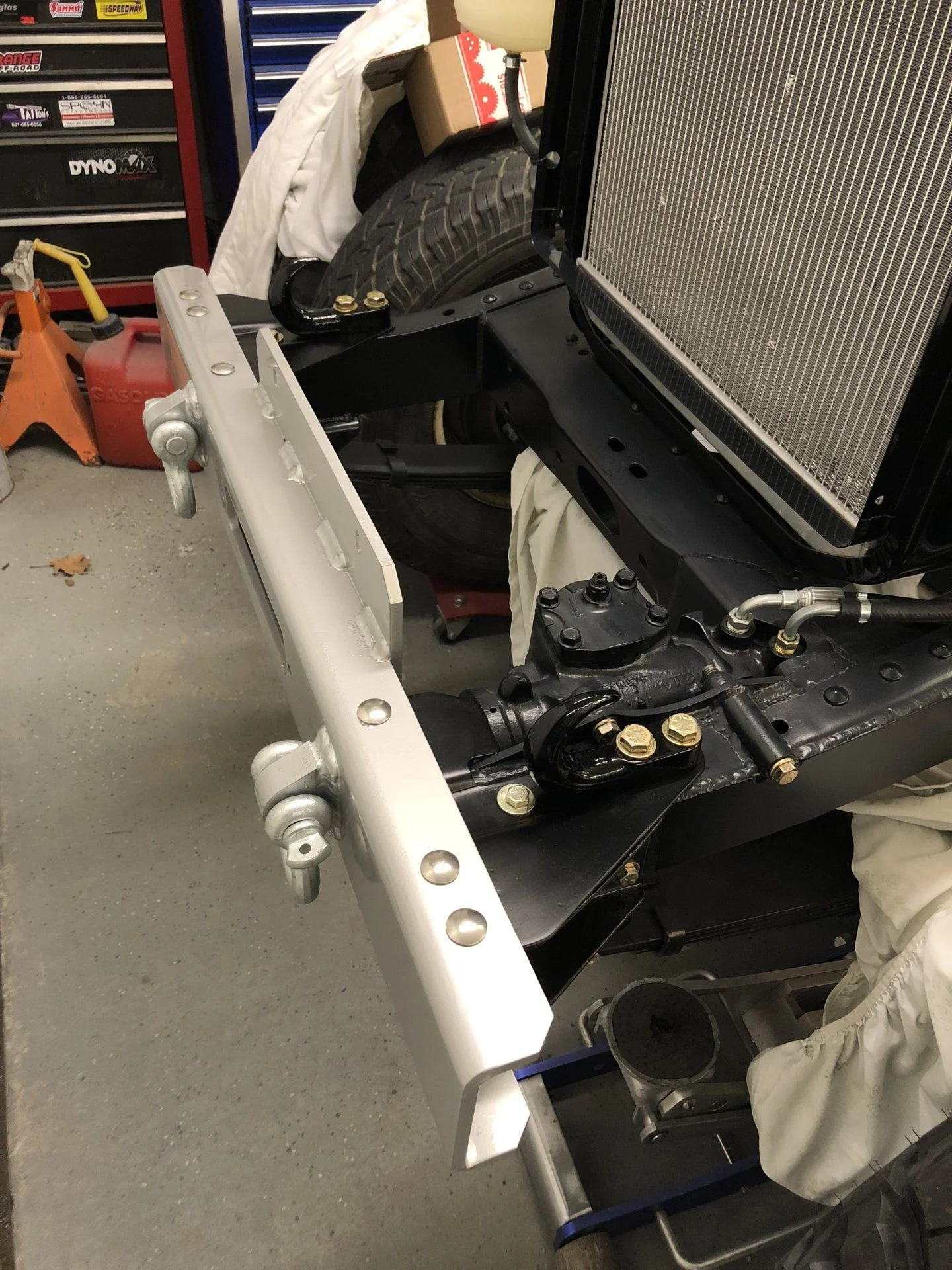

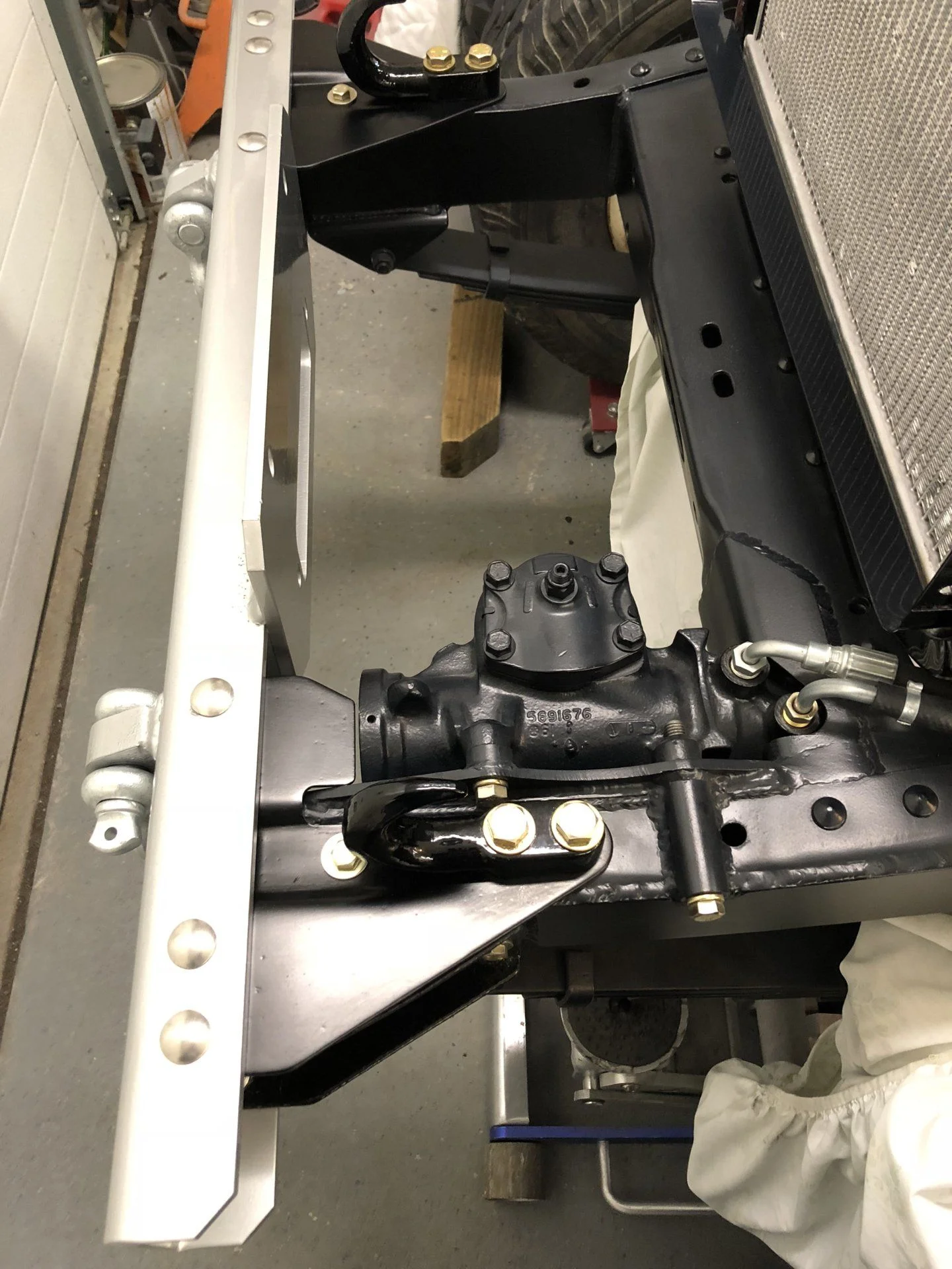

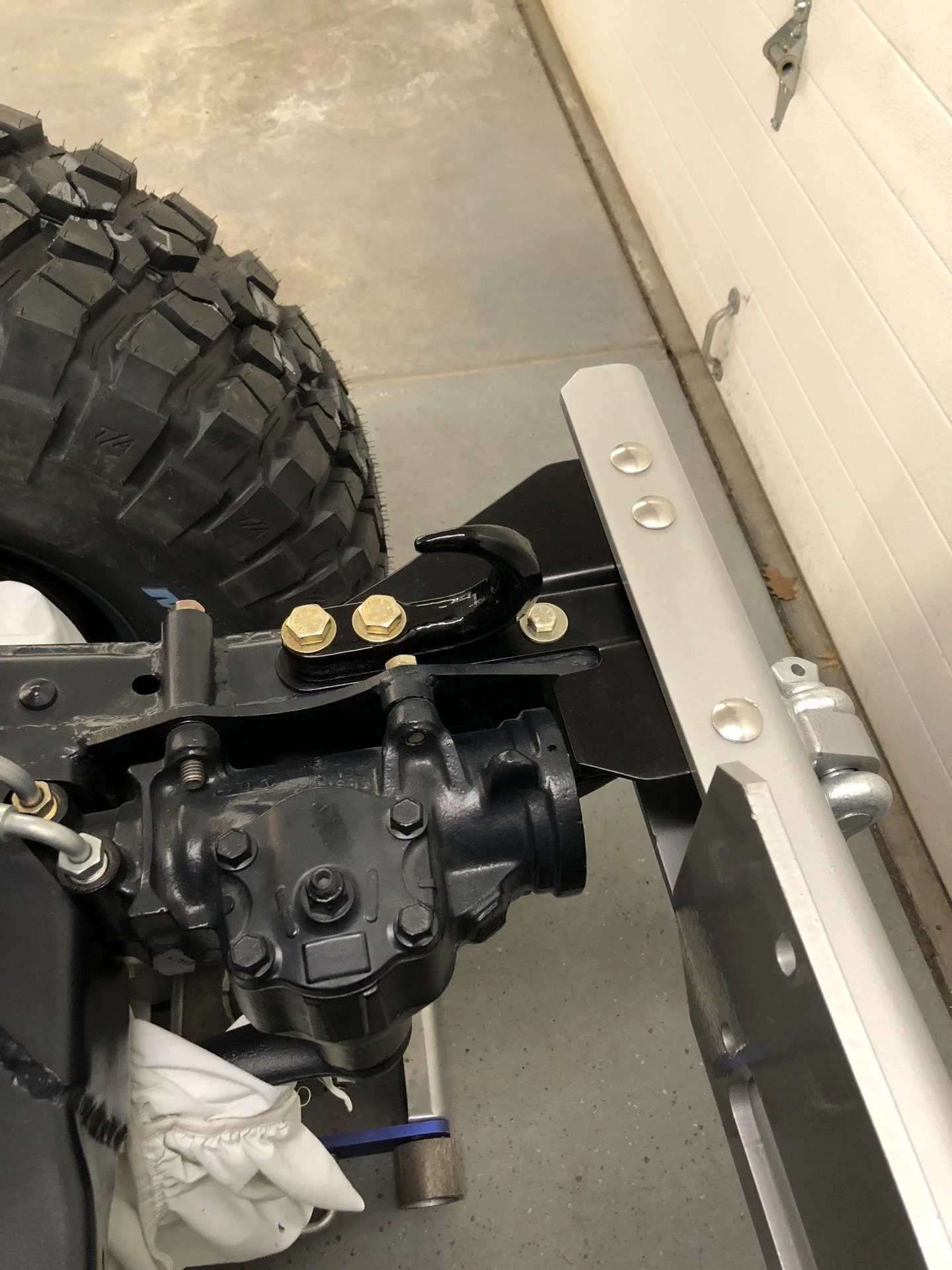

Started working on my CCOT Hell For Stout front bumper. I really like how beefy it is and its simplicity. One thing is for sure, the powedercoating is crap! As soon as I removed It from the box, it was already pealing up on some of the corners. I have a feeling someday I will be redoing this.
As you can see from the pictures, I had to slot the left hand side bumper mounting plate. This is due to my Saginaw gear box conversion.
