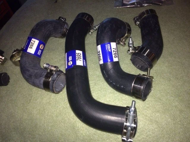

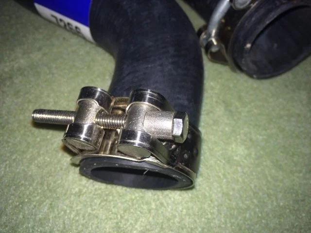

"Plumbing" is a 1/4:banana: job (banana bite) with the engine exposed. Not real "sexy", but important nonetheless. At any rate, 99% of my plumbing hardware has arrived. All except the set of clamps for the thermostat housing to water pump...Either I ordered the wrong size or they sent me the wrong size..Probably an "operator head space and timing" issue. I have used and prefer the stainless shouldered clamps over the garden variety worm gear clamps. Although I do keep a couple in the "Kit bag". . Using Napa hoses. Decent price and IMHO they (Napa) have pretty decent products, a good return policy, and a handy machine shop. Should have the rad support and shroud back on the around the 1st of May. That will allow me to mount the radiator and finish up the plumbing. I have a couple "Gano" filters (thanks Sarge) ordered. Looking forward to firing it up after all this down time. Any recommendations on start up procedures, other than prime the lubrication system??

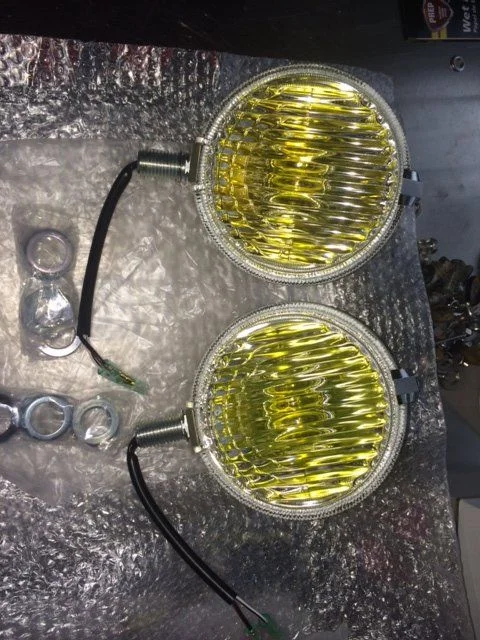

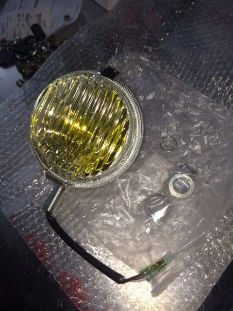

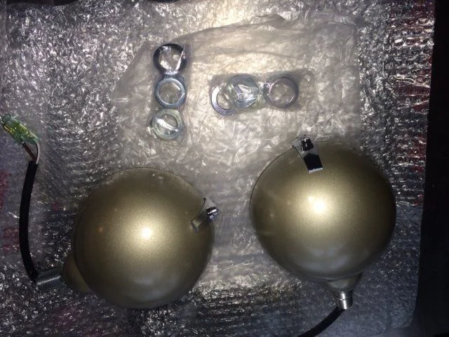

TLC Bling..Just using those words in the same sentence can spark a significant emotional response. Well, I bought some..In this case it's "factory bling". I found a set of OEM Toyota fog lamps/lights. Bought them from Griffith Motors out in Oregon (no affiliation). I've been watching for a set for quite some time. This set was about %50 less from the best price I've found so far. I don't have the mounts, but I do have a set of knock-off mounts from a set of lamps I bought a few years ago (came out of Dubai as I recall). I'll clean them up, shoot a coat of paint and use them to mount the lamps .

I found some of the clamps 51-54mm from an Ebay vendor out of Elkhart Indiana. Some of the smaller clamps were from a Ebay vendor out of Los Angeles. I just searched "Stainless steel T-bolt clamp". The local options here in my little corner of WV were primarily bulk options. I did not need 500 22-26mm clamps. So the online route was easier for me. Cheap enough to pick-up just what I needed with a spare or two. In the past I have sourced some of these same style clamps out of the peoples republic...But the slow boat from China was frustrating because you could not depend on a quick delivery if you were in a hurry (read within 2 weeks). I don't know what it's like out your way, but here its hard to find things that aren't "mainstream"....

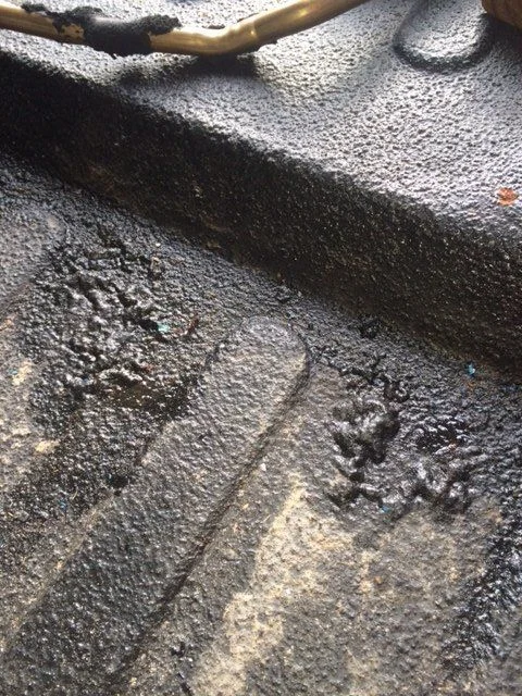

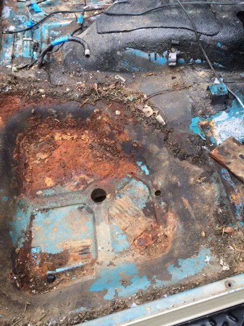

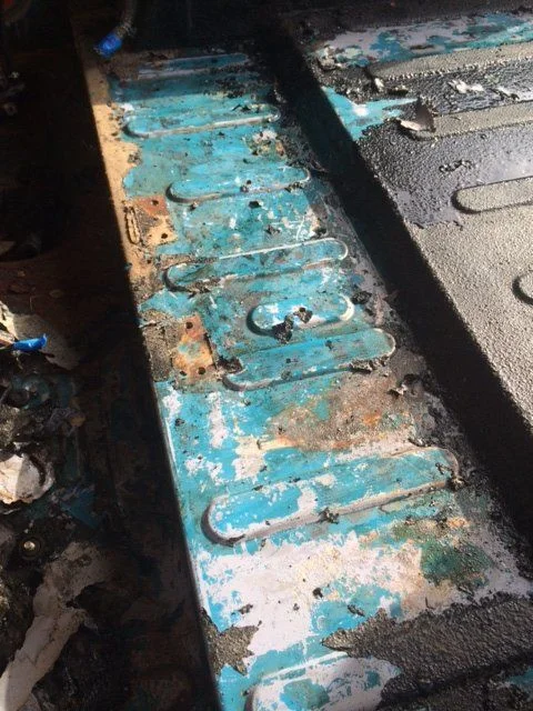

When I first made the decision to start peeling back the bed liner on ole' "Zig", I started on the drivers side floor board. Previously, I had replaced the clutch MC due to a pesky and persistent leak. What I had not noticed due to the black bed liner was some of the fluid had leaked down into the floor board. As I began to remove the old liner the areas that were saturated with the brake fluid peeled back like "wet lettuce":hmm:. Areas not saturated held on like a doberman on a dog bone....You can see where this is going....Pics below are a before and after of a "controlled test". I brushed on a medium layer of Dot 3 and waited a week. True to my earlier observation the old bed liner peeled back with ease....What had taken considerable time before now scraped up in less than a minute...I'll post more of the observations on the next post....More to follow!
I am not sure the brand of bed liner that is on my TLC. But I believe there were factors that contributed greatly to this "Unconventional application" working for me:
Things I am certain of:
1. My liner was a brushed on application.
2. It was a thin layer, probably 1 coat.
3. Initial prep of the tub before application was so-so at best.
4. Where the fluid was able to penetrate the greatest "lift" occurred.

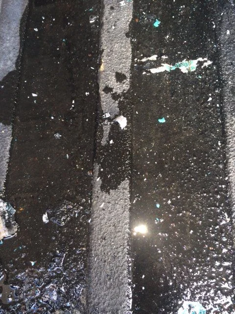

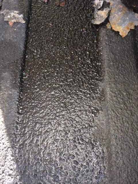

The following area (see below) had one application of fluid and allowed to sit for approx 4 hours. You can see where the liner came off in very large pieces. My weapon of choice is a 12" gasket scrapper that I purchased at Napa for a few bucks.
I am not suggesting this is a technique that will work on every application. Some bed liners are "tuffer" than others. Some applications of liner have a better prep than my example.
Also, cleaned the area profusely after liner removal and it will receive a thorough high power wash after all bed liner is removed.
Not recommending you run out and try this unless your bed liner criteria is similar to my example......But, in my case it took "hours" of grunt work off my liner removal.....
I don't suppose I'll have to wait long for the opinions..........

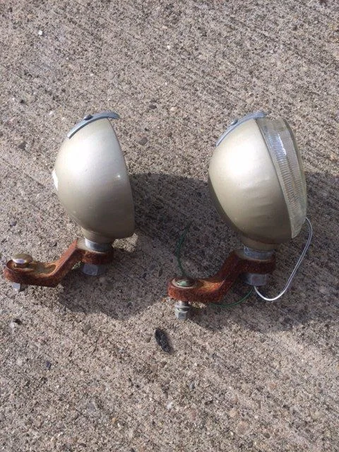

I purchased a set of new fog lamps without the OEM brackets. So, I re-purposed a set of "after market" fog lamp brackets I had.....Pics are pre-removal.
Treated and waiting a shot of black satin.

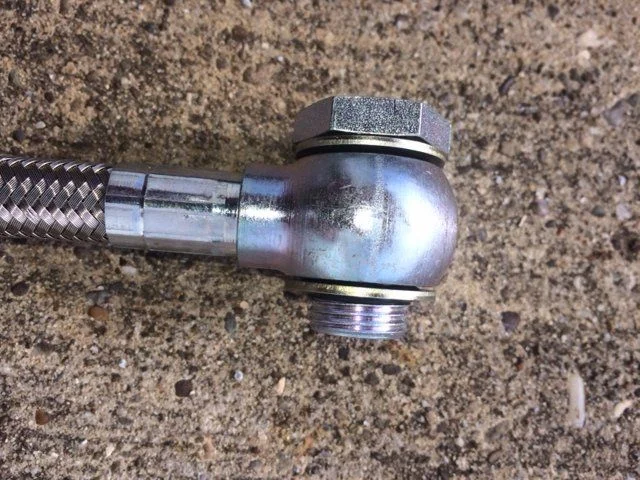

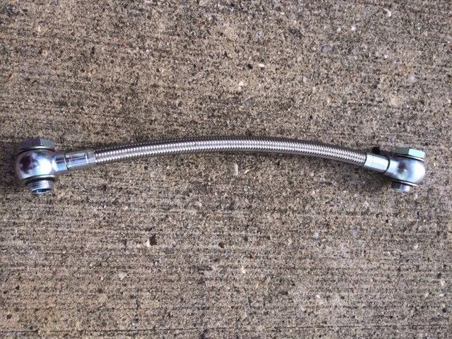

The postman was good to me: Received this awhile back and forgot to comment. Application later in April or 1st of May. Thanks to fellow Mud member "Shipmag".
Group Buy: FJ40/55 Transmission ByPass Hose
