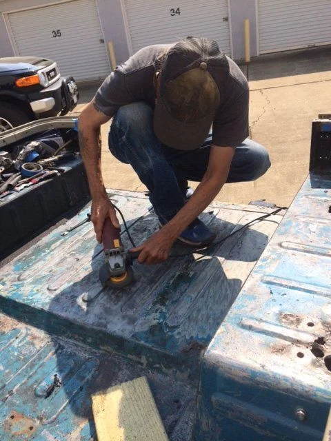

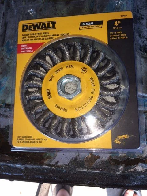

Get a dual-sided stringer bead wire wheel , they can be turned over to keep the cut aggressive . Very little pressure needed at about 50* angle and that stuff will fly off (eye protection - good idea ) . Weiler makes them . Fred will become light-speed fast . Do not use it at 90* or panel damage is imminent , they are that aggressive . Pipeliners love these things , Fred seems amongst that potential brethren ....
Sarge

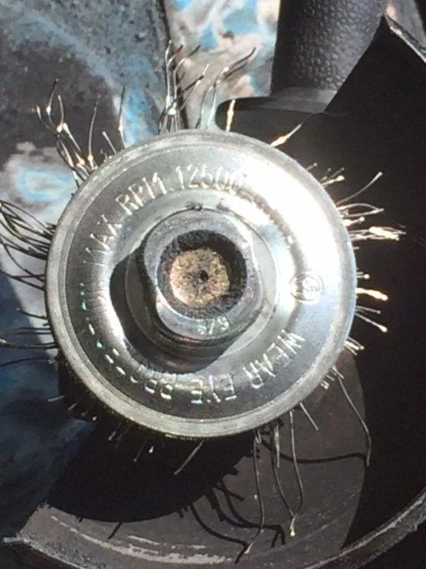

Good copy, that is exactly what we were using on the small grinder..The small grinder had just enough ooomph to spin the wire wheel effectively, but not enough to incur any sheet metal damage. It worked like a charm. But it grenaded the last hour of the day..I will pick-up another for next weeks assault.

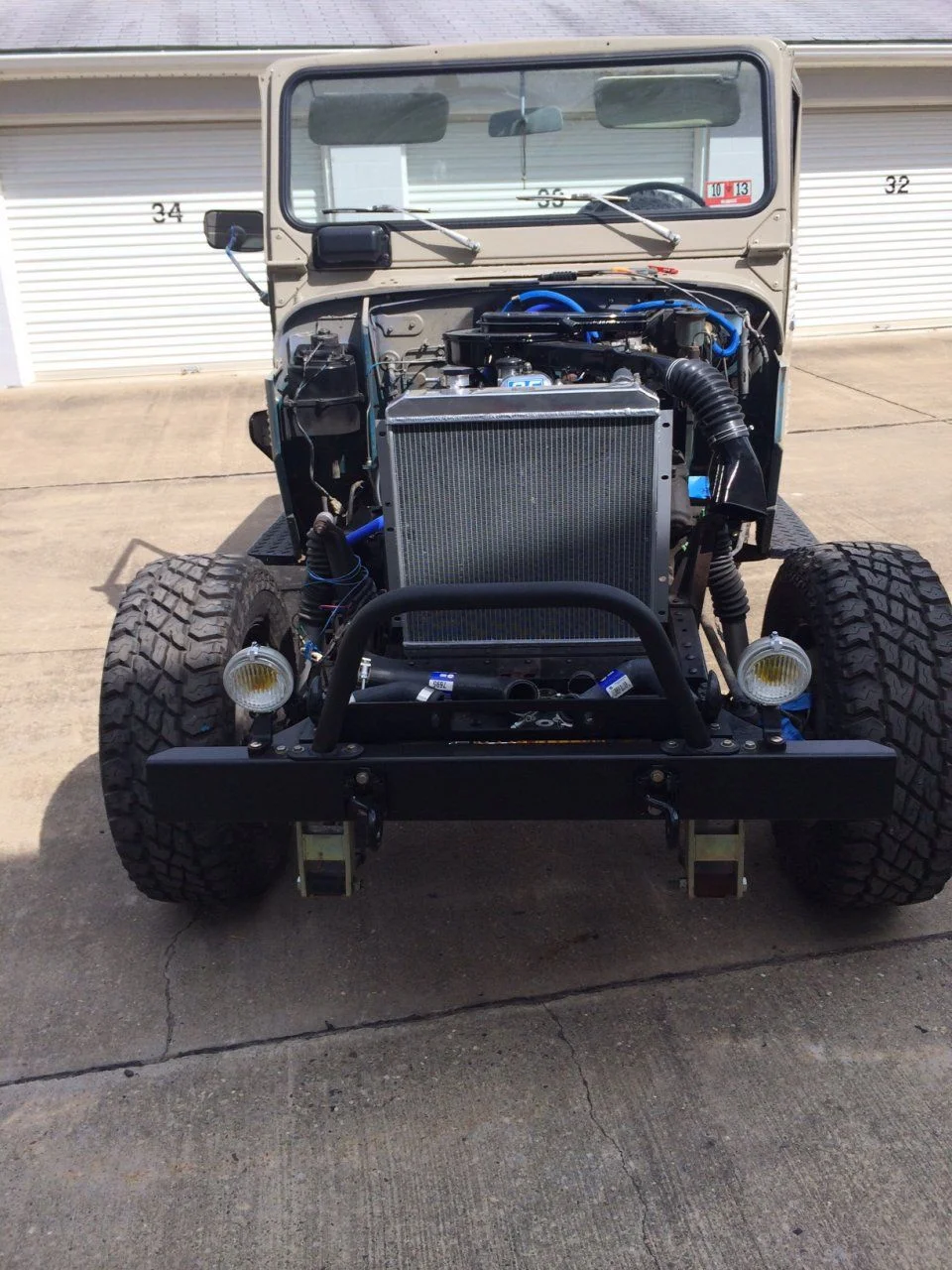

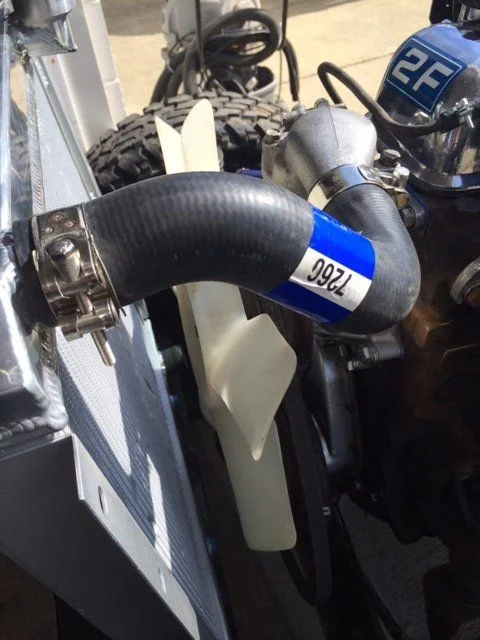

The remaining hardware for my "plumbing" came in on Saturday..While "Fred" was assaulting the bed-liner I test fit the radiator..I really like the T-bolt clamps for functionality...
Fenders, hood, Rad support and fan shroud are still at the painters, so I can't button up the plumbing until then. Mark'en time till next week!!!

Well, ya see "Fred" is now 10 level qualified...Signed off on his job book just at quit'en time on Saturday... Task 1. Proficient with the A1-J1 Scrapen' tool. Task 2. Proficient with the A1-J2 Bigger scrapen' tool. Task 3. Proficiency with the Bravo 3, High speed rotary liner assault weapon.
That's 10 level qualified!! Now next week were going to do some advance "training". By the time this is over I figure he will be a skilled "Rust Warrior"....If I could just talk him into buying a "welder" I'd train him on that too!!!

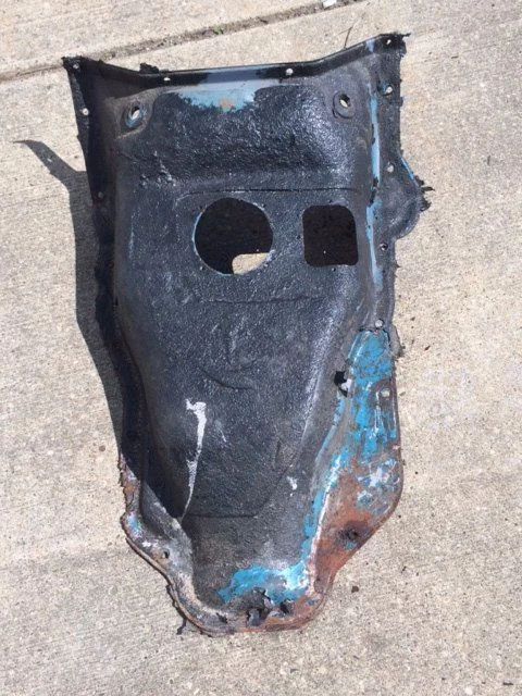

I found hints of the red scourge around the tunnel, ragged decay hidden by bed liner and obscure holes lurking under my gas tank (blaming the unplugged drain holes)...I call it "TLC osmosis". The seemingly impossible transfer of a fluid through a non-permeable surface (maybe Semi-permeable)...That's a "Blinding flash of the obvious" for most of you zealous chasers of oxidation, but to me it's a unwanted wanton twist of fate.
I did have one or two desperate ideas that were simmering just beyond my conscious thought..Like burying the bane of my existence with a backhoe and swearing it was taken by aliens in order harvest its reproductive organs and start a "Borg" race of mutant
tractor like beings....I abandoned that plan when the local chapter president of the "WV - Extra Terrestrial Greeting Committee" and State Farm agent, informed me our "Pleiadian friends are here to help us and are only interested in studying the reproductive habits of your TLC, not harvest its organs"...Scratch that idea!!! Who I am I argue with the greeting committee!!??

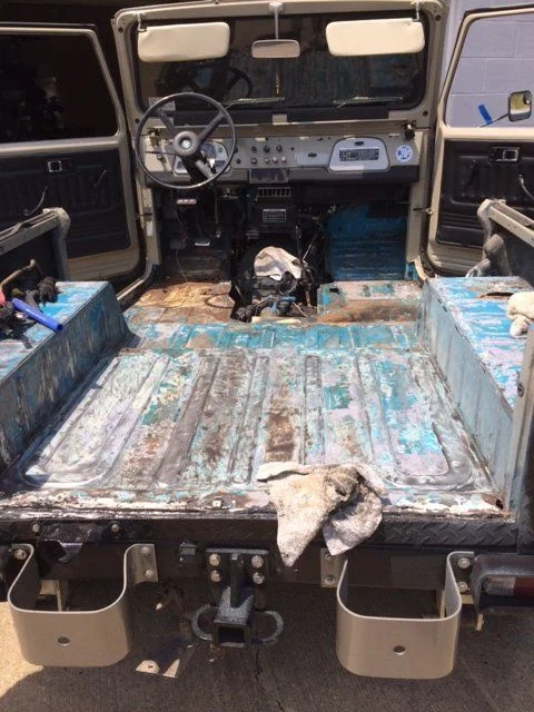

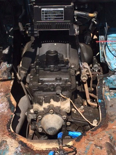

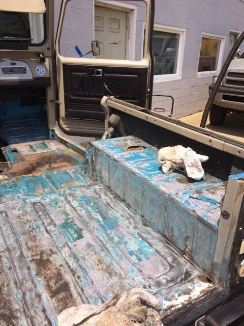

Well, I reckon I'm knee deep in it now...So, I've taken the plunge. I have resolved myself to remove "all" the old bed liner from the cab. So removing the tunnel and having another "look see" was a necessary progression. With the front end off and the tunnel out, it may be an opportune time to take a look at the seals in the T-case and tranny! You can tell by the pics my tranny "Gently weeps". At this point my TLC coefficient (TLC=Time+$$) is spiraling out of control...In a former life I would dub this "mission creep"....No end in sight and no clear defined exit strategy..Remember, in the not so distant past, this started as a simple "carb swap"....Good news! The tunnel gave up willingly...Not a single broken bolt..Must have been the full can of WD-40 I threatened it with. That's a new record for an afternoon on the mule..A little repairable rust on the tunnel/drivers side. Gear select lever came out with "narry a hitch". Bed liner is in full retreat..And, most importantly, in my headlong race down the rabbit hole, "Fred" is now qualified on the Bravo 3, High speed rotary liner assault weapon....!!!
It was Africa hot (Well, maybe Alabama hot) in the "Mountain State" today :mad:...92 (in the shade) w/humidity..Worked a couple of hours on the hunting mule...Adhering to the philosophy that only "Mad dogs and Englishmen go out n the mid-day sun", Fred and I decided that it would be prudent to knock off a bit early..Fred is a domestic connoisseur, so the "ration" for the day was an "Inbev" product :beer::beer::beer:. Not a fan, but..When in Rome, or Fred is buying..Then who am I to criticize...I'll post up more later on the days activities . Our morning did start out with a well planned offensive, but sputtered to a halt as the temperature began to climb. I did come prepared for a full on assault with the remaining bed-liner (photo #1). If you recall, we were beaten back last week, due to equipment malfunctions (Photo #2, is what remained of our kit). Again today, using the weather, the Bed-liner put up a robust defense in depth, fighting a skillful withdrawal and employing numerous delaying tactics that led to our (Fred and I) decision to "fight another day" (I'm gonna' need a bigger scrapper) ........I'll post up more later!
"Jah-zuss shuga it's hot outside, what chall werkin on"? That was the immediate response from the bee-hived debutante down at the 7-11 as Fred and I made straight for the walk-in-cooler. 1/2 hour later, still sweat caked, dirty and hankeren' for a liquid respite, we (Fred) emerged with six bottles of the finest domestic brew (read cold) that "Inbev" ever produced (Fred's not one to make hasty decisions when it comes to the daily ration). Mizzzz future beauty school honor grad found it odd that Fred and I would be "just plain silly" enough to venture outside on a "day like this"....Well from the mouths of babes...Who am I to trifle with such Maybelline encrusted adolescent wisdom...??
Round three of Bed-liner removal...! Some of that "liner" I am sure was put down with a fresh coat of super glue..I realize this thread is stuck mid removal...I just hope some fresh faced, pie-eyed TLC hopeful will read this and remember
"Ole Chungas" war on self applied water proofing and think twice about buying the Dura-coated "barn find"....
Fred is a "shy" master of the rotary tool...We made good work while the temperature hovered below 90F. Although the liquid consistency of the super heated liner made it a little easier to work with, the humidity combined with the heat led us to break contact early in the day...
As of now, we are at a 90% solution for the removal process....Scheming now to formulate a plan for the future....:hmm:

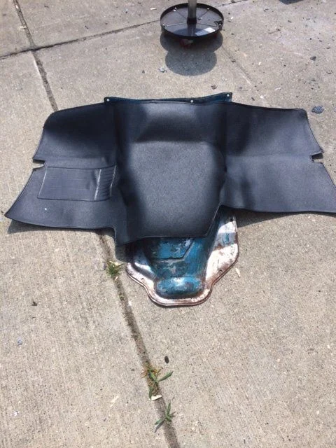

With the tunnel off and the heat index off the chart, I thought it would be a good time to start "molding" the PVC mat. Not sure exactly if I am going to put this in service..I may just make a template and cut out some "floor mats" of my own...Jury is out. Anyone else using this product? I may post another thread to see how it is holding up..
We are all anxiously awaiting @Racer65 's OEM-like mat...
Just kicken' the can down the road..
One of my 1st conversations on MUD was concerning a replacement mat @Racer65
I have an original "Toyota" mat that has been semi retired...Like most of the "originals" this one has a hole worn at the drivers heel...Thought about a repair but I elected to save it (for what I don't know)...Very happy with the CCOT rear bed liner mat. Heavy duty piece of kit. Did me some cyphering yesterday and I believe I could take another rear mat and make a set of mats for the front. Everything would match and I would have the same rugged heavy duty mat throughout the cab?
