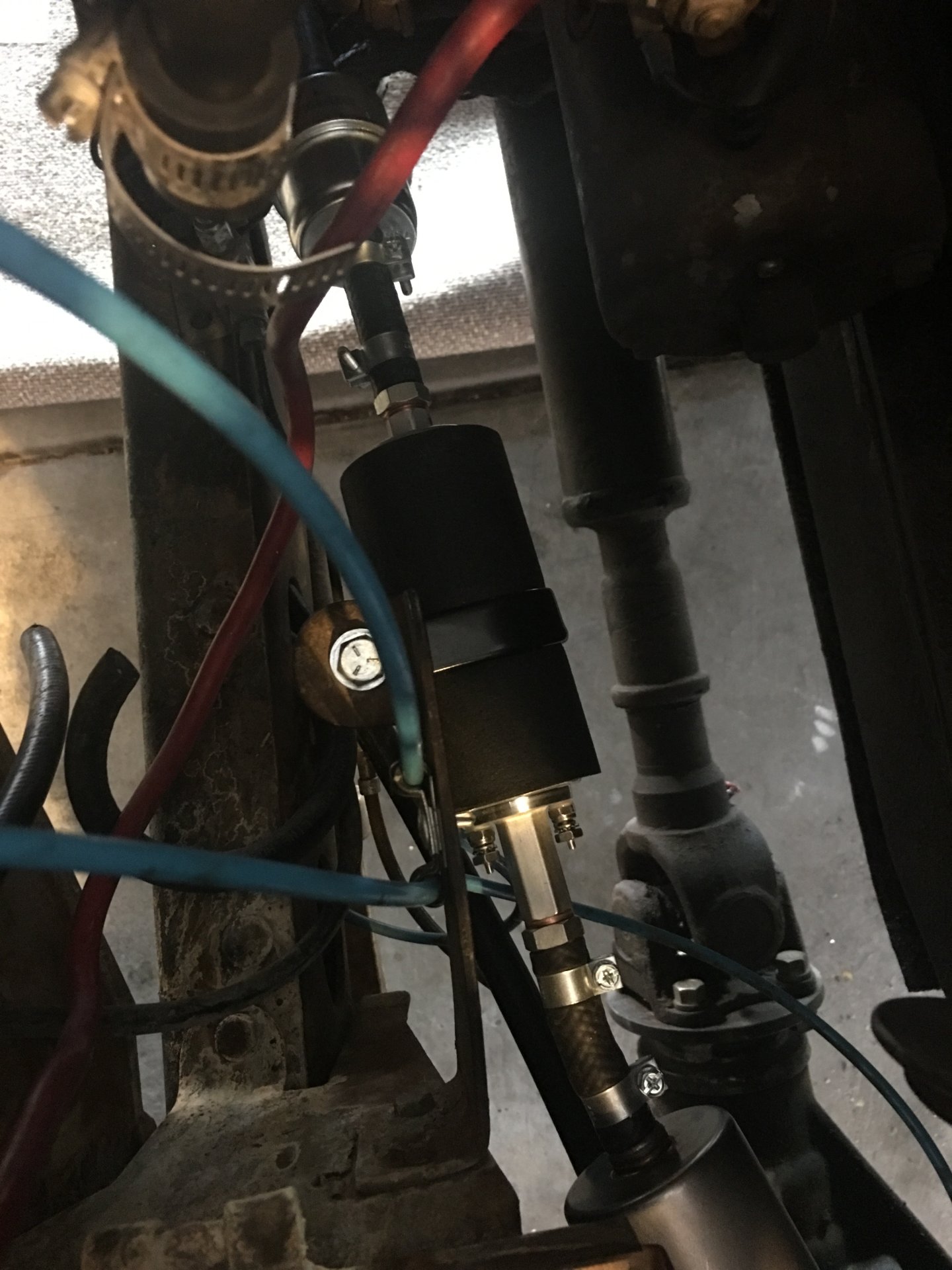

If you get creative with the filters and some -AN fittings it will be pretty clean looking. Don’t forget you can plug the return at the Sniper and use an external regulator down near the pump to eliminate another line in the engine bay. There are a million ways to do the install, as long as you get 60psi of clean fuel and make sure to do a good job on the wiring, you can’t go wrong. PS, your carb solenoid is ignition +12volts.

Start it up as it is now and make sure the timing is set and everything is good to go. You can run the sniper on the old ignition. Probably want to start it up, make sure everything is dialed in and then do the DUI install. A fuel pressure gauge is a good thing to install when you do the lines as well. DUI install with the carb would work out ok too.

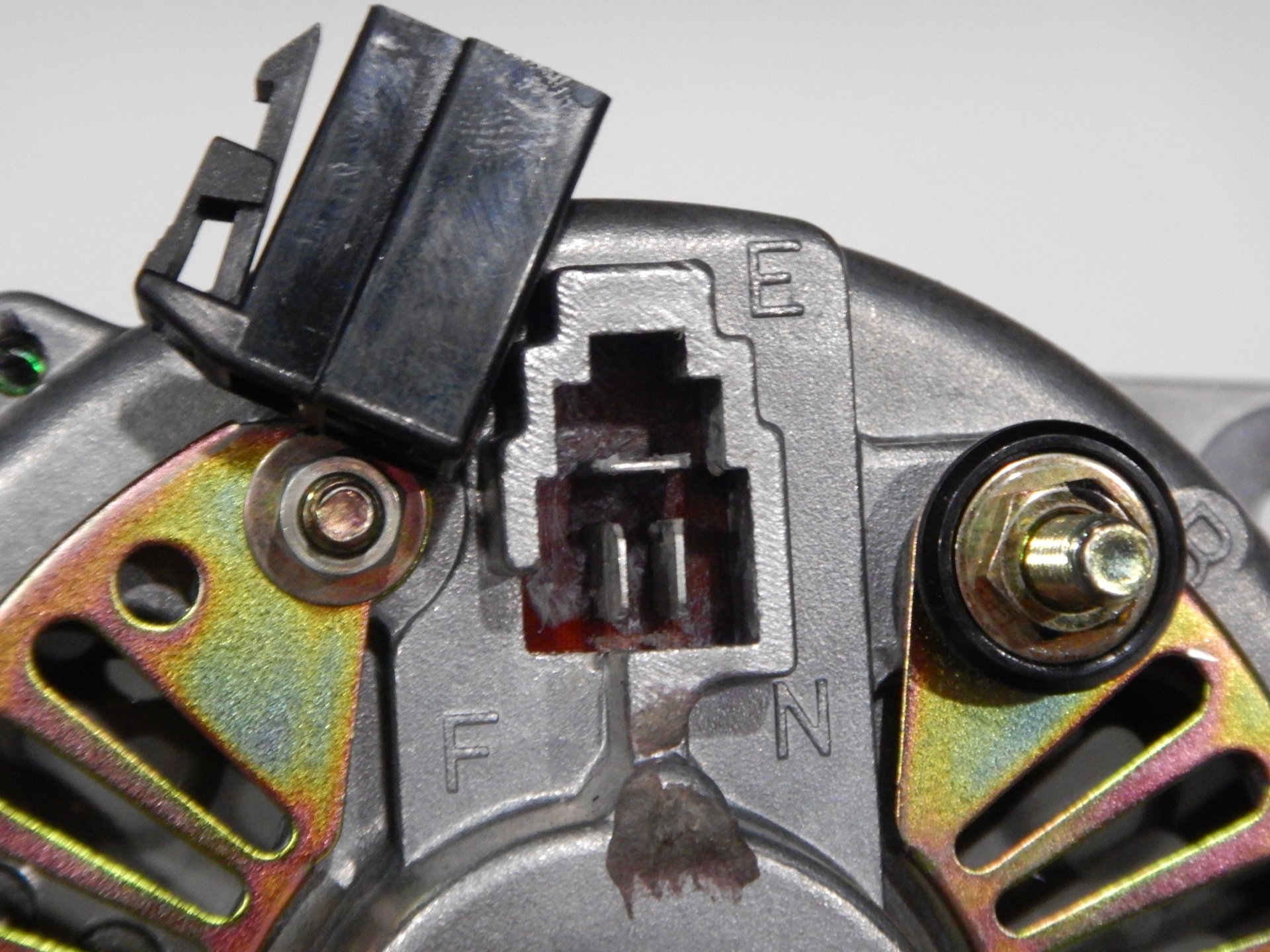

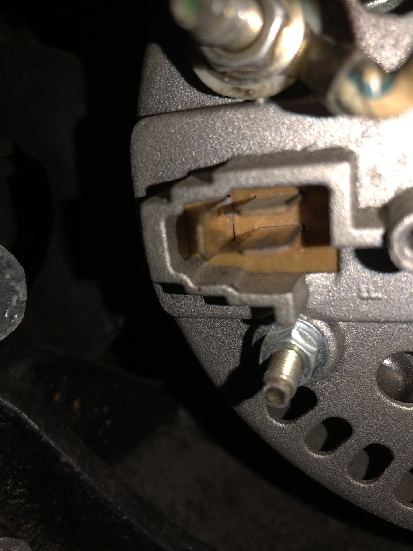

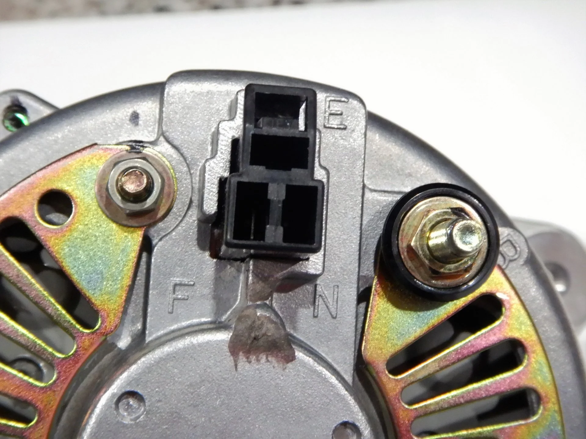

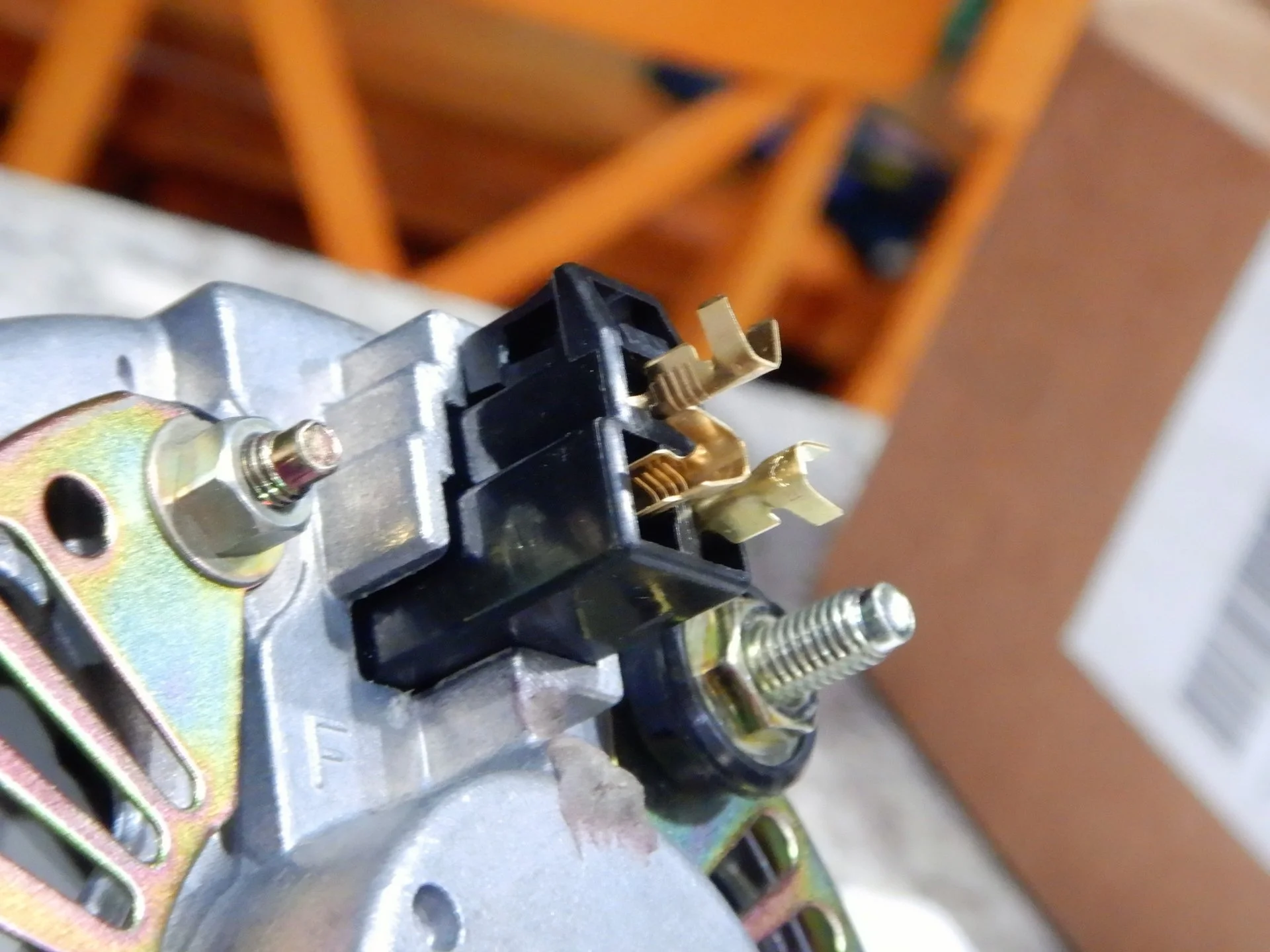

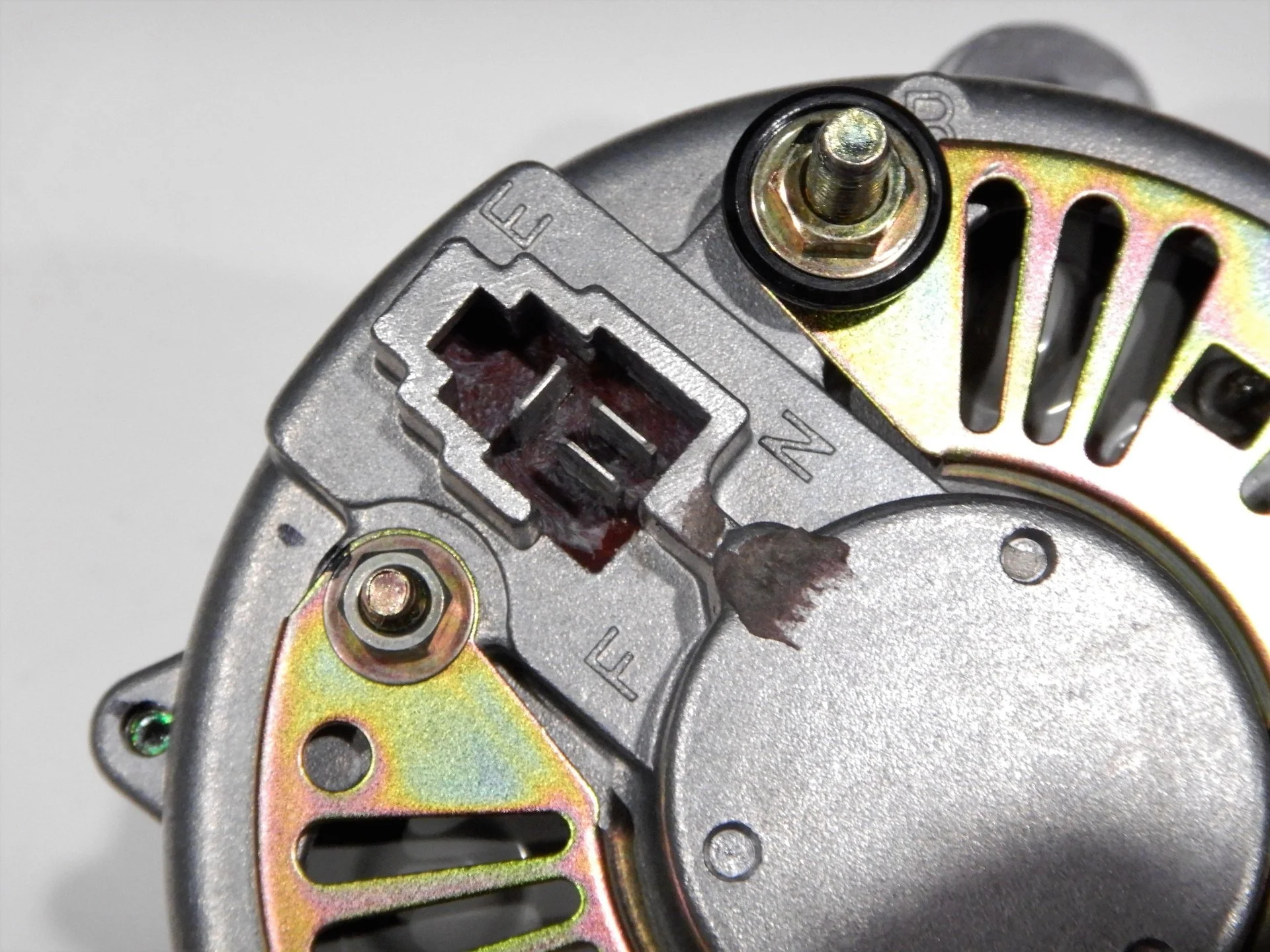

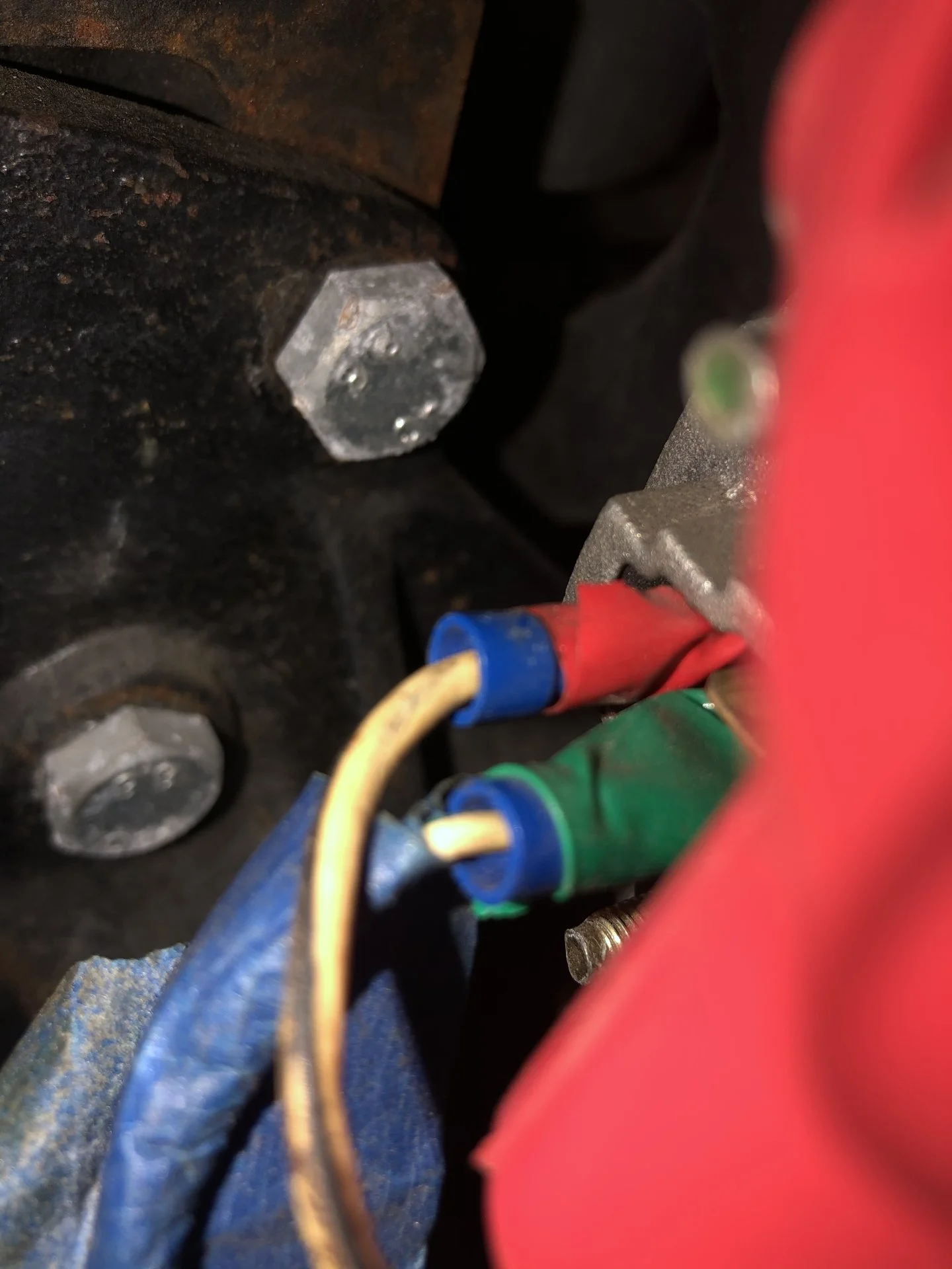

Took a ride on the ”way back” machine this afternoon. Just before taking an extended hiatus in the Land of Nod, I had been working on the world record for alternator/ V regulator swaps in a single thread. Sooo, I took a “look see” at the alternator today, then remembered my field expedient answer to a fractured 3 blade connector.

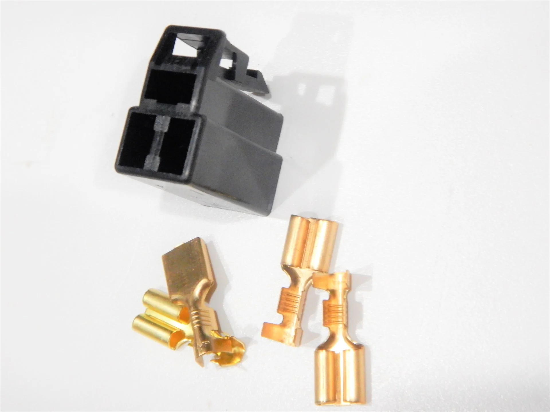

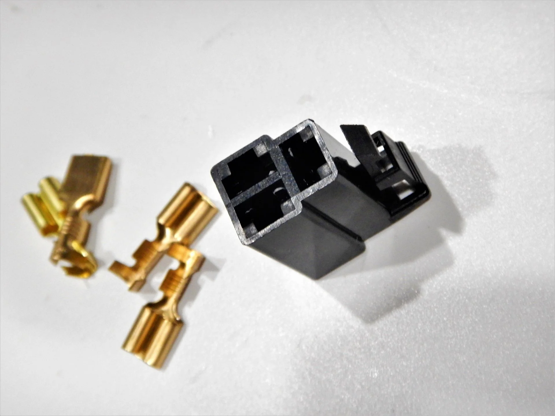

Hoped on over to Vintageteq @ToyotaMatt and loaded up some much needed bits for the mule, IE correct three blade connector.

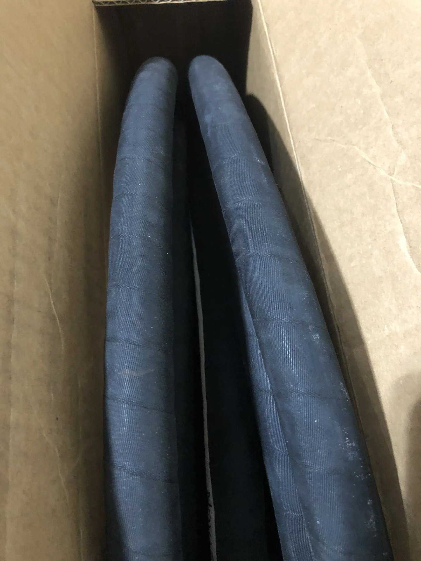

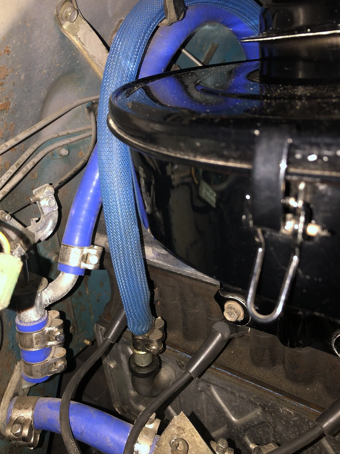

Another chapter from the way back machine. Early on, I found a great deal on some blue silicon high temp heater hose. It worked very well but, it just didn’t fit the utilitarian nature of the Mule. Figure it’s time to update.
So, I found some MILSPEC 4-ply, full wrapped, high temp heater hose to use.

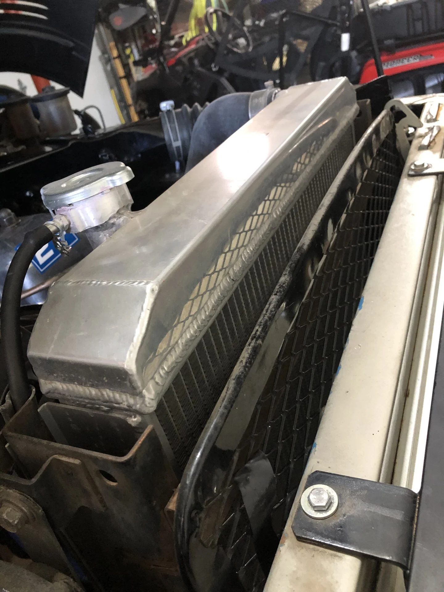

The mule is currently sporting a Champion aluminum radiator. I’m currently looking for a replacement OE type radiator in a 3 or 4 row. Probably paint the fan shroud while I’m at it.
