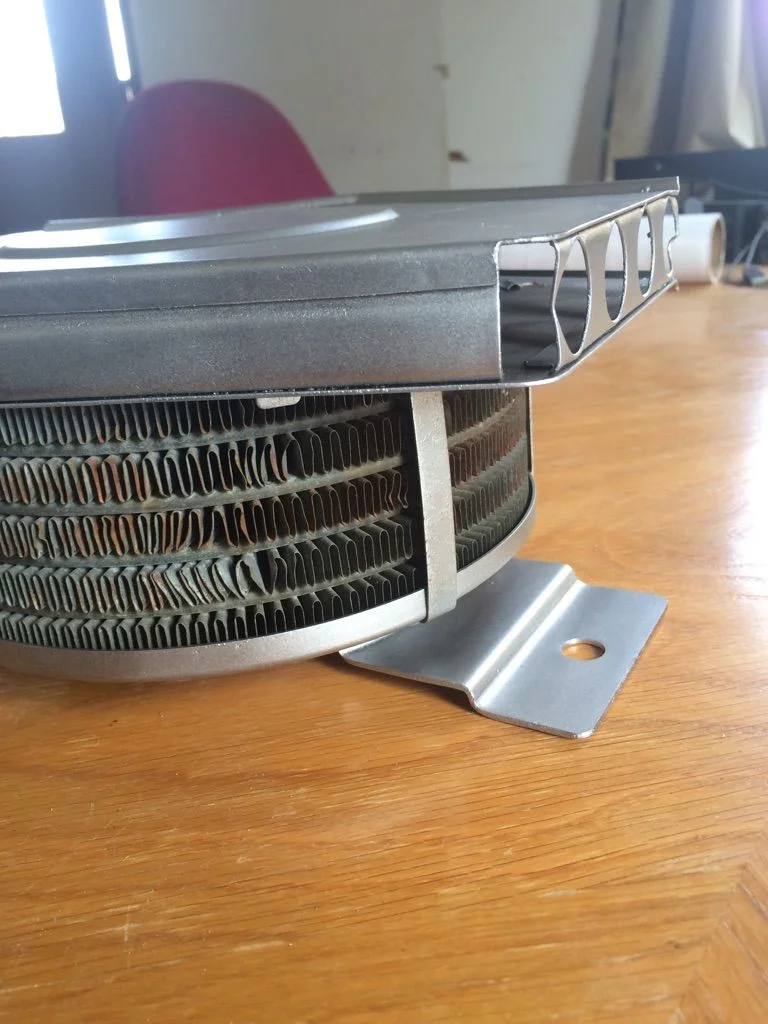

My rear heater core gave up the ghost at some point. Remember the old "flux capacitor"? I disassembled the rear heater motor, cleaned, lubed and tested it. Works perfectly. So I am on the hunt for a new (used) core. I may put the hard lines back in. They suffered a little "transfiguration" removing them from the old bed liner. PO sprayed the liner over the soft foam covering making it near impossible to remove. So, in the spirit of field expedient repairs, I am thinking about running some of the Ven-air silicon hose (yep it's blue) to the rear heater core this fall/winter. I have the rear heater housing with me this week for sand blasting and re-paint.

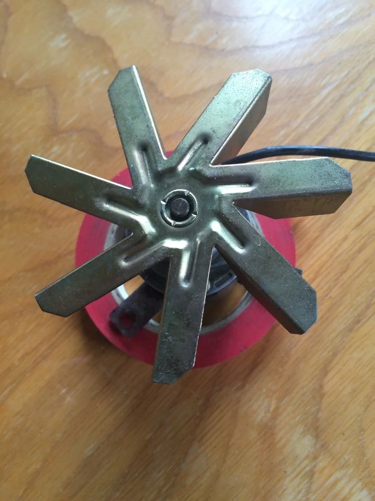

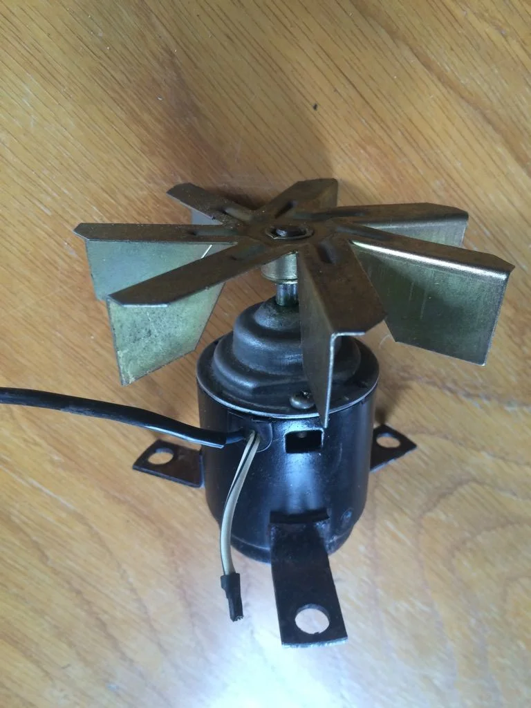

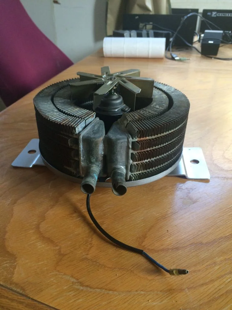

Disassembled the rear heater blower motor. Brushes still looked good. lubed the unit and reassembled. Tested with a battery / all good! The ground contact wire was the only casualty from age. The contact was rusted and disintegrated. I'll add a new one when when I reassemble the unit....

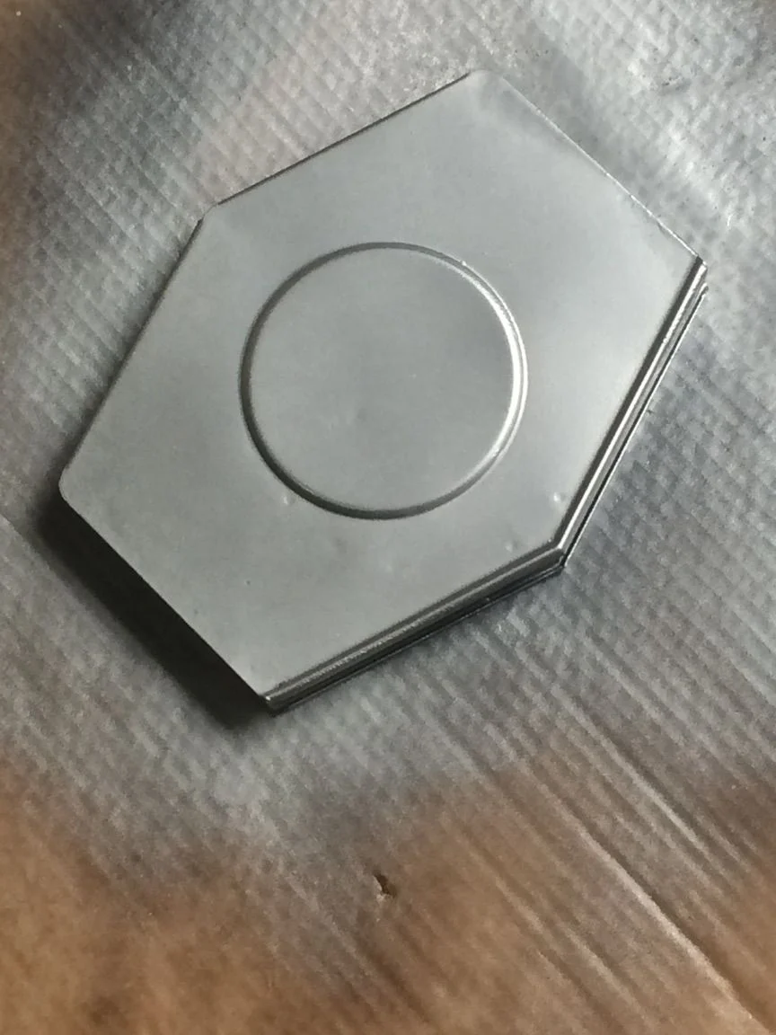

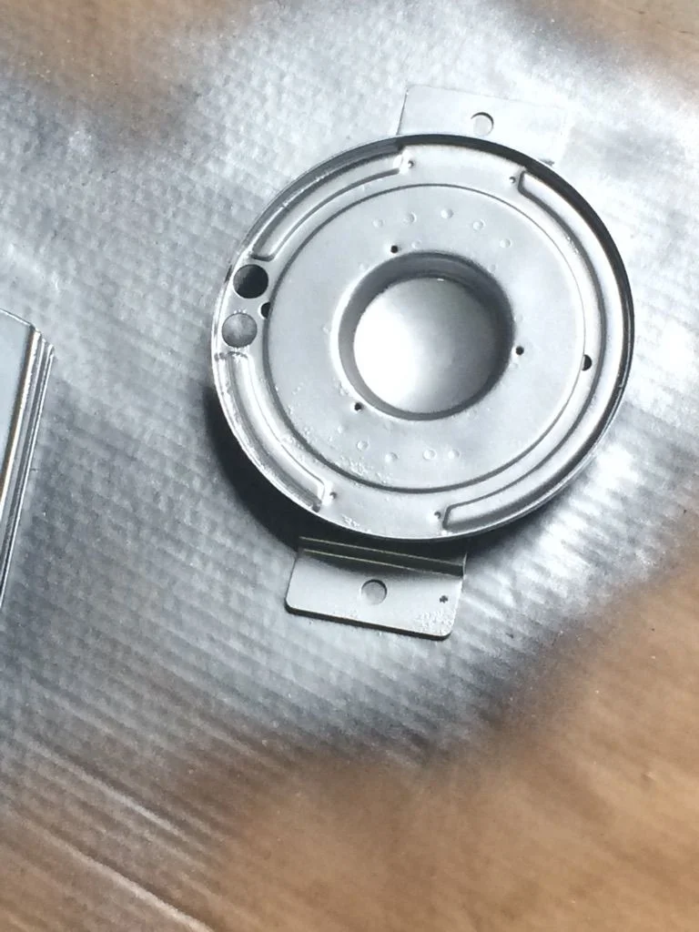

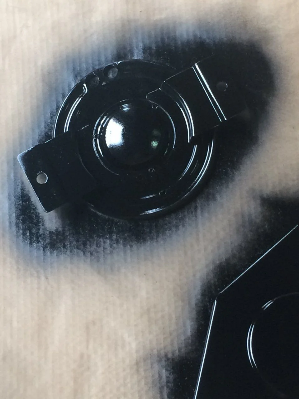

Sand blasted the rear heater housing. Added fresh coat of primer.
1st coat of paint on the rear heater housing. I'll shoot it again in the AM. Have not painted the mounting clips yet. I'll sand blast and hit them in the AM as well. Looking for a heater core. Found one or two for sale but, folks are rather proud of them. $100-$150 for a "tested usable core".....Starting to realize why the old "Flux capacitor" was installed by the PO....

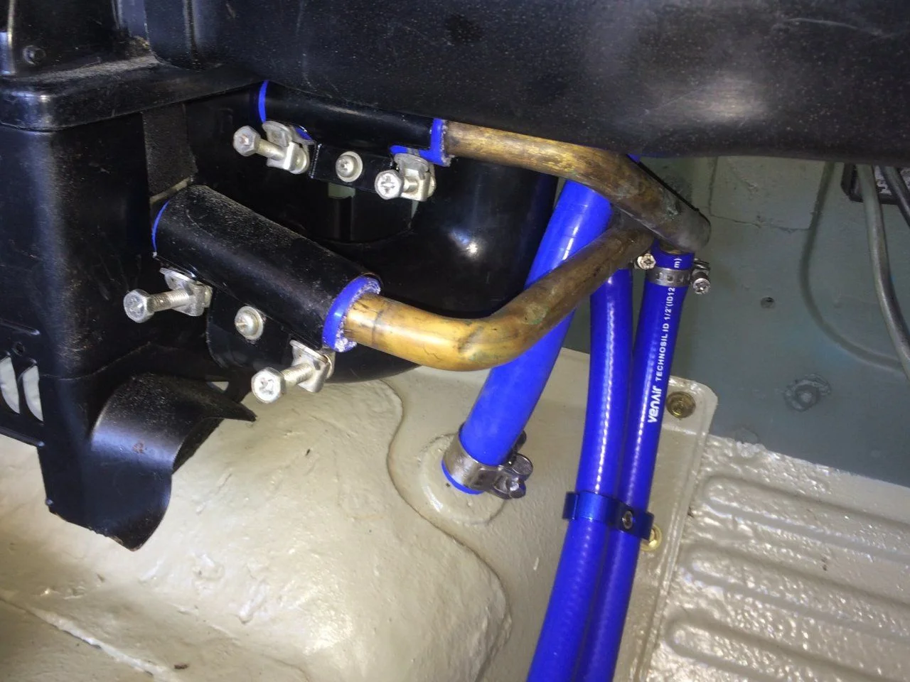

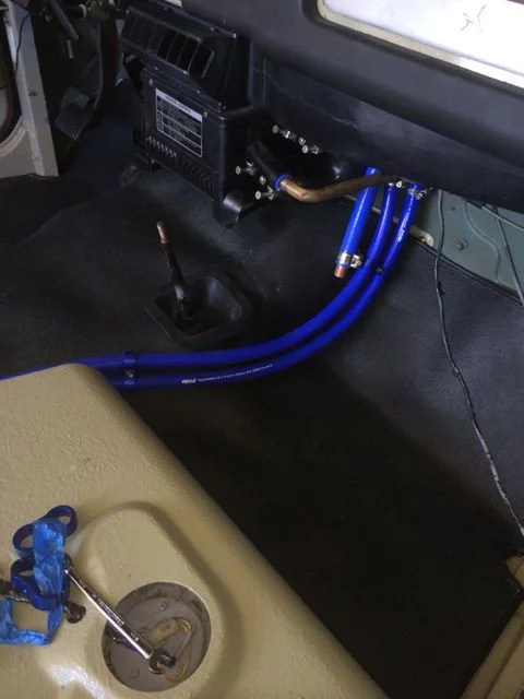

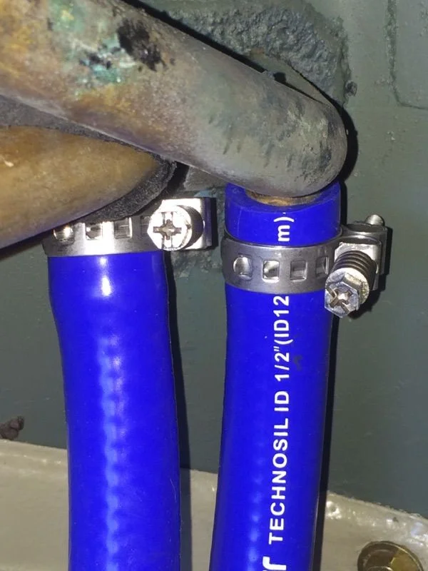

Shot of the stainless clamps I may use on my "silicon solution" to the rear heater core.

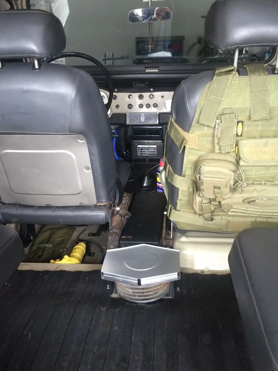

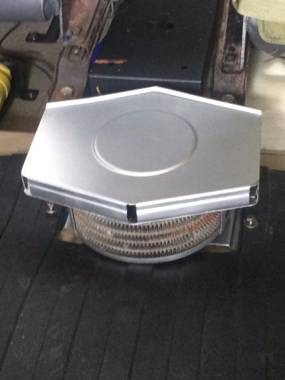

Finished up the re-paint of my rear heater...
My rear heater core is out of commission. But, I used it to mock-up the rear heater. Should have a good usable core next week. Finishing up the interior (relatively speaking). If I can manage the plumbing next week I'll try to work-out some "bay space" IOT install the OME.

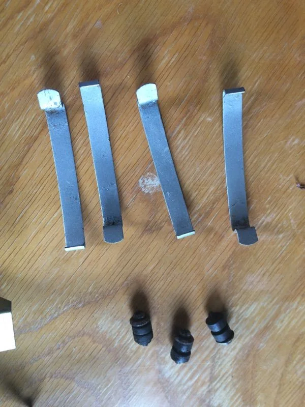

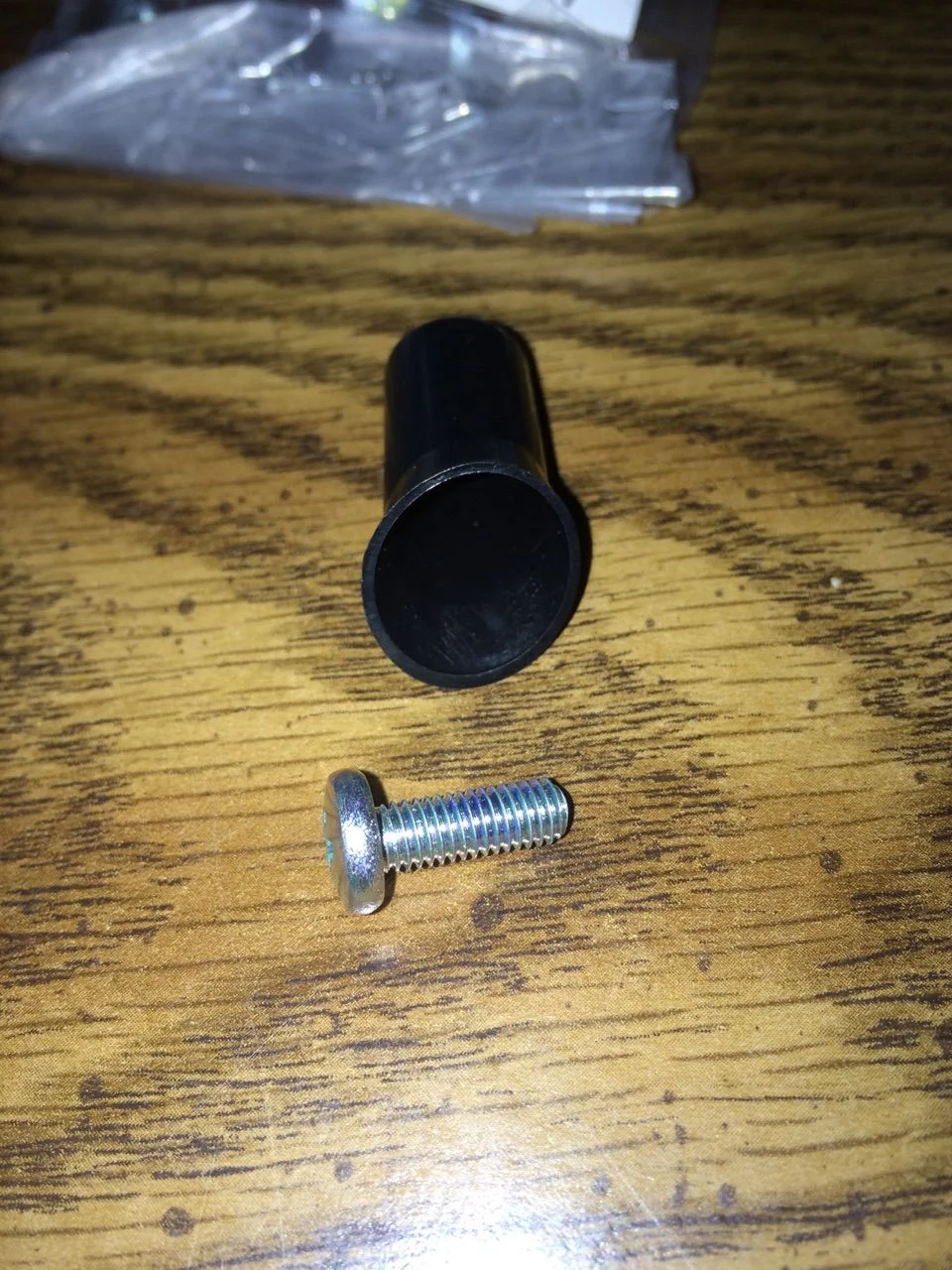

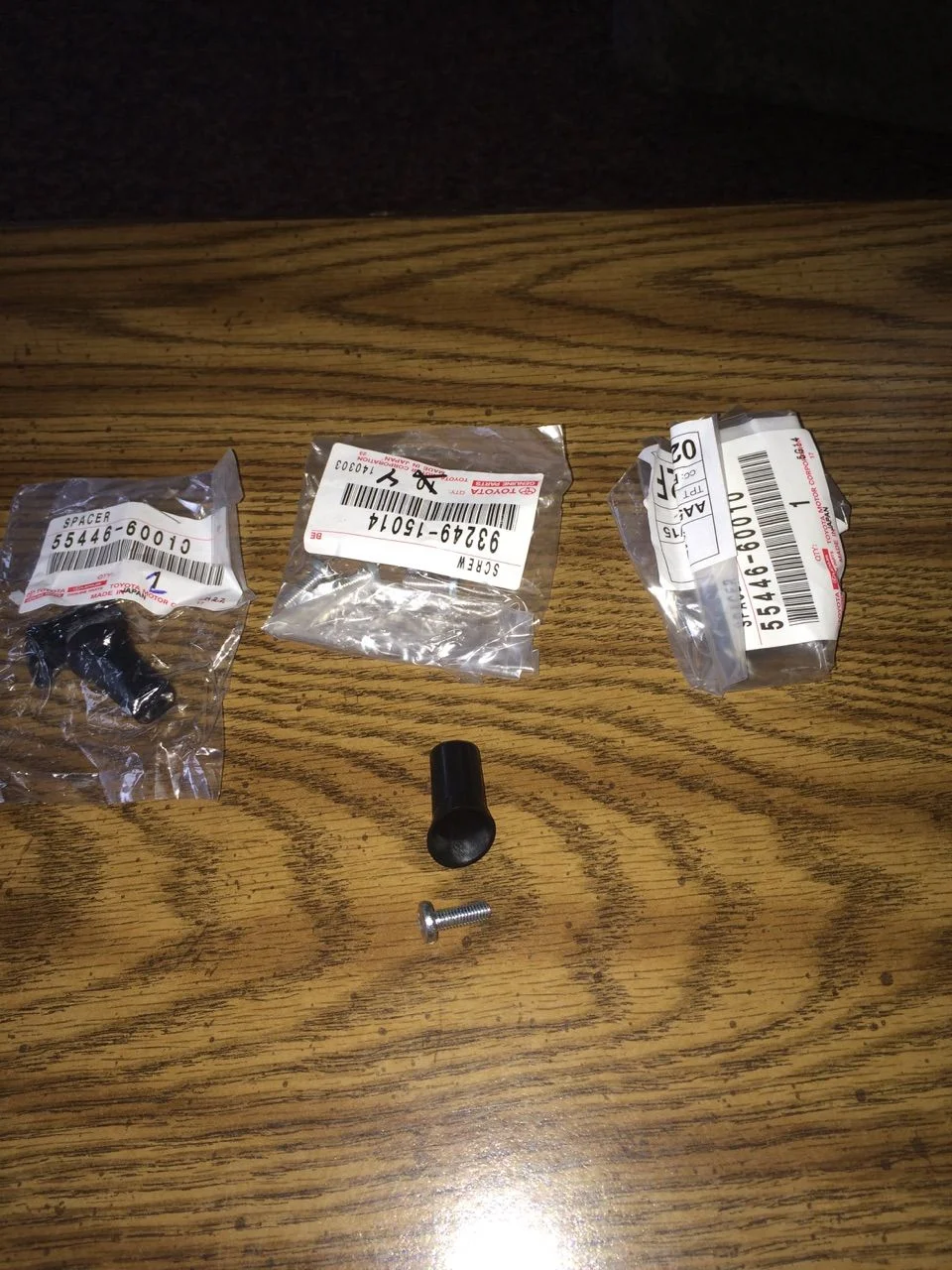

When I "re-installed" the front dash pad, two of the original spacers were cracked and the screw heads were a bit "woolard" (<it's a word ;)). Ordered a new set of screws and spacers for :banana: job later.
