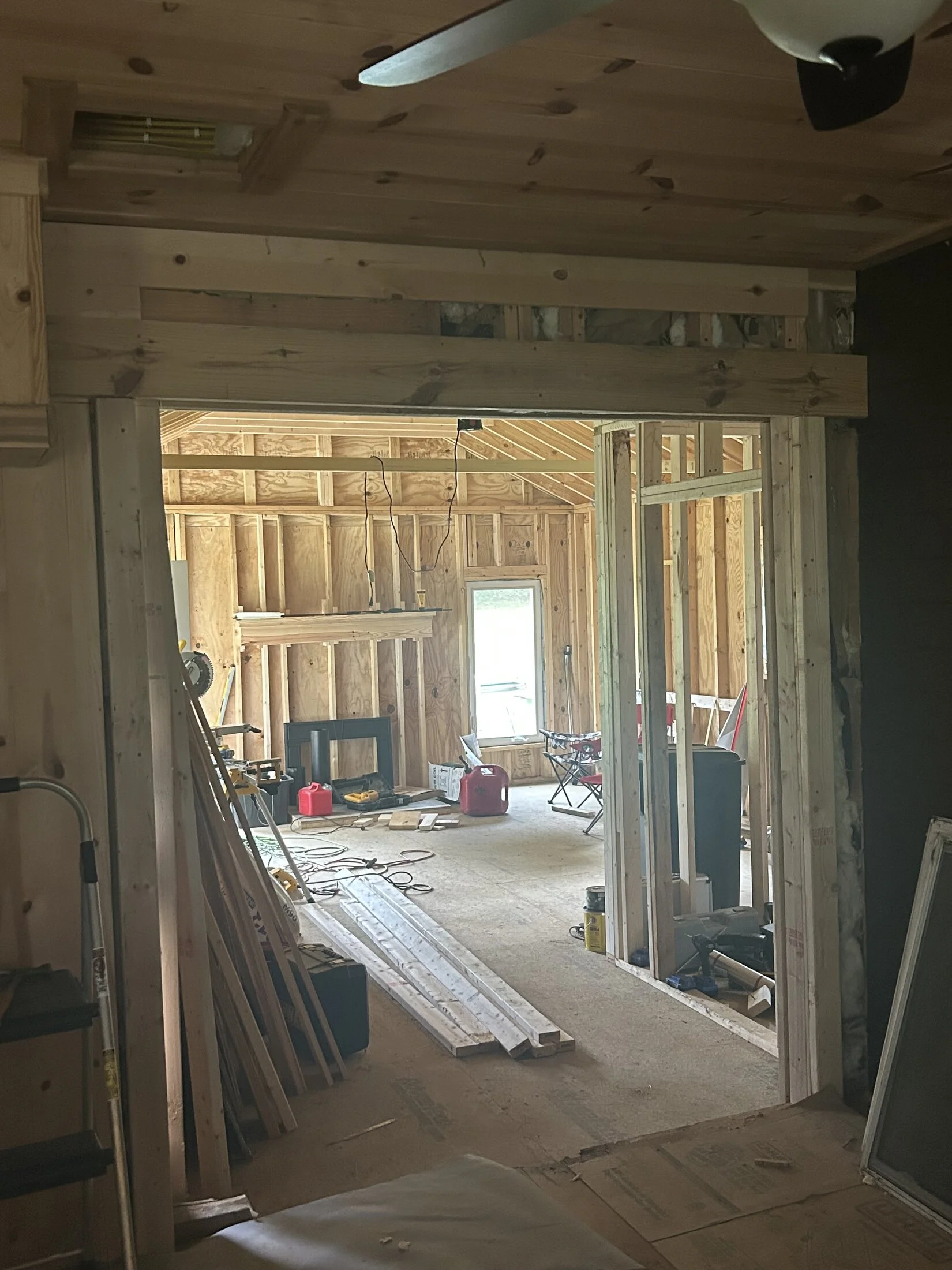

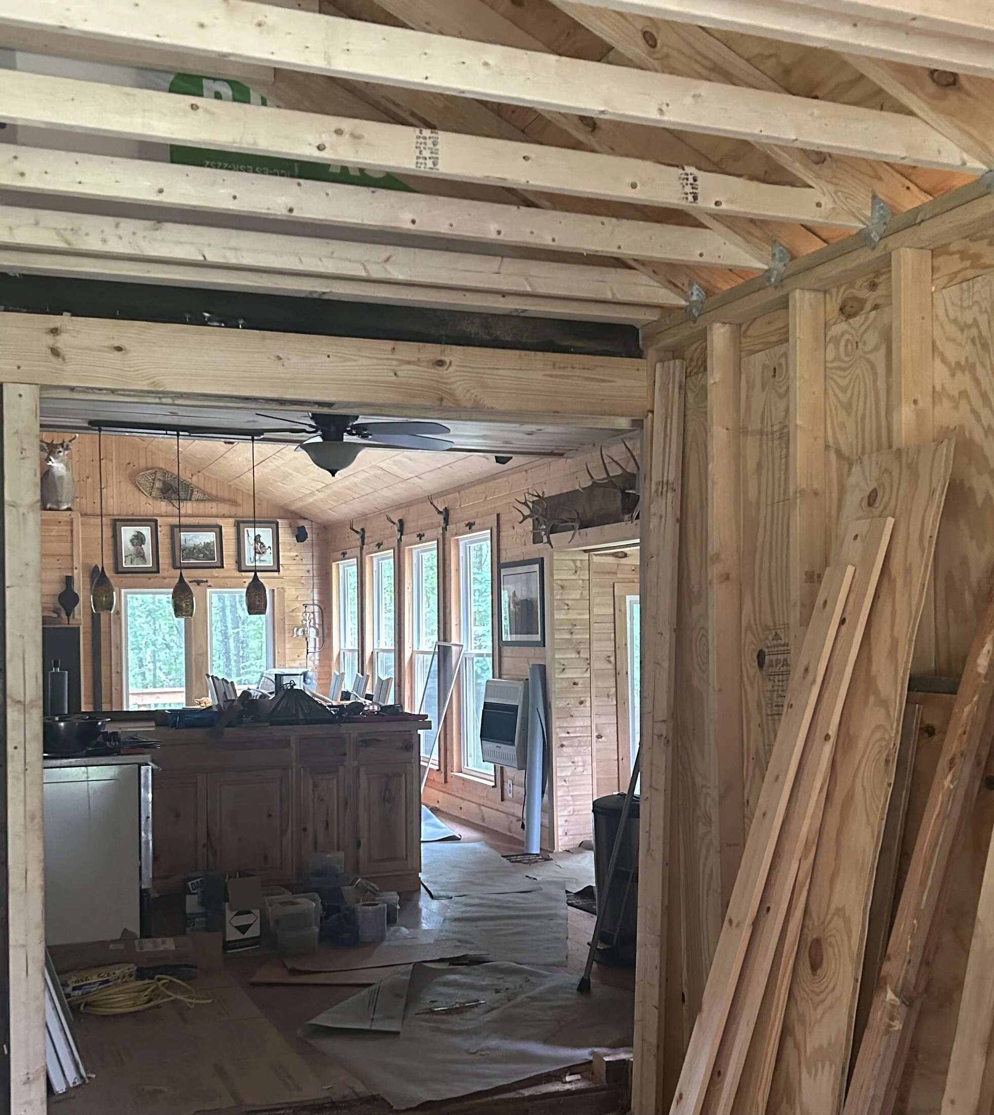

The two halves are one. Old cabin meets new Grand(e) Meade Hall. Joining header added. This ties the old and the new together (in theory 😁). Geezer buddy is doing geezer things, so I’m one offing it. Translation = I’m low and slow but making progress.

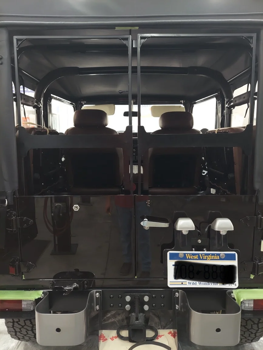

Slipping in a pic of the one off “Ambi door removable frame” in full regalia, just to keep it tech for those who follow this thread for rare insightful tech tips.. :rofl:

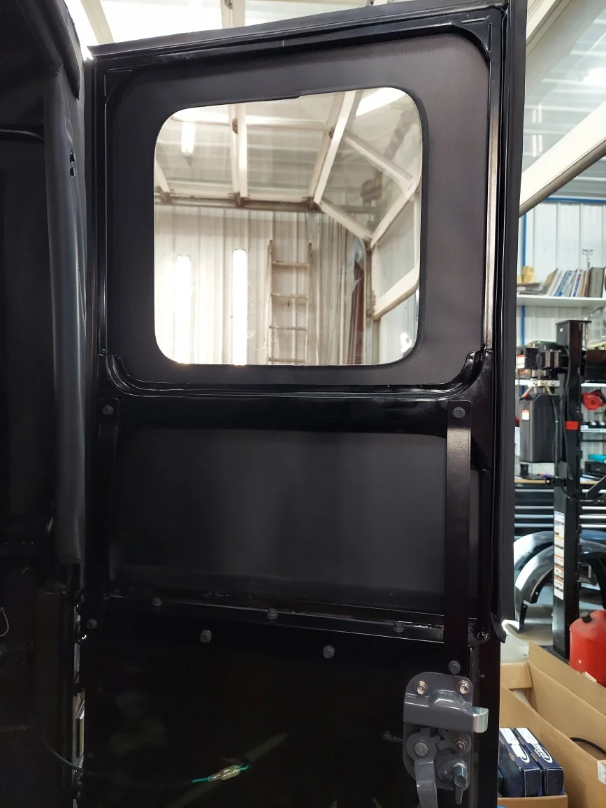

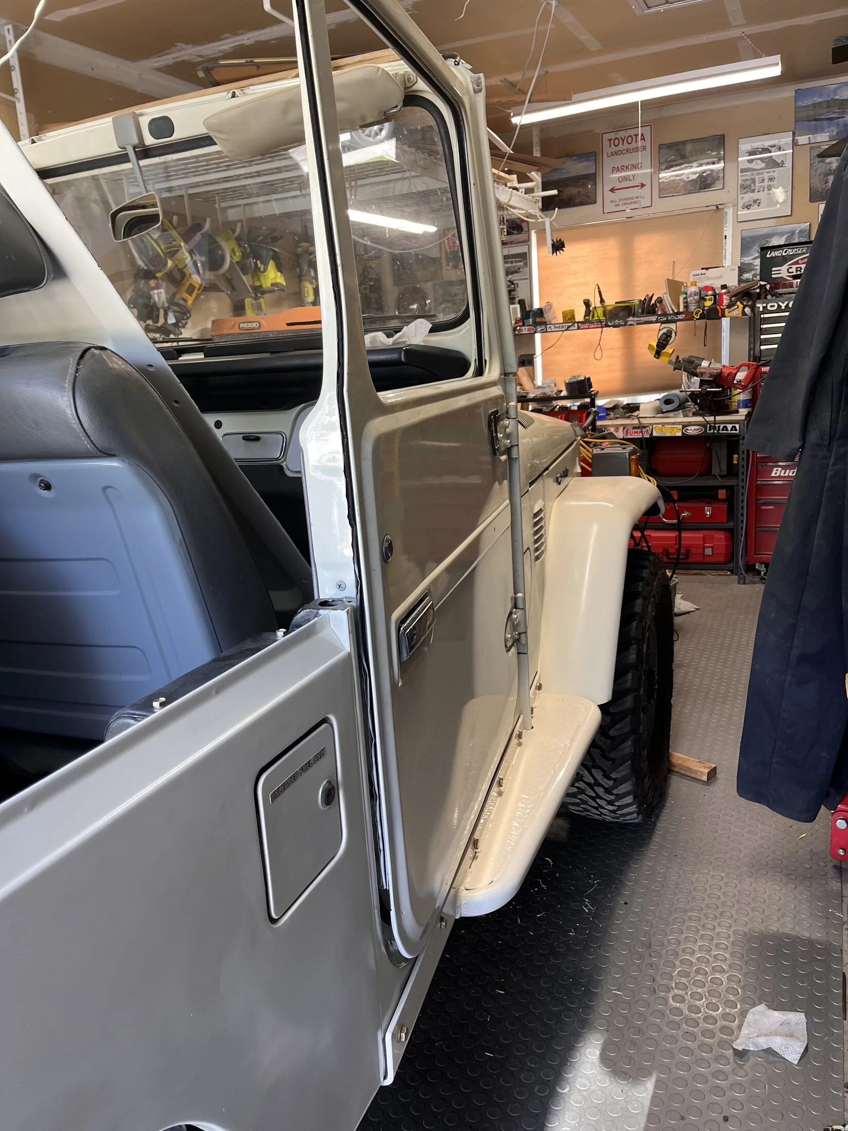

Prerequisite, and I think unique to a soft top ambi door. This is the removable portion of the door. One of the “must haves” in early discussions…
Twiddling my thumbs this AM before I go lumber shopping.
Mating the Canadian doors w/the Colombian frames and making them convertible required copious amounts of head scratching. Toss in OE hinges and hardware and it started to look like a Chinese algebra problem.
Following the Laws of Continuing Upgrade Physics EG, for every mod there is an equal and opposite upgrade problem to solve. The rear doors were no exception. By adding the must have convertible variable into the equation, upper frame stability became an issue.
The vertical braces were added IOT limit flexing/stress on the aluminum lower door(s). 10 minute job to fully remove the upper doors.
Edit: Vid shows the OE hardware and the solid lockup.
That is going to be awesome. Removable rear door tops should've been mandatory from the get go. Someday I hope to be tempted to set my beer on the fender.
100% 👍🏻. I wanted to be able to roll up the sides, yank the doors, pull off the Ambi’s and still have a functioning tailgate.
Many beer rings will bear witness to the telling of the tale(s)…🍻
I was jealously watching the 2 fingers to close the tire carrier latch, then I remembered you added the "thru-door" stabilizer.
It’s not just my playground humor that thoroughly enjoys the new mechanism. It really is functional. 🙄

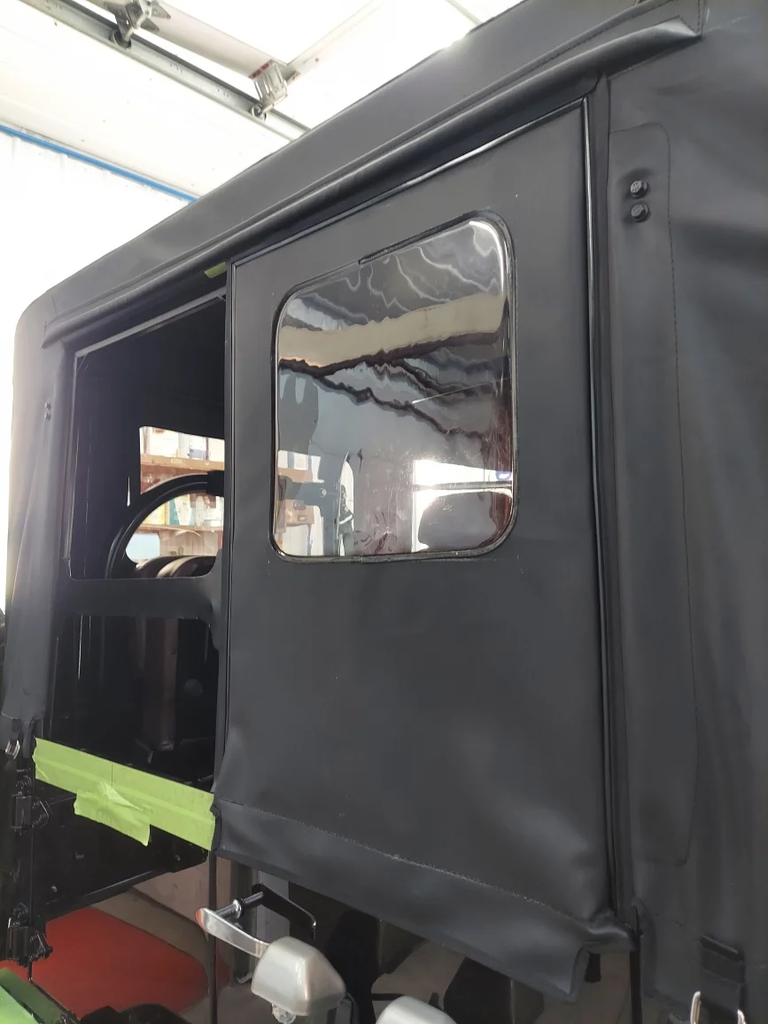

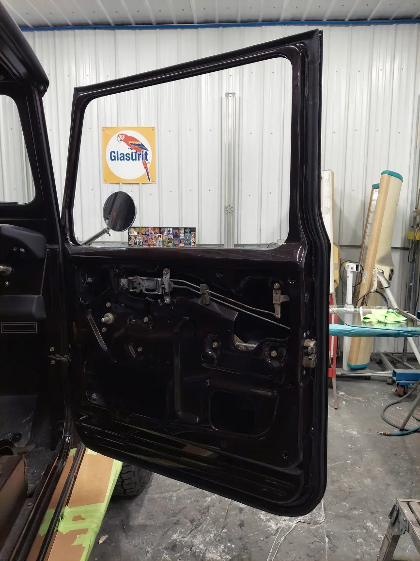

Door seals going on. Should drop the decibel level down to a dull roar and keep most of the moisture out. 😉

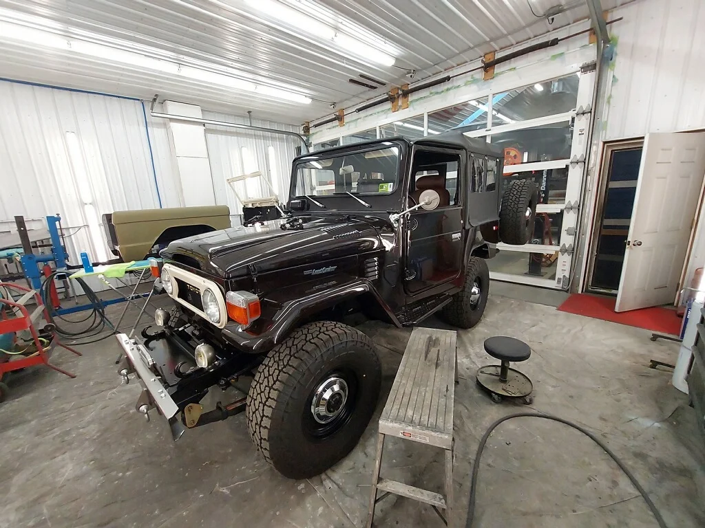

What do you do while you’re waiting on parts? Detail and wax.
@RevISK Good shot of the fit and finish of the soft top. Waiting on a clear day to get a photo in the wild. Fluorescent shop lights give it a charcoal vibe instead of a deeper black.
Thumbs up again to Alex and Dan at Alexander Restorations @Atram for working through my puddle of ideas. You guys really pulled off the “what if, why not, can you do this” Innuendos. And, your out of the box work arounds are 1st class. I’ll see you at the Amelia Concourse next year!!! 😎 1st rounds on me..Ok, maybe 2nd and third round too. Who am I kidding, it’s on me… 🍻

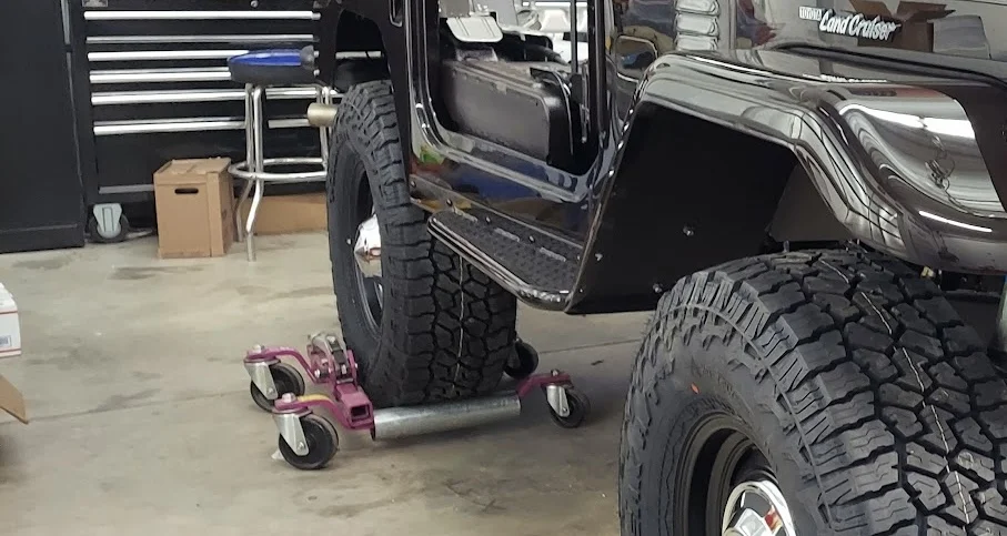

Are your running boards body color or black?
Are you happy with those Dollie’s? Been seeing them more and more. Thinking still of getting a set
Those belong to the shop. But, from watching how easy they are to maneuver, I’d say it would be money well spent.
