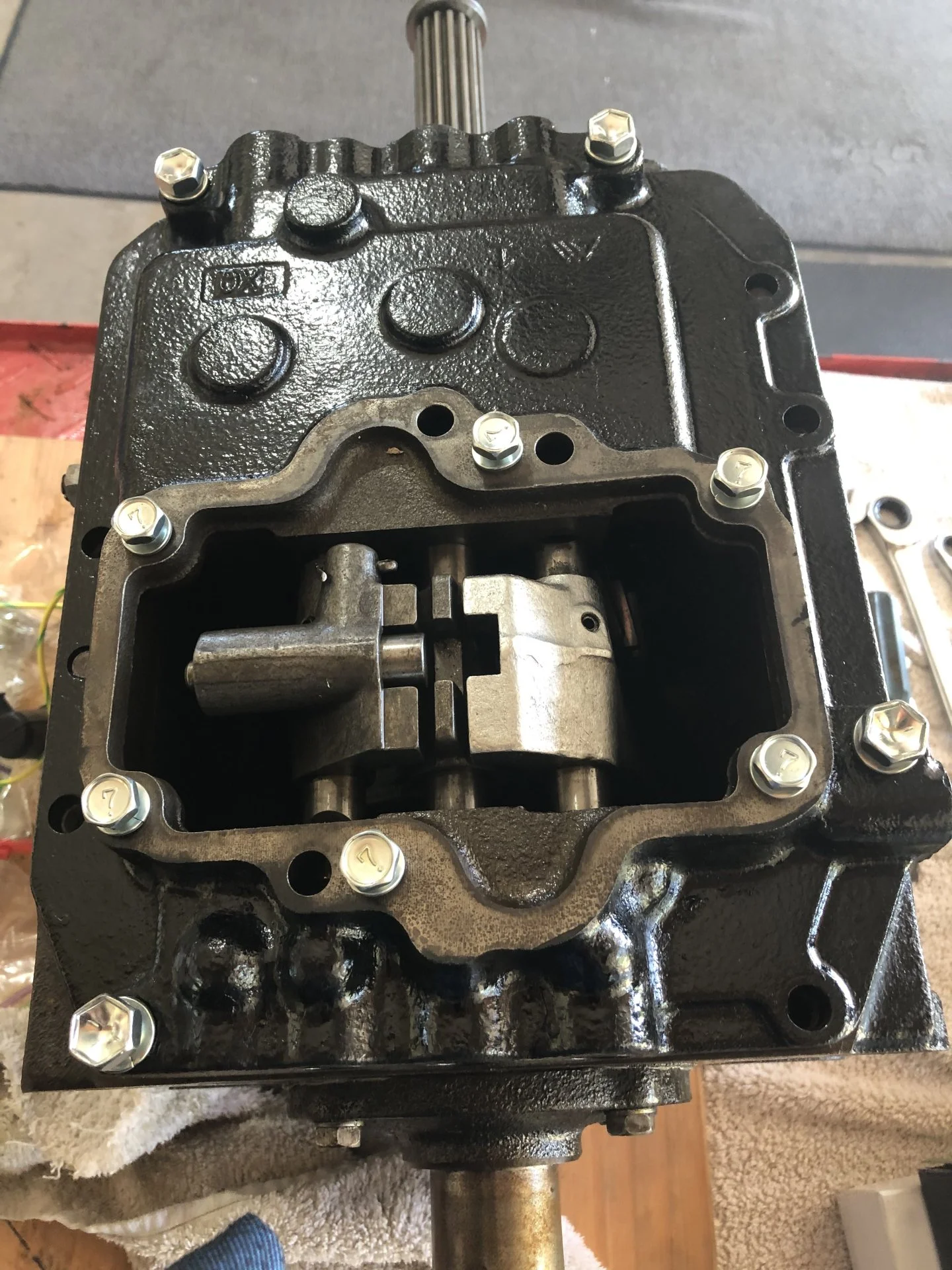

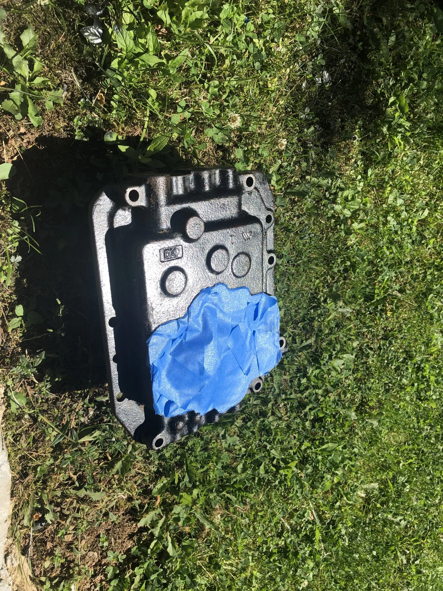

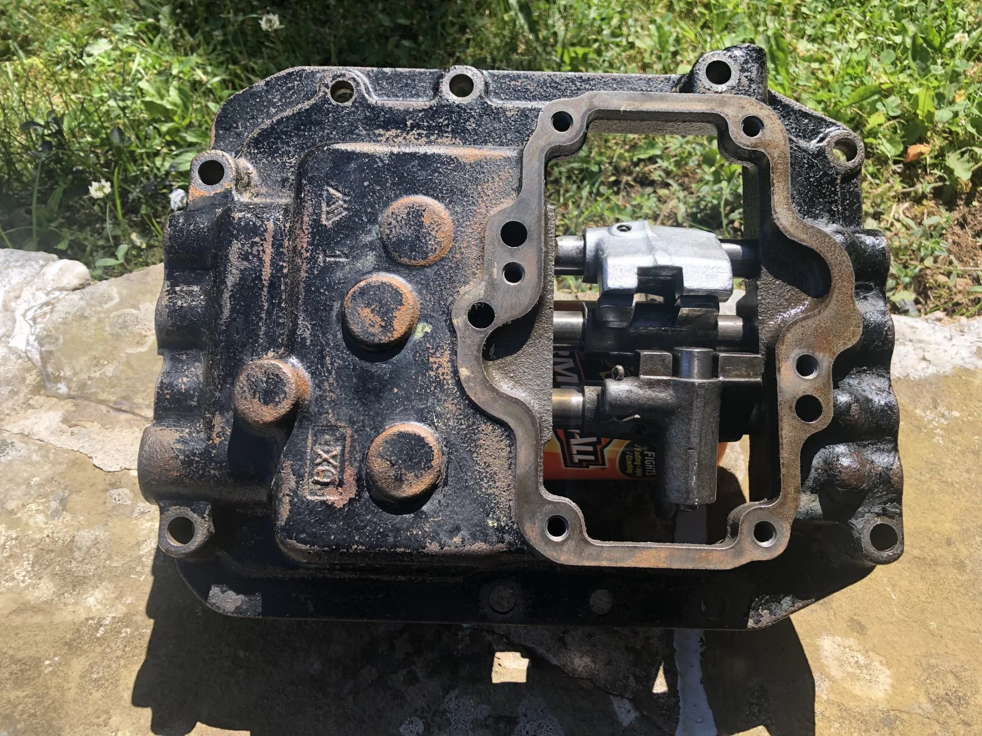

Rattle can rehab turned out OK. You know the routine. Before/After. @TeamJB
Clean/treated/painted the top cover on the Trans.
Before/After.
The remaining hardware is inbound so I should be able to button it up in the next few days.

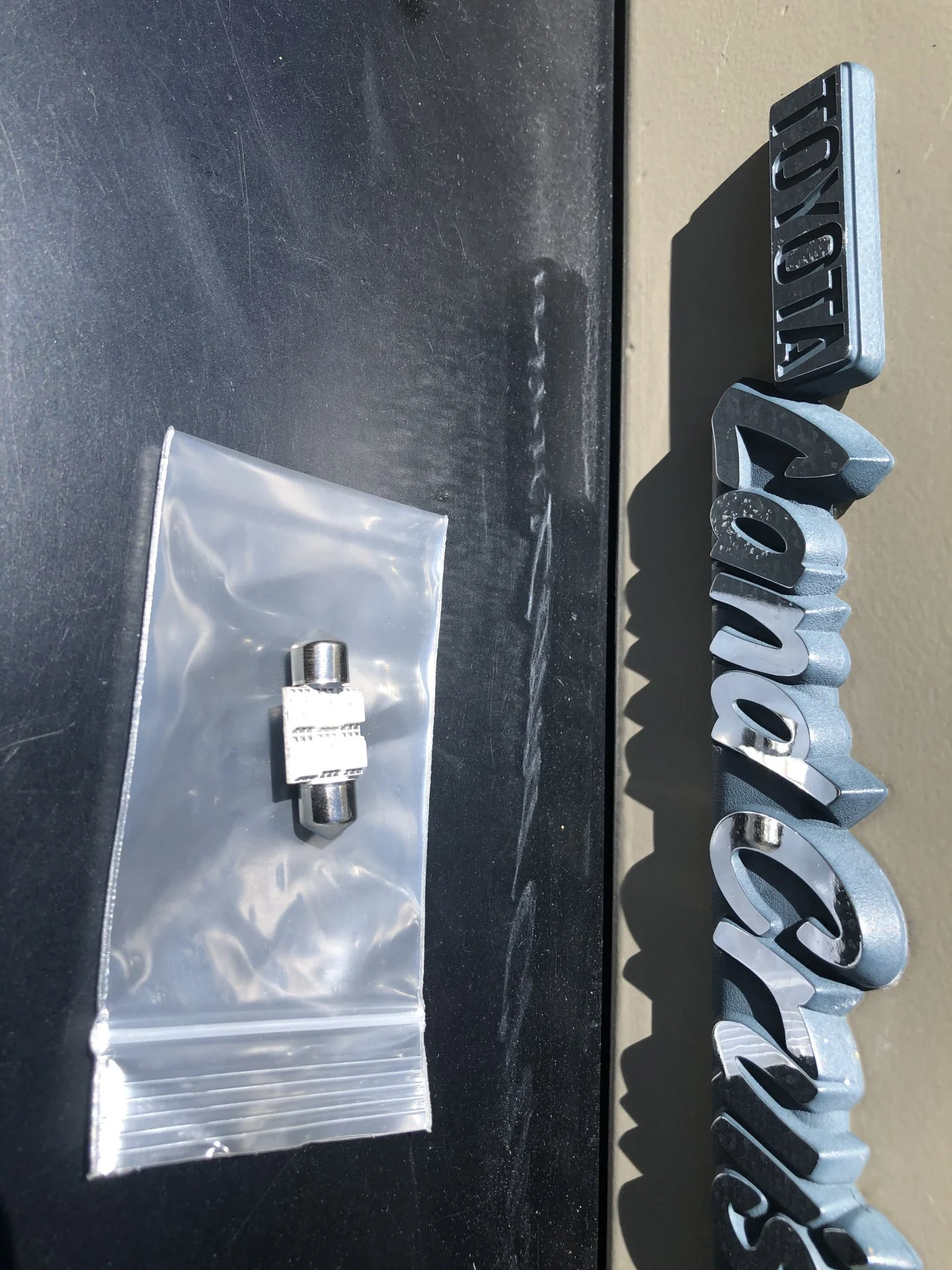

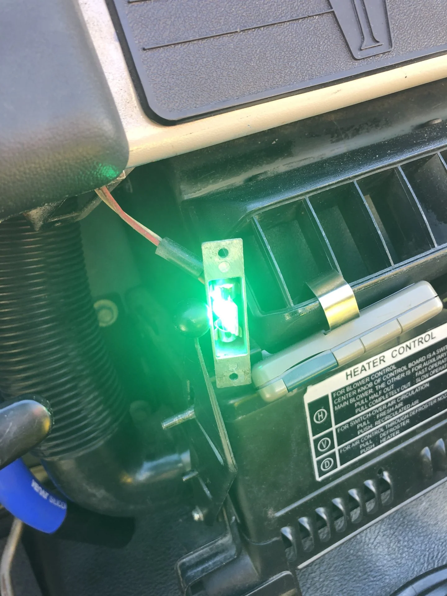

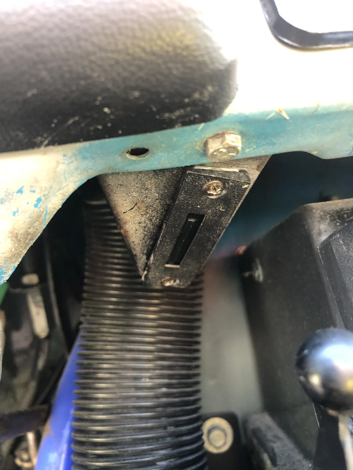

Switched out the bulb in my under-dash light to LED. Tested during full daylight. Quite a bit of difference. The last pic is with the lense in place Light off. I'll try another pic later to see what it looks like in low light conditions.

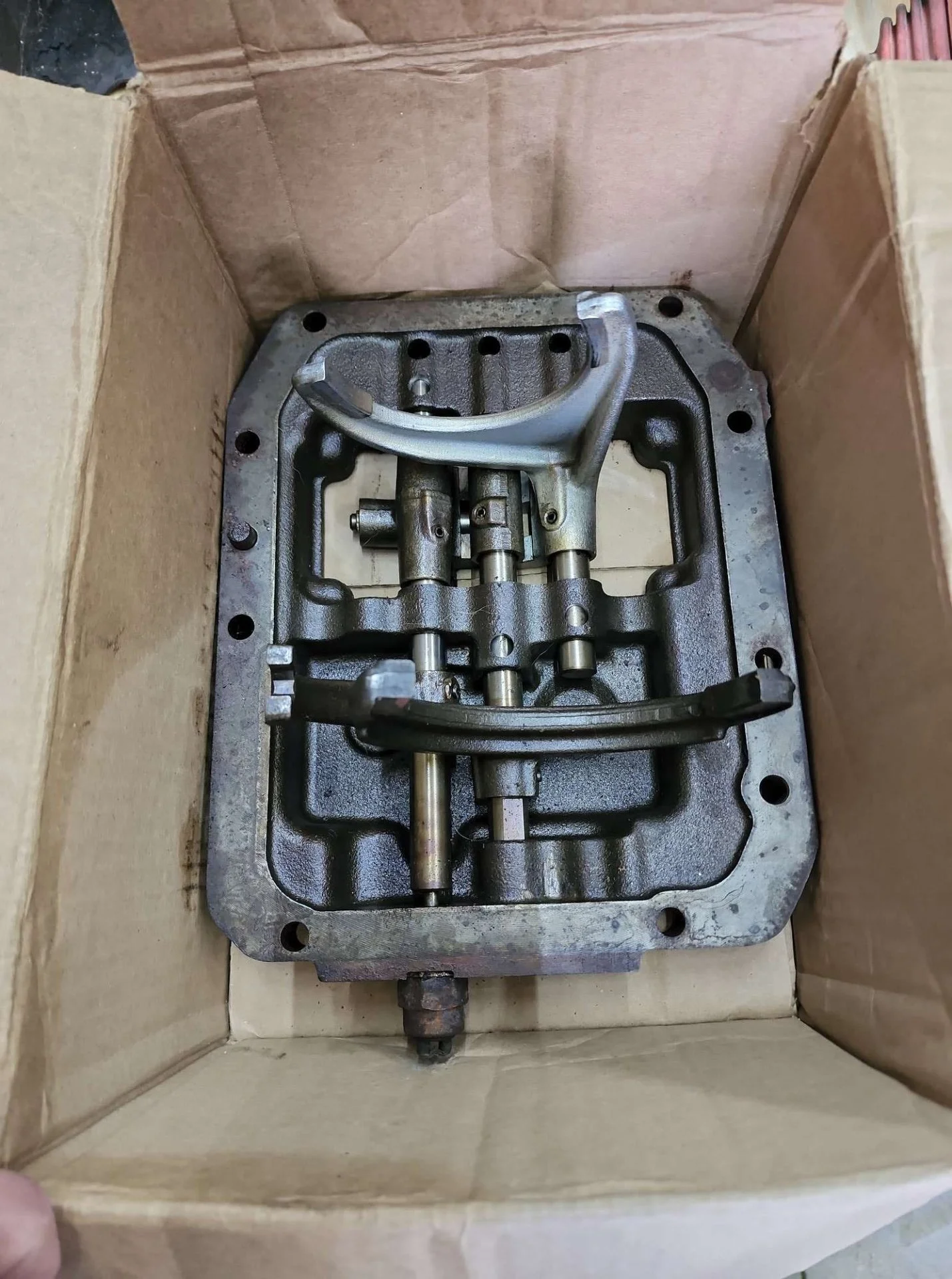

UPDATE: I found a set of metal bottoms for the front turn signals to rehab my old ones. I wont need the left turn signal after-all. Also found a shift tower for the 4-spd.
What I do need, if you have anything in inventory, is the 4-spd linkage. REF up a couple post and you can see what I do have. I'm looking for everything else.

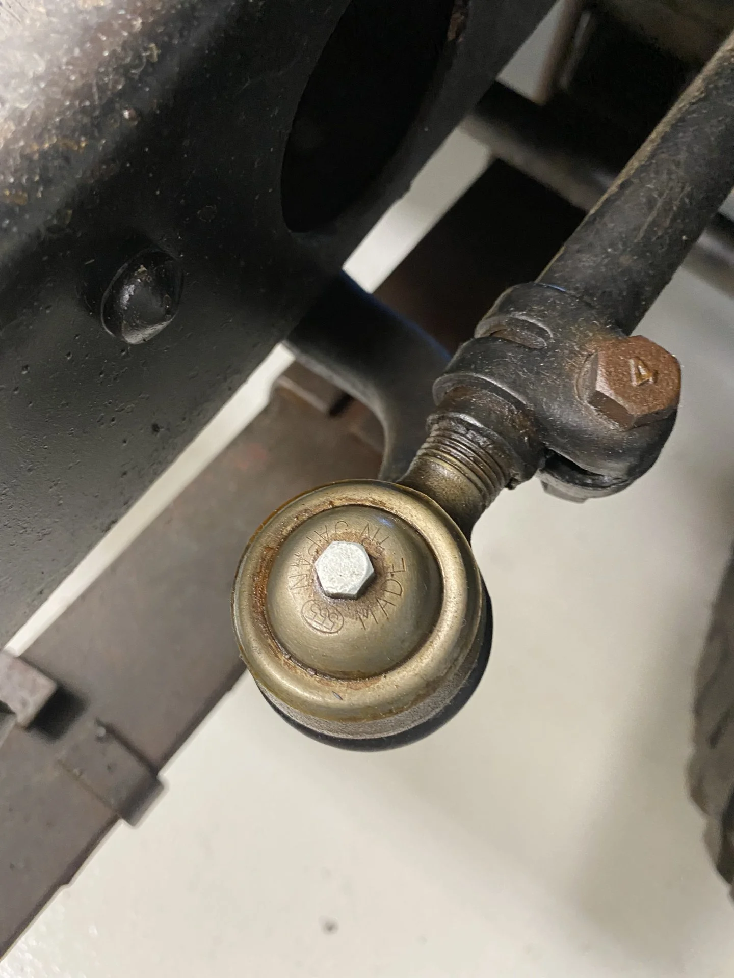

If your looking for a better way to protect those parts. I have a suggestion. It doesn’t smell like stinky snatch fluid film and especially if your going to hide it in the closet you may get into big trouble. One who is un-named may think your hiding a girl some whereabouts. @Jdc1 and I use a product call Boeshield T-9. Backstory is Boeing developed it for their large castings they store outside in the PNW. They wanted something they could spray on for protection but that could be removed with a strong detergent when they wanted to weld on it. It works well, is safe on paint and plastic and can be removed using dish soap when you want to paint. It can be purchased by the gallon on Amazon. It’s pricey but it goes a long way. Don’t forget to get an upside down spray bottle so you can put it everywhere. I use it on my frame and exposed metal all over my truck. It dries to a mat finish. I included a quick pic of one of the tie rod ends I sprayed like 3 years ago. I just recently cleaned up my truck and hit it with a blue scrubby and reapplied the Boeshield

How does it hold up on your undercarriage?

Unlike the sheep oils, it is on there until a solvent is used to take it off. It also creeps better.
Here is a pic of it as a fresh application last week. Because I used soap I just misted it again. We’ve been using it for like 5 years and doesn’t seem like any new rust at all
