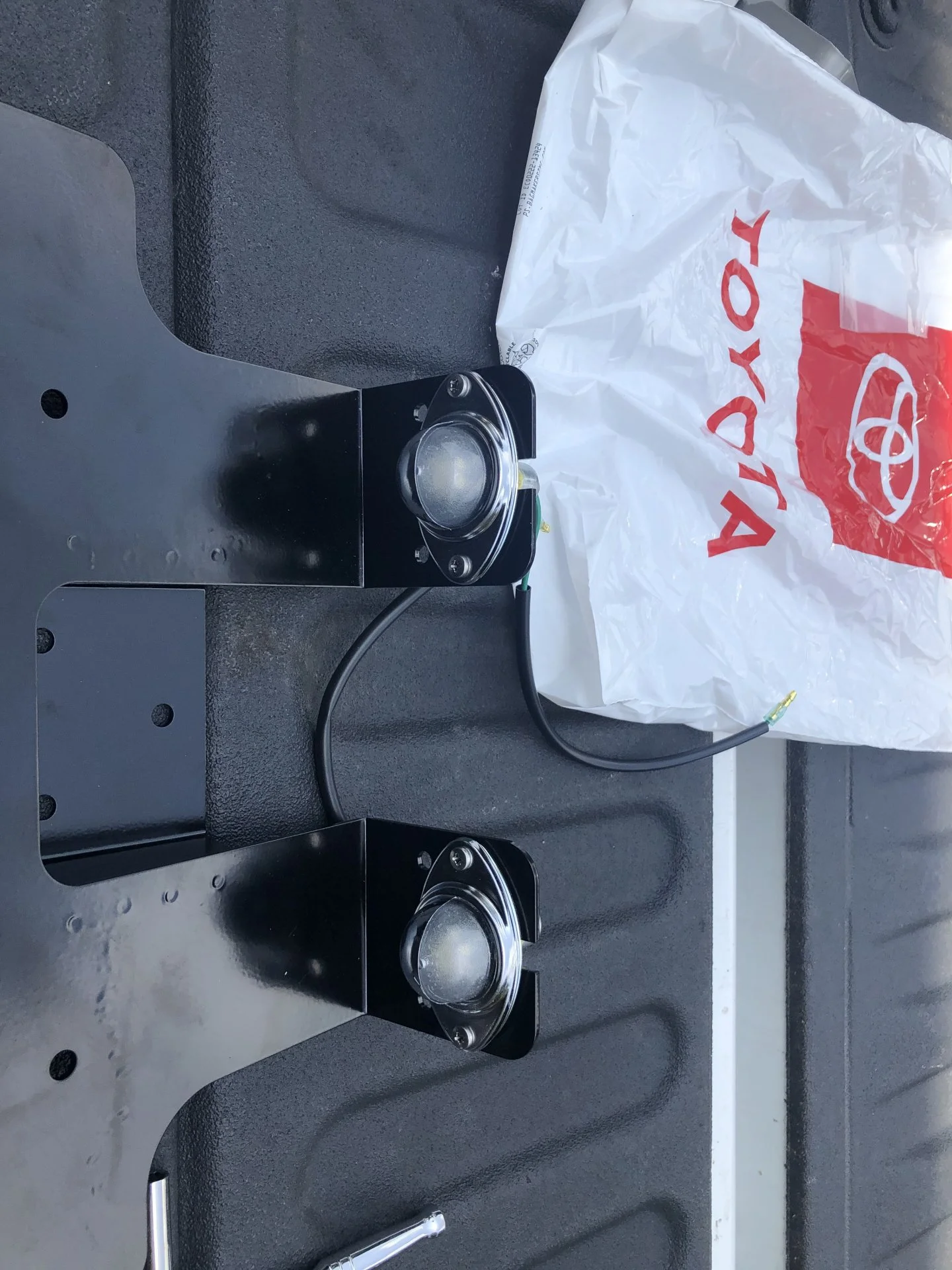

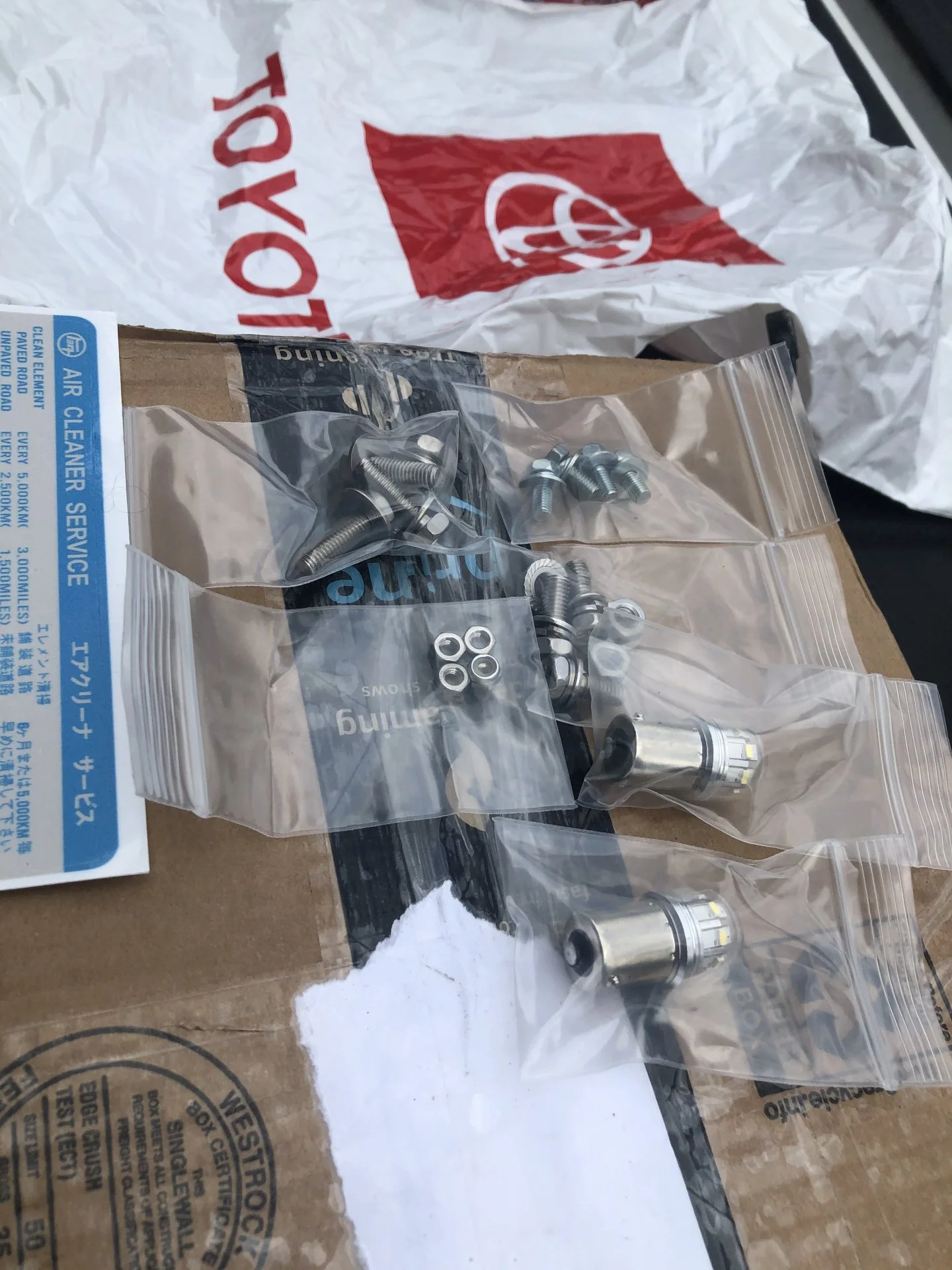

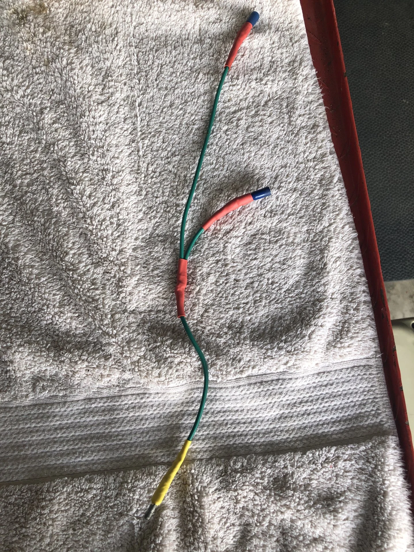

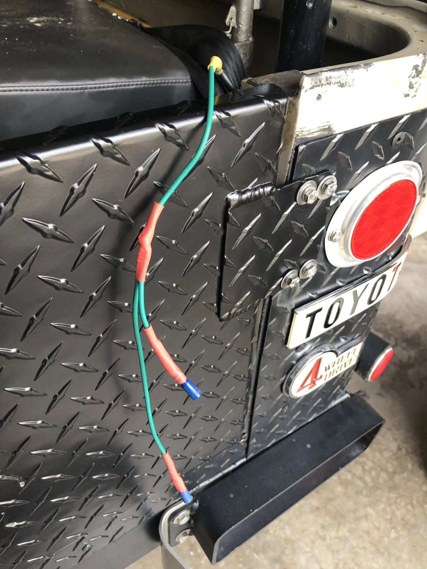

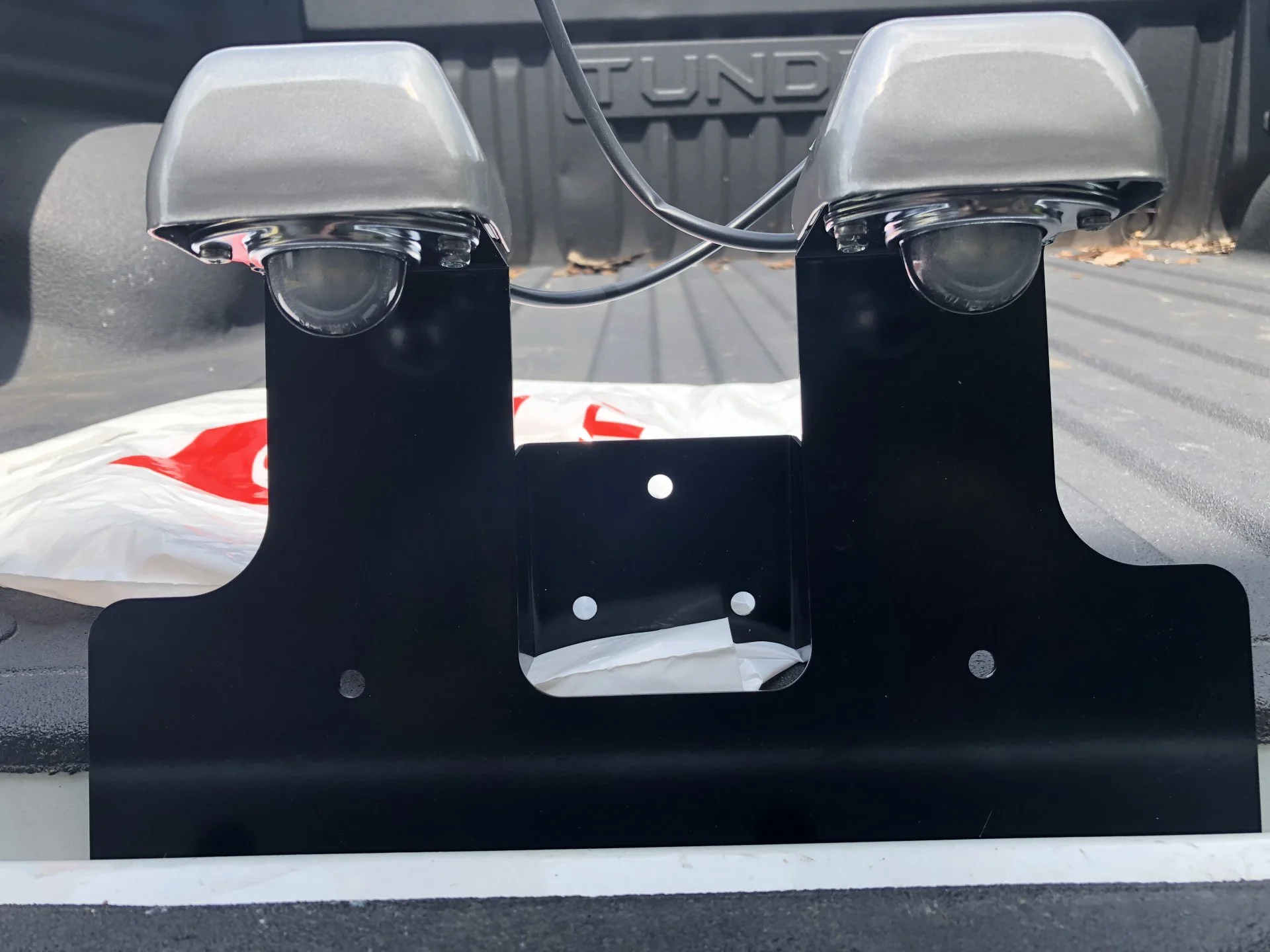

Care package from the world arrived today. Many thanks Mijo. It was just what the Mule needed. The LED's really light up the stern of the SS Mule. I'll post up some pics of the install.

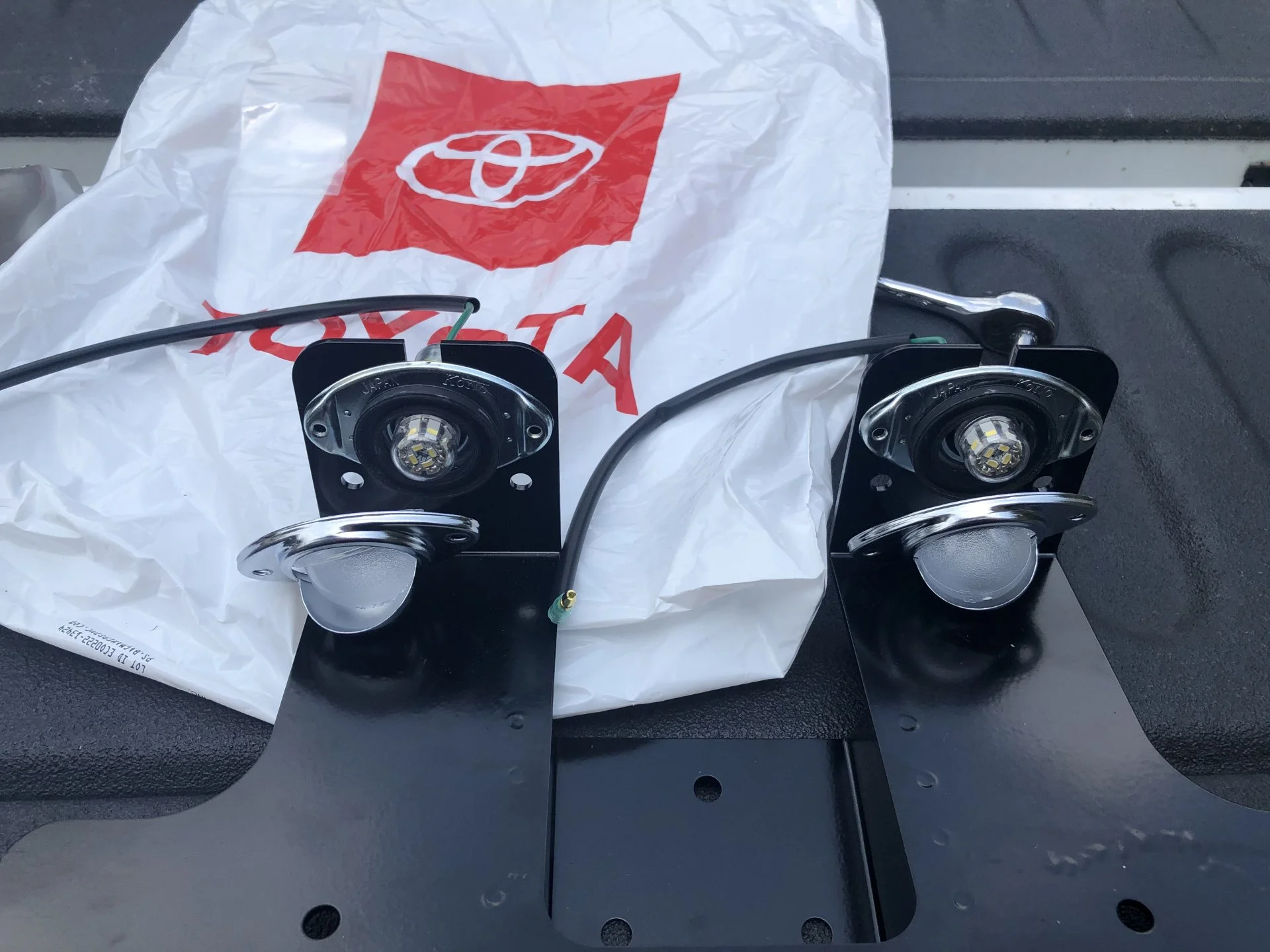

Bulbs exchanged. New hardware applied.
Covers on. Total time on target 10 Mics....
The only electrical fab :banana:..
I can repurpose this when I put the hard top back on.
Prepare to mount - Mount.
Last bit...

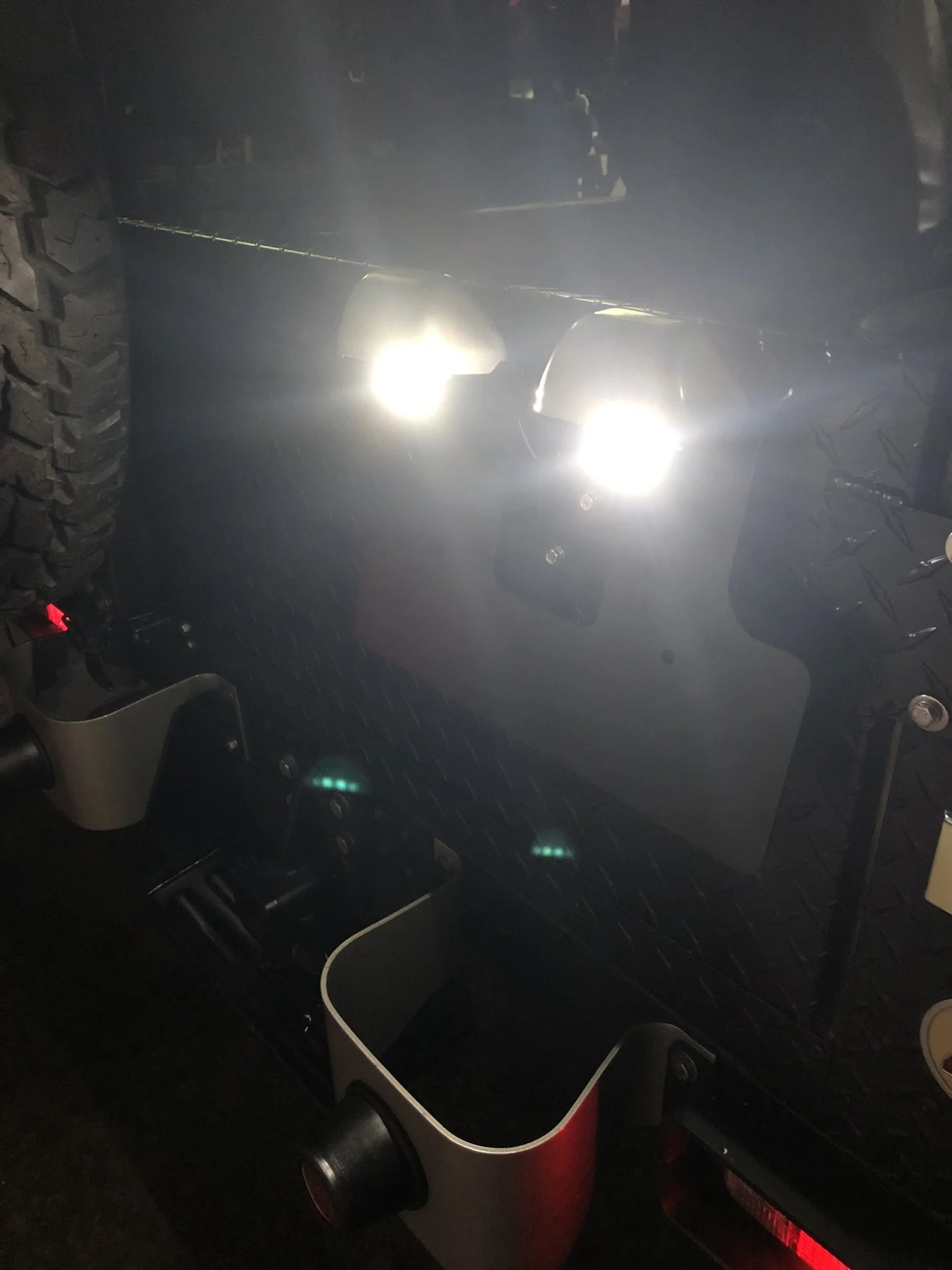

The LEDE's put out some lumens. I think the future holds a changing of the guard at some point from traditional bulbs to LED's......

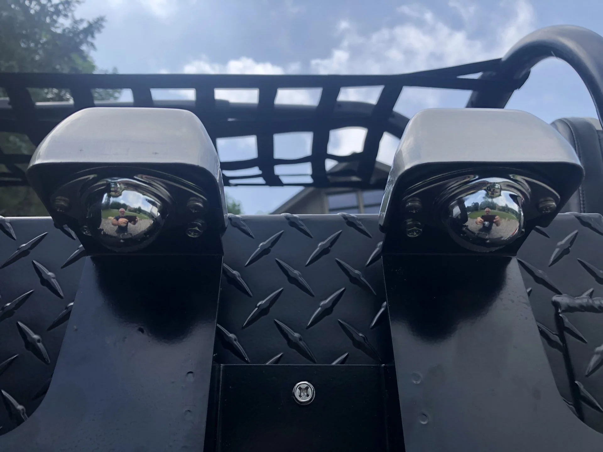

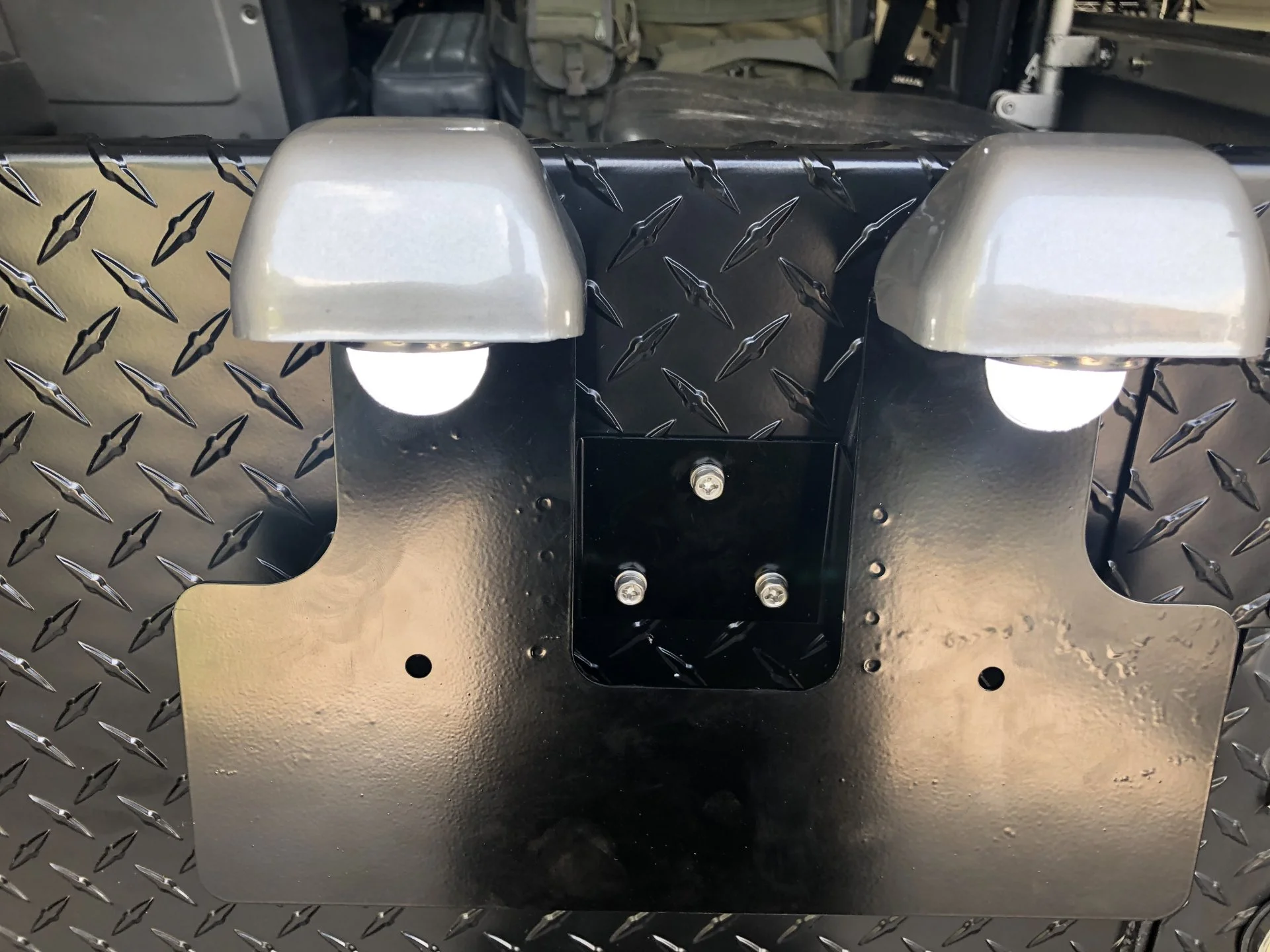

@ToyotaMatt
I do believe you've installed the license plate lamps backward... light is supposed to be shielded from those behind you and project onto the plate.
I'm assuming the missus asked to help you and you gave her this simple task to satisfy her curiosity and bring her into your world.
Keen eye Sahib..".I do believe" you are right. Please do not invoke the name of the one who shall not be named. I could end up on the couch..:oops:

Man, I should have been more subtle... it won't happen again!

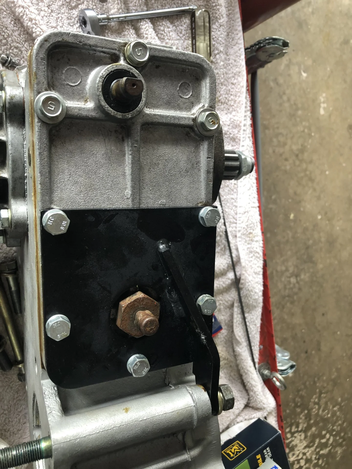

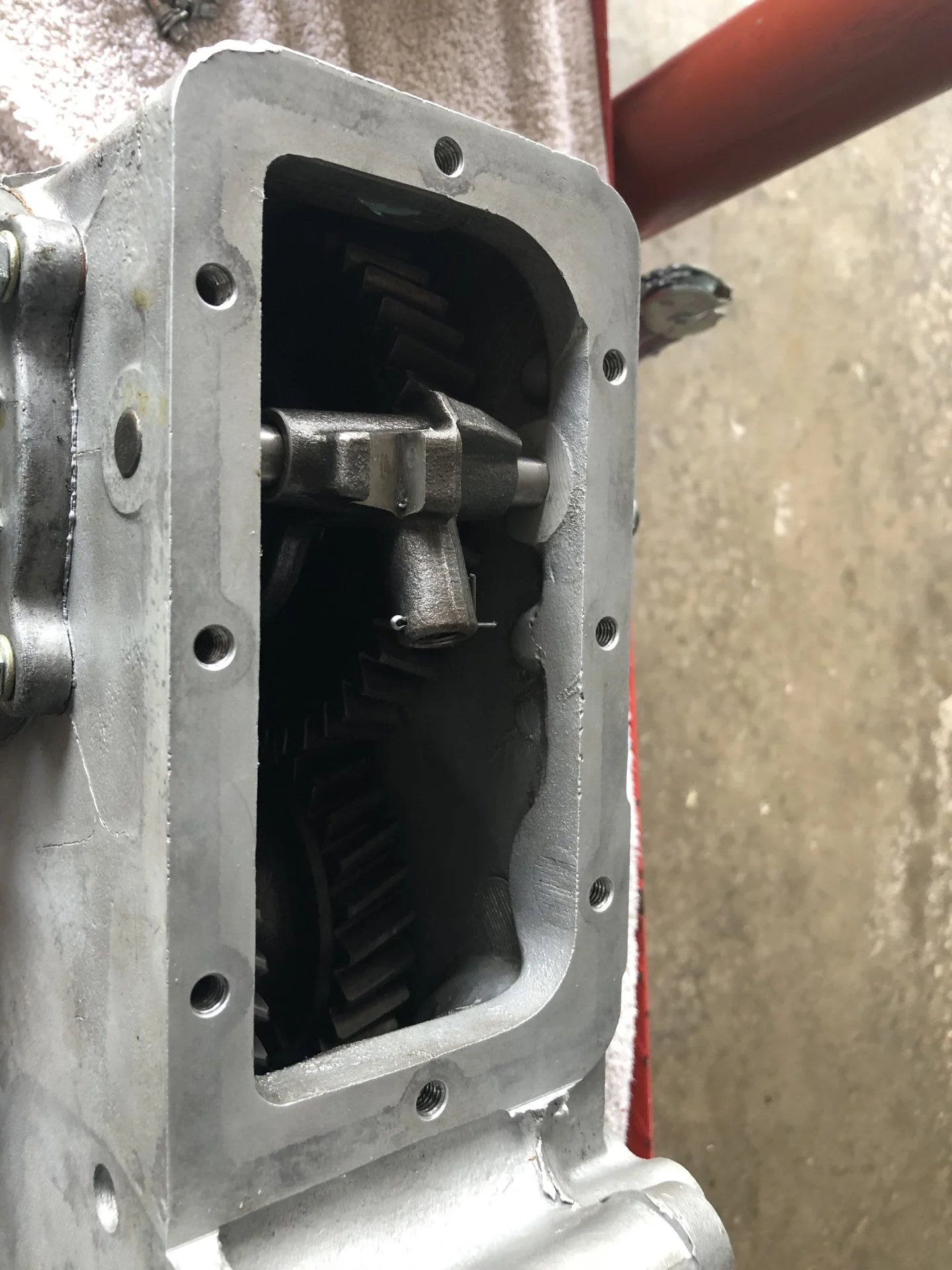

Houston, I have a problem.
It's an H2O insurgency, the vapor scourge, the dreaded humidity infiltration. Unusually humid here on the mountain top (Foot hill to you folks on the divide) for this time of year. My AC vents run exposed in my garage and man-cave. With all the precip, hot and warm conditions, every time I open the garage door the condensation monster comes crawling.
To the extent that after an hour today I was mopping up moisture off of the T-Case/Trans. Pretty sure neither have ever been exposed to back east humidity. So, I popped the top cover and gasket on the T-case, Put a coat of oil on surfaces I thought were susceptible to flash rusting as a preemptive strike. Also, plugged all the ingress/egress outlets. Bolted up the PTO cover sans gasket etc etc etc.
I may need to mate these two pieces together and fill with oil. As of now I'm short a 4spd shift tower to button up the Trans. I'll post an add in classifieds and see if I can round one up.
Thought about wrapping everything up and sneaking it into the closet.
I may have to relocate everything west into a more stable environment. Open for suggestions, comments or remediation. Cosmoline and vacuum seal.. :rolleyes:

I Would just spray/brush it down with some oil.
Thats what I did. Coated the internals with some straight wt as well, added a little grease to the shafts and crossed my fingers. I doubt that metal has ever seen anything like the humidity here back east. Usually, this type of moisture is relegated to a couple weeks in AUG. This year, we've had consistent rain interspersed with bright warm days. Every spring in the county is pumping water.
Reminds me I'm behind on the sheep dip (fluid film)...Crickey Mate, I may have just answered my own question as far as the external surfaces.

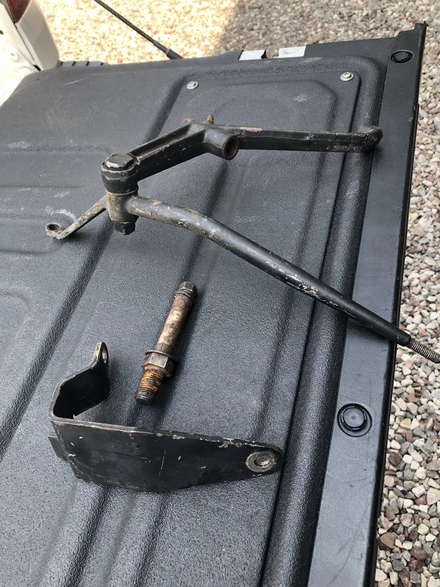

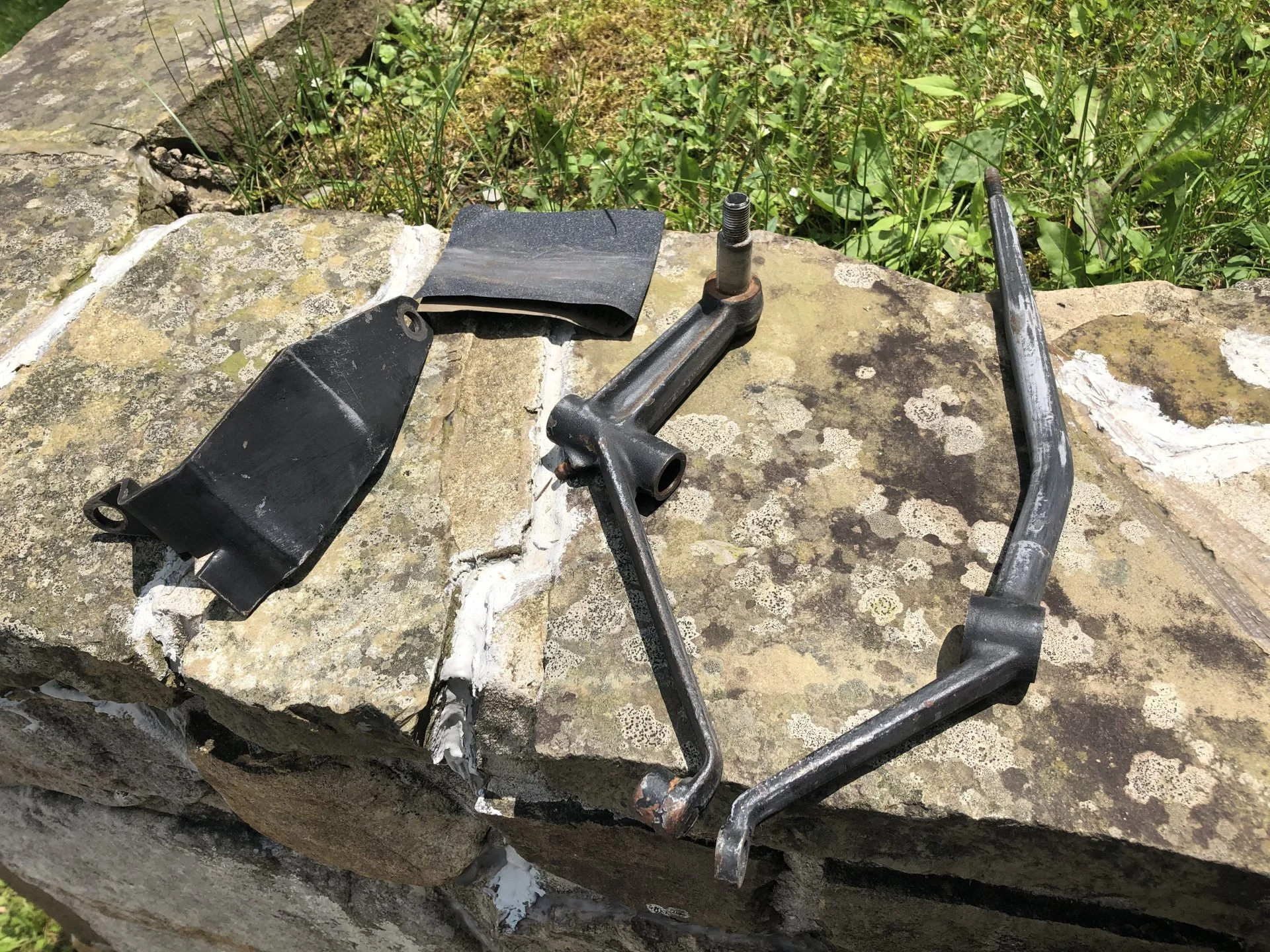

I broke down some of my newly acquired shift linkage. Scuffed it and cleaned it with some alcohol in prep for a rattle can make over.
Da*n that would be a good title for a thread (Rattle Can Make Over). Painted Pieces are currently baking in the sun. I'll post the shiny bits later.
