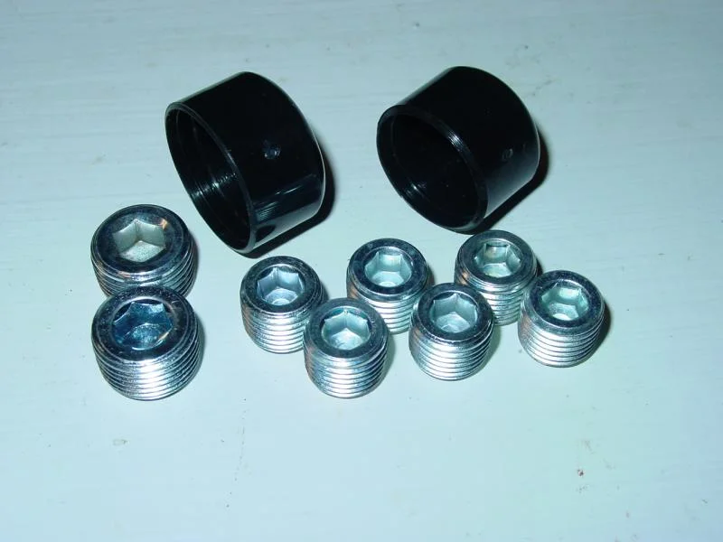

I'm going for a clean desmog. I think these are just the ticket.
Toyota 2f desmog air rail plugs

I've finally got up enough nerve to take a stab at demogging my 82' 60. This post was really helpful in informing me about what I going to be faced with once I start. I have a question about the plugs that are used once the air rail is removed. I plan to oreder Toyota part number 90340-14001 as shown in the photos here in this post. Does anyone know what the quantity is when you order this part? For example, if I order one (approx $6), is this just one screw/plug or is it a set a screw/plugs? The photo here in this post shows a bag of them and the quantity is labeled "10." Can anyone confirm? Thanks to everyone. This group has been a wealth of information over the past 15 months or so.
Save yourself a ton of money and just go to your local Ace / True Value and purchase the plugs for around a $1 each, you need 6. Yes, the Toyota price is per plug and you need 6, unless you must have a Toyota part you can save $. M14 x 1.5 or 1/4" NPT hex head cap screw will work.
Just got back from my local ACE hardware and the they didn't seem to have anything that would work for the plugs. The largest size they had with an allen key head was M10. They had M14 bolts, but no allen key in the head, and not threaded all the way. So, can you get a socket on the head so you won't have to use an allen key, and what length should I get? Thinking I can just use a bolt? Also, what is meant by 1/4" NPT?
Thanks
1/4" National Pipe Thread.
It needs to be an allen socket pipe plug. A square head plug (much more common) will start down in the hole, but as the plug gets down into the surface of the head, it's difficult to get a wrench on it to tighten fully.
Plugs like these (see link in my sig):
