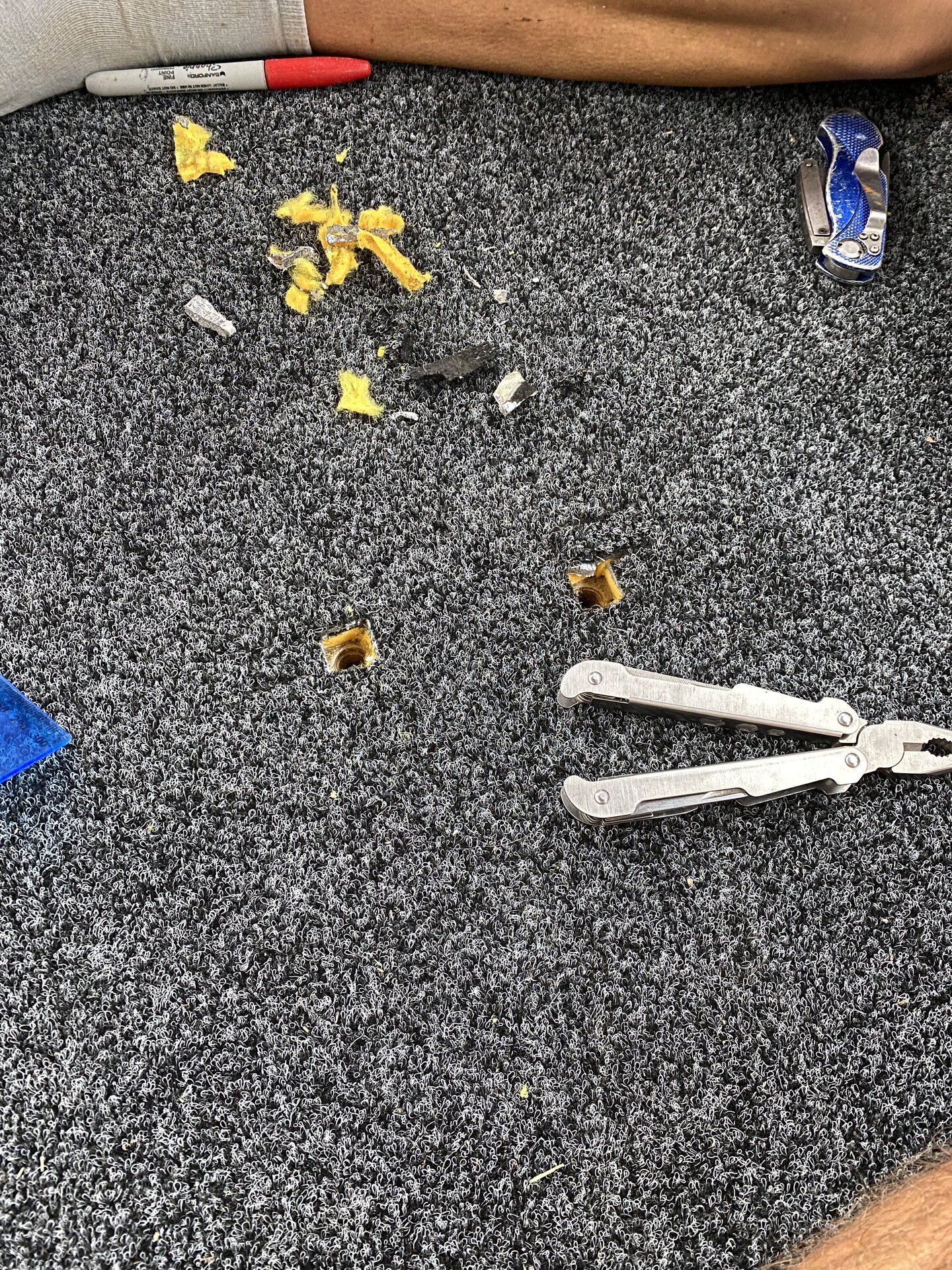

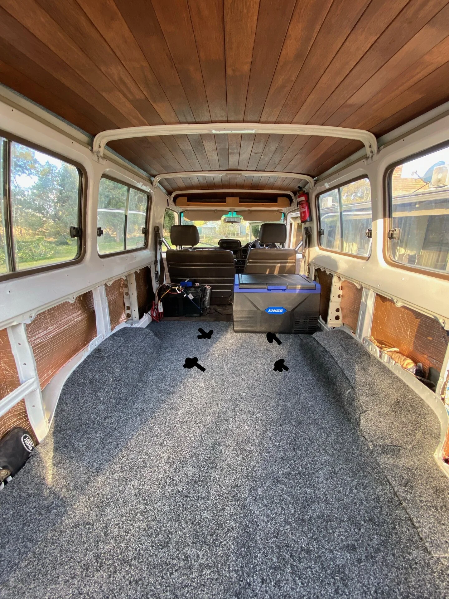

Newbie here and asking for a favour. As we are converting our beloved 75 series Troopcarrier we just finished laying out the marine carpet and insulation/ sound dampening. Ofcourse we forgot to mark down where the 4 anchoring bolt points are located and now the search for them unravels. We may or may not have glued down the carpet and do not want to tear it out again.
So if you own a 75 series troop carrier could you measure out the locations of the 4 anchoring bolt points. This way Im hoping to use a soldering iron to make as little damage as possible to the carpet while still being able to use the anchoring points to anchor the 17mm ply sheet on top.
Pictures for reference and laughs :D

Maybe try getting underneath the rig and pushing an awl up through the captured nuts on the underside of the body?

We also visited Toyota and jumped into a brand new 70s series to measure out the anchoring points. Seems like they didn't change the back since the original came out. If anyone is struggling with those measurements:
(measured from the rear door upwards)
(measured from the wheel arch)
Top
1680 x 433
1680 x 530
Bottom
840 x 227
840 x 325
Maybe this helps someone in the same situation some day :)

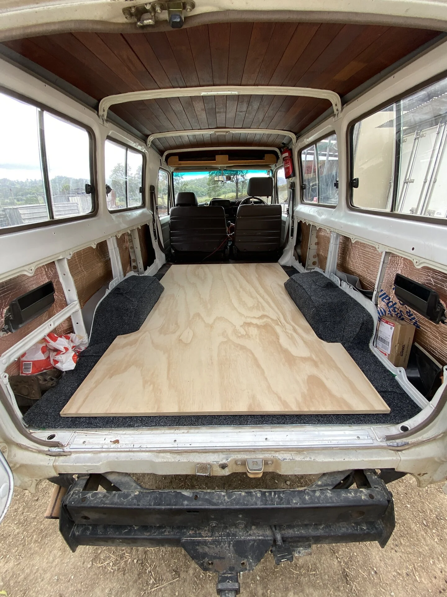

The insulation + marine ply bring a nice sound deadening effect. Also the ply will be used to screw in our framing for bed/sofa and kitchen/ fridge. I'll post some progress pictures soon. :)
