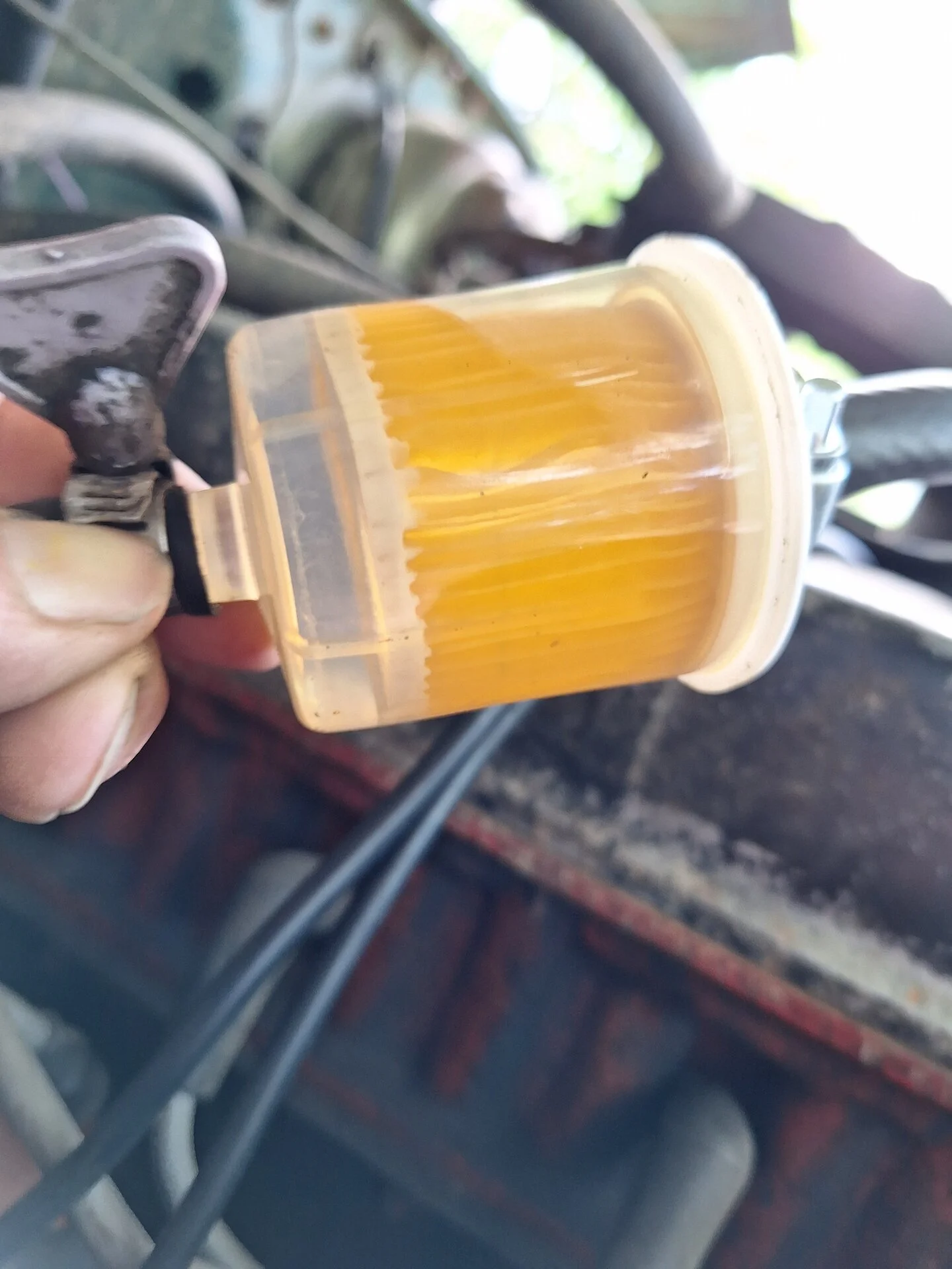

On the fuel side of things its a new filter and electric pump. I took the top of the carb off and made sure it was visually clean and no water inside that i could see.

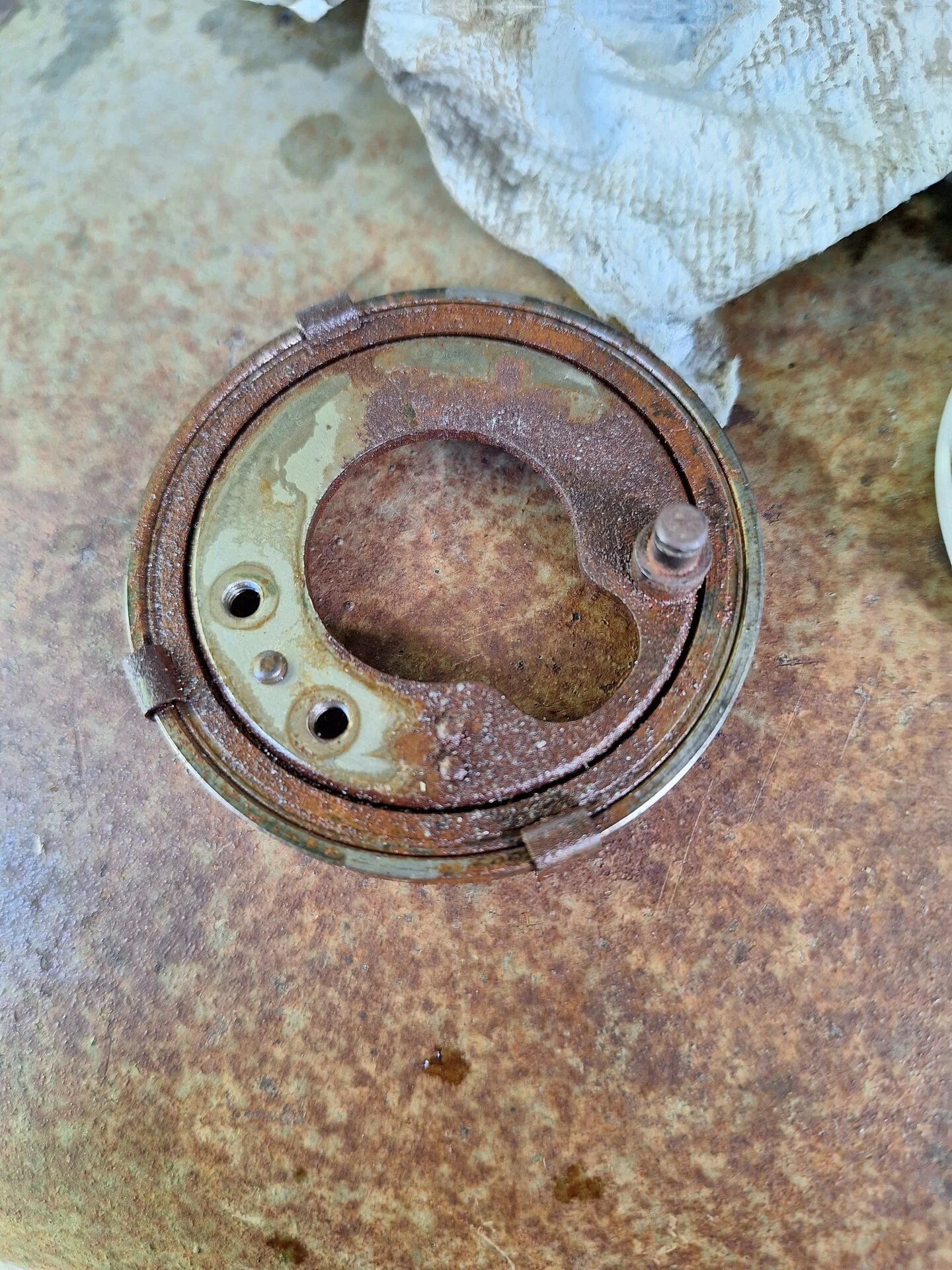

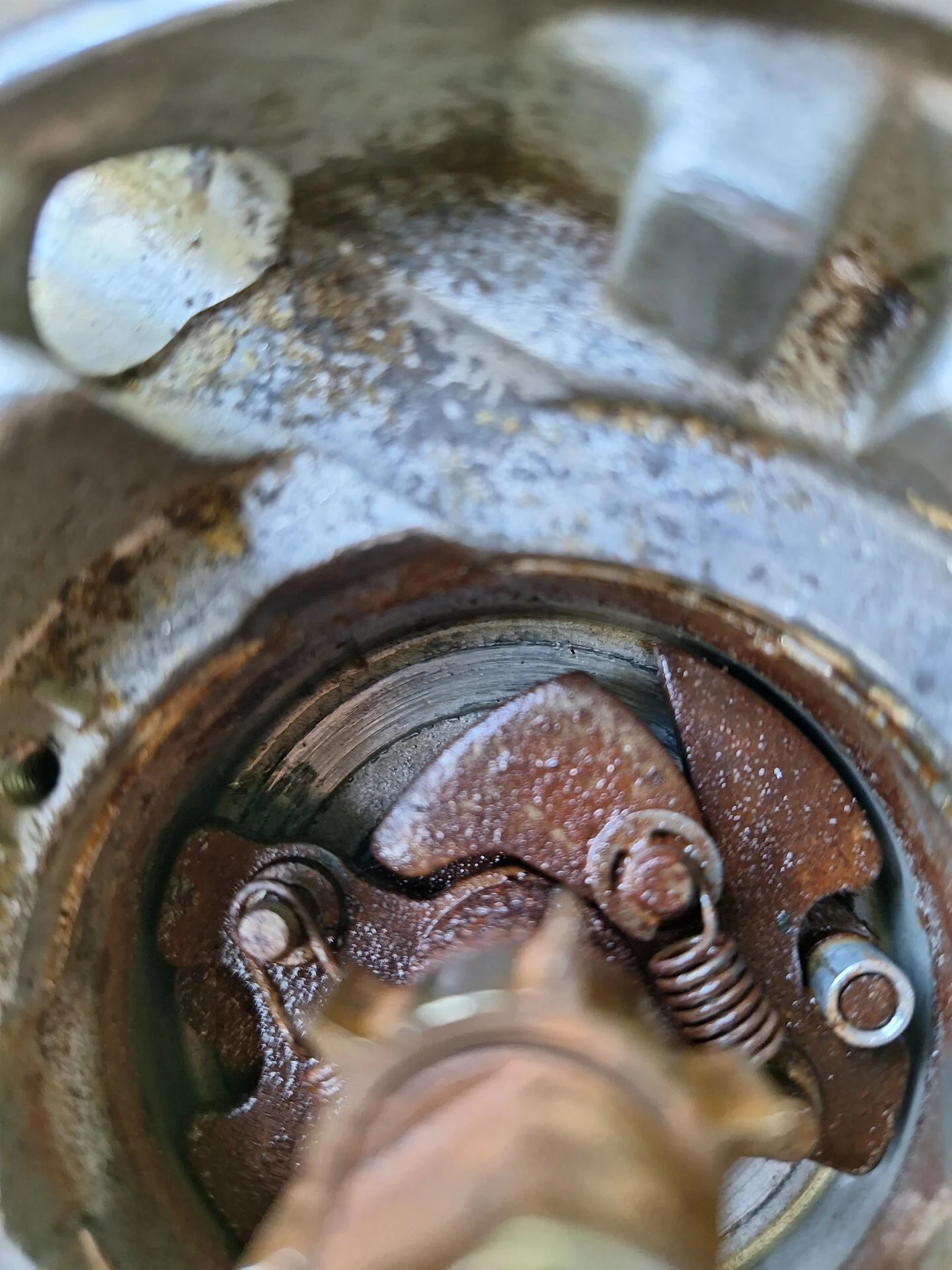

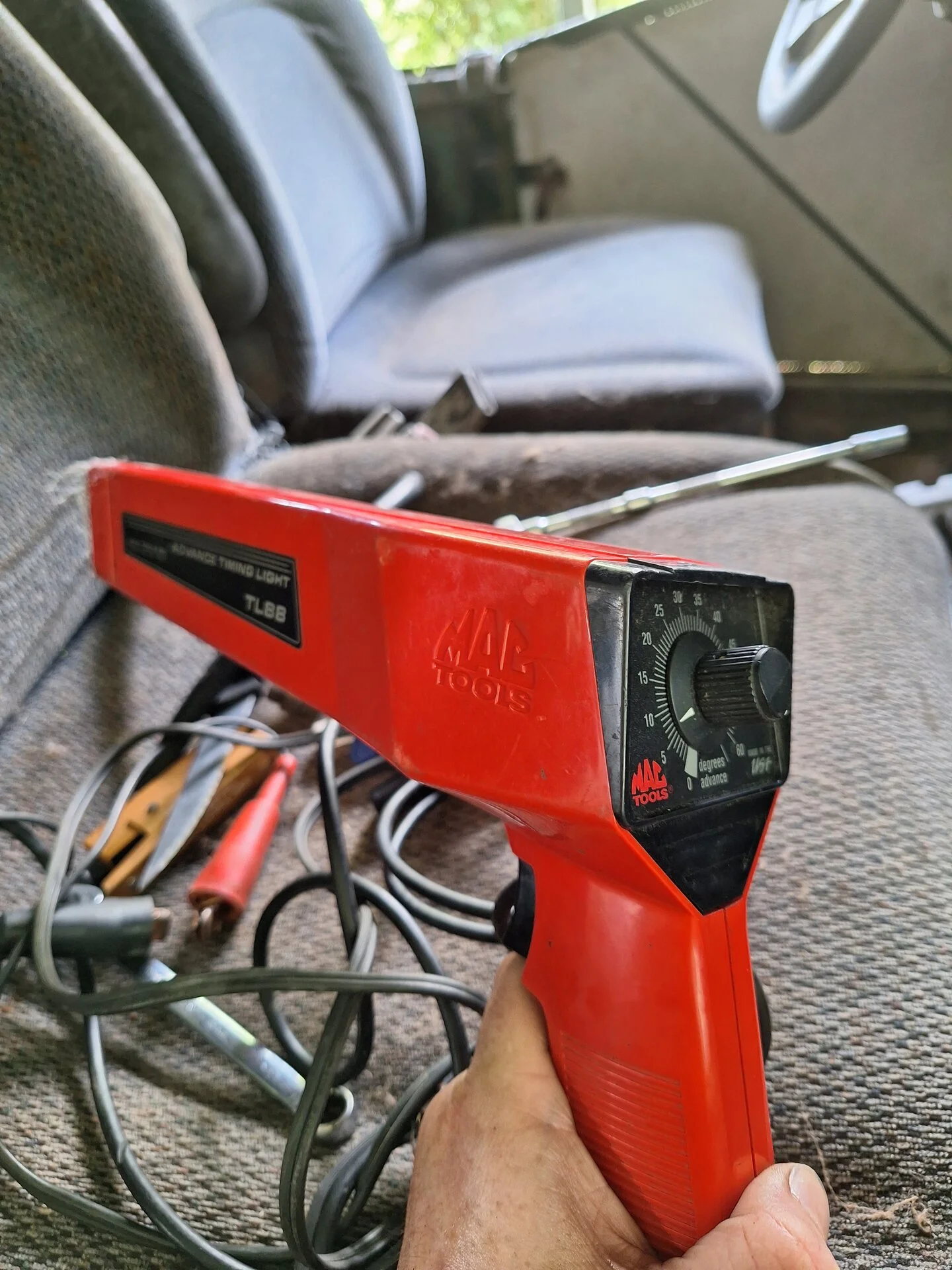

As to timing, I looked at the timing with my light (in picture), I had to turn the dial up to like 25 to 30 degrees before I could see the mark(not hole, but line on flywheel). If set correctly though it runs much worse will die. I found a post on here about cheaply recurving the dizzy and I have already ordered the spring kit and installed the new aluminum bushing on the pin in the dizzy. Question is the barring plate that holds the pickup available anywhere?(Pic included). Also I'll include another pic of the bottom of the inside of the dizzy where it seems its machining a Grove in the bottom. I'm sure it's not supposed to do that lol. any ideas as to why it's doing this?

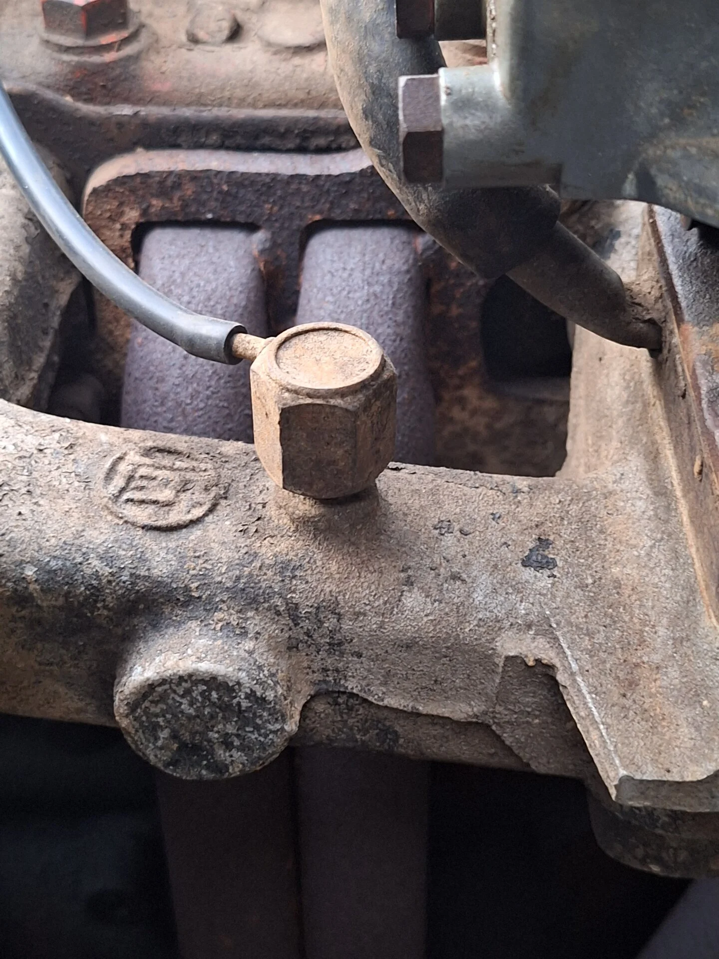

On the vac advance vac lines I got the back port ran to carb and the front ran to a port on the intake?

The plugs are new denso' s from cruiser outfitters. However they had alot of black soot on them probably from running a bit rich. So i cleaned them and it is running better ish... it's still bogging under load. As to the break booster it's a fairly new unit from btb and takes a gm master cylinder. So unless the grommet is bad I don't think there is an issue there. The vac is tested from the port on the intake that is hooked to the outer port the advance on the distributor. If i rotate the distributor all the way counter-clockwise it stars to idle smoother and the vac goes up. And when I put a timing light on it you can't see the mark until you turn the dial to almost 40° of advance. And this is when i tested the vacuum. But if I turn it all the way the other way it puts the line on the flywheel on the needle and the setting on the light can be dropped to 7 degrees. But it runs really low and has a chopy idle. I think this may be a fuel problem in the carb.

Ok I see something I'm getting wrong and that's the ports on the dizzy advance and believe I need run the inner port on the advance to the side of the carb and just cap the other off. I don't think I need the extra advance especially since I'm basically at sea level lol

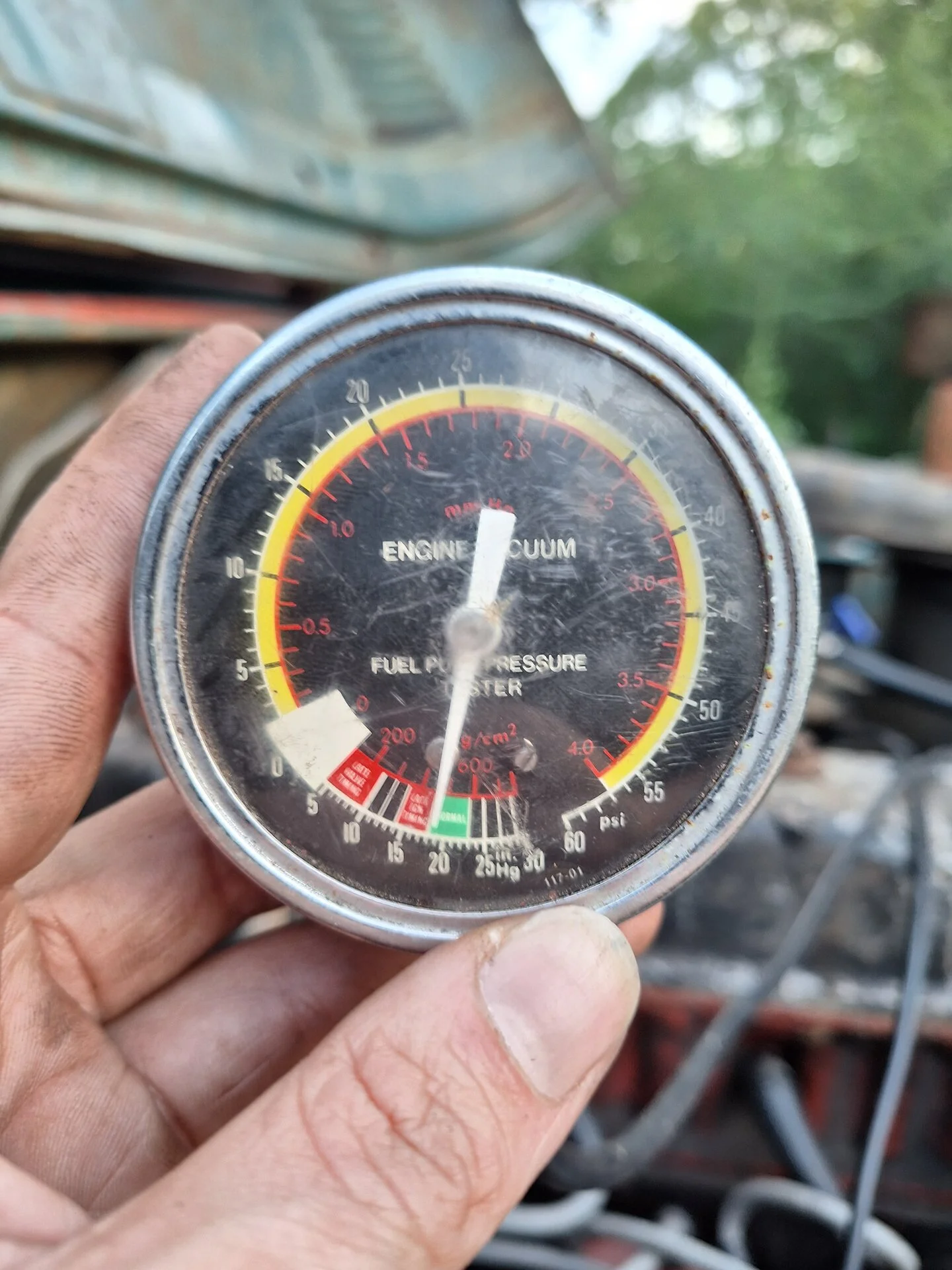

So what i did is disconnected the vac and pluged the lines and reset the dizzy, then hooked the inner port to the the port on the carb and left the other pluged. And its running better and it has power under load, but its still running rough and has rough accelerating. I did to a manifold vac test with my mityvac gauge and its running around 17 psi. Another thing i need to note is my idle air screw on my carb has absolutely no effect on idle if you go all the way in or out there is no change. Now I do run 10% ethanol in the gas I know its bad and horrible for the carb but its all i can get localy unfortunately. Are there any kits or builders that make them compatible with ethanol? I'm thinking about sending mine to trollhole

Think you both mean In HG, not PSI btw ;)

Fair point I miss spoke lol. I don't have a fuel pressure gauge. I'll look into getting one. Bur it's just one of those clickty clack electric pumps because I'm poor 🤣. I need to find a good mechanical pump or at lest a kit. And no water in fuel filter I posted a pic of it above
