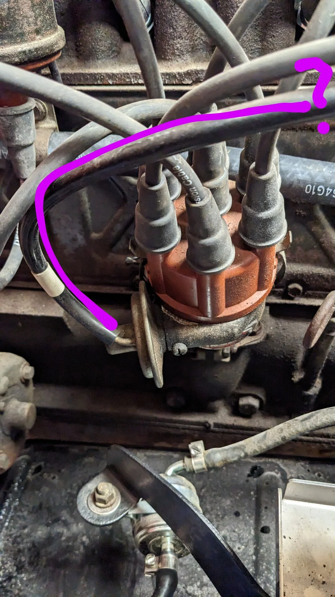

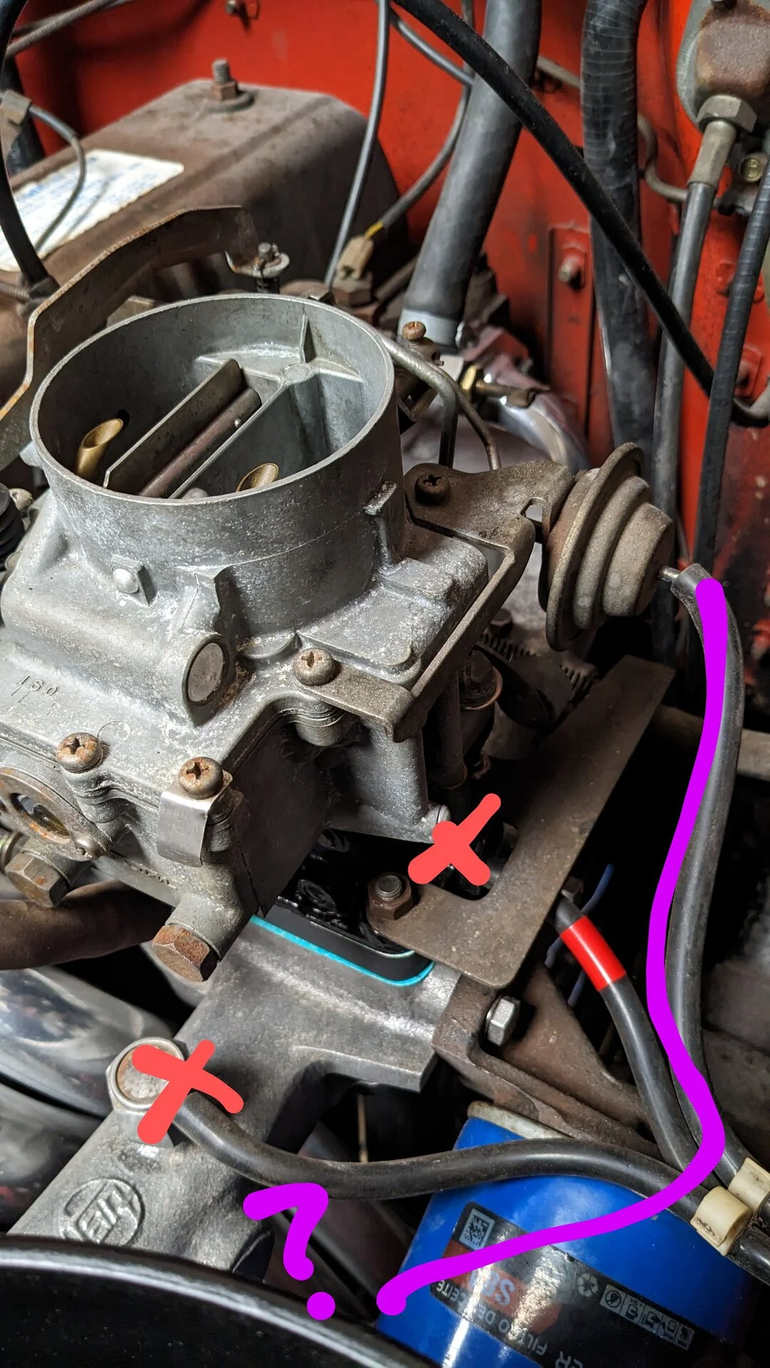

So to my understanding my 72' 1.5F motor has a vacuum switching valve for emissions. Since I don't know if this early emission control works and im having trouble tuning my carb I decided to eliminate it.
A previous thread discussed this and blocked off the intake manifold port and lower carb port. They said that both vacuum retarded dizzy and carb diaphragm need full time vacuum but never said from where, to each other? '72 FJ40 Emissions Control Device~Advice - https://forum.ih8mud.com/threads/72-fj40-emissions-control-device-advice.551434/
Then once these are all connected properly how much would I have to potentially advance timing, base idle mixture turns etc. Not sure if it matters but I also have headers but that prob doesn't make a difference at idle. Little bit of a carb noob on these Aisin boys

I'm pretty sure that you have an F engine.
On a vacuum retard dizzy, don't bother to hook it to vacuum.
I got the vacuum for my throttle positioner from the port at the base of the carb you have marked with a red x.
I'm running 22 degrees BTDC right now
Is it vacuum retard distributor?

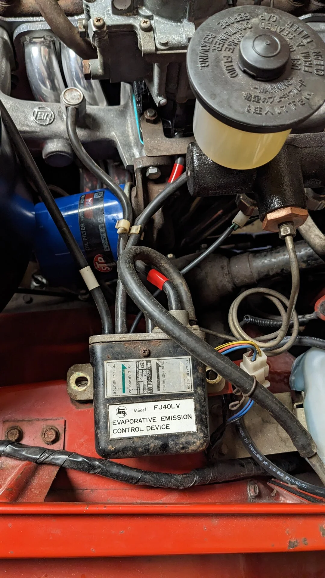

Yes thats what I've been told for a 72 with the F155 motor, a F motor with the oiling advantages of a 2F. I also have the weird multi-vented fuel tank that runs to the middle seatback. No one reproduces one and it works in conjunction with that EVAP control, so eliminating that would help me upgrade to an older style fuel tank later on...

Yes, definitely a vacuum regard distributor.

Sone people have reported fuel vapor odors when the evap system was not present. YMMV.

So which vacuum port do I connect my vac guage to while setting timing?
To any one of the ports on the intake manifold. I use this one for my in dash vacuum gauge
