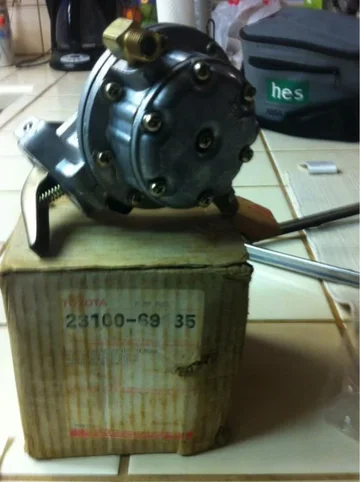

Nothing says bonner like going into your buddy's shop and telling him your close to complete and need to get a fuel pump and he reaches over to the shelf and hands you a box. After blowing the dust off its a new factory Toyota fuel pump! This was still in the bag with the reciept from 1980.The cost was $65.20 expensive! Some things never change. Check out the install instructions, Im pretty sure the bottom line says Toyota Manufacturing thanks for yen round eye!

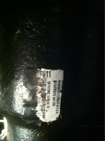

Put 1 in 3 months ago purchased from Pep Boys Auto Supply,box is remanufactured by ASTCO out of Arizona part #7511 for a Scout by Saganaw. $189 no core. Notice manufacture date on sticker 08/12. They are still available. Let me know if you need help

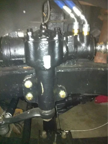

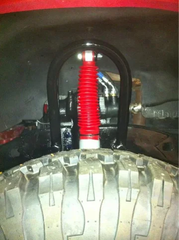

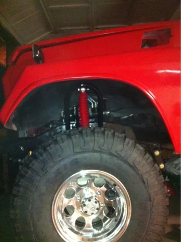

Installed some shock hoops and Rancho XL9000s today . Getting kinda busy with the steering box, brake lines, pitman arm that side glad there's nothing else that needs to go on that side.
powersteering
Is that a saginaw steering box? That is my next project! I had planned to use a 60 box. I am wondering why you used that one verses a 60 box. Is the difference like beeing able to turn the wheel with one finger verses four?

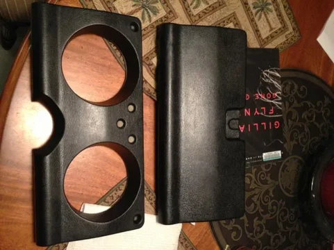

Those dash deals are from SOR? They look hot!!! Fun to find that waiting for you.
Gonzo,
What's the story on your dash pads. Did someone restore them. They look new, Nice!
They are new, SOR has a few left and I'm not sure if they are going to re-run them. The package that they came in was on the self for a while.They are complete pads not covers and excellent fit and quality. If your thinking about some I would jump on it now. The 2 were about $150
Yes, it is a sag 7511 for a scout.$180 rebuilt from Pep Boys auto. Works great
Yes, it is a sag 7511 for a scout.$180 rebuilt from Pep Boys auto. Works great. Fits nice and turns the 35s with one finger at a stand still.Jeep pitman arm fits right on too. Ya I know jeep, I ground all identifying marks off it .
