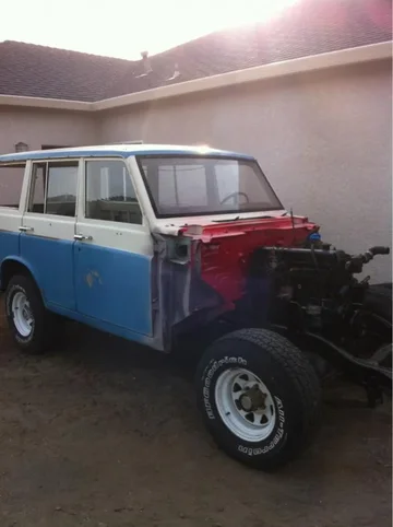

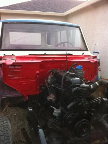

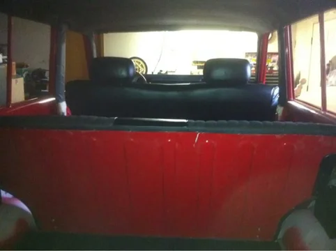

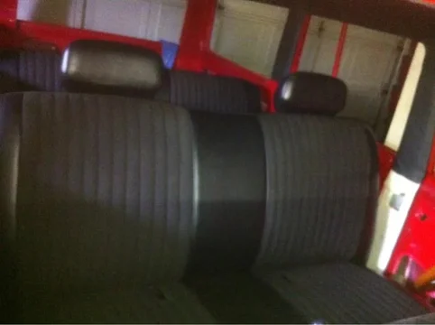

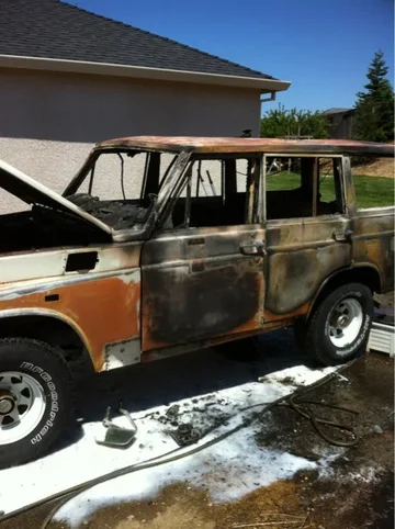

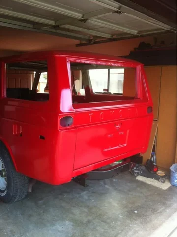

My son Harley and me started our first FJ build together and it caught fire.He was devastated.He wanted that one fixed so I bought a 76 and took the frame and running gear off the 72 blasted it, painted it and new body mounts. I cut the tail light rings off of the 72 and welded them to the 76 body. The 72 tailgate was not on the body when it burned so we had a good one. 200 hrs of body work and painting every night after work and on weekends . The only thing we farmed out was the seats.We are almost done and getting ready for our first trip this summer.

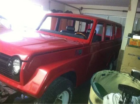

We were grinding the rust out of the drip rail and some headliner insulation started smoking so I figured I would get a hose and cool it done . Went and got the hose turned around and it was shooting out the windows!! The red is for the Chico Fire Department that saved it. It's farther along than the last pic. Just installed all new factory rented glass , looks cool. My buddy hooked me up for $400 for all glass
New glass that comes tinted any shade you like when you order. I made pattern of all the glass and had a buddy order it. I will post a pick .

Your tragic fire may have saved my pig from a similar BBQing. I am currently working on the roof rust and dents and have been grinding, power sanding, and heating with a torch. Didn't even think of that stuff burning like that. Today I am pulling off the insulation before doing more metal work. Thanks for the lesson.

OK Gonz... Give up the info on the windshield. I know there are some people here who will want to know. I have got two from a place in Truckee and they were installed for over $200. Since you are in the Central Valley, I would bet there is a similar supplier. I'd love to get an extra and put it in the shed. Tahoe eats windshields. It's just a matter of time for me.
