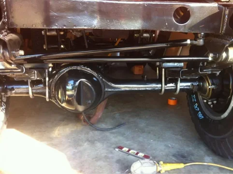

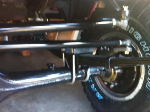

Installed the front axle today after cutting and turning the knuckles.Installed all new parts including disk brakes.She's looking good and Tommarrow I will fab up new steer rods and lay out steer box.Where getting close.
Man Gonzo, That bright red paint and the chrome, really looks good. Got any more pictures of your axle stuff.
You and your Son, are doing some good work.

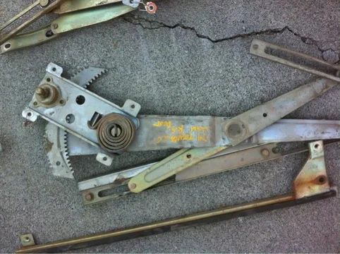

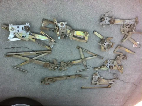

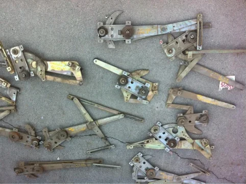

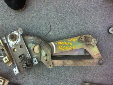

Window regulators anyone? Came across a old glass shop that old stock up stairs. The story goes that the old owner was converting the hand cranks to power back in the 70's. These are in really good condition , the crank spindles have no play in them at all. So I got them all.
GOLD MINE score, man. Good Job! I need a drivers side front for a 74 door, and if you still have that old 3 speed transmission....PM me.
Thanks!

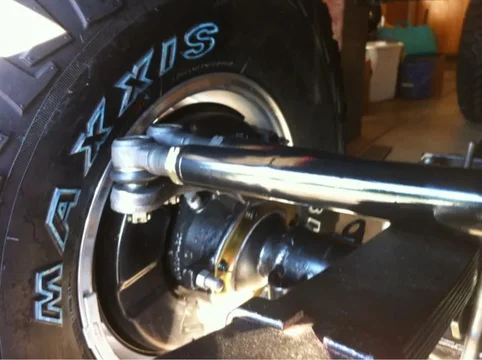

Install the steer arms today, made them from
1 1/4 DOM and welded Trail Gear crome Molly plugs to them, a little paint and some new FJ 80 tie rod ends went into the mix. Shock towers and some brake lines should rap up the drive train.
GITCHASUM!!!yeah.

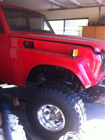

are you gunna be willing to take it wheeling?
Hell ya that's why I painted the frame and bottom of body so it will look just as good upside down ;)
