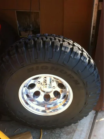

Bought a new pair of shoes for the pig today.I snuck them through the back yard and into the garage so I don't have to sleep on the couch.:)
