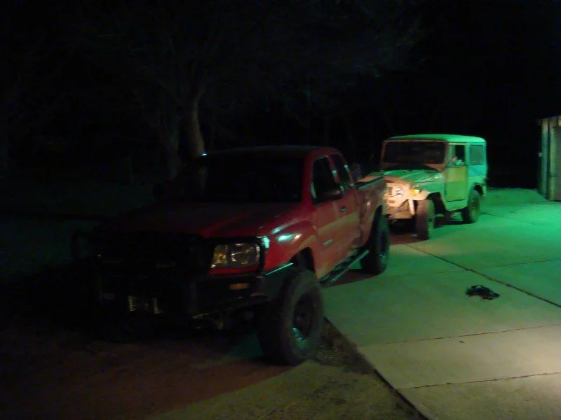

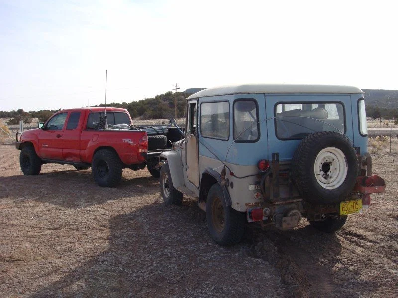

The first thing I had to do was get the 40 home.
U-Haul wouldn't rent me a trailer because the cruiser outweighed my Tacoma, but they did have a towbar for sale.
I dropped the rear drive shaft and flat towed it several hundred miles (including through Salt River Canyon) home to Arizona on ancient dry-rotted tires. NOT recommended!! :o

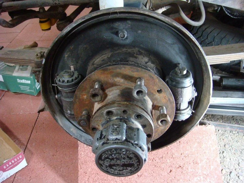

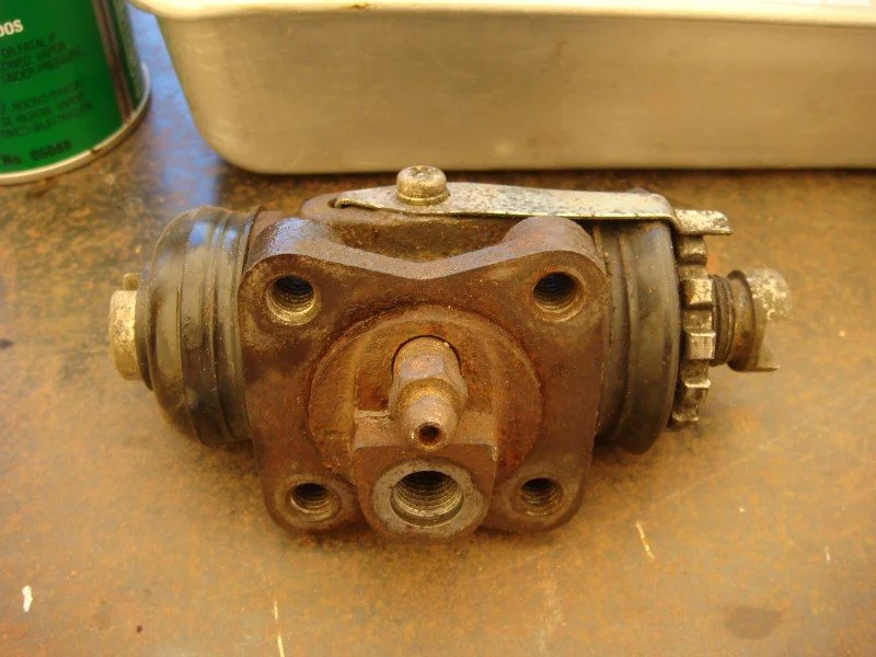

Second thing was making sure I could stop. I found that 7 of the 8 brake drum cylinders were seized.
I had to try three different NAPA rebuild kits from 1970 & 1971 to get the proper rubber pieces for the cylinders, but the cylinders honed up nice and I had good working drum brakes after NAPA turned the drums for me.

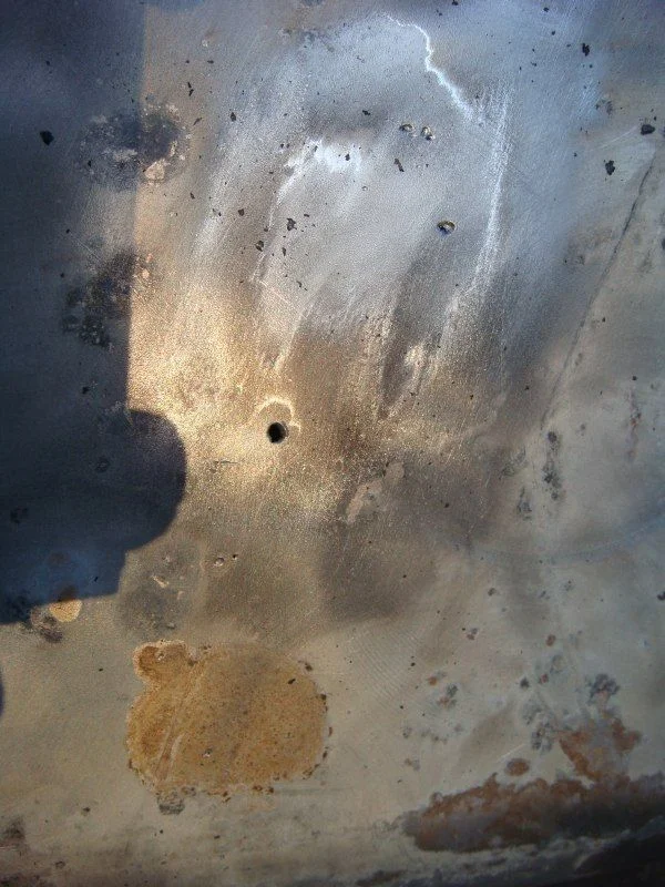

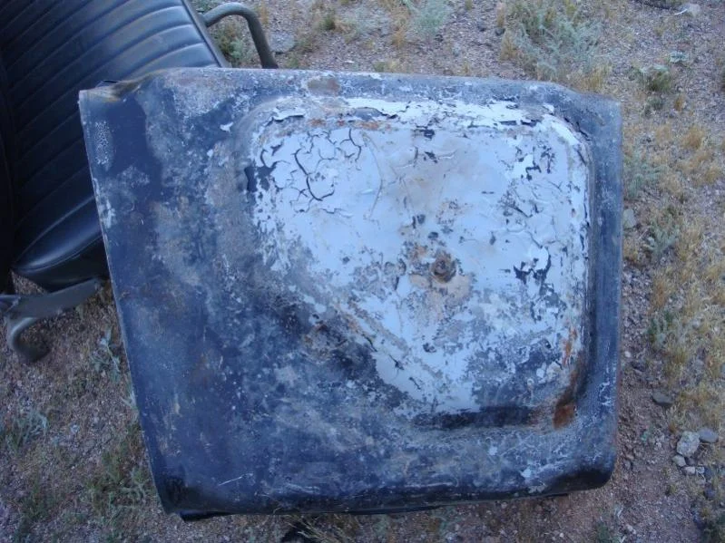

So now that I had (or thought I had) good working brakes I pulled the fuel tank and washed the rust out.
Turns out it had bigger problems than rusty innards. I started sanding down the outside in order to give it a coat of paint and found the bottom was as solid as Swiss cheese!
I contemplated a quicky fix using epoxy, fuel tank repair tape, bubble gum, etc, but decided I needed something safer.
I never was comfortable with carrying a bomb around inside the cab, and a leaky bomb was just too big of a risk for me. I ruled out a poly tank, and called around to some of the previously owned parts places.
Mark from Marksoffroad hooked me up with a decent tank of the right vintage (no extra hose fittings to block off) and after a quick paint job & inside scouring it has served me well.
I put two fuel filters in series just in case, put a few gallons of go juice into it and fired up the engine for the first time - WOO HOO it started!

Fuel tank bottom
Rust sanded off to expose Swiss cheese
Newly painted tank from Mark

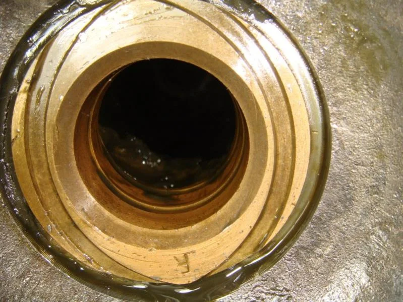

Fun with Balls & Claws
While I was waiting for the fuel tank to show up I figured I would pop open the knuckles & put a dab of grease into them.
Boy what a can of worms that was!

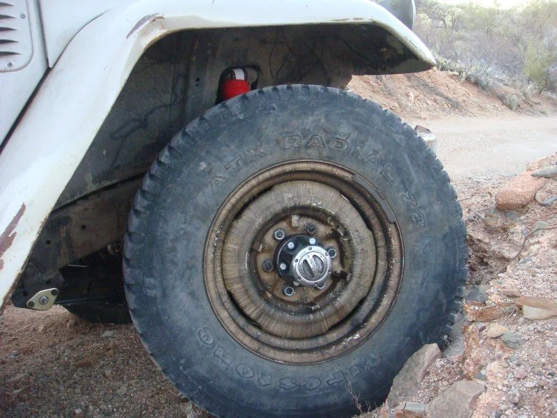

I knew from the grease stains on the front passenger side rim I had diff oil getting out of the knuckles, so I started on the passenger side first.

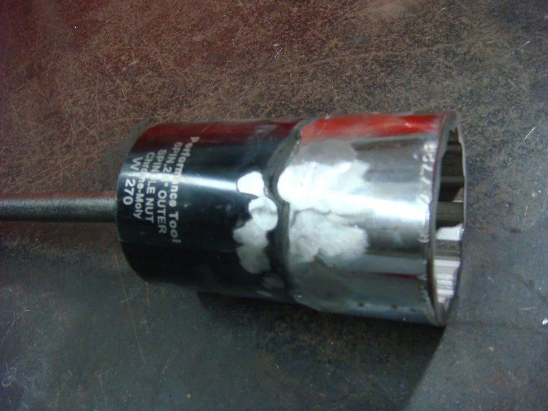

After removing the Selectro locking hub I found out that the ball & claw hub bearings have 52 MM nuts. I looked online and in several stores but nobody had a 52 MM hub socket.
I welded strips of metal onto the end of a Ford spindle socket and was able to get the outer nut loose, but the outside diameter was too large to reach the inner nut.
So I bought a 2" socket that fit the nuts, but was too shallow to reach the inner nut because it hit the end of the axle shaft. Kwap!:mad::mad::mad:
So out comes the welder and I attached the 2" socket to the Ford spindle socket and then sliced the end off the 2" socket.
Now I have the magic tool so I don't need to chisel off the nuts!

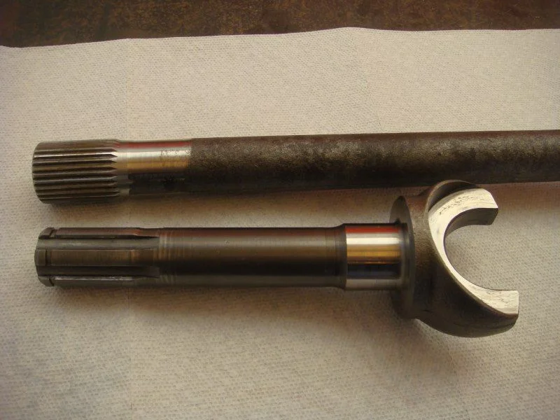

So I finally got the bearings off & pulled the axle shafts.
I was pleasantly surprised to find the inner axle had fine splines. This meant I had interchangeable thirds and could put a "normal" ARB locker in the front.
The inner bushing seemed to be in good shape, and although it was obviously too worn to make a good oil seal, it seemed gudenuff to put back together. Especially 'cause the bushings are unobtainium these days.
So I cleaned as much grease out of the axle housing as I could, replaced the upper & lower knuckle bearings, tossed the ball & claws back in, and filled the knuckles with Sta-Lube extreme pressure Moly-graph.
Knuckle rebuild instructions are all over Mud, so I didn't bother taking any pictures of the messy part.
Pics:
Greasy oily passenger wheel
Claw axle shafts - note inner fine splines and coarse outers
Ball & Claws
Inner bushing - note the "R" for right side bushing. The left side has the inner grooves running the opposite direction for oil control as the axle rotates in the forward direction
The magic 52 MM tool

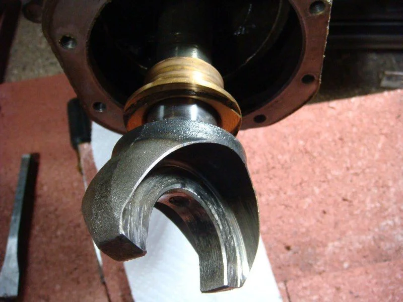

Since I had so much fun and learned so much refreshing the passenger side axle & knuckle I foolishly thought the driver's side would be a piece of cake.
Nope :bang:

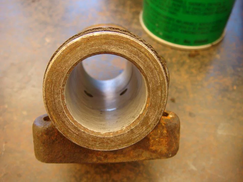

As I pulled the driver axle out the brass bushing came out with it. These bushings are supposed to be pounded into the axle housing and shouldn't be falling out.
Sometime in the past the bushing started spinning in the axle housing, and wore quite a bit off the outer surface.
Since I can't buy a replacement bushing, I had to try to refresh it.

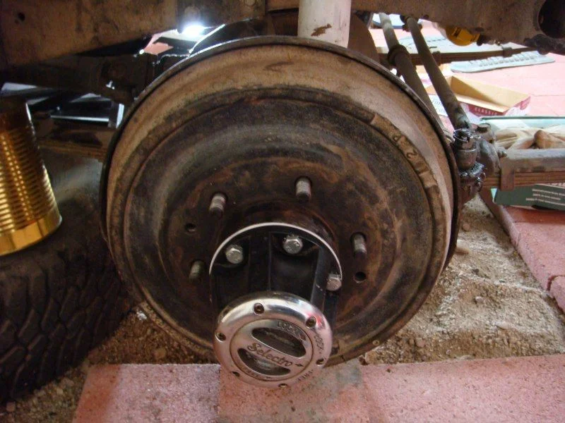

New style Selectro on passenger side
Old style Selectro on driver side
Driver's side inner axle with loose bushing

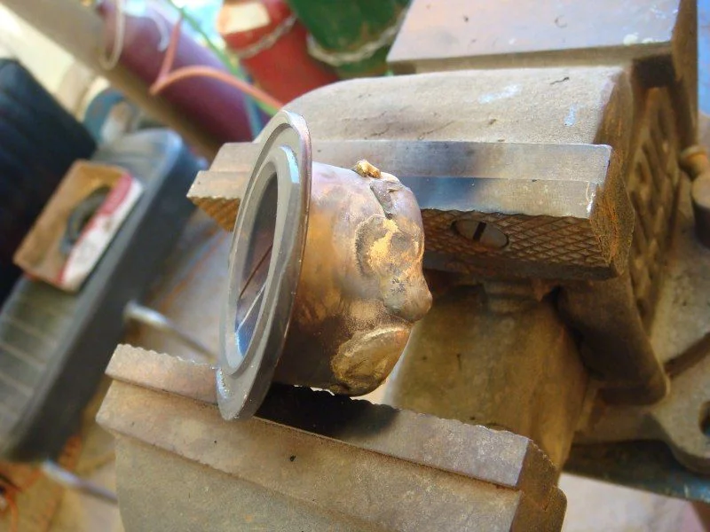

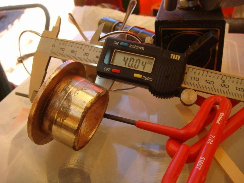

Last Resort Bushing Repair

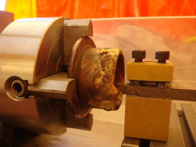

I didn't think the wiped out bushing would do much good if I just reinstalled it, so I figured I would attempt to repair it or ruin it trying. :hhmm:
I very carefully brazed blobs on the outside of the bushing letting it thoroughly cool in between blobs so it wouldn't warp too much.
Then I chucked in my lathe and turned it down to a scosh over 40 MM.
There was quite a bit of wear on the face of the bushing, so much that the "L" was barely visible, but I figured I would quit while I was ahead and not try to build up the face.
I drove it into the axle housing and it lasted until I replaced the ball & claws with Longfields.
Interestingly I discovered that behind the bushings was a recess milled out in the axle housing that would fit the normal Birfield axle seals.
Apparently the same axle housing was used for these "new" style fine spline claw as the Birfields. (remember that USA stopped getting ball & claw axles way before 1971)
Pics:

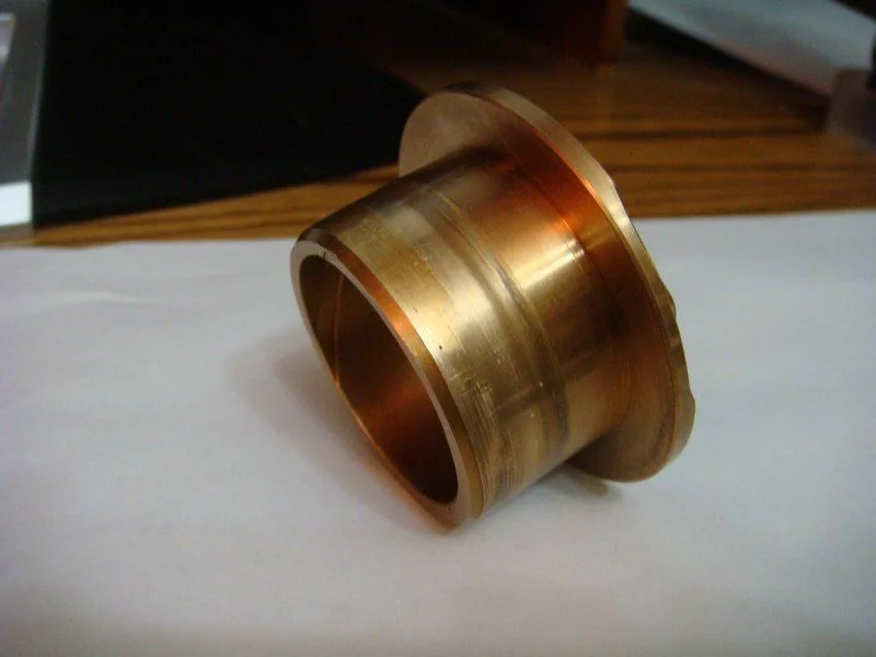

Blobbed up bushing
Ready to turn down
After turning
Final measured 40.04 MM - this was about what the unmolested portion of the bushing measured
Reinstalled:bounce:
Nice!!!!

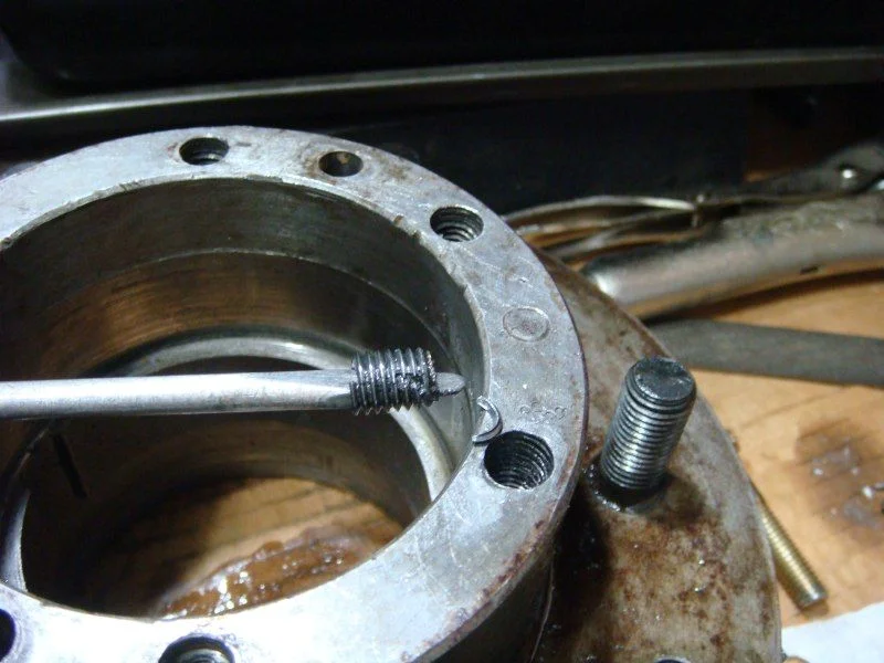

There were only four bolts, one was missing, and one was snapped off deep in the threaded hole.
It also did not have any drive pins :whoops:, and the holes were too wallowed out to hold stock pins.
I bought a set of oversized dowel pins from Bobby Long that came with 5/16" pins, a drill bit, and a cool jig for drilling new holes. Great product!

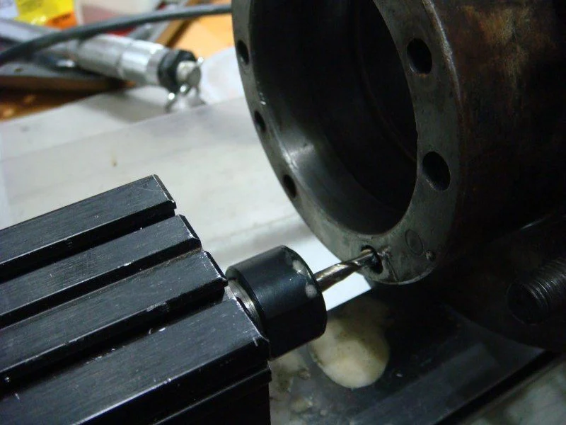

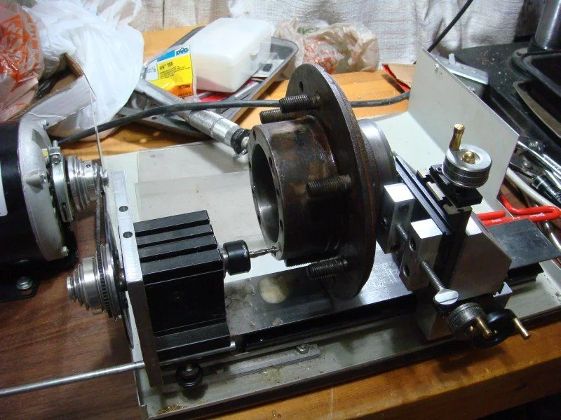

First I had to get the bolt holes refreshed and the broken bolt out.
I was barely able to hold the hub in my lathe's largest vice and milled out most of the broken bolt. Then I pounded a screwdriver into the bolt and easily screwed out the remnant.
Pics:
1 & 2 milling out the bolt
3 & 4 unscrewing the remnant
