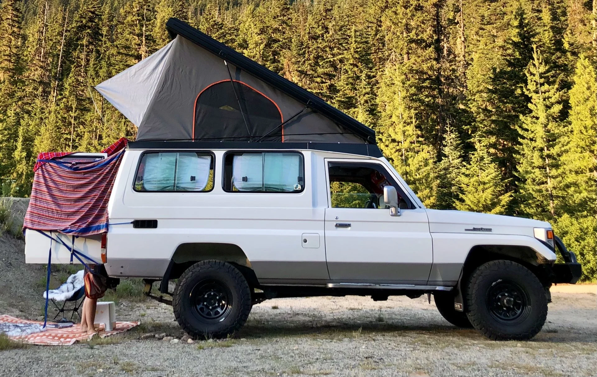

Hi, I have a 1988 HJ75 Troopy and a 1993 HZJ75 Japan Fire Truck. Both of them need discs.

my 1988 Troopy is from Costa Rica and the '93 is from Japan. All drums everywhere.
