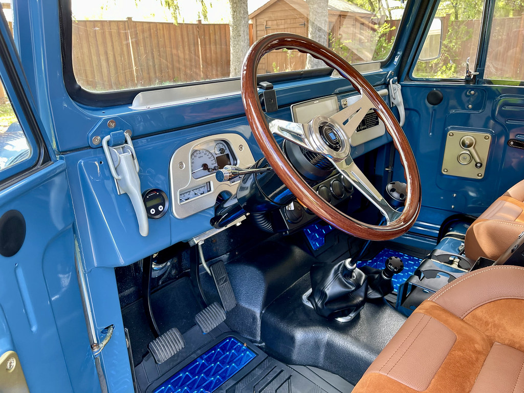

I have a 65'. Can you tell me what seat bracket you are using for these seats? Is it the factory bracket with adapters? Something you fabbed up?
I'd like to put buckets and a center console in my ride and am curious about options. Thank you.
Steve, what beautiful work!
Are you speaking of the new seats coming from TMI ? (brown) ... these come with the double locking sliders.
So I custom make all my own seat brackets etc ... very easy if you can weld, oh and as well I purchase the entire seat frame kit from one of the members here (forgot who .... mmmm )

Morning J ... this is the best pic I could find but I believe we simply mounted it to te firewall but had to bend the pedal shaft a little to move it away from the brake pedal '
