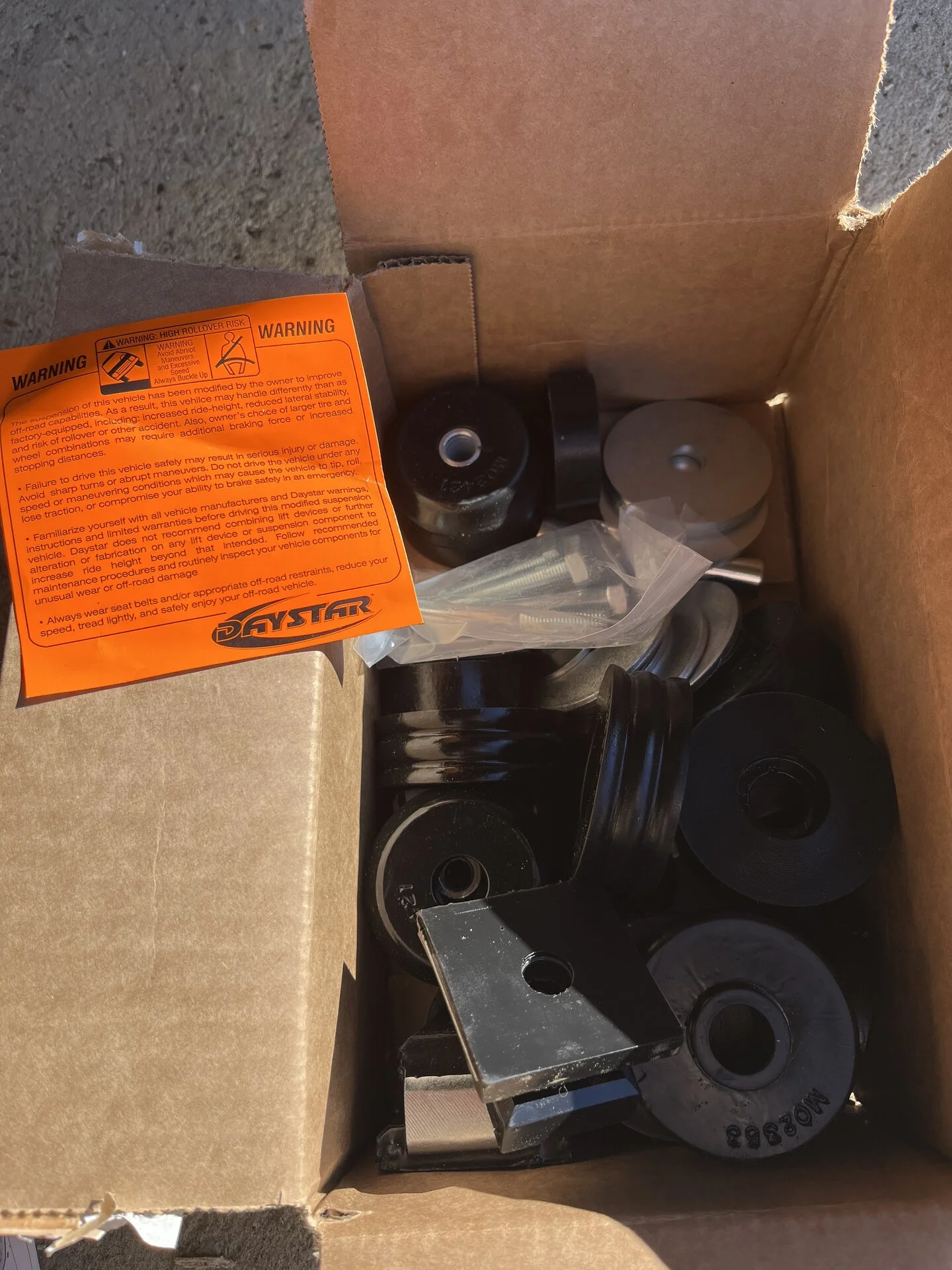

New to the group. I’ve just started a 45 build after accumulating some parts. The frame does not have any mounts to work off of. I bought a daystar body mount kit and wanted to see if anyone has a diagram of what goes where. I’m scratching my head. Thanks!

That’s where I got this one. I just don’t have much to work off of, since there weren’t any on the chassis when I got it. Any of you have an early 45 LWB that you could snap a few pics of the locations? I just don’t know what goes where. Thanks
Again, it’s been over 30 years, but as I recall, the tall round ones went under the back of the cab, and the thick square ones went under the forward frame extensions that the running board stays attach to.
For the bed, rest it lightly on the frame, use some wood shims to even the spacing out, and you can tell from the gaps where the bed cushions need to go.

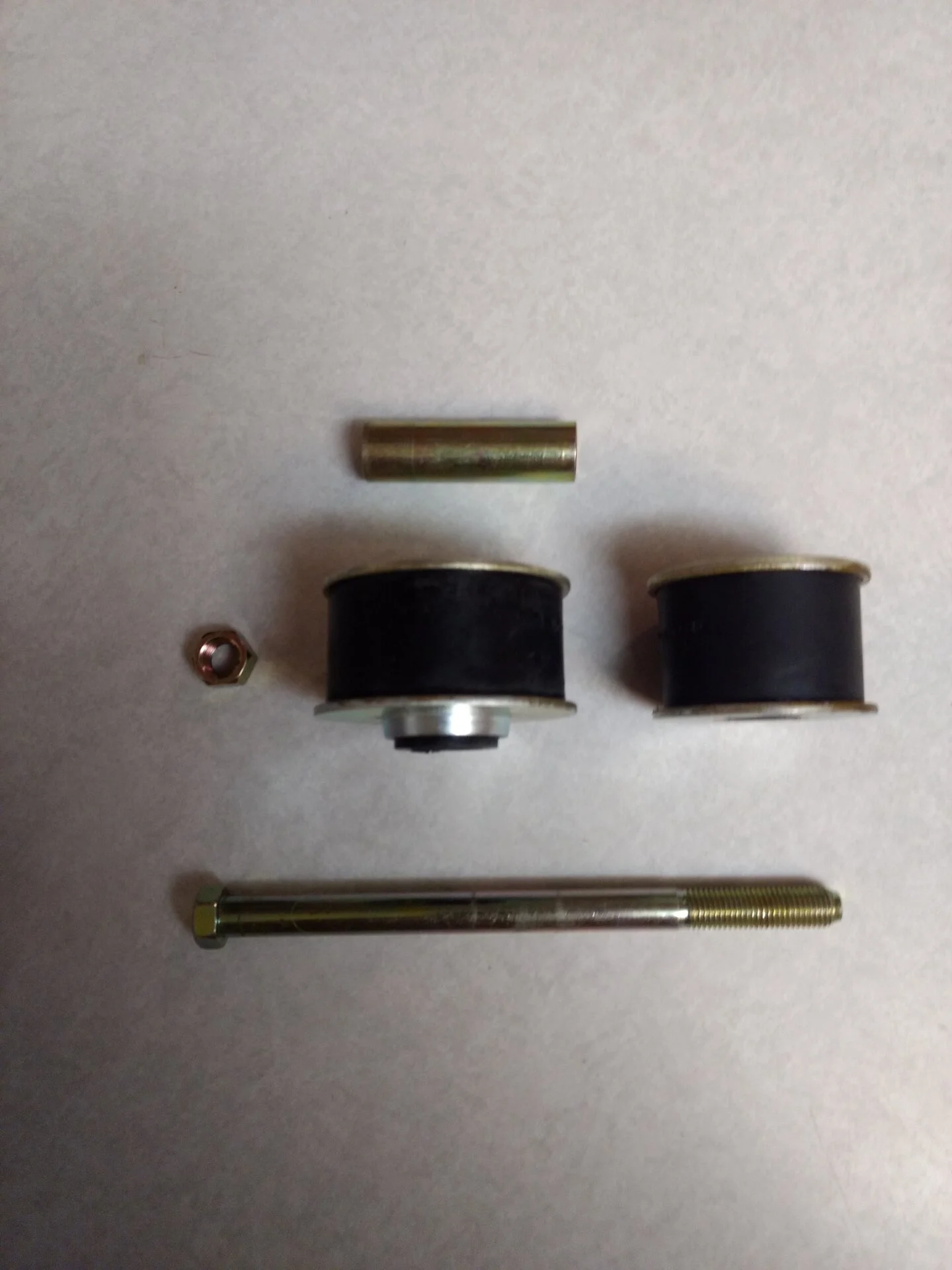

I'm away from my vehicles. But, the tall 40 puck by running boards, then a circular one between back cab mount. I can snap pics this weekend with measurements. Front 40 mounts under bib, running boards, and front of cowl, 55 style back of cab sandwiched down with sleeve inside.

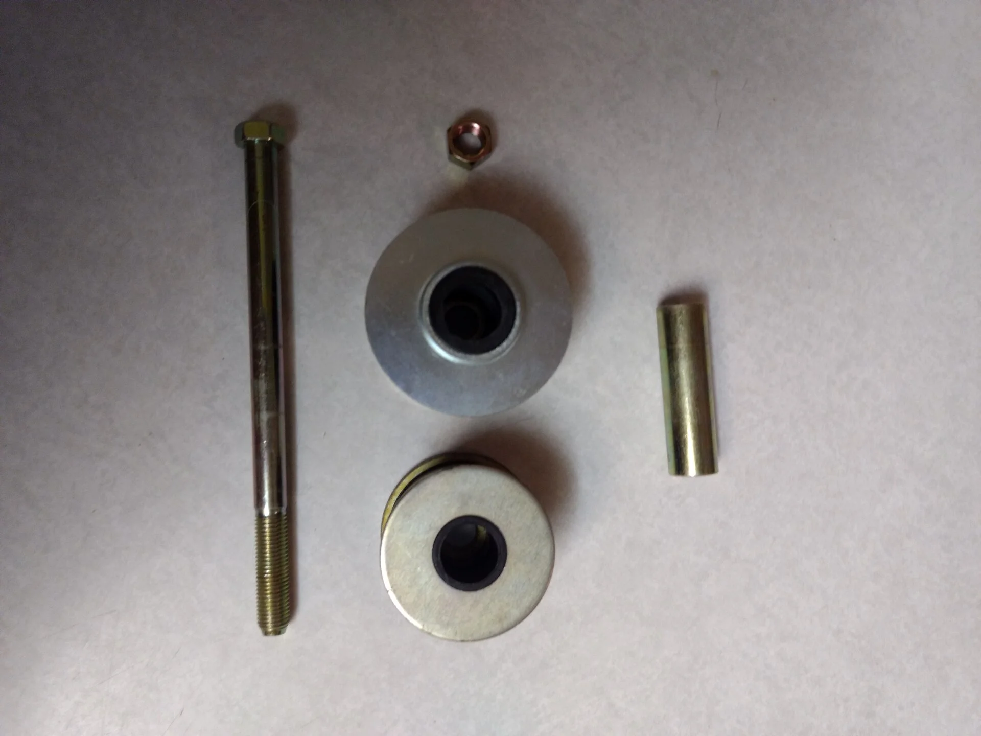

All of the round ones (several different sizes and shapes) are two piece. Got to match them all up. There are three sizes of washers and a few sleeves for bolts. No hardware.
