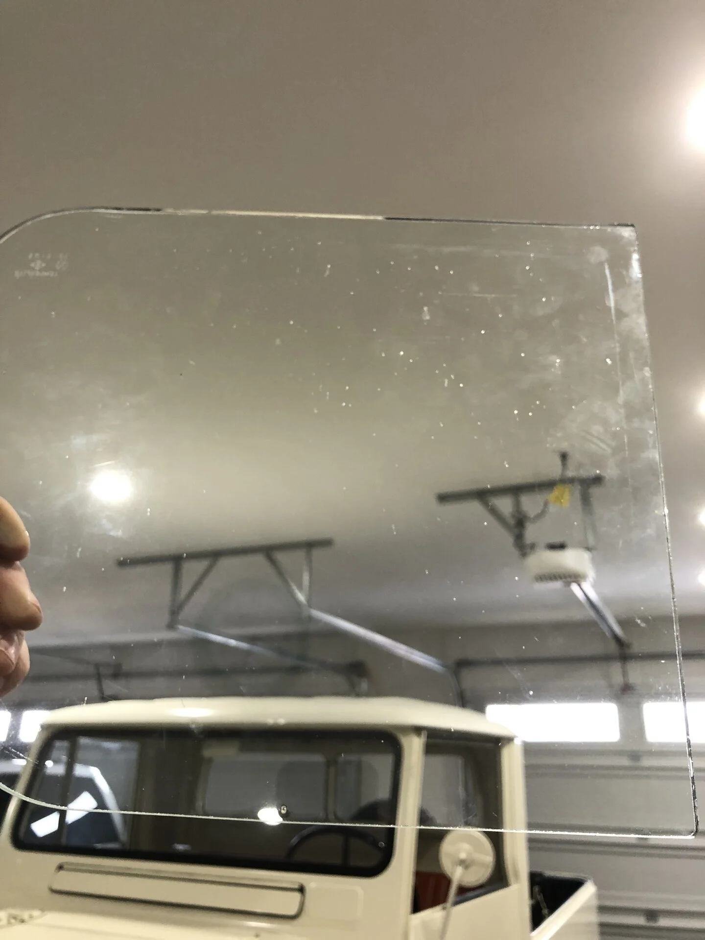

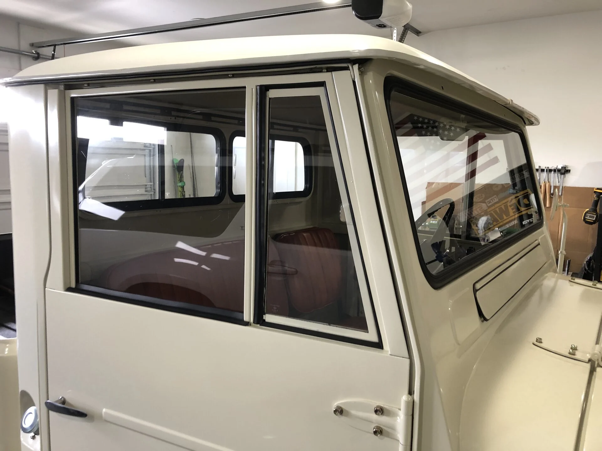

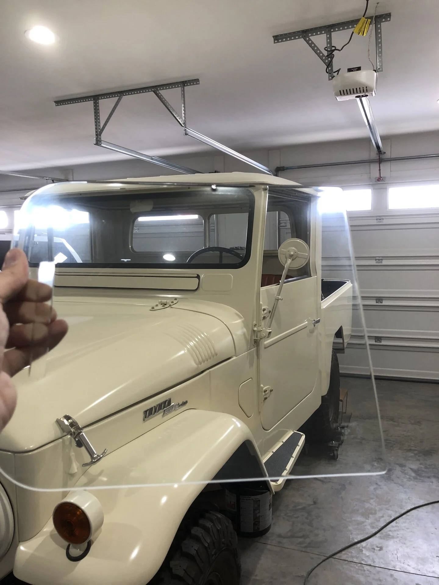

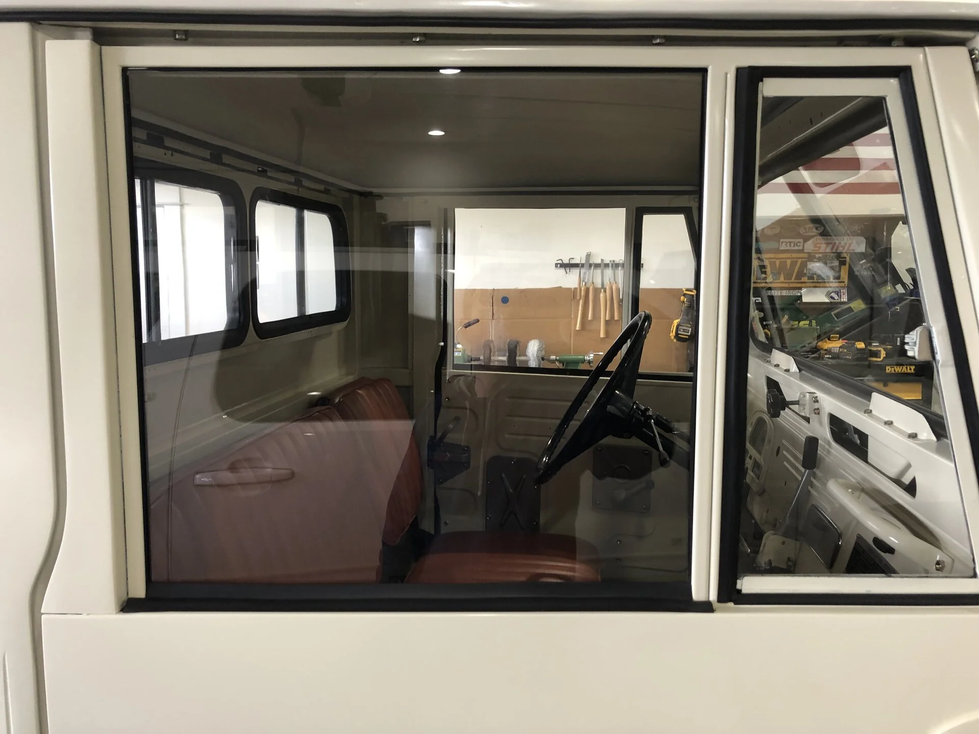

Also was able to sand and polish the glass and get the welding slag pits and bad scratches out. They are not perfect but much better.
Curious to hear the process on the glass sanding/polishing? Results look great!
I used this kit ! And they have many videos how to do the process. It’s hard and a little stressful with tempered glass and you have to take your time. Depending on how bad the damage is will determine the amount of effort and time it takes. If not severely damaged I don’t think it would be very hard. Mine was bad. I rushed a few and there is some distortion in the glass. Again better than all the welding pits but a little distorted.
It’s a messy process. I probably spent 20 hrs on the rear glass and just the two roll up glasses. You can easily clean water spots and small scratches.
There are plenty of tricks and things to look out for. Anyone wanting more info feel free to message me.
It would be a long post to write the entire experience out. Lol
Glass Polish 25022 PRO Glass Scratch Removal Kit for Professional Glass Scratch Repairs - Ø 5 inch with 5/8-11 Thread https://www.amazon.com/dp/B07TS84Q46?tag=ihco-20

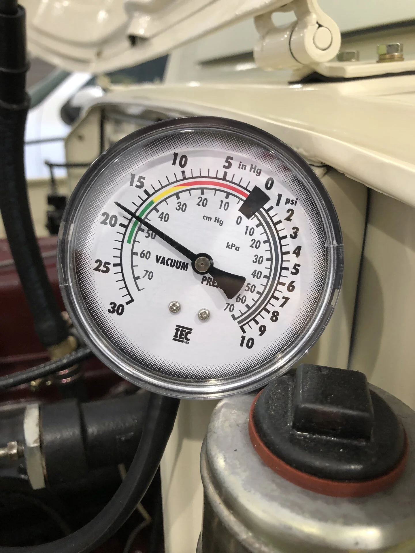

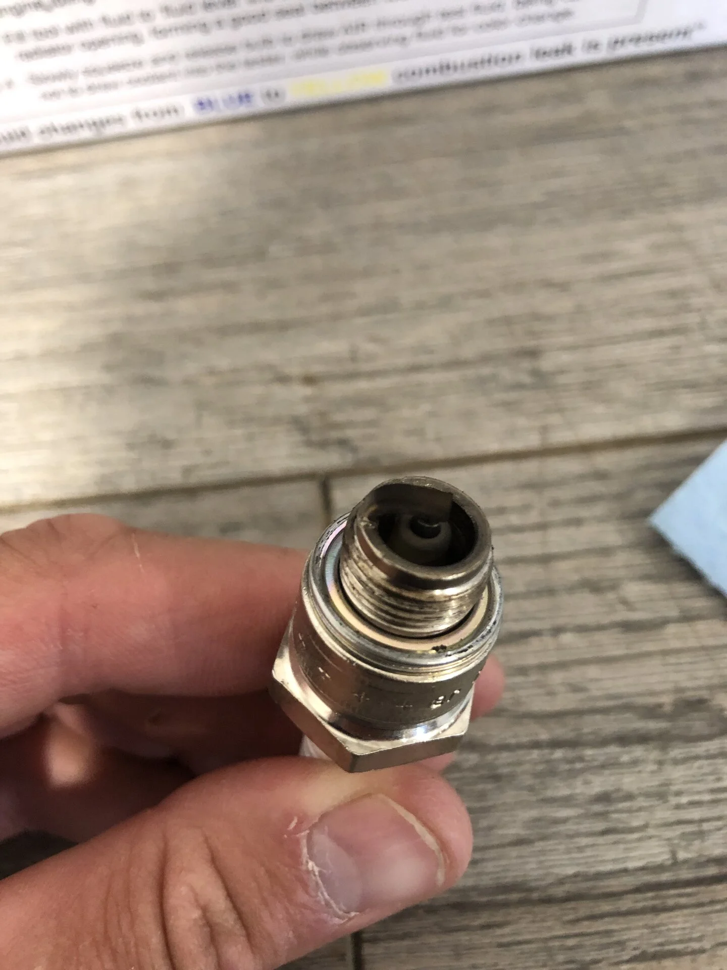

Well I put some new valve seals in. Adjusted clearance and exhaust smoke was slightly better. I let the truck run for a while tonight. But wasn’t able to drive it yet. I did one of those blue chemical block test kits on the radiator and wasn’t getting any discoloration. While doing this I played with the carb adjustments and was able to get vacuum around 18-19 idle at 700 ish and smoke is slightly better. Spark plugs still show black carbon. But they seem pretty dry and with one wipe they are clean again.
I’m guessing since I’m driving it maybe?? And still maybe running rich?

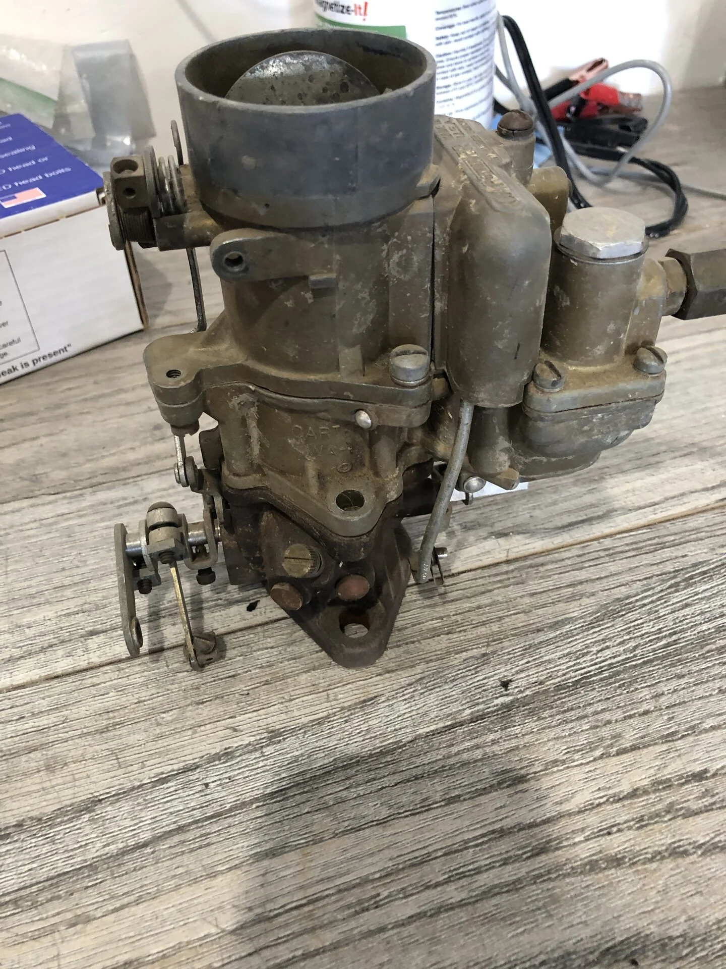

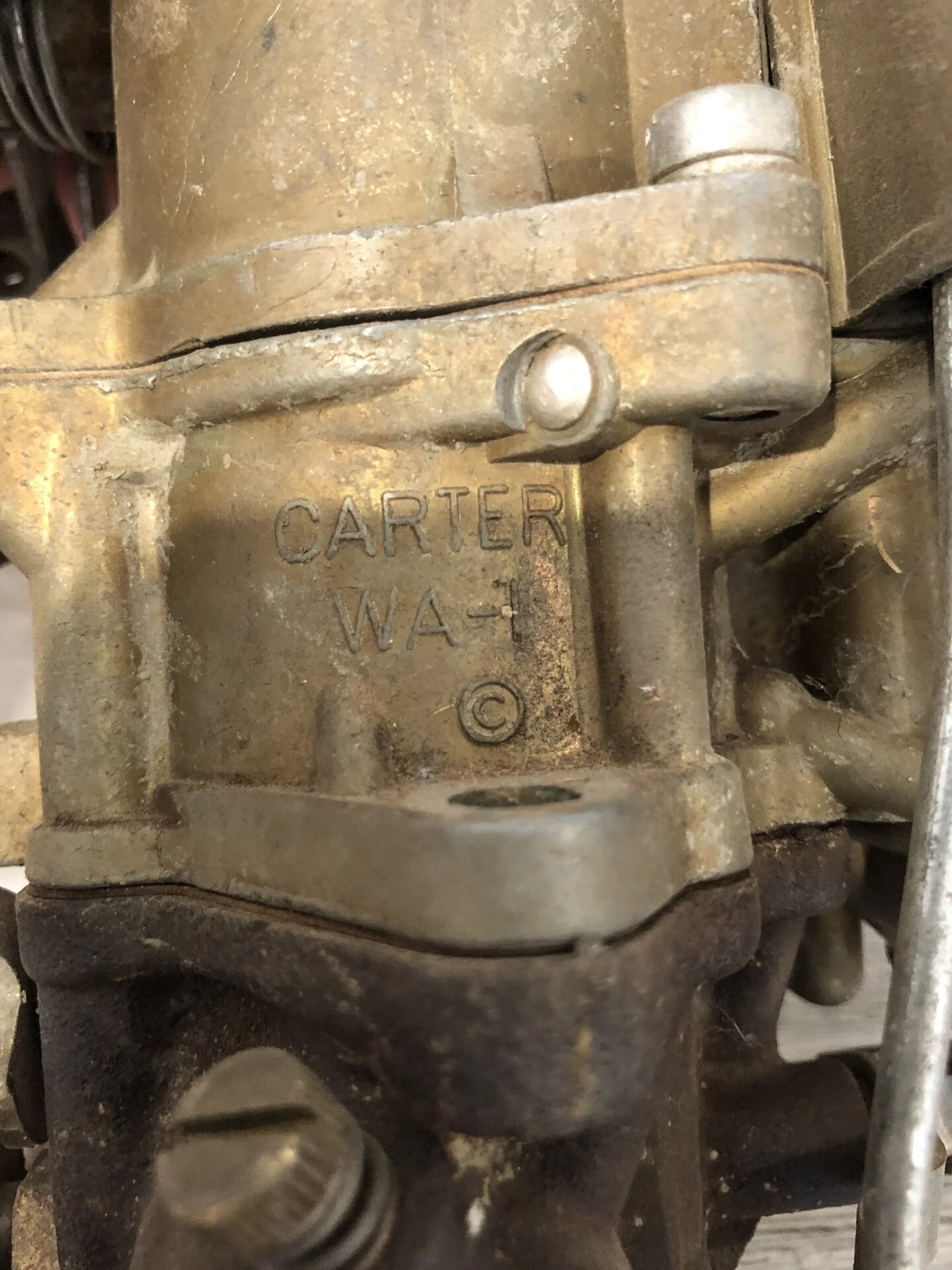

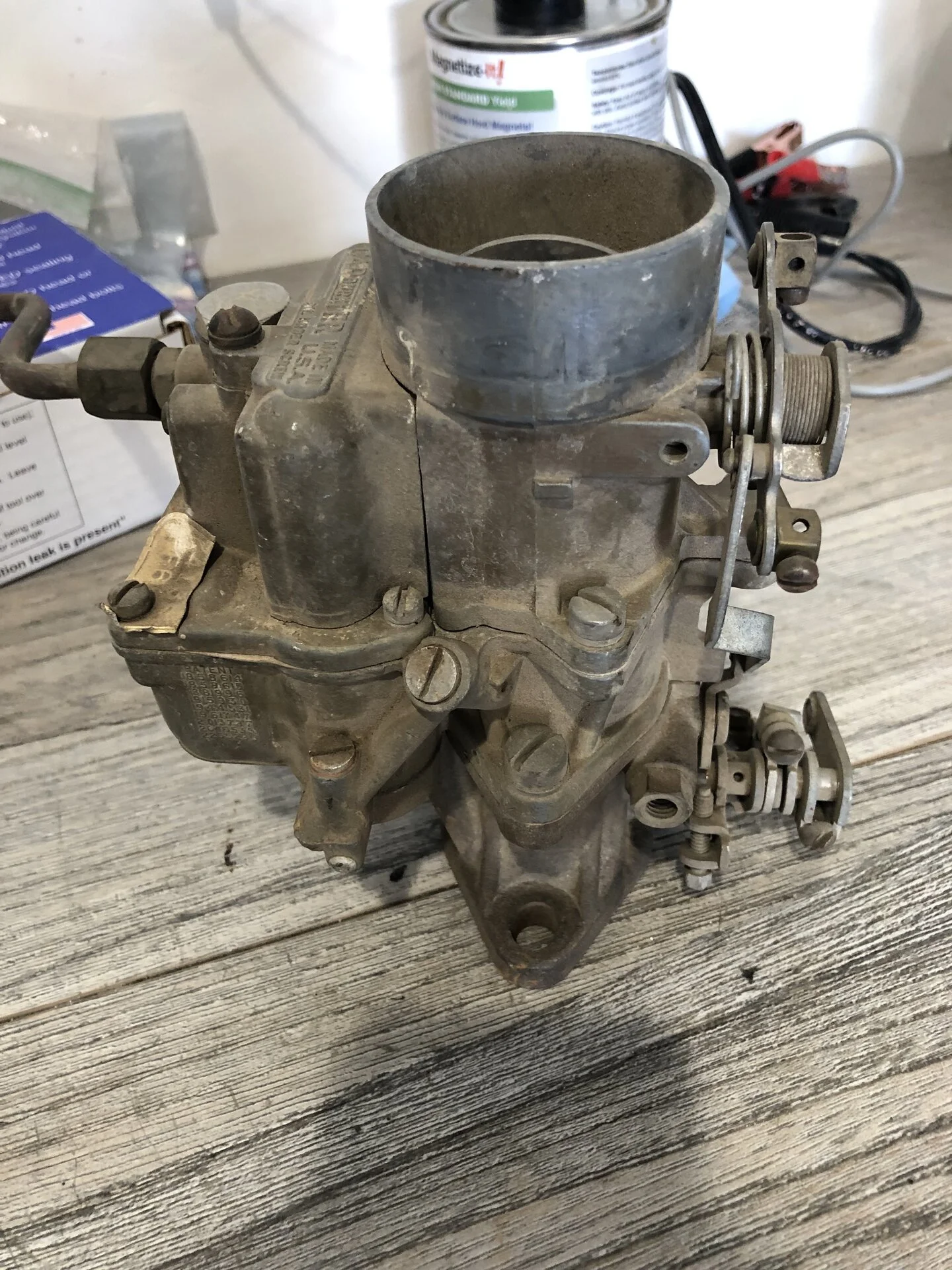

Also I found this old carb. Original??
Who might know someone trust worthy and knowledgable enough to rebuild?
I’m not positive the one I current am using is original. Would be nice to have correct one installed.

vacumn looks good
compression #'s are right in the middle range
Carter is not an OEM carb

Vacuum and compression are fine. You could just be suffering from non-functional oil rings (aka broken, stuck). Only way to determine that is to pull the pistons. Are you burning oil? If not too much, a little blue smoke helps with the mosquitos. Maybe try some SeaFoam and see if that cleans things up a bit.
I’m running two of those WA-1‘s on my dual carb Offenhauser setup, cuz’ I’m a glutton for punishment 😂. Runs pretty good for a motor that was blowing smoke with many broken piston rings and a slowly dieing head gasket (both/all repaired). The Carter’s are not original to Toyota but are the carbs Offenhauser suggested for their dual carb setup. FWIW. They’re easy to rebuild, simple and fairly dependable. But having spent a few years in St. Louis I’m a bit biased towards Carter (and Ramco piston rings). Mike’s Carburetors has kits for these. And just to prove I’m not a complete imbecile I have two Toyota SD-40’s (those would be original to our rigs) with rebuild kits sitting on the shelf for a truly smashing, and probably unique, dual “big glass” setup, someday.
