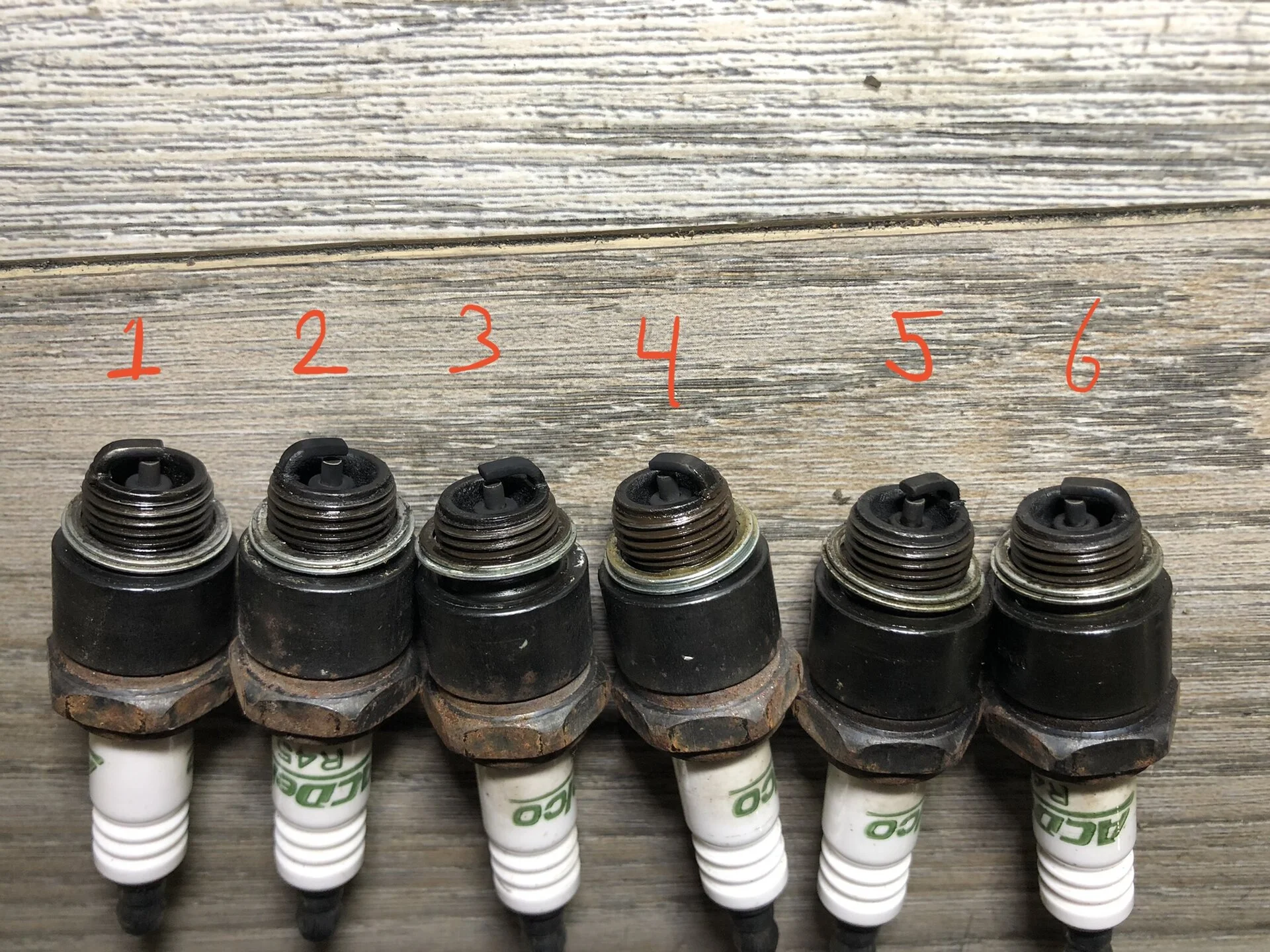

I did pull the plugs and they seem pretty dirty to me. Which I’m guessing could have to do with the timing being off and such.
