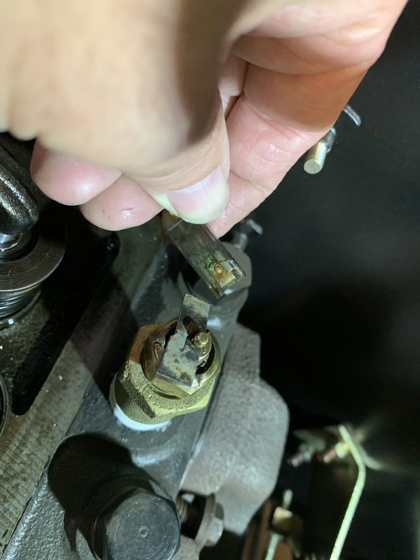

question. How does the wire connect to the temp sender? I have some kind of pillar on the sender which is oem I think. There is a metal blade clamped on it.

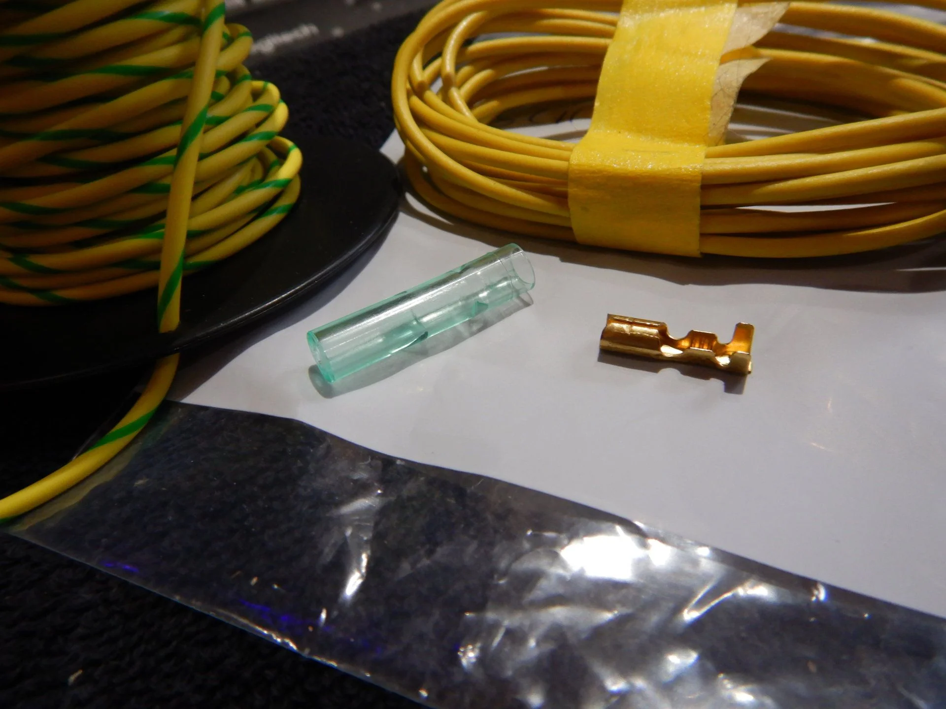

if u PM me your Wire color , Solid Yellow or Yellow w/ green tracer stripe ?
and your desired Length , i will have a Factory OEM Parts Maker YAZAKI Service spec. Repair Connector
pigtail in Mondays Mail out To Ya H55F Fast ...............

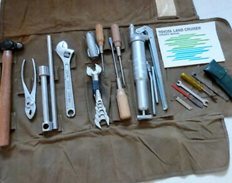

If you don't have a tool roll for this truck, I think @wscbill is selling a complete mint '62 one on EBay. Ideally you would not have a single one of these tools, making it possibly cost effective.

Thanks Matt. The connector on your picture is not the one I need. I have the right connector on my wiring loom but need the right temp sender. Will try the one from the FJ45V first.

- what year is your truck and engine, it looked on the early side ?
- this is one choices a OEM toyota Water senders w/ male button connector 83420-20010
- I can source the correct OEM TOYOTA YAZAKI parts maker Sender , if you need me to ....
