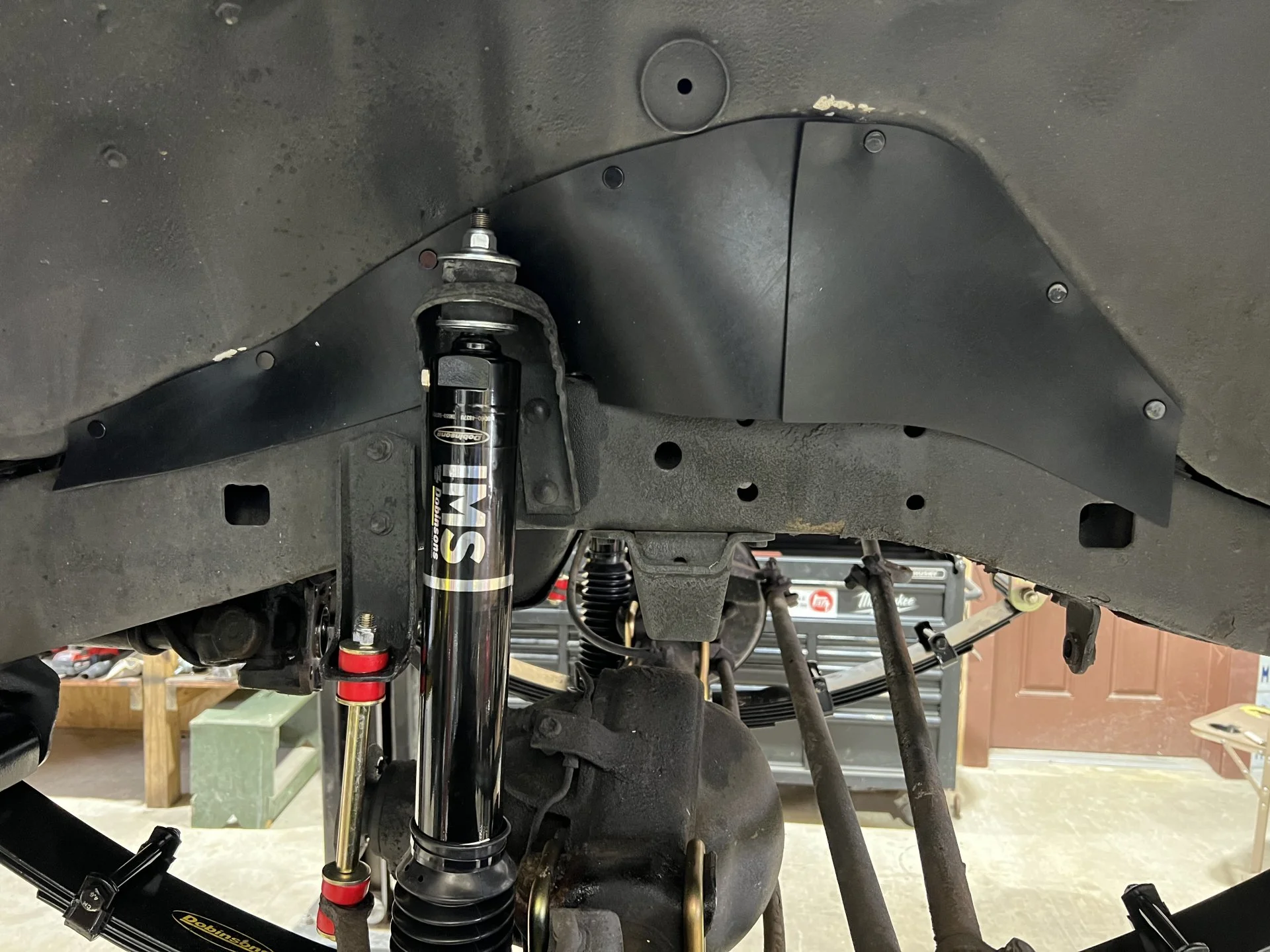

Finished off @WharfRat ’s lift finally with some 4* caster shims from Georg.
Also he sent us some reman loaded calipers for a brake upgrade
