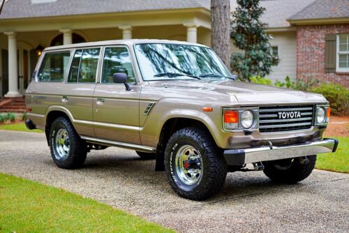

Damn nice 60 local. Never seen it.
@JTU is about to but this one on Bring a Trailer. Someone needs to get this one and keep it in the family.
I have no doubt. I just wish JTU was more of a non-purist like me and opted for a GM connect and cruise swap instead during this build.
I’ll be happy to repurpose the proper drivetrain into something else. It’s got the radiator for the LS swap already.
