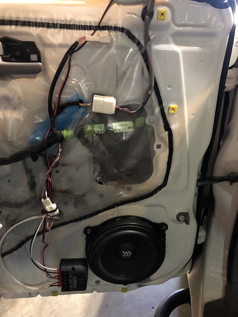

For now, here is what the final-ish setup of the speakers looks like. @87warrior I know you had said you were looking at getting the Morel's, just an FYI there is LOTS of stuff in the box, including specifically sided terminal ends for the woofers. USE THOSE when you run your wire, the fit SOO much better than anything I had laying around.
Right now the crossover is only stuck to the door via heavy double stick tape, when I do the sound deadener install I will put some nutcert/rivnuts in the door to hold them in place better.

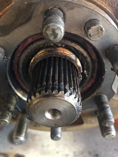

Once all that was off and the flanges were off, this is what they looked like. They definitely were original, had some decent wear but were still in pretty good shape. Gonna see if I can find someone to send them off to and have them milled out for that "just in case" moment that the axle/splines break and I need to run them with center diff lock on.
Untitled by Greg Fisicaro, on Flickr
Bearings were pretty nasty. Looks like when the shop installed the cheap axles and were installing the lift they pulled the rotors and packed the cavity but never repacked the bearings or anything. Luckily they still spun smoothly and didn't seem to have any play.

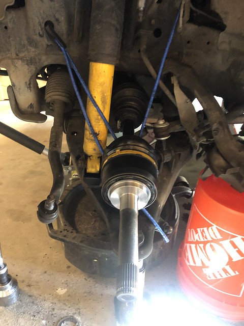

Best part was when I went to remove the old axles this is what happened!
These DEFINITELY are not RZEPPA type bearing tulips, they are tripod and hence the vibration issue. I literally just gave a quick tug to see how tightly they were in there and the tripod popped out and wouldn't go back in (happened on both end). So that makes me believe there is no retainer ring or anything like OEMs have to keep bearings in place and axle from traveling too far.
I did end up weighing the cheap axles against the OEM and not only do the OEM feel much more hefty, they are heavier by a good 2lbs via my unscientific weighing of me, me + AM, me + OEM.

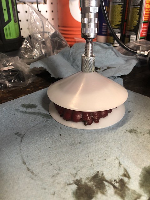

New T-seals for diff tubes
Everything torqued down to 14.5lbs of preload. Ended up having to do about 52ft/lbs of torque on the nuts to get the appropriate preload, but all in all spins nice and smooth. Needed a 1.8mm snap ring on drivers side and a 1.9mm on the passenger side. Both fit perfectly and were just loose enough to spin in their grooves with a little effort, otherwise they were nice and tight. I got a timing belt job coming up at 200k (another 3k miles) so figure at that time I will go back through and check everything to see how it is doing.
