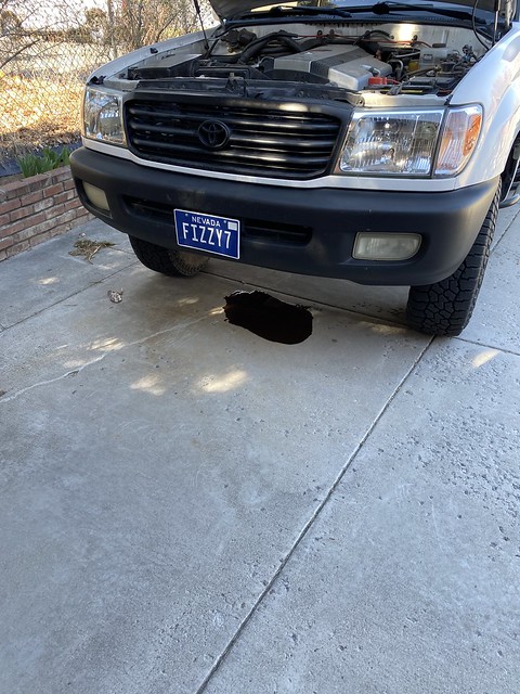

Yesterday was at the Ex's place to take the dogs out like I normally do on the weekends. Get done with a walk and let them in the garage like normal and started to walk in to the house like normal to give them after Dad-time cookies when for whatever reason I turned around and saw the below.
Untitled by Greg Fisicaro, on Flickr
Looks like the 1k+ mile trip last weekend to Hurricane, Utah ended up being more than the steering rack could take. Not sure if the seals on the TRE on that side just completely blew or if it is the rack itself but she turned over 207k on the way back so definitely on the "older" side of usage. I had noticed that she was making a little bit of noise this week but leak is down low after pulling the skid plate and looking around (no wetness or anything up by steering pump and now lines looking like they blew).
So she will be getting towed to a clubmembers house that does work for our club as I am currently without garage or tools to handle on my own. Still haven't handled the P0171 code either so there will likely be a few things handled while I am having him do the rack or TREs (whichever it is).

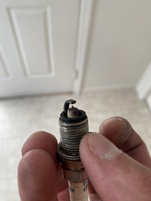

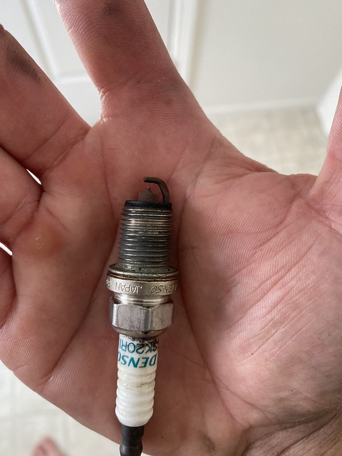

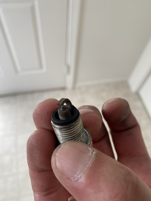

Interesting development was that yesterday on the way back down the mountain she threw a new code.... P0301.
After getting home and letting the engine cool I pulled the #1 cylinder coil and plug to investigate.
#1 Plug
#1 coil pack
The plug was IN THERE and still had the original grey sealant stuff still around the threads so this confirms my belief that I am still running factory plugs. So I will stop by the local O'Reilly's today as their website shows they have Denso and NGK stuff in stock and ready for pickup. Will replace all my plugs this week and see if the misfire code resurfaces. If it does on that cylinder then I will know that the coil pack is bad and grab a new one (which I might anyways).

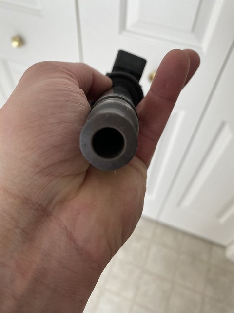

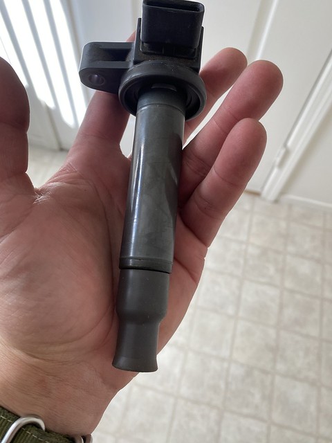

#1 Plug
#1 coil pack
Thing is that I have noticed a rough idle having developed in the last few weeks. Truck hasn't lost any power, no rough feeling any other times, just at idle. Thinking that I am going to order the new coil pack as that #1 coil could be going but just not be throwing a code, which from reading seems to be a pretty good consensus.

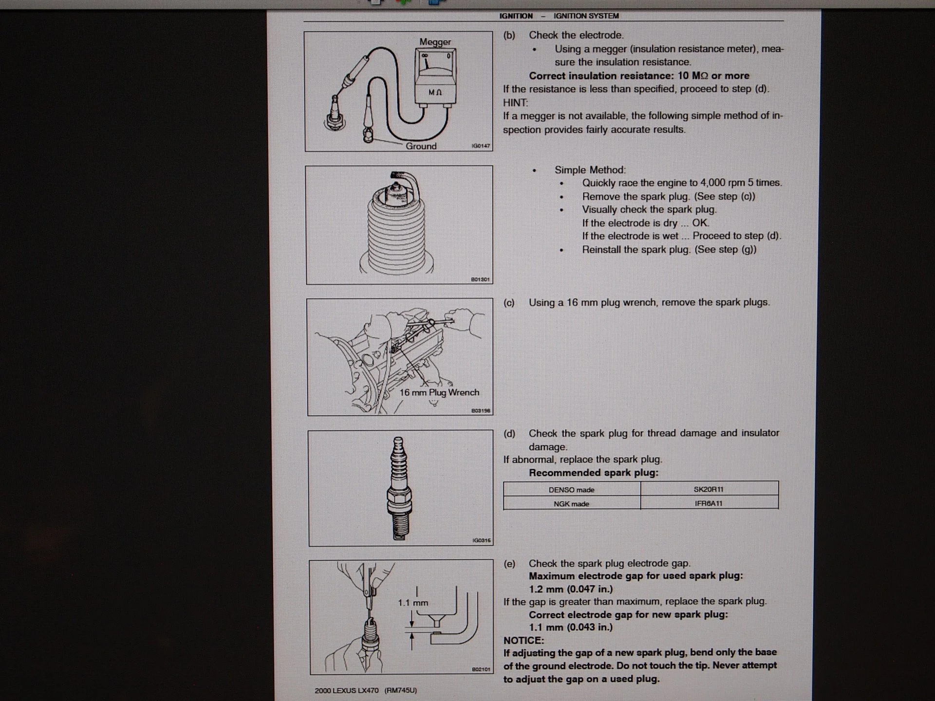

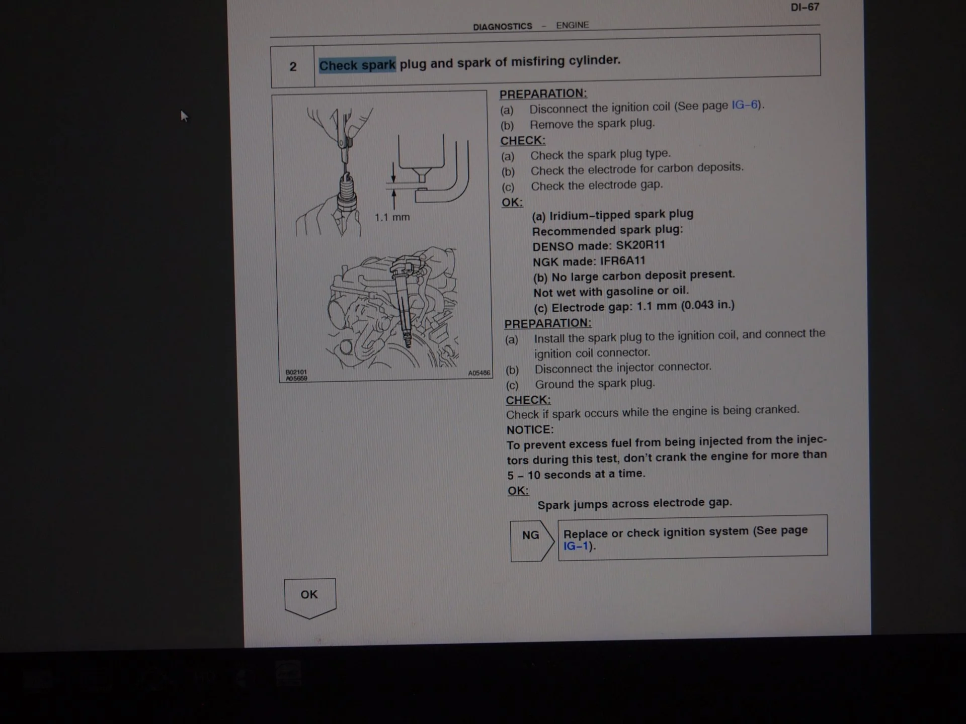

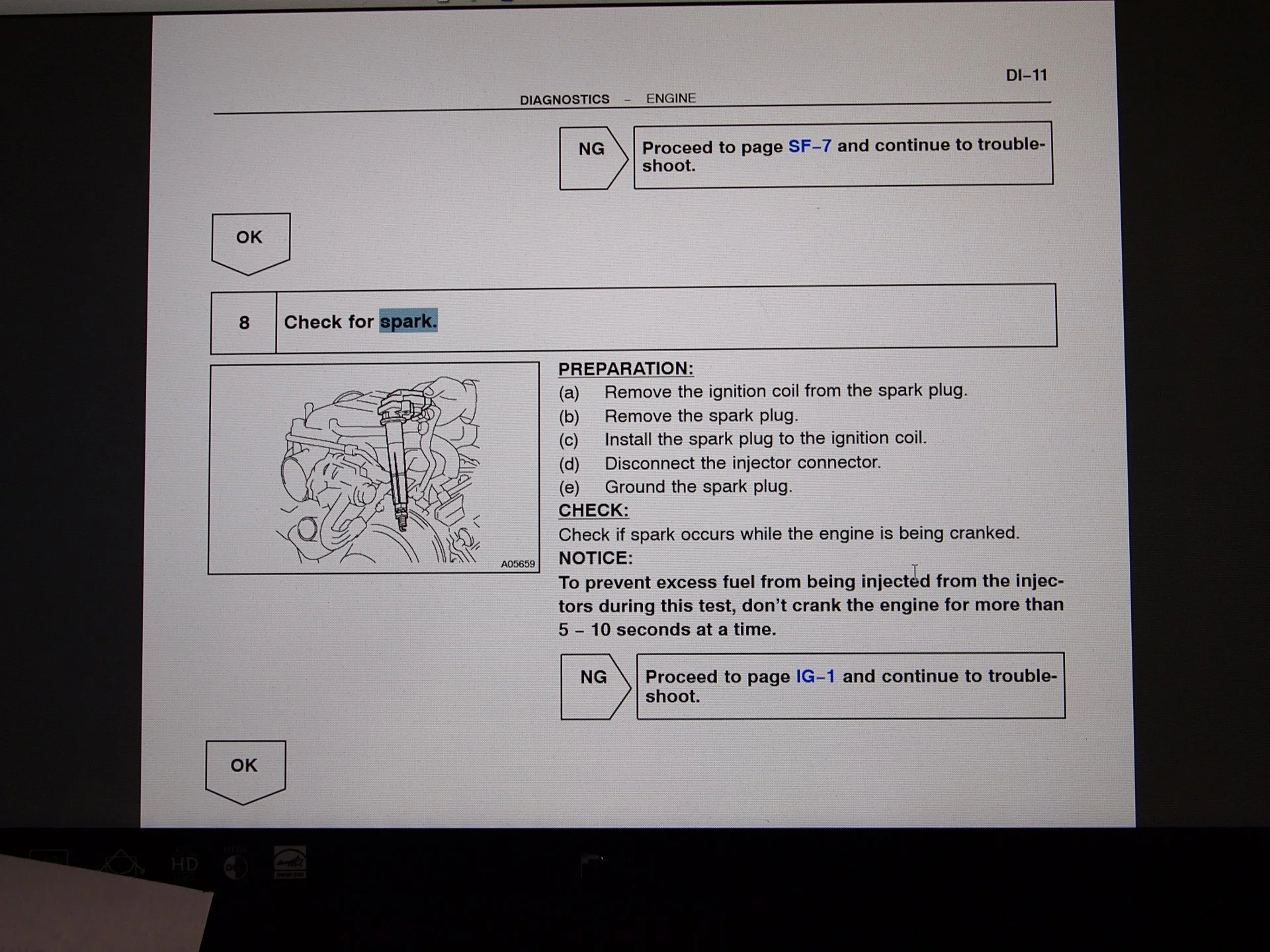

Swap coil with #3, see if code moves! You can also check it's fires (sparks) the plugs.
Plug are tested in 3 ways, without specialized equipment:
1) Gap std 1.1mm. Replace if 1.2mm>
2) Check that it fires (sparks).
3) Ground.

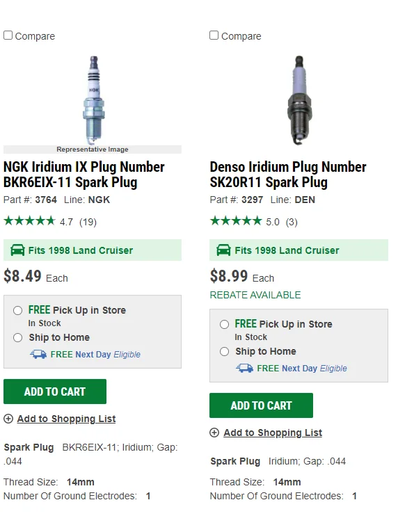

Regardless the plugs are getting replaced seeing as they likely never have been based on above pics. I have two Denso coil packs coming as test items just in case I do have an actual misfire at one of the cylinders.
