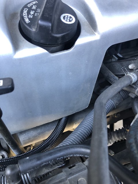

Only possible gripe I found was that the engine hook to fender apron cable is thick enough that it makes slight contact with the plastic engine cover/shroud. First world problems really as it barely contacts it, at this point I have not heard any rubbing or anything in the engine bay when the engine is running. If nothing else I will attempt to reposition the cable or clearance the shroud by filing off some of the plastic there. Really many of the trucks that I looked at were missing the shroud before I purchase Alita. So not a huge deal.
