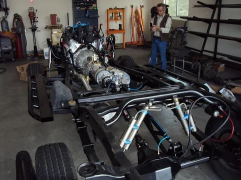

This is my neighbor taking a picture w/ his cell phone. I can't thank him enough, he was there everyday helping me, pushing me and encouraging me and I couldn't have done it, especially so soon without him. Thanks Chuck

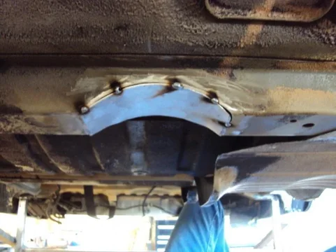

Before undercoating the body we had to notch this part for driveline clearance
It is always great to have some one around to keep you motivated whether they are just a tool monkey, or tons of help.

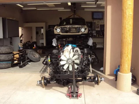

After cutting out all the wires and crap it didn't need and tying into the new stuff, this is what it looks like under the hood. I didn't take any pictures of the air filter box being made but you can see it here. Chuck did a great job of cutting all the peices to fit just right and then I welded it together with a lid and latches.

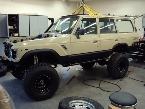

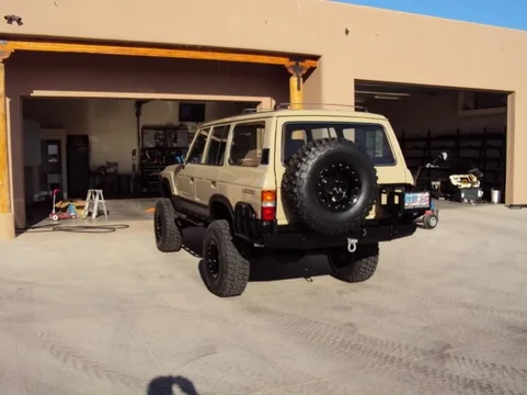

After buffing out the old paint and putting a coat of wax on her these are the finished pitures.
