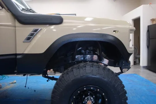

The hard part is plating off the rockers. Using a cardboard template my neighbor made a nice sheetmetal peice and I tack welded for what seemed about a week.
Finally filled in all welds then all was ground smooth and awaiting a coat of bedliner
So I'm staring at your last pic (post # 18) which appears to be the rear of the vehicle, and I'm not quite sure I understand why the diff is pointed in that direction.
The plan is to use double cardan driveshafts front and rear. The diff is pointing at the t-case output flange. Is that what you mean?
EDIT Now I understand. Its an optical illusion.
I was originally going to take it to Linex to be sprayed but I decided to do it since that would be the only thing that we wouldn't do ourselves. My neighbor was a BIG help.
I found this product Raptor U-pol bedliner two part w/ hardener.
It comes w/ spray gun that you have to throw away when your done. It hardens on you in about 20 m,inutes.
You have to pull off the tape right away while it is wet. The end result was better than I had expected. Probably wouldn't be the best bedliner but was perfect for this pupose. Very hard and durable.
