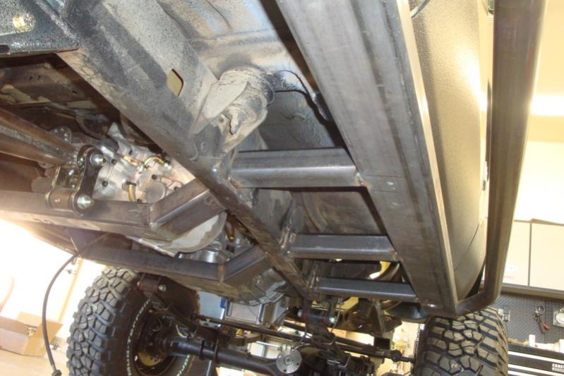

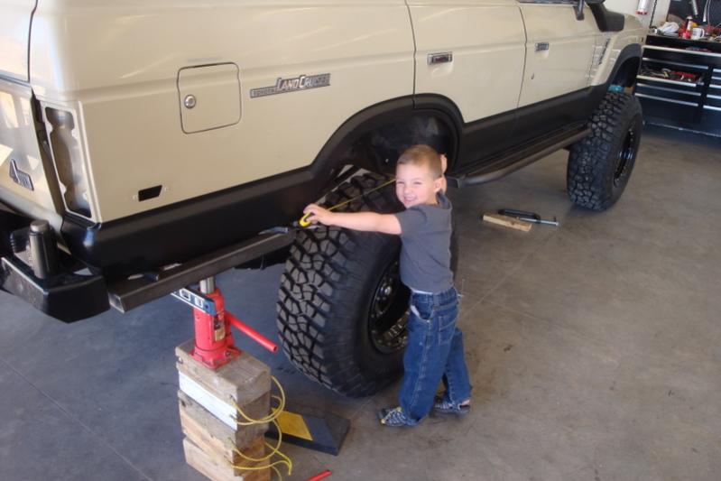

After the bedliner material was applied we could start on the sliders and quarter panel guards.
I used 2x4 .188 wall rec. tube for the main rail, angled and capped the ends and spaced it 1/2" under the cut rockers. We fish plated the frame w/ 1/4" plate and made 4 runners from 2x2 .250 wall sq. tube and heavily tacked them in while holding the main rail in place w/ a jack.
At this point I planned on finishing all the welds after I take the body off to paint the frame.
I bent up some 1.75" DOM tube for sliders and tacked them on.
I'll put some short cross tubes in when the body is off.

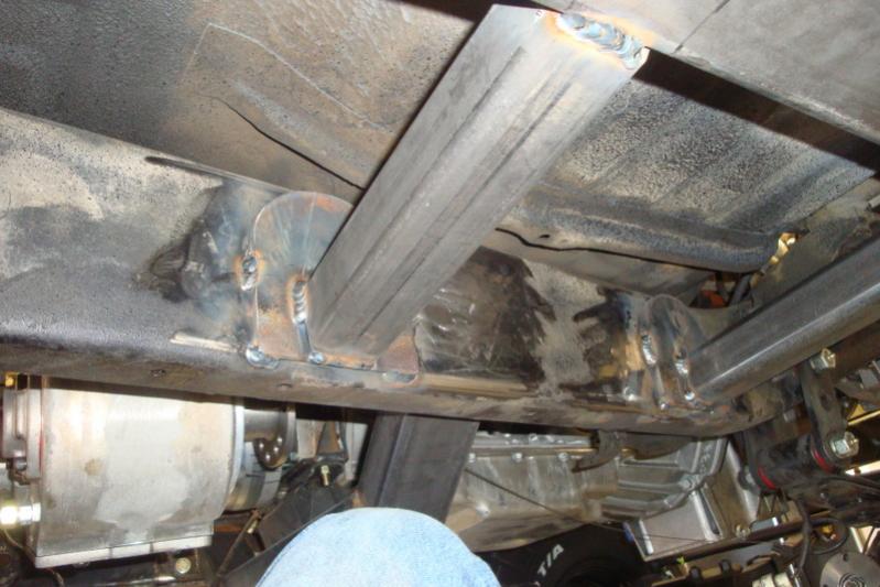

I planned on building a roll cage internally and wanted to tie it into the frame. So before I could take the body off I had to come up with something. I had an extra 2 sets of AA motor mounts So I came up with this tie in and plates to weld the cage onto in 4 points. The cage tube will weld over the 5/8" center bolt.
