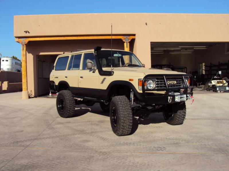

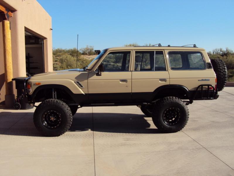

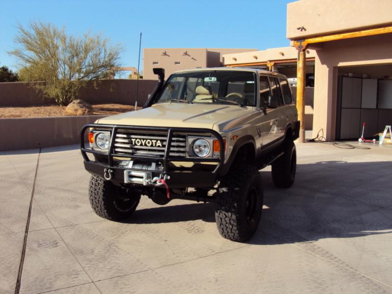

Here are some more. Thanks for reading this thread and all the feedback! see you in Moab:beer:
All the sensors are being used, except the rear O2 sensors were removed.
Hotwire Auto built the harness and programmed the computers.
Its a Ron Davis Radiator. Ron Davis is here in AZ and they already have all the specs. to build an fj60 rad. for an ls1 or vortec.
I only covered the highlights of the project, so if anybody has a specific question I'll be happy to answer it and post up a pic if I have one. I din't think I'd have this much interest considering all the awsome buildups on this website.
