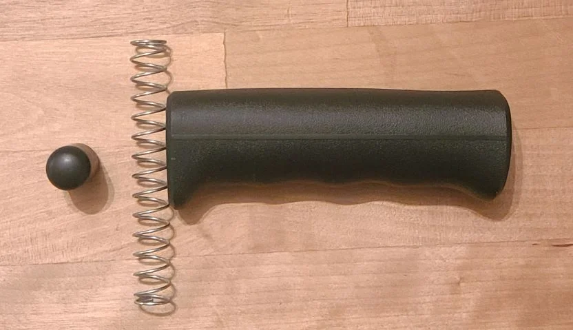

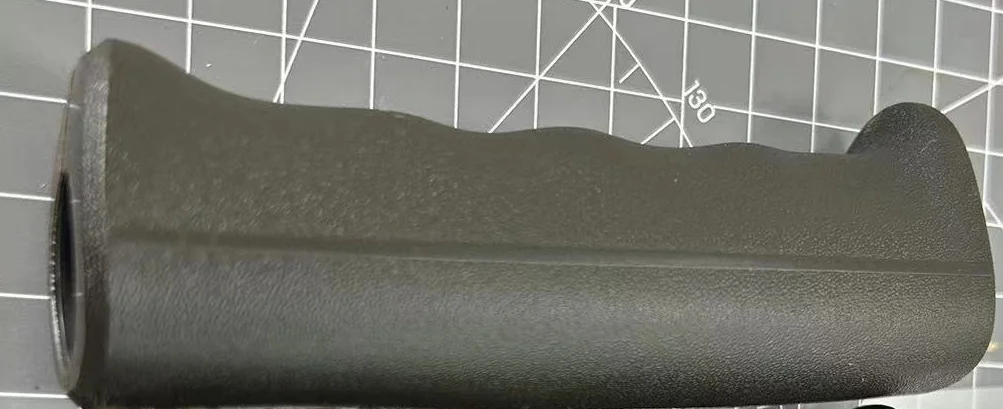

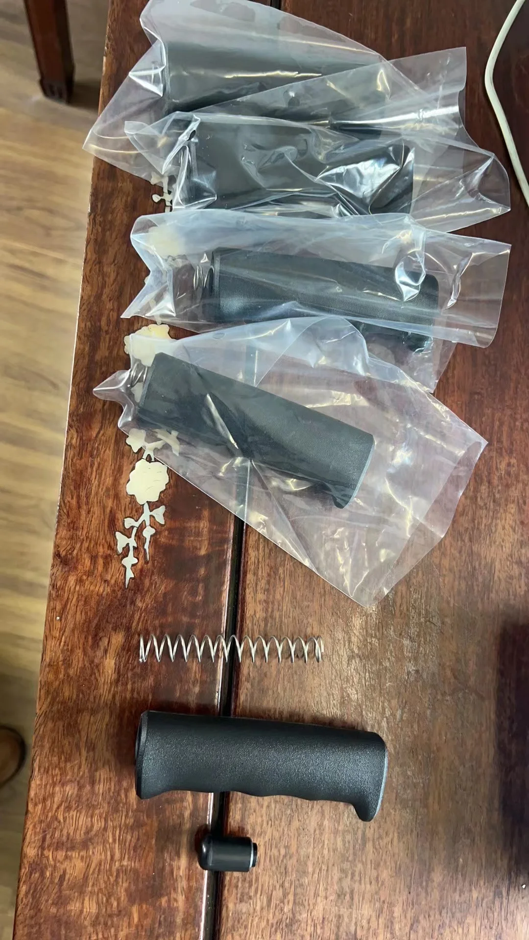

We are launching a parking brake handle rebuild kit:
Kit is available in Black, Dark Grey, or Dark Brown
Comes with a Molded Handle, Spring, and Knob
I pre ordered mine a few months ago. Should I expect to see it sometime soon? The dash bezel was perfect so I am excited to get the handle installed.
Joe- Are you coming to Torfab's party? (I may have asked you that) I can bring it to the party, otherwise it will ship out Wednesday. Seth

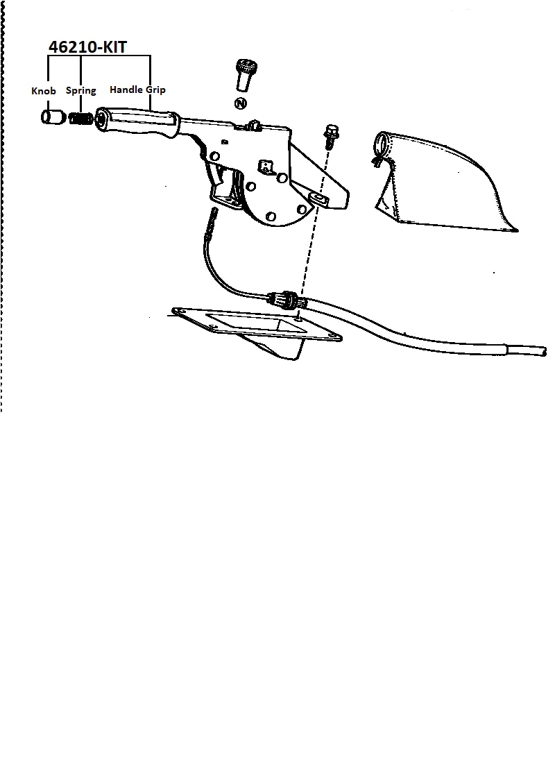

How does the old handle come off? I'd like to extend the steel portion of my ebrake handle,
anyone got any ideas? Or am I gonna need a new handle once I take the old one off?
Utility knife, Die Grinder.... These are two methods I employed during R&D
Other option I used was to take the entire assemble out.
Remove the Knob and Spring
Pinch the very end of the plastic handle in a vise.
Man handle the assemble back and forth and pull really hard

I’ll be ordering your new grip handle...great replacement part, but a few follow-up installation questions first:
(1.) You can remove the old knob & spring with out removing the grip first?
(2.) Removing the entire assembly seem to be the best ticket. So after removing the old grip with a utility knife, grinder or bench vise the new handle grip slips cleanly & firmly over the metal lever and locks securely in place?
Seems somewhat crude, but if necessity is the mother of all invention I’m all for it…my compliments to the chef!

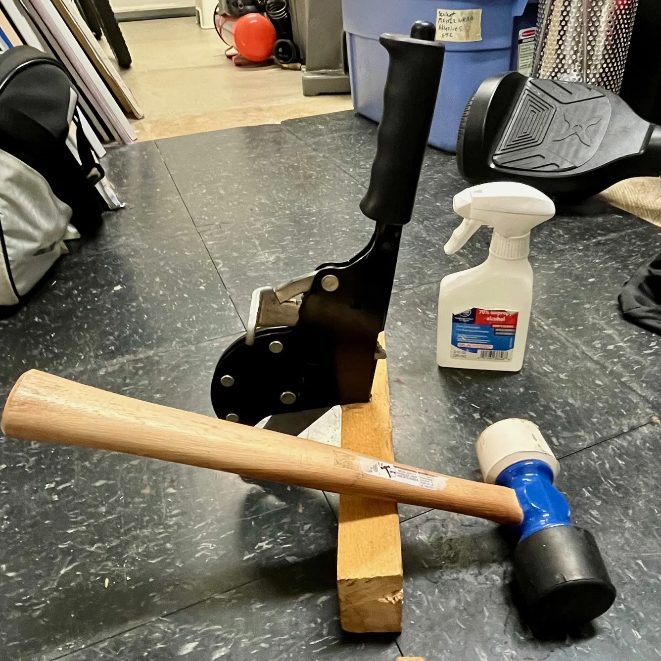

I found a fairly easy way to get the Rust Farmers replacement handle on! First, Kudos to @TRFarmers for this. I've waited a loooooong time for someone to bring an e-brake grip replacement to the 60!
I used a soft hammer, a 2x4, and 70% rubbing alcohol. It worked way easier than I expected. I rinsed off the mechanism with water afterwards! It took so little time with this method!
