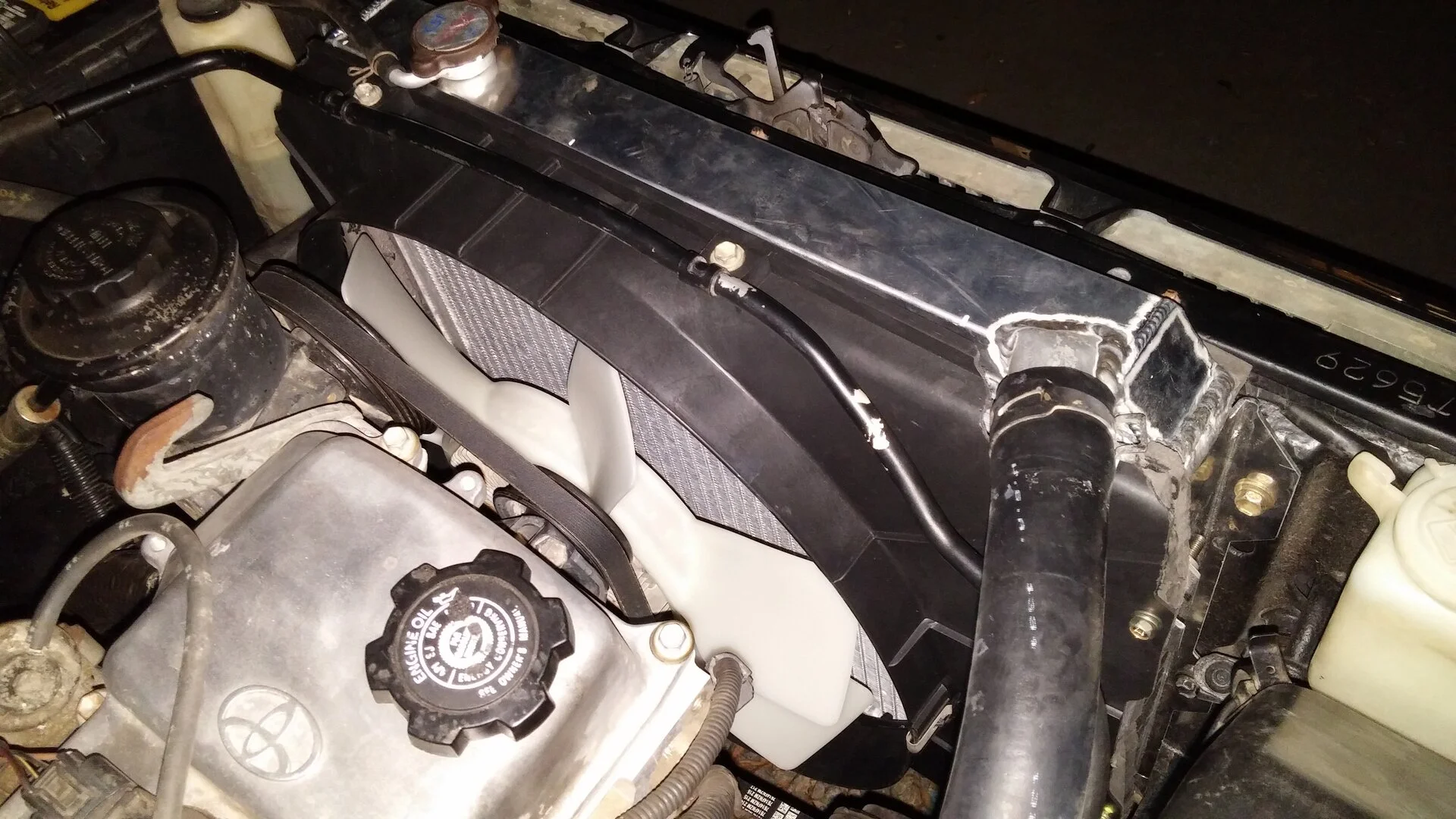

I posted it all up on yotatech back when I did my swap. All the pics are gone unfortunately.

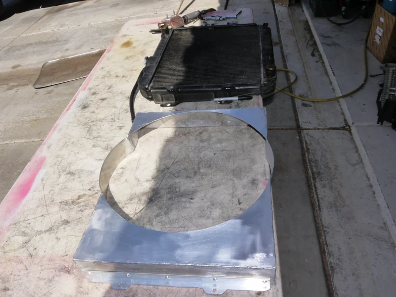

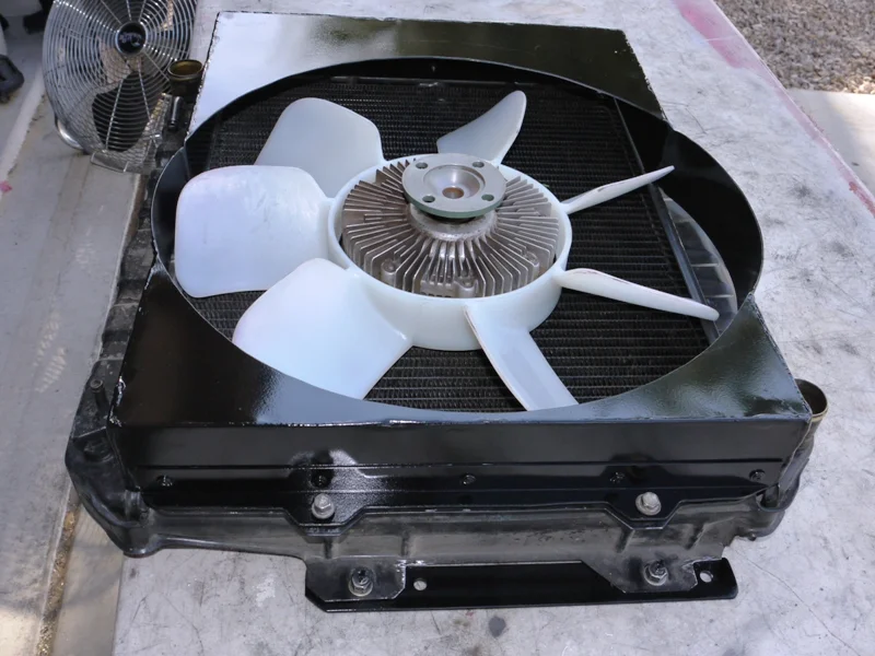

I used sheet aluminum I happened to have and made a box that fit the radiator, stuck out far enough to cover half the fan depth and centered the hole on the fan. (Offset on the rad.)

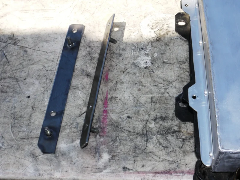

I also made a simple set of brackets to change the height of the radiator. They were just pieces of flat bar with holes drilled to bolt to the stock radiator mounting holes. And new holes with studs/bolts welded on to shift the radiator. In this case I lowered the radiator. I lowered the engine 1 1/2" so I didn't have to cut the hood or use a body lift.
I'll see if I can find pics in my computer somewhere. I can probably take pics of the shroud since I pulled it off my 88.
I have also seen some posts about building custom shrouds with fiberglass for those without a welder. I'll see what I can find.

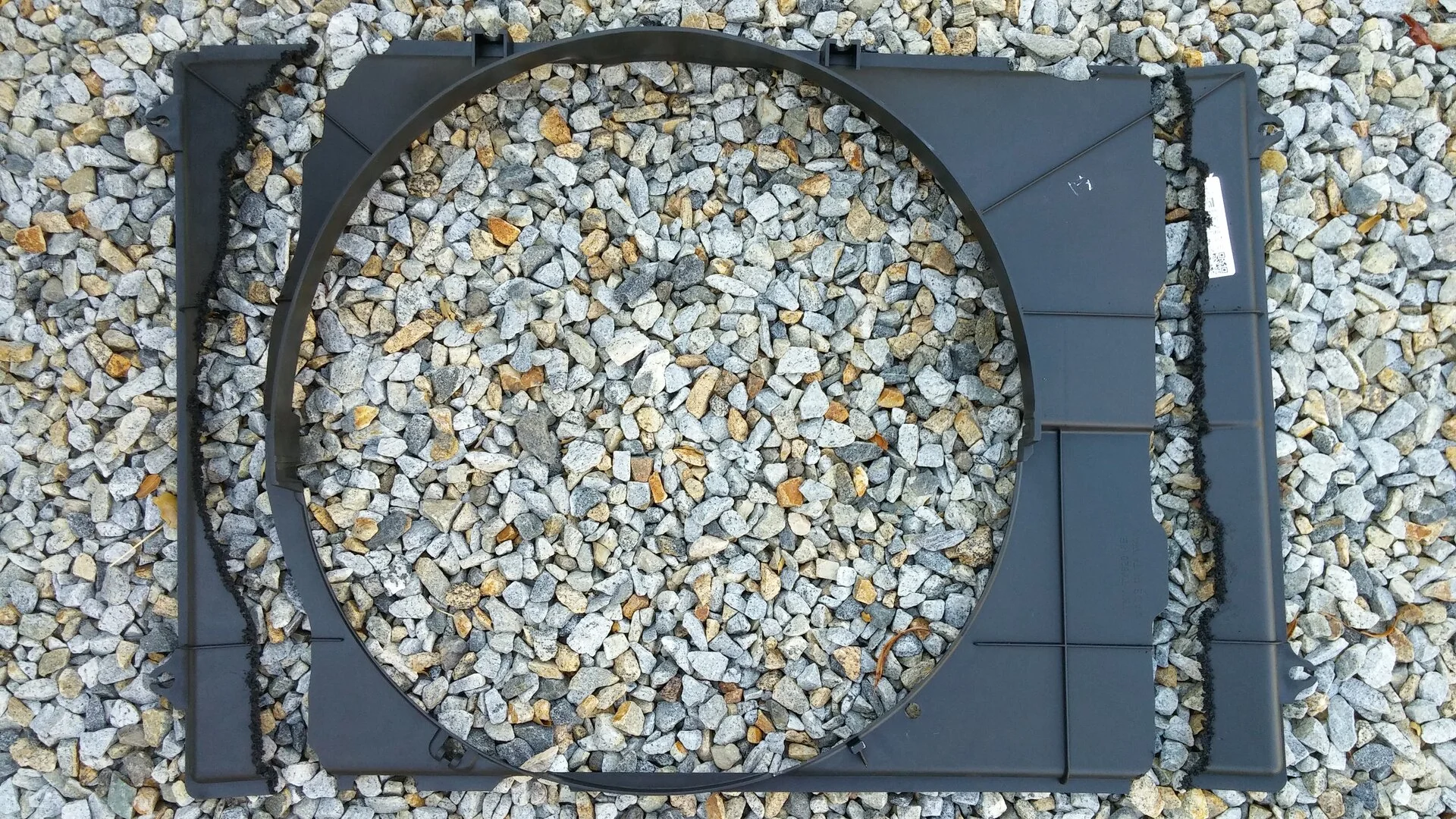

After hacking away at the fan shroud, it's just basically an upper guard at this point. On top of that the plastic is so brittle that if it cracks it'll sacrifice itself into the fan.
I'm going to run without it for a bit. I still have it, but I'm not convinced it's going to do anything at this point.

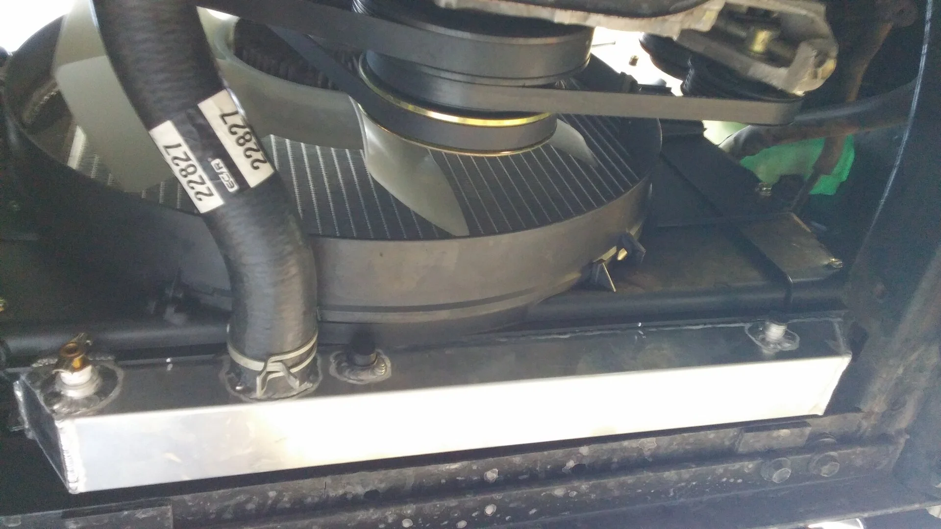

not sure if they're around anymore but I was able to get a 3.0 2wd 3 row aluminum radiator (DPI-1190) which is shorter than the 4wd version. I used the 3rz fan/clutch and modified a 2wd 2rz shroud to fit over it. It was the right height just a little wider. I drive long distances through desert areas reaching up to 115 deg in some areas like when I go to Colorado from San Diego in the summer. The 22RE radiator/ fan / shroud/ and clutch could not keep up, especially with the AC on. I have no issues now. I imagine it would have been the same issue with a 3.4
