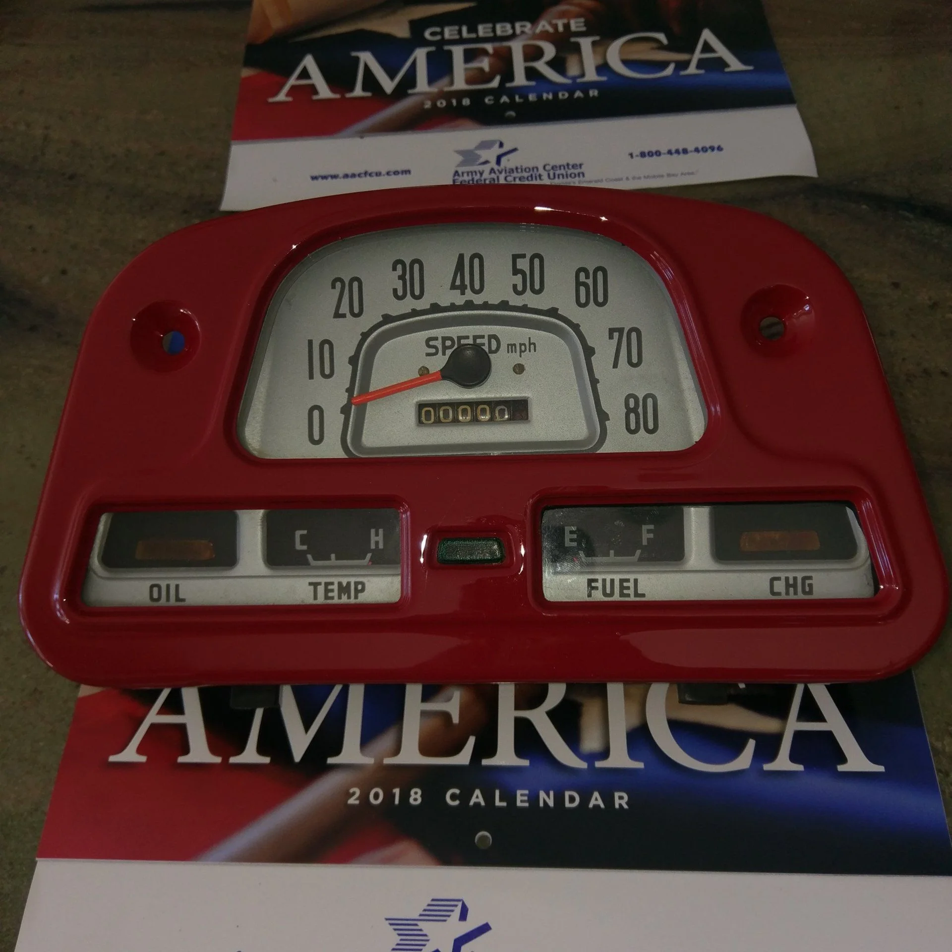

Thanks! Its a more difficult build. Finding parts, making parts. Little details that 25's only have. Finished this up today.

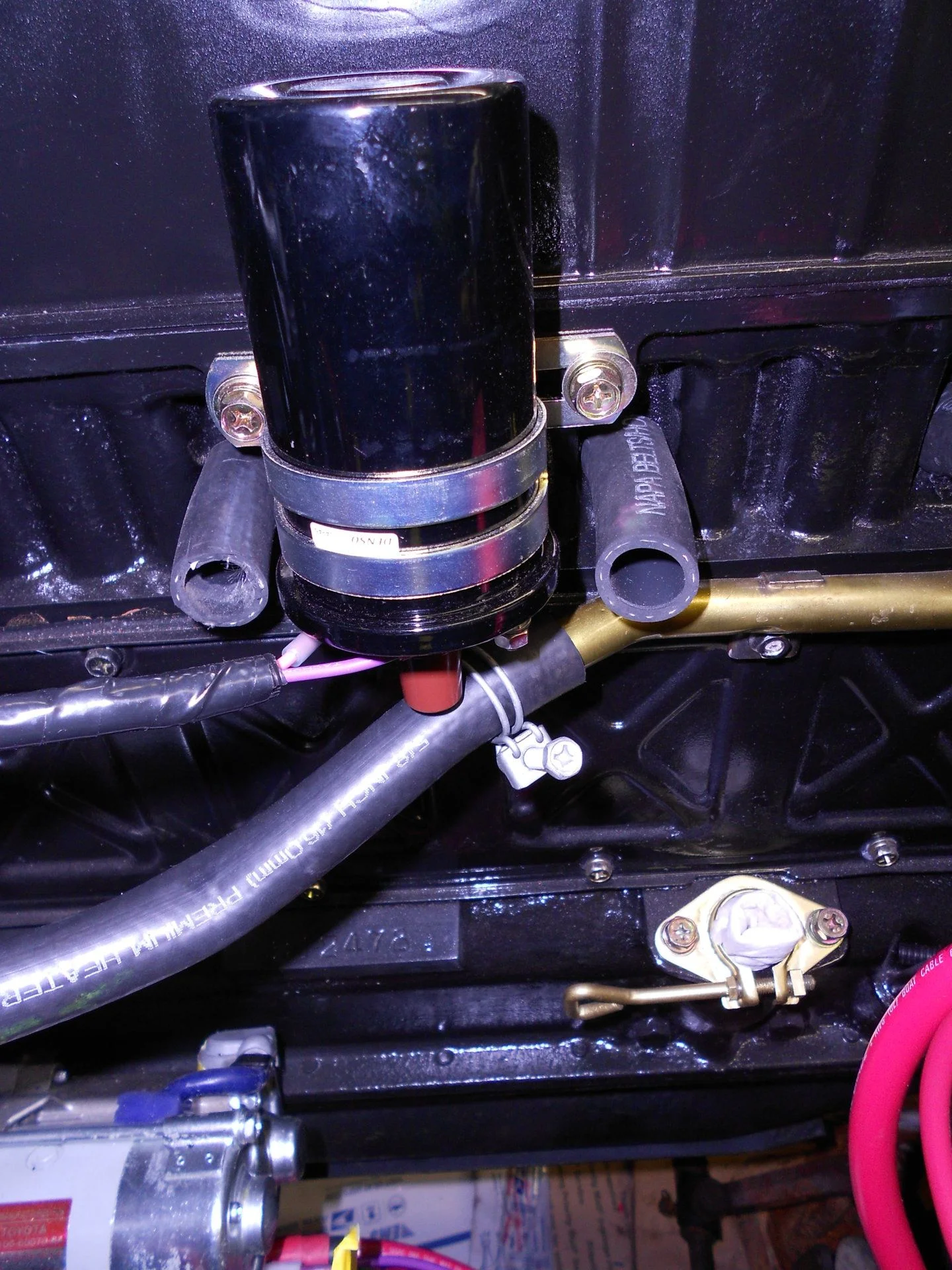

Engine has an oil pressre sending unit, dash cluster has an oil light. To work correctly, the OPSU needs swapped for an oil switch. I think I posted the rockauto PN in my FJ45 thread.

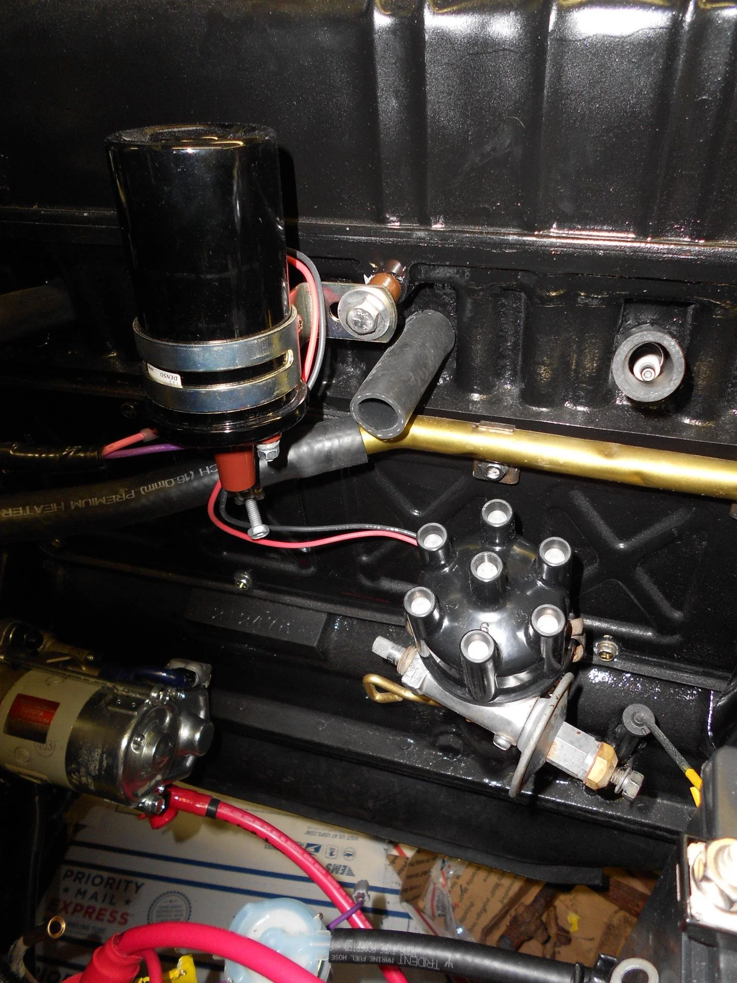

The cam does not appear to have the retaining clip on it?

I probably made a mistake picking up an OPSU from Kevin (kevos37), since I have the oil light (?). Is the Beck/Arnley link you posted the correct one for early ('63) 1F engines? (2010452). Thanks.

Thanks Jim, i will purchase the oil switch. Good eye on the cam. I did install it just snapped the pic before hand. I wonder if anyone out there has a really rusted out smooth top air cleaner? Bet i could cut the bottoms out to keep the oem look.

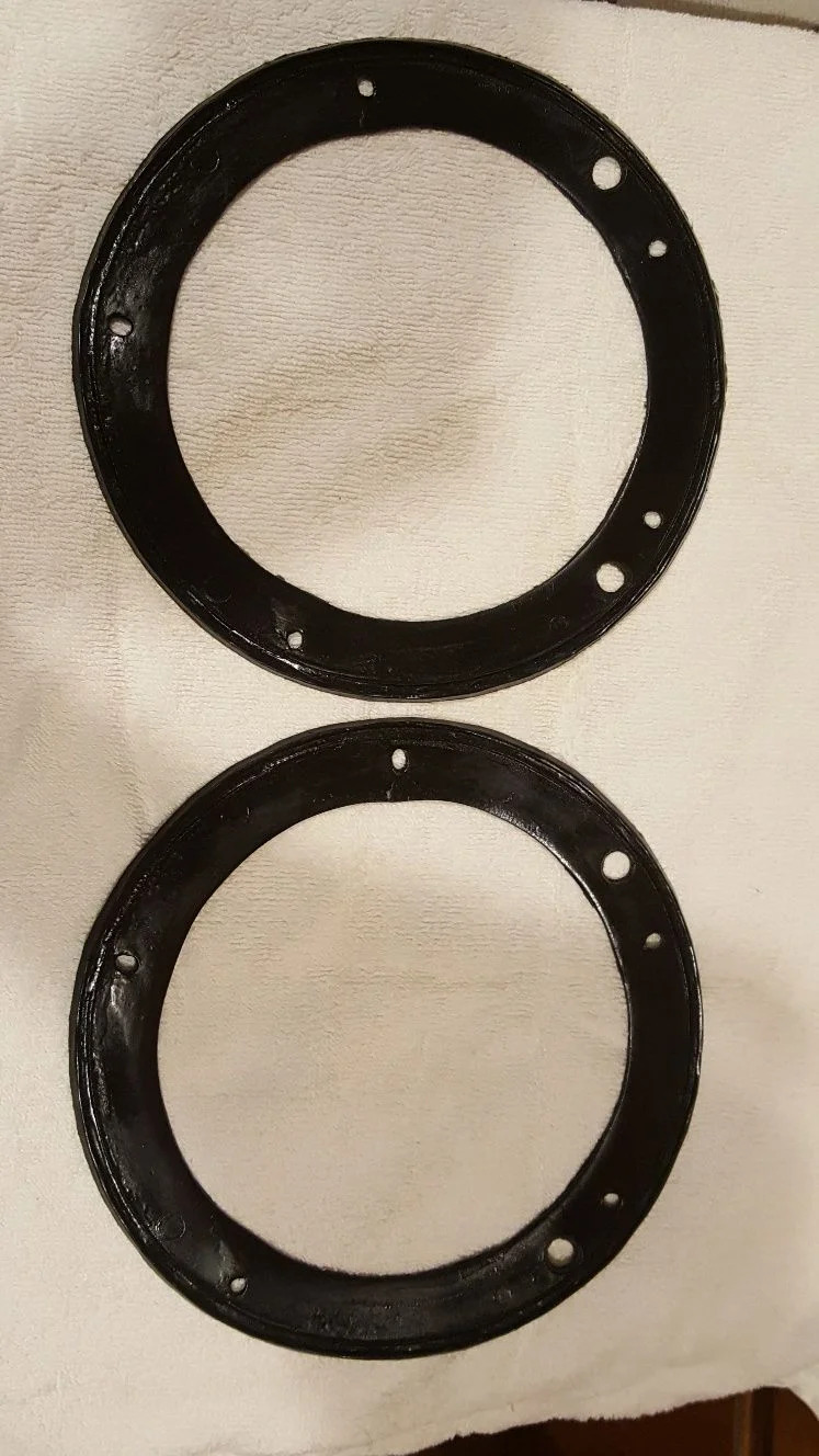

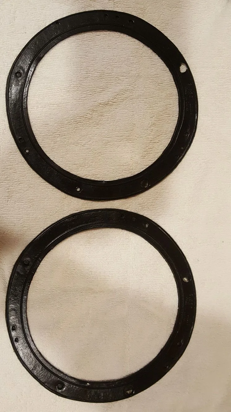

Been working with John @SLOCRUISER . Sent him a 25 and 40 rubber headlight ring. Goes between the headlight bucket and bib. 25s are larger. If you need a set hit John up.

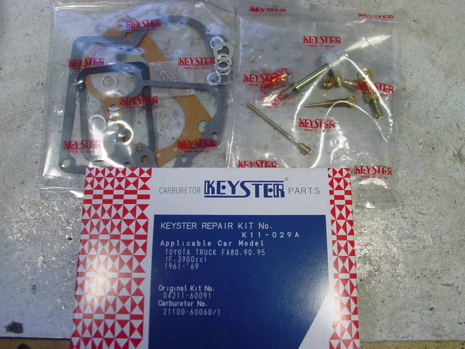

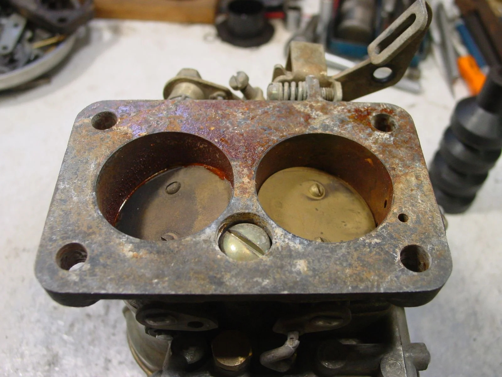

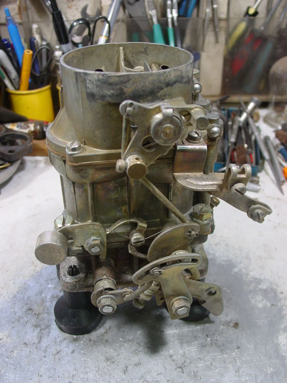

Got the carb together for this project. Initially looked pretty good on the outside...
But closer inspection showed some rust issues, including a stuck throttle.
And some antediluvian corrosion inside.
Still, it looks promising, so a kit is ordered from Sirius in Cananananada.
