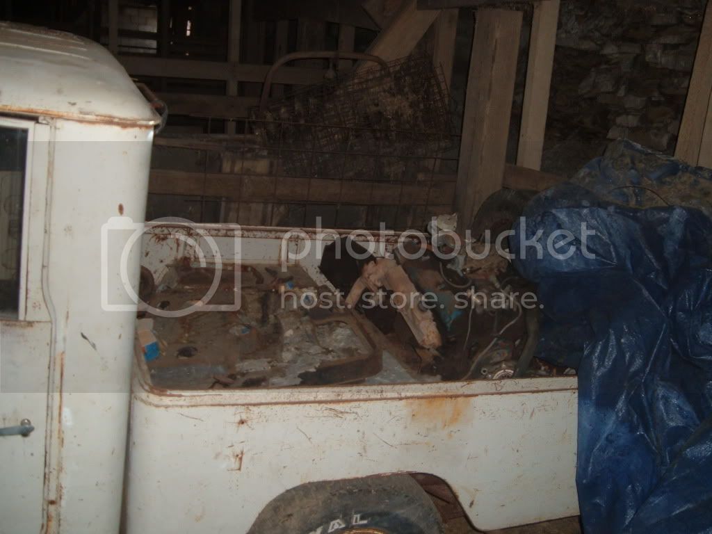

Here's what it looked like, under a moldy, s***-covered tarp (it was in the basement of a 3-story working barn).
And with the tarp rolled off.
In the bed is a SBC with an exit wound in the pan, a filthy TH350, a 1963 T-case, radiator & frame, racoon poop, rotten cardboard, etc....
The interior features random gages holesawed into the dash, rotten original seats, custom wooden overhead console, extensively customized tranny hump....

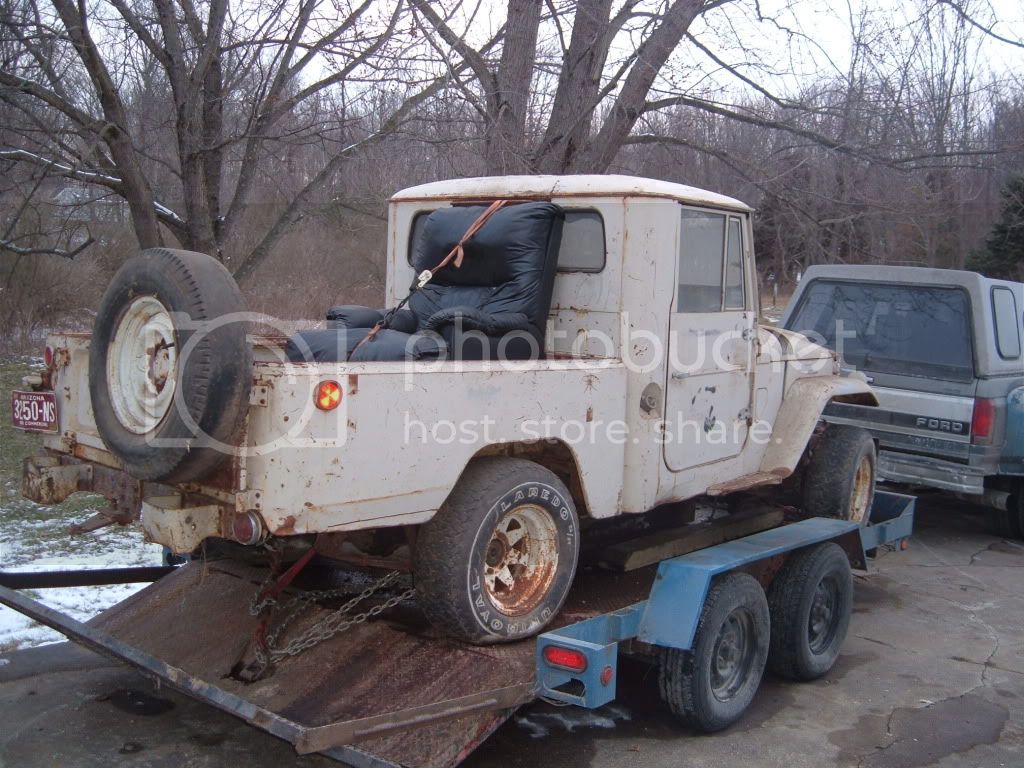

The rear drums were rusted solid from sitting, but all 4 tires took air, and the steering was free. So we drug it outside with ZebraBee's F350.
It was winched onto the trailer, and hauled back to the shop, where we disposed of the garbage in the bed. Then we decided that it really needed something in the bed. A proper accessory for a beverly hellbillies Cruiser.

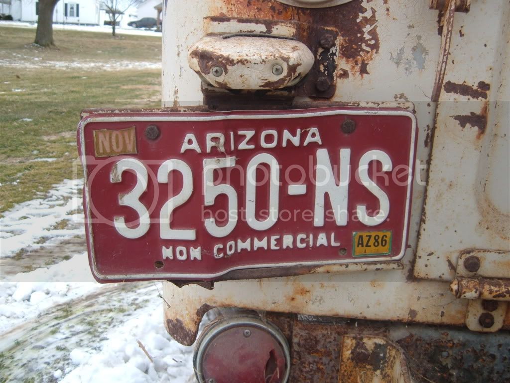

Ribbed roof for her pleasure and tailights down low because it has the swingout tire carrier not the underneath one... There are so many different details on these trucks it's amazing.
Better lock that bezel up. Strange that it has Orange front bib lights and a stamped bezel. Normally they would be white bib lights when they're that old.
Fews things just aren't right. Transfer case is a 63 and looks like the truck is too. Stamped bezel with the non emblem grill would be 63 or earlier. The orange bib lights wouldn't be correct for any cruiser before the 68 model year. I believe the tail lights are later also. Prior to 64 the tail lights were the same size as the bib lights. Just too many things wrong. Best thing would be to ship it back to AZ to get things straightened up. Since I live in AZ and hate when we let things like this happen I will give you my address and you can ship back to me. As soon as I get correct parts on I will ship it back. But that may take a while.:rolleyes:
This is an early truck, grey speedo, fixed windshield,no plates or hinges,I bet this truck is in the 12'*** vin range making it a late 62 build...Lets see the vin#!! nice find:beer:
I'm told that the frt bib lights looked like new, before somebody pushed a haywagon into the barn and mashed them. I'm guessing they were replaced in 1986, right before the 305 2V engine spat out a rod.

Not originally from AZ. Only been here a few years (71 :rolleyes:). No that one wasn't mine. The only fixed top I've ever considered buying was in paint with primer about twenty-five years ago. Going thru a divorce timing wasn't right. Happy now just to have my long bed. Besides anything that the drums brakes are rusted so bad that they wouldn't break free even with being dragged has already spent to much time out of the state.
Your Maroon plate might have given a good idea I might be able to do what I want. I put historical plates on my 68. It had the orange and green plates. Since these over lapped the maroon plate maybe I can convince ADOT to let me use the orange/green plates on my 70 I just bought. It had a maroon plate
but the ornage/green plate would give a more retro looked.:hhmm: No Buick, porche or BMW going in that one. One of these days I need to send you my 76 carb. This is off another one of these rust free cruisers we managed to keep here out of the rust belt.
