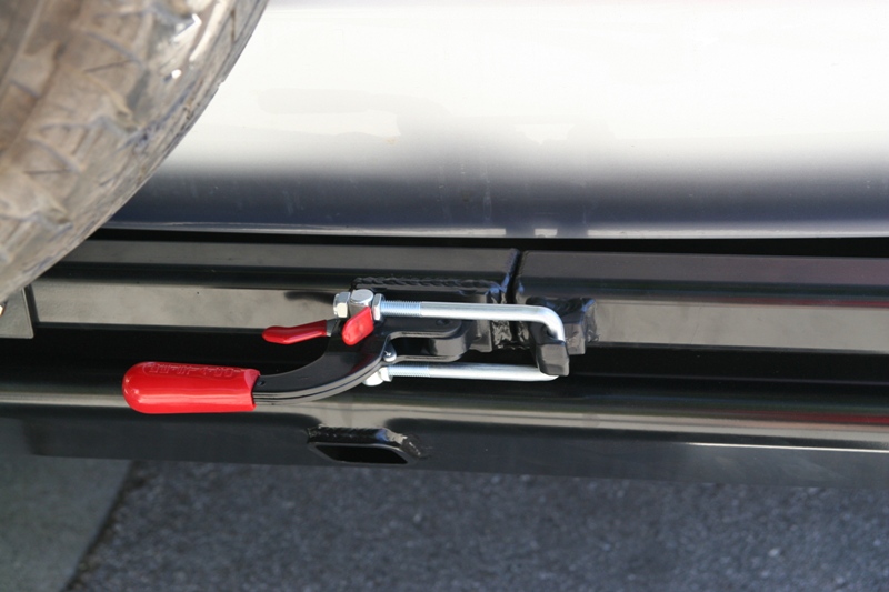

Which leads me back to a single clamp working in the vertical, but I wonder about using this latch pin to give a more solid stop. SO something like this one, but then weld the pin at the end of it.
I'm trying a good, clean way to mount my clamp for a single swing as well. Post up when you figure it out!
Mounting the latch vertically has been done by tons of people already and there are many ways to do it. All you need to make it work is some sort of hook that will catch the u-bolt from the latch. Luke's destaco latches that he sells come with the weld on type which you can easily grind to the contour of the bumper shell and weld on. The only problem is that I don't think his are locking, the point is that you just need the hook thing to make it work. Or make your own like I did with 2 1/4" thick hooks and weld them on. It all works as long as there is a sturdy weld and the latch is set up correctly and tight.
Thanks for posting @pandathrust , I have referenced your build several times. I must admit that I am type A personality, and want to overkill this. I am leaning to do exactly what you have, and add the spring loaded drop pin for additional lateral support.
FYI, Luke's at 4x4labs are locking clamps, model 375-R

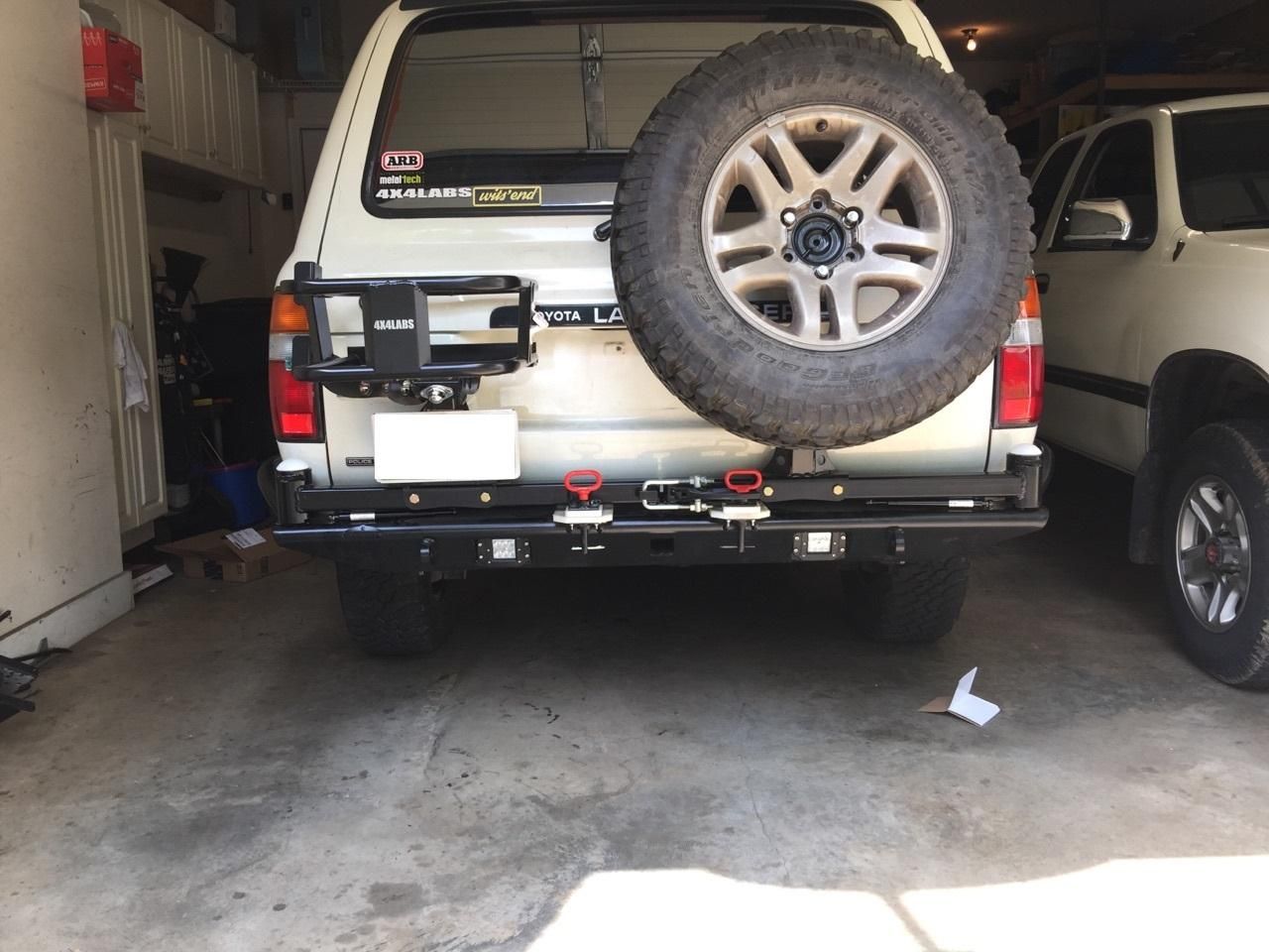

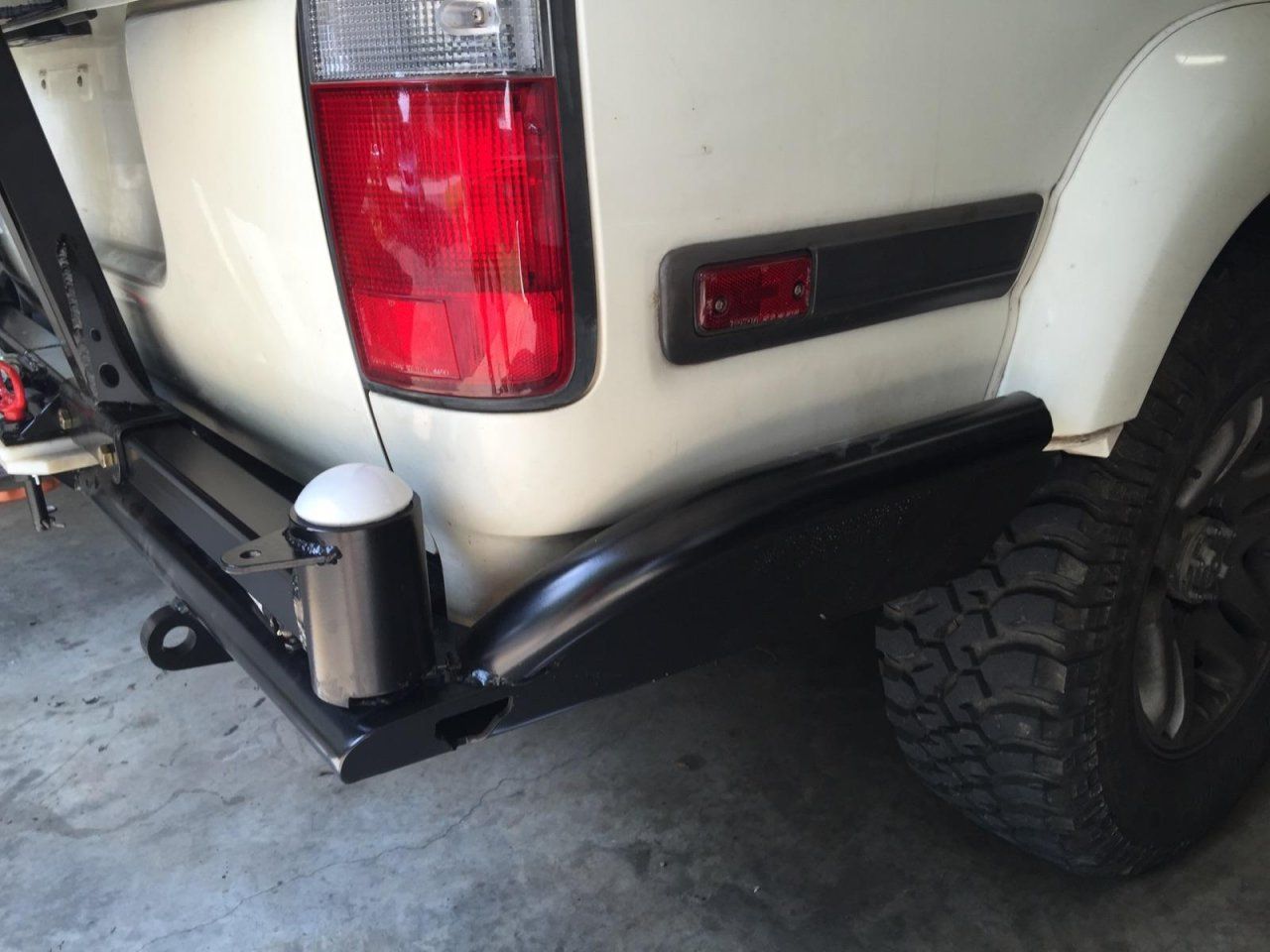

The thread was helpful when I was planning my build so here's my contribution
Added some cut outs for flush mounted LEDs, added some tabs for a hitch pin for each arm and cutting board pads so the arms can rest on something, And the tabs also make a great step when accessing the roof, and used 2" wing tubes so it matches the ARB front more closely.

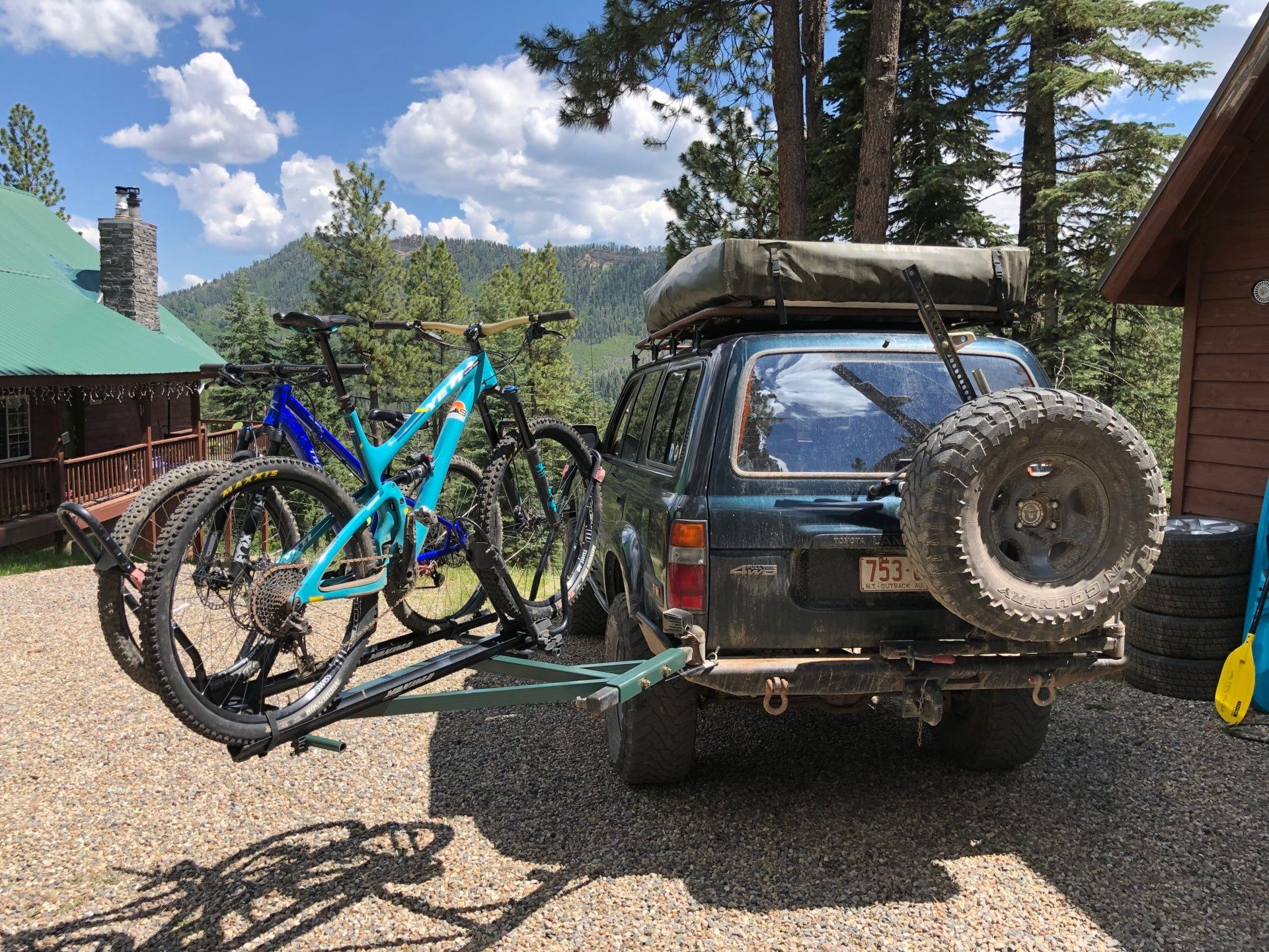

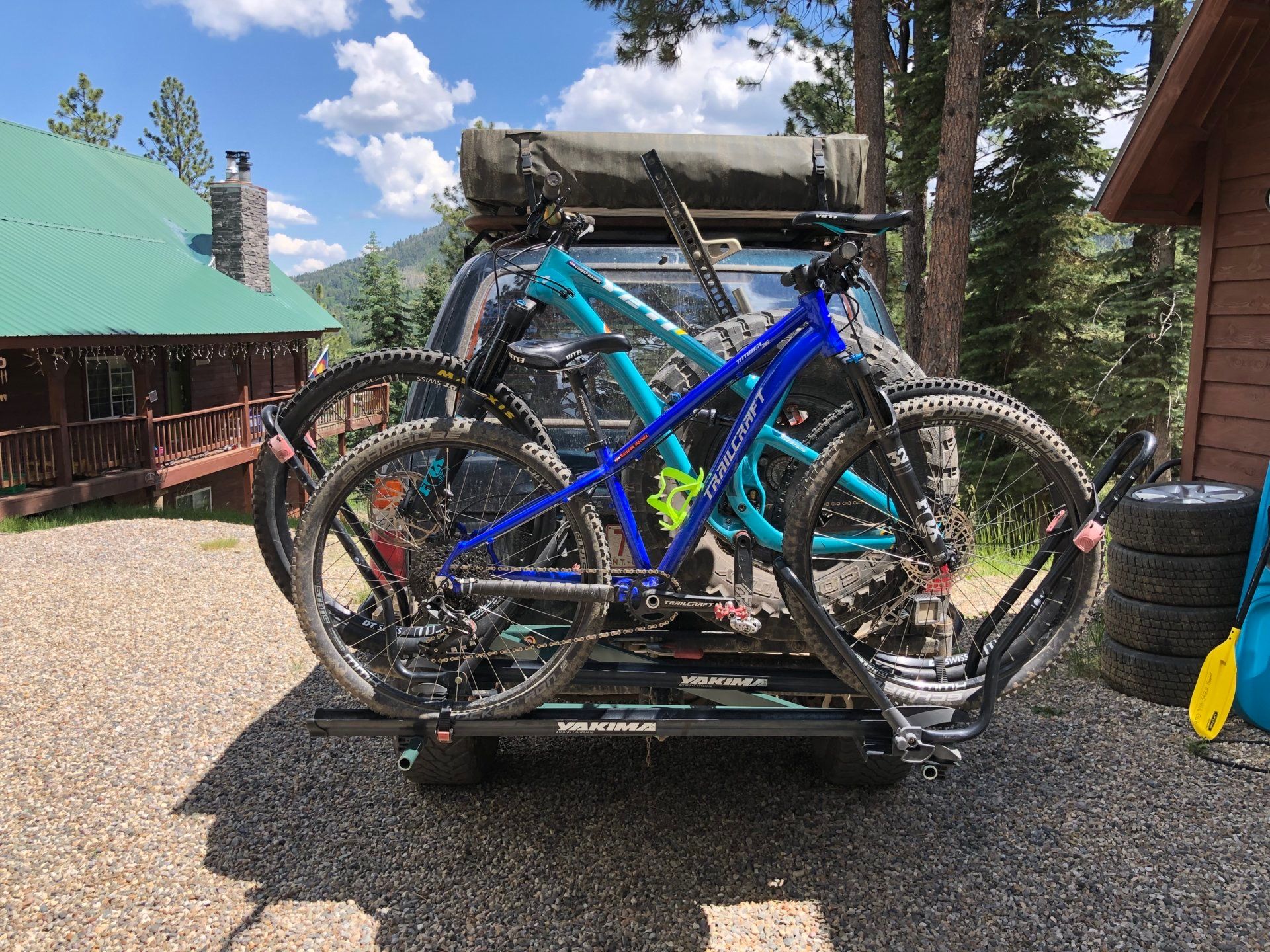

I forgot about this thread. Here is my latest edition. Posted already in other places but I’ll put it here too as it may inspire some others. Simple Yakima roof mounts.

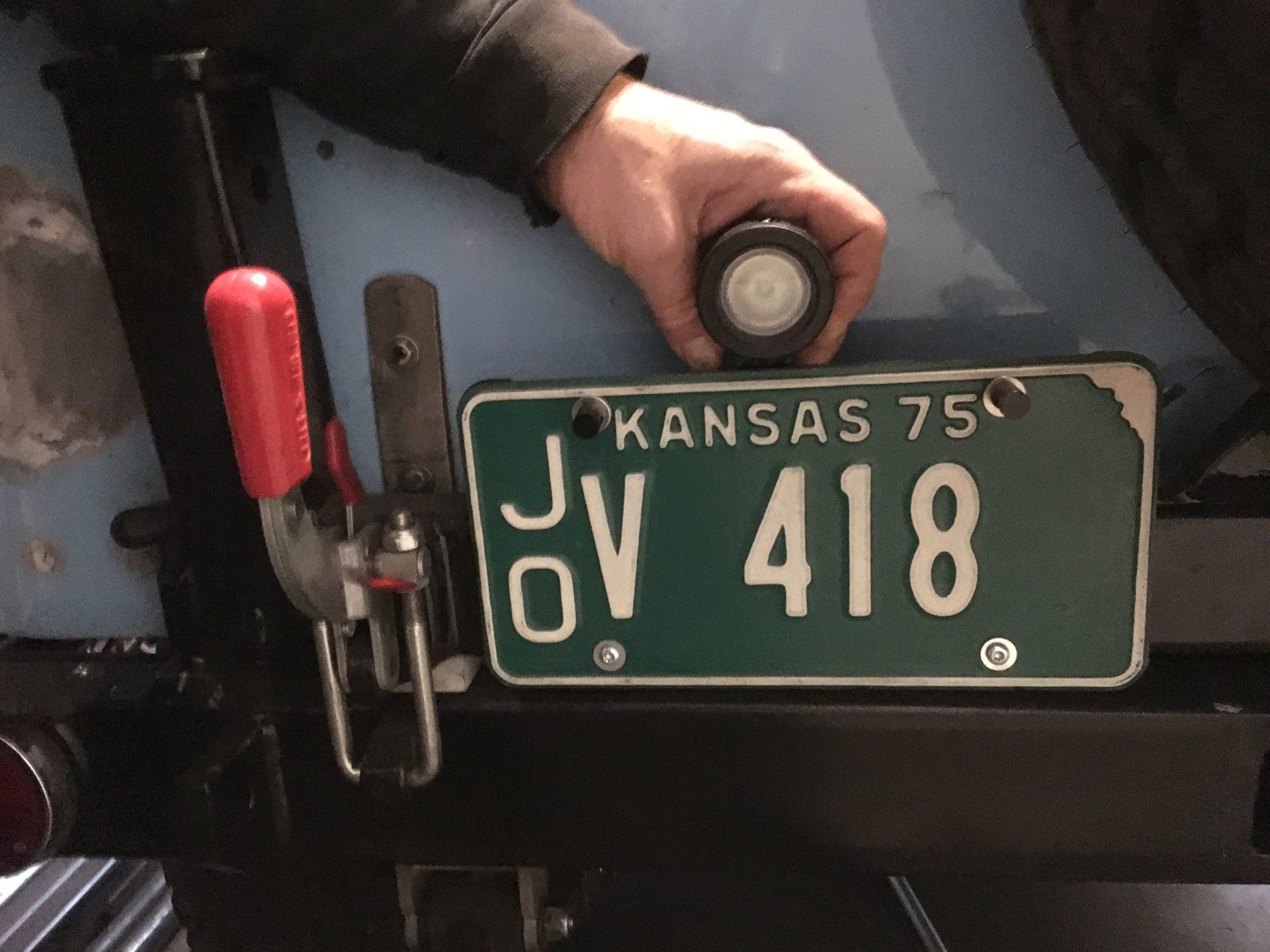

I found some lights that also are used to hold the license plate in —very small LED units on eBay
CZC AUTO 2PCS License Plate Light, License Tag Screw Bolt Lamp, 12V White LED Bulb, Waterproof/Rainproof, Black Aluminium Light Holder, Legal for Car Motorcycle Truck RV ATV Bike Amazon product ASIN B077Z6WQ6Q

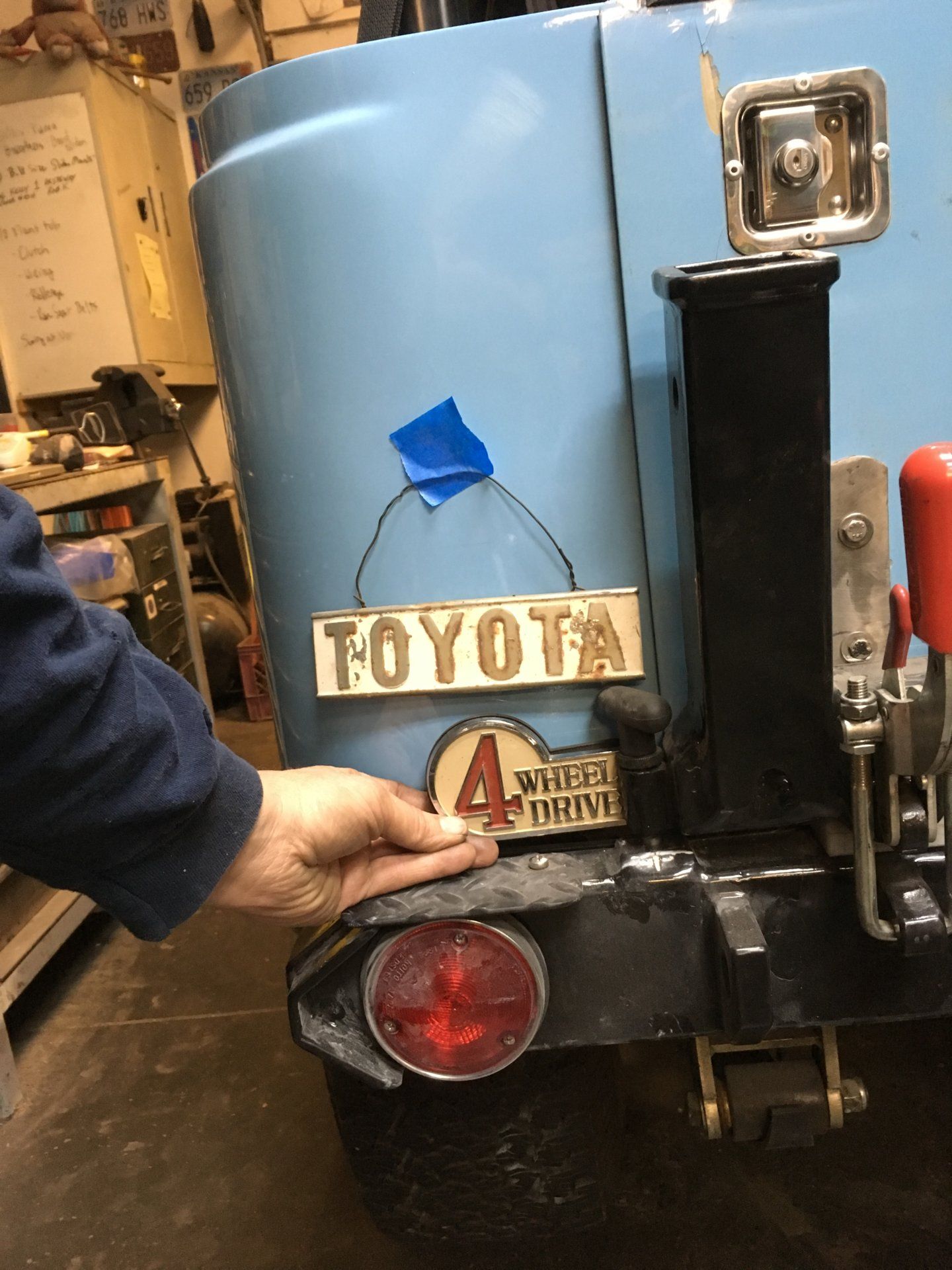

Picture. They are shown on the license plate mounting holes, barely tell they are there

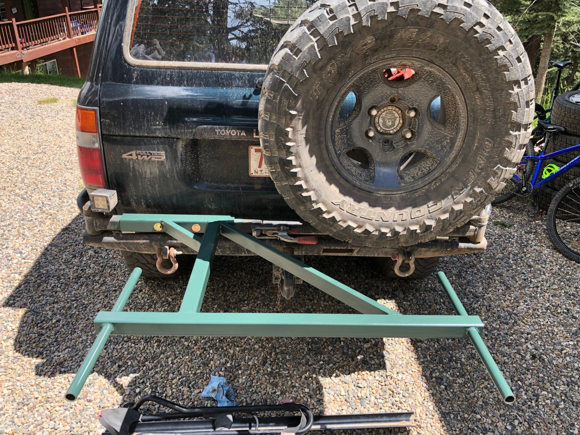

And here is how I did the mount for the swing out
