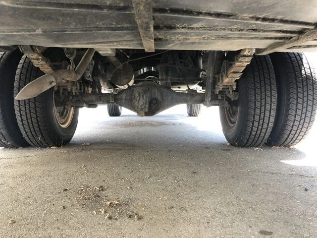

Haha, okay, okay. Dug through the photos on my phone, found one. Here’s the current setup. (@pappy to help my own ignorance, where are the rules written down?)
Do I need the “beef” of a D60 or equivalent? No, but the problem is the weight on the rear axle and my need for a wide wide track - I won’t be putting much torque through the diff, but I will be much heavier than stock, and will be bouncing all that weight around on dirt and rocks. And toyota campers have a history of nasty axle issues.
