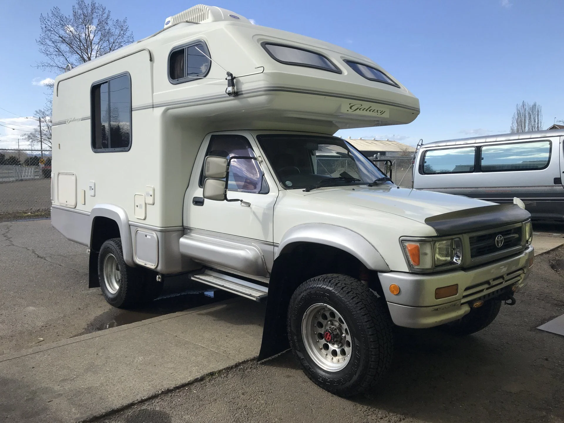

@Squandro I was going to demand a picture, haha. That looks like the one that was at Ottoex, but that one was a '93. Nice score.
Mine is actually unfinished and tarped, it didn't make it through the California DMV.
I got a Ford Sterling ready to put under it but never quite got the brakes figured out - big pistons on the one ton rear, stock on the front seems... unlikely to work well. The problem with swapping a Ford D60 front in to match is they're both driver drop pumpkins but the driver's seat is on opposite sides! :banana:
I'm currently planning on lightening it up, replacing the rear bearings and seals, throwing E rated KO2s on, and driving it gently while keeping an eye on it. Less load on the bearings with a single, although it will be goofy looking and skinny.
Long term, I am considering either a full one ton swap or swapping an FJZ80 rear in, which is standard six bolt plus full float. Would require lots of grinding wheel time to make that work, would still be a little narrow, and I'm still not sure if you can hit the driveshaft angle sweet spot with that setup with a straight driveshaft or if a straight driveshaft would clear all the other junk downstairs.
