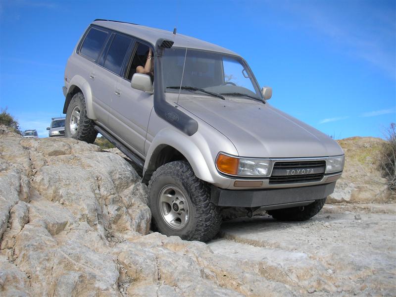

By the way, let's post up some shots of your 80's in the rocks. I don't mean slickrock of Moab. I mean nasty rock gardens, maybe not Hammers but some real rocks runs. Not just a single wheel up on a rock somewhere--I want to see pics of 80s IN a rock FIELD. Check attached photo. Anyone?
Dave (rag publisher)

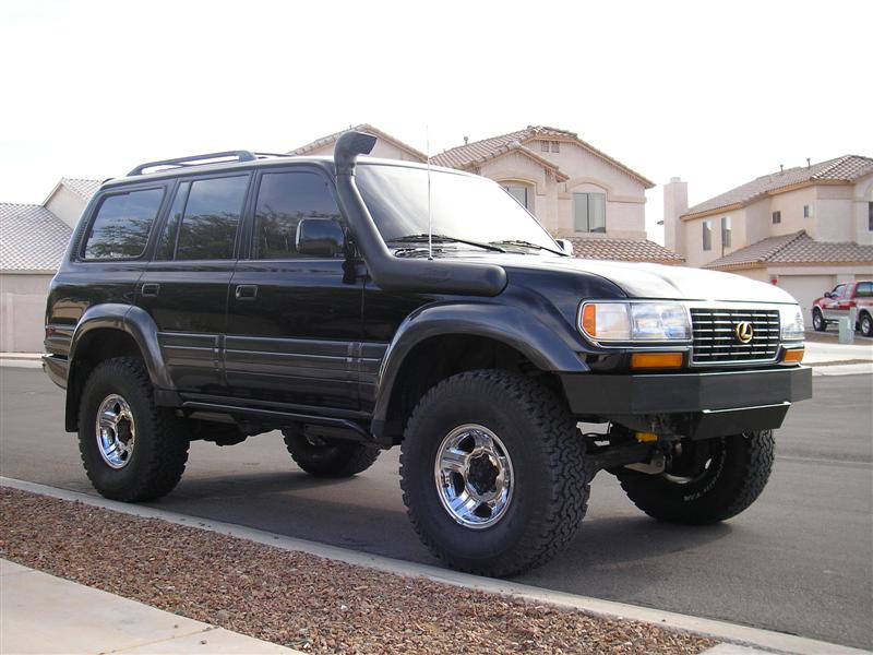

Hi Dave. John here from AZ. You've had my 80 and 100 in your first editions. Thanks!
We've scheduled a rock crawling trip that's right around the corner. It will be to one of AZ's most beautiful canyons. Are you interested in a write-up with hi-res pics? Or, do you just want some rock garden pics posted here?
I'll be attending with my '93 (tan). I wish my new Lexi was ready but it's not quite (black). My 100 is grey-green.
