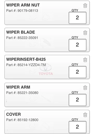

I just ordered the two arms off ebay using the oem part number- used, saved a couple bucks. 25$ ea free ship... now looking into the blades and rest of the parts...
Really don't NEED any other parts as the nut that is used to hold the 60 arm works just fine. Tried all kinds of blades since I did my swap and seriously, the $10/set standard NAPA Auto blade have been flawless. Just swapped a new set on last week as mine were starting to do the chatter dance, now they are slick and smooth as butter.
My 4Runner arms arrived PN 85221-35080. They are straight arms, without the slight bend that the stock 60 arms have. Hoping the blades won't stick too much into the field of vision. The bend allows for the blades to come to rest at the bottom edge of windshield.
