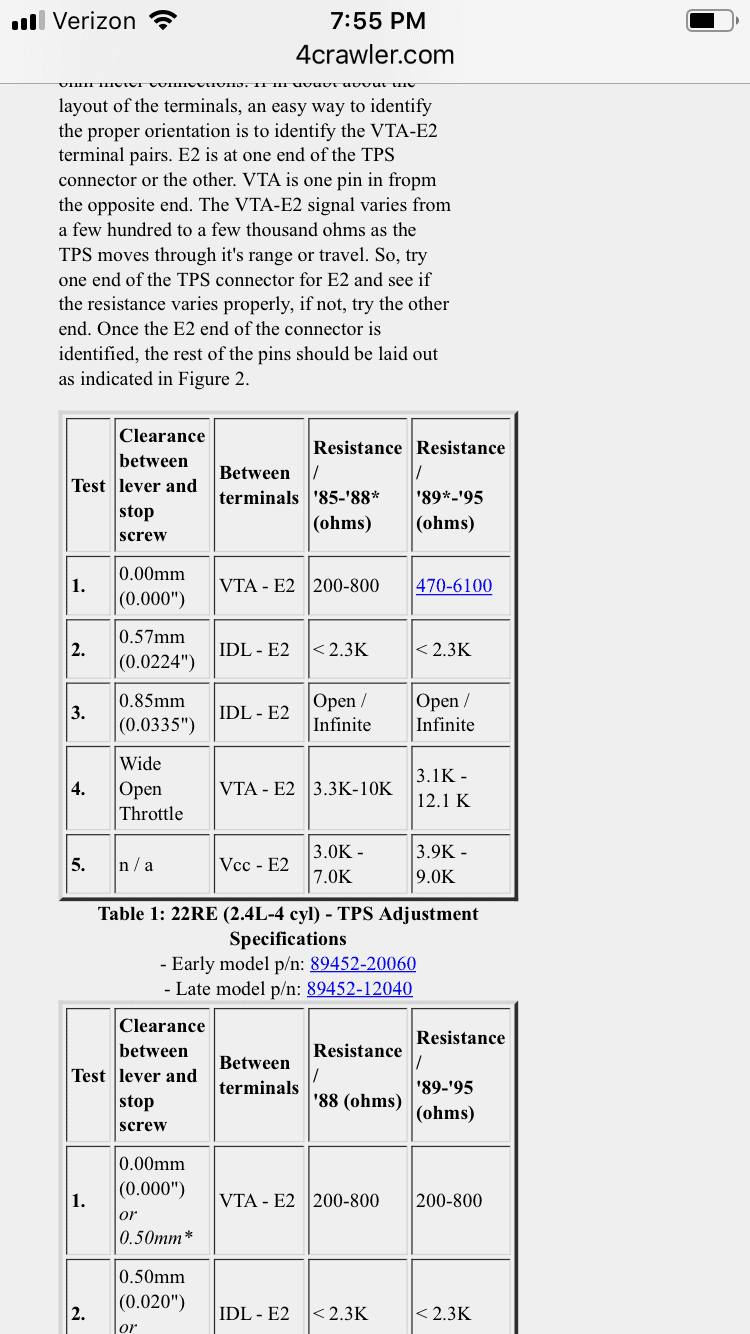

Tested the TPS using roger browns method today. And it failed check number two. Thinking this is probably my idle issue, but I’m a ways away from being roadworthy so Ive got other things to button up first.

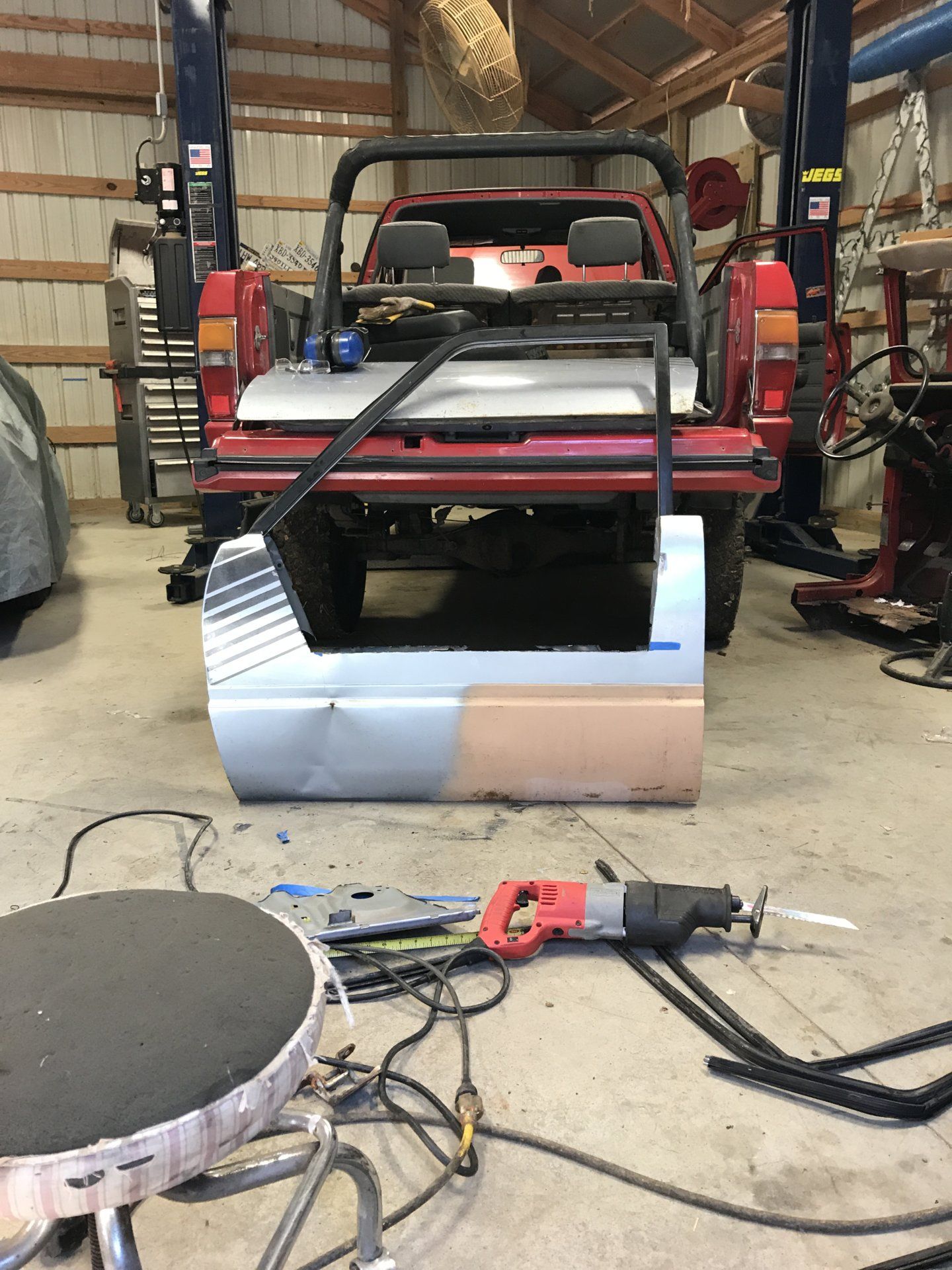

So I did something fun for a change. A buddy gave me a set of doors. So half doors are on the menu.

How are you planning to have the half doors latch?

For the door latch I’m just going to use a pice of cord around the latch mechanism and run it through a grommet. It’s about the simplest idea I saw.
Those doors turned out nice. Are you doing that to get around local law about going doorless? Do you need to mount mirrors on them too?

No law hear about running doorless, but I had free (s***ty) doors and I was waiting on parts. I might go doorless but I like having the half doors to keep stuff on the floor in, and stuff from my tires (kind of) out.
I'm going to some kind of mirror on there. At least on one side.
Cool. Throw some more of that red paint on and you’re ready for summer!
