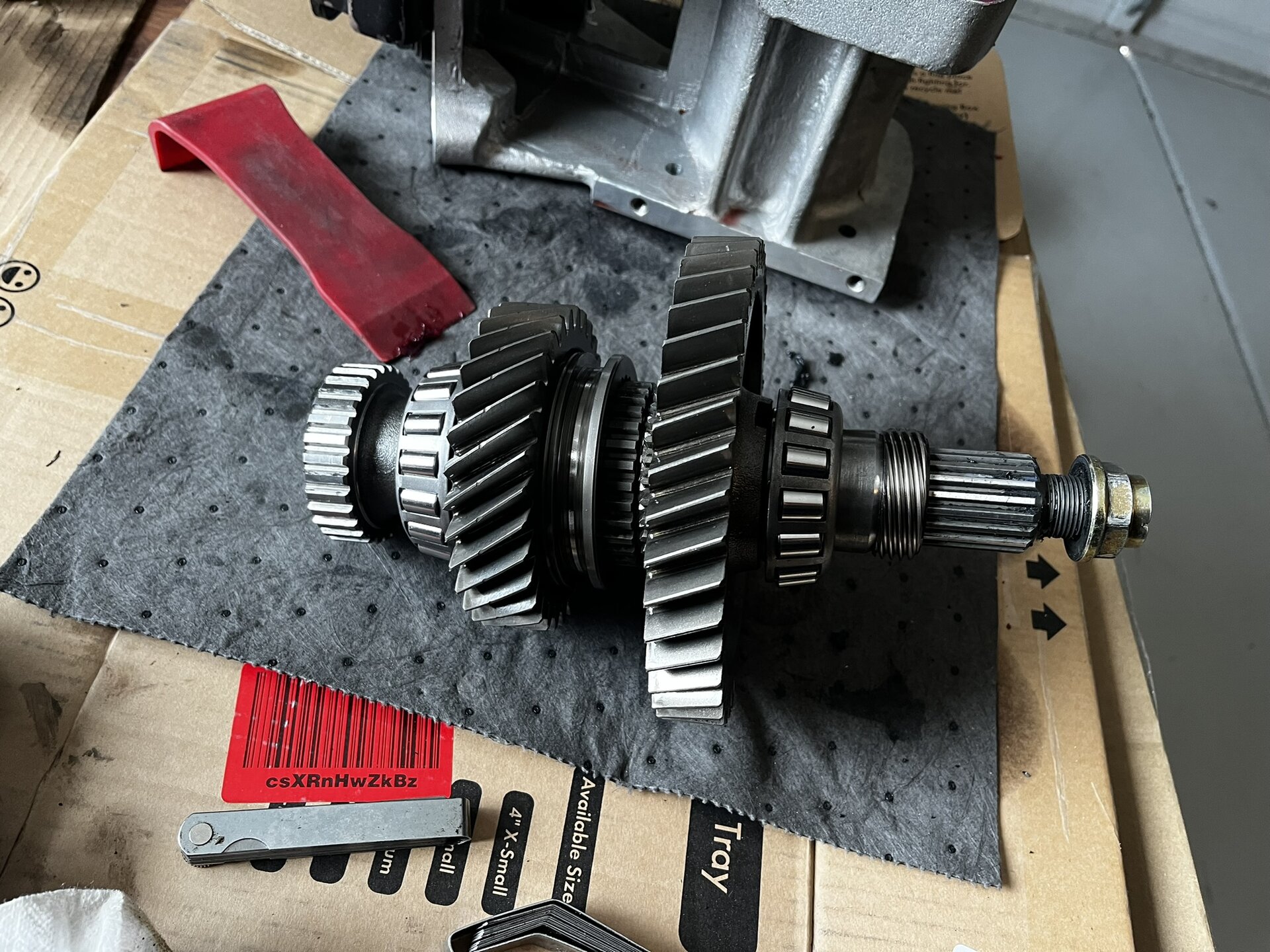

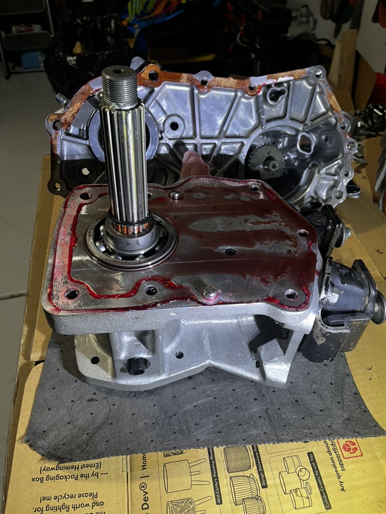

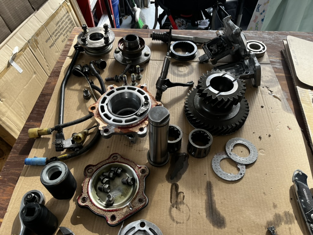

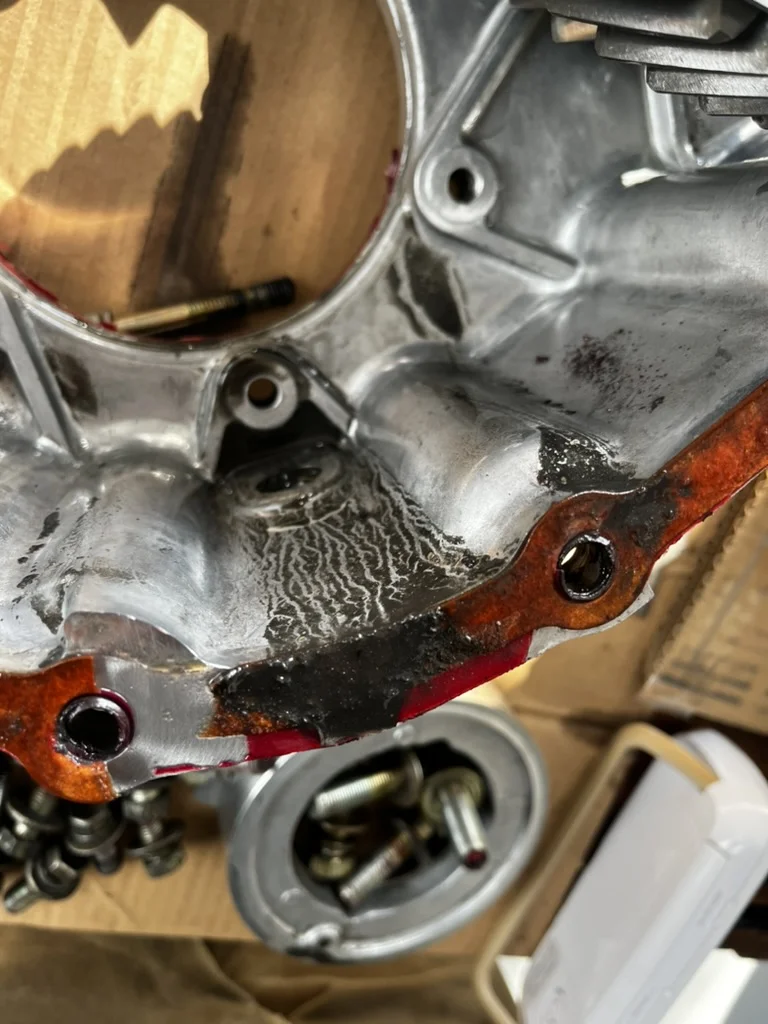

Had a minute to tear down the t-case. Nothing glaringly wrong, but definitely have some fine ground metal in the bottom, and there is ATF on the rear of the Advanced Adapter. Seems possible that I overfilled the transmission, but not sure if that is an indicator of a different problem. Any thoughts on that?
And the only part of the rebuild that I didn't do myself the first go around was pressing the new bearings onto the output shaft, as I didn't want to buy a press. Going to look closely at that to make sure all good. Otherwise, going to rebuild it again and see if a second attempt works better.
The ATF likes to creep through the spud shaft and the giant bearing on the Adapter. At least mine did. I used FIPG all on the splines and around the little metal spacer thing and i dont get ATF in the case anymore.

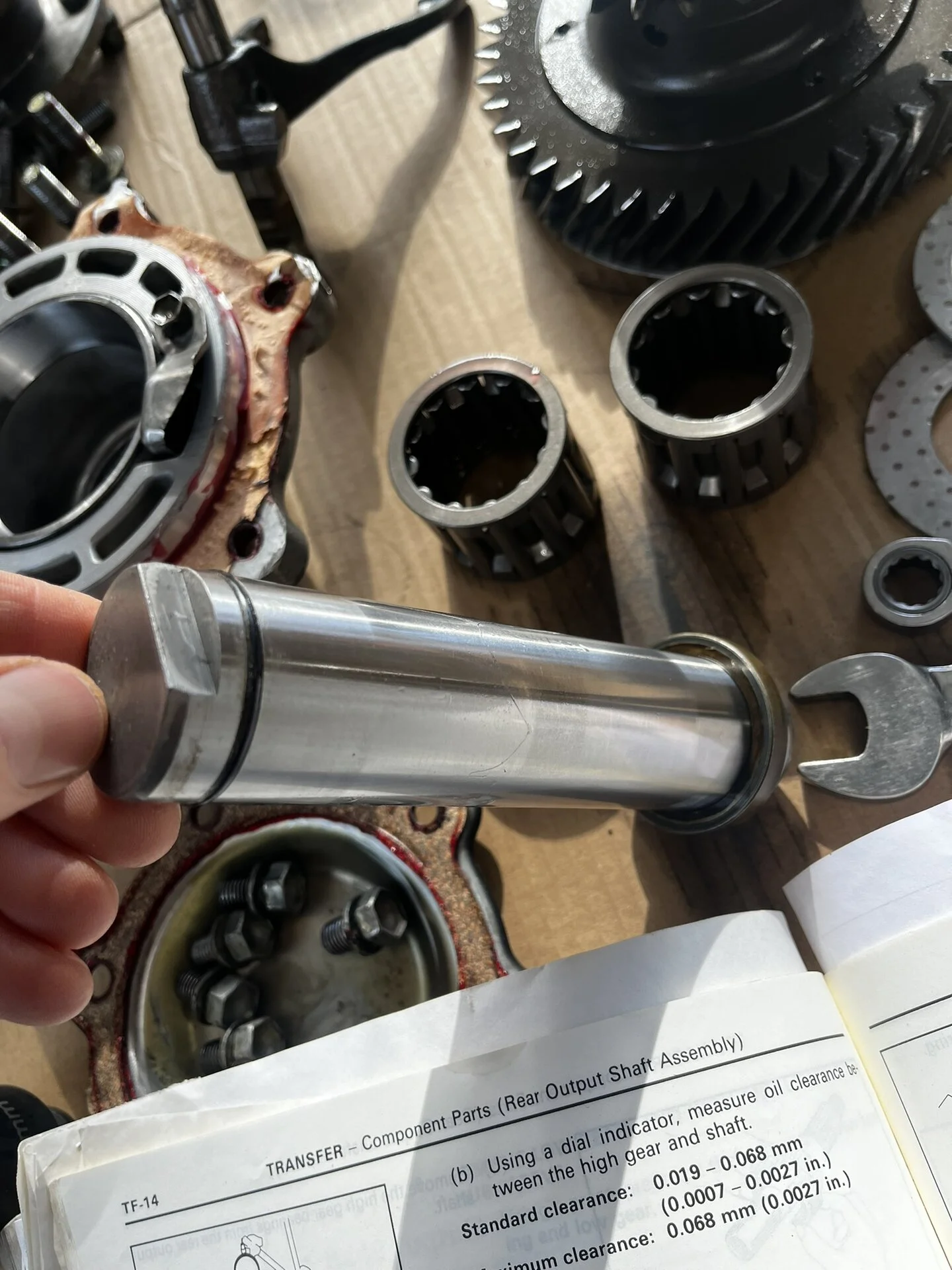

Did you put a new idler shaft in when you did the rebuild? Hows the wear look on it?
Hmm. Good call on FIPG on the little spacer. I did the splines under the bearing, but obviously not enough. Nothing like dripping ATF under my new motor swap to convince me to be liberal with the red goo.
and yeah, did a new idler shaft. Looks decent to me, BUT, it only has 8 miles on it, so...

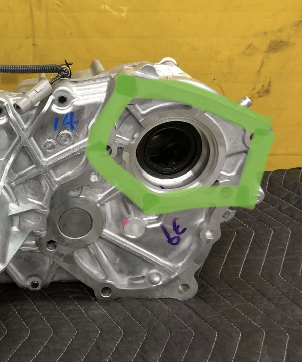

What I started doing with the 4l60’s is not using the paper gasket between the adapter and front transfer case half, and using RTV on this area marked in green, that way the ATF doesn’t enter that lower chamber and pool up.
Ah man mine showed way more wear than that, but i had a few hundred or more miles on mine, you can definitely see where the idler gear is riding on it
This is genius

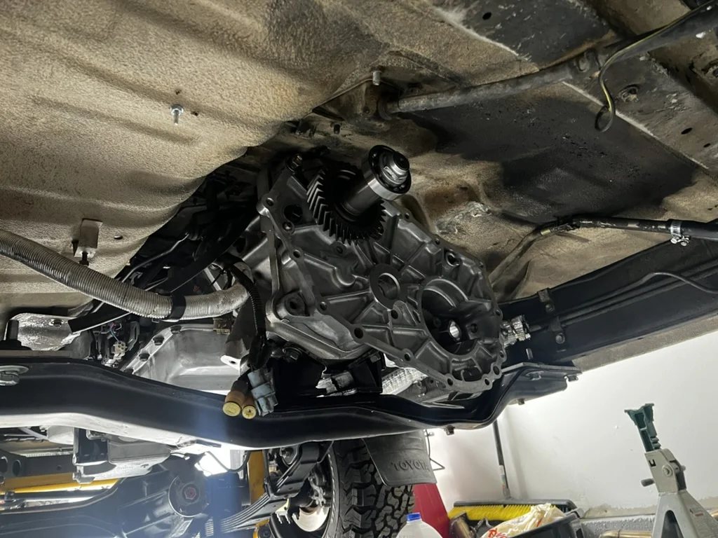

Making a bit of progress. Taking Matt's advice and put the front half of the case with input gear onto the transmission.
Started it up, gave it some gas, and kicked it into neutral so I could hear it spinning over the lack of exhaust. Couldn't hear anything out of the ordinary coming from the transmission, so am going to rebuild the t-case and see how it goes.
