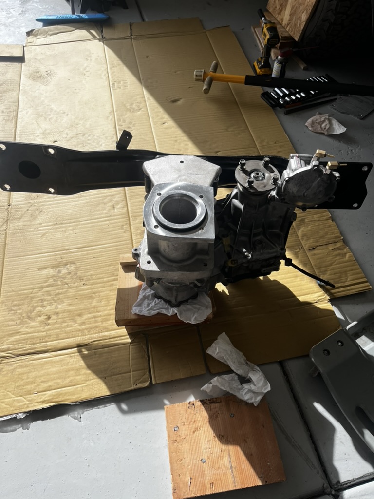

Yeah new bearings all around from a rebuild kit I got from cruiser outfitters. They all look good to me at this stage (with 8 miles on them).

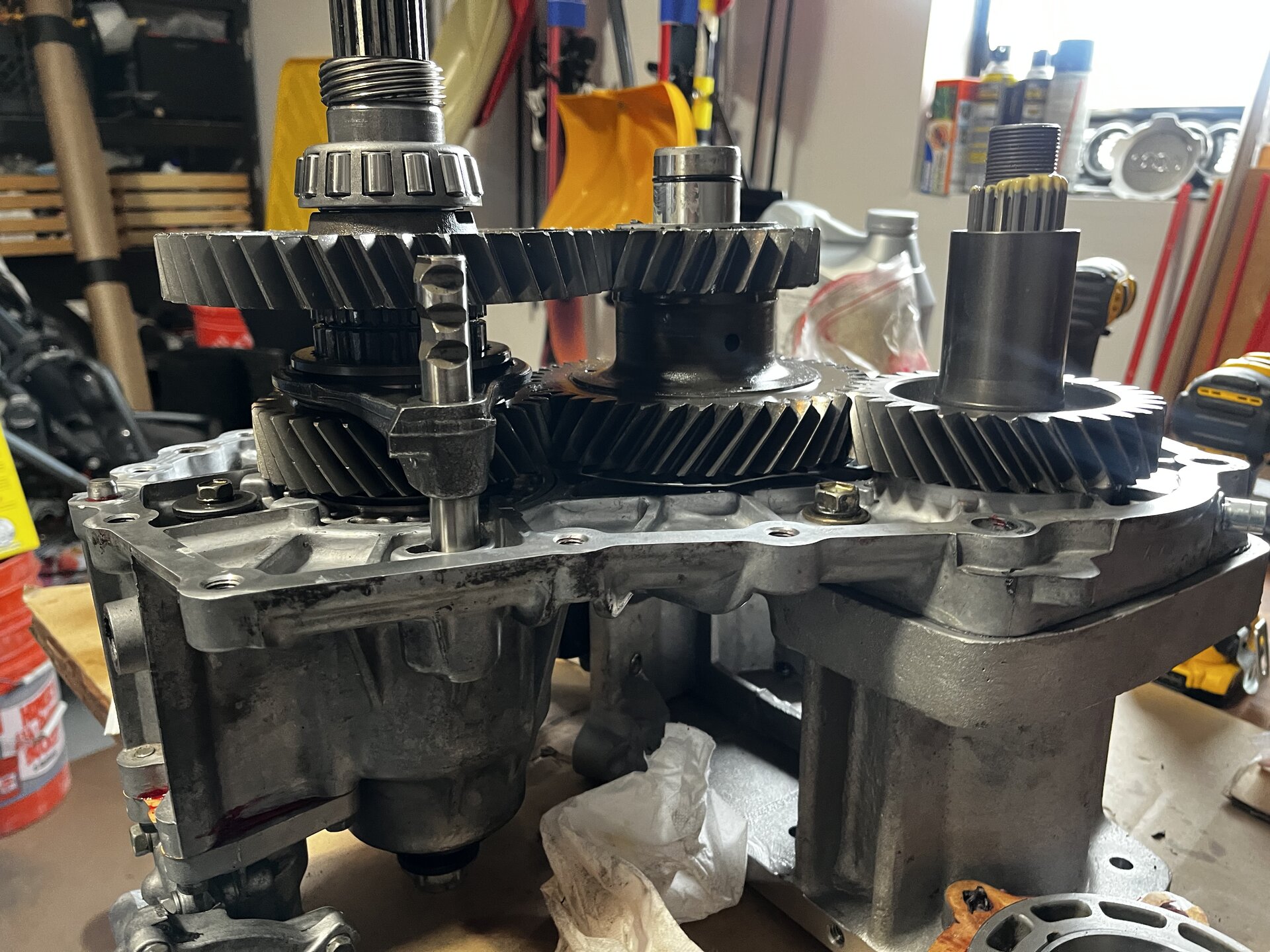

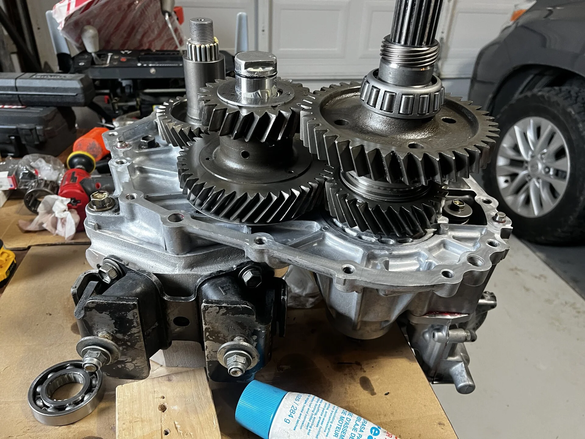

I got the half the mating surfaces cleaned up and the gears dropped in this afternoon. Everything lines up and spins. Still hoping to find something to explain the noise.
quick video to verify things are in the right place. Let me know if anyone sees anything that is incorrect or questionable.
