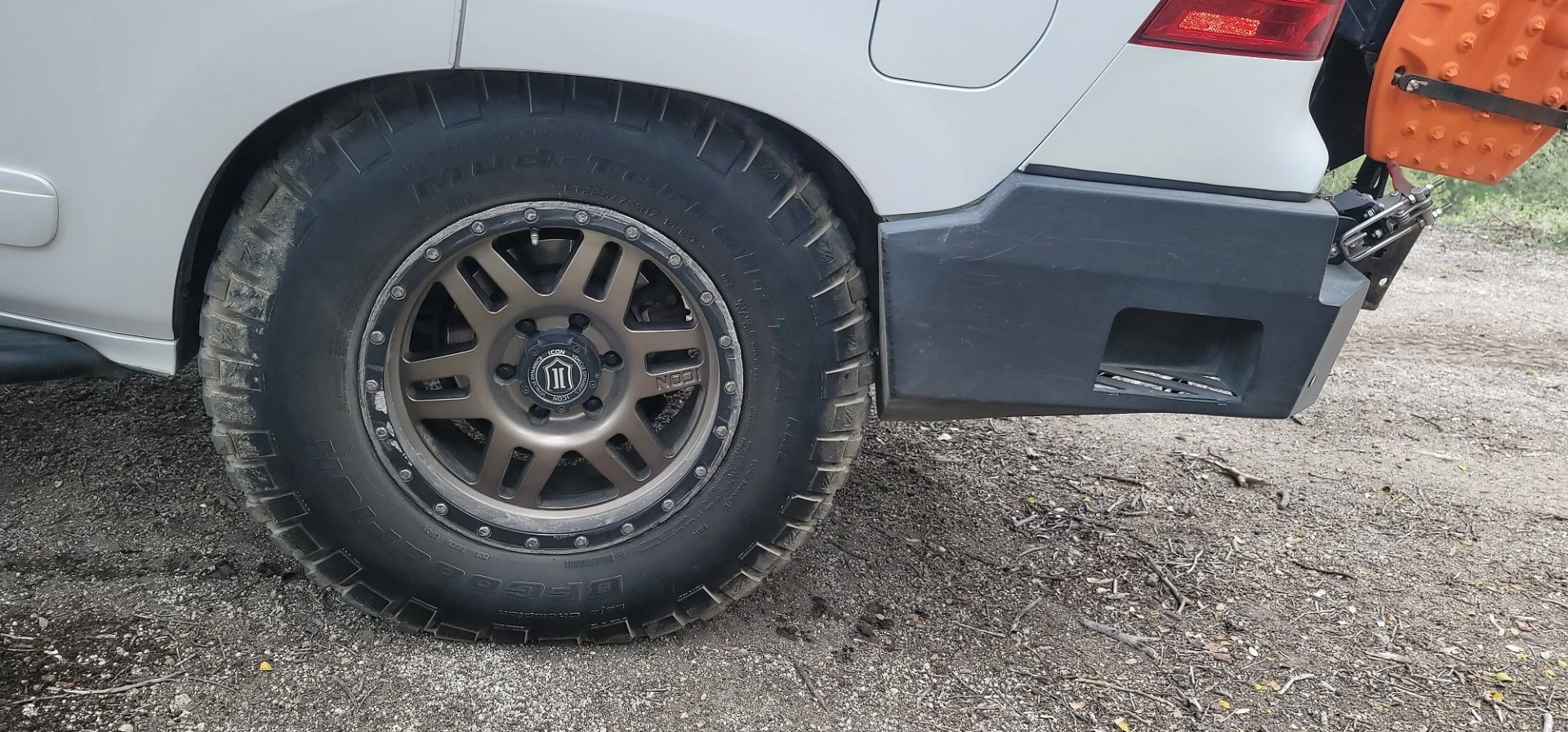

I thought I would throw my update on here. I ended up going with 285/75/17s. My biggest concern was articulation without rubbing, and with cutting/pounding welds I have achieved that. Those of you with the metal tech rear bumper, be careful 35s could be real dicey through articulation.
Whoa thats close! Looks good though.
Yep, that's just about where my old tires sat when compressed. Same tires (285/75R17's) same bumper.

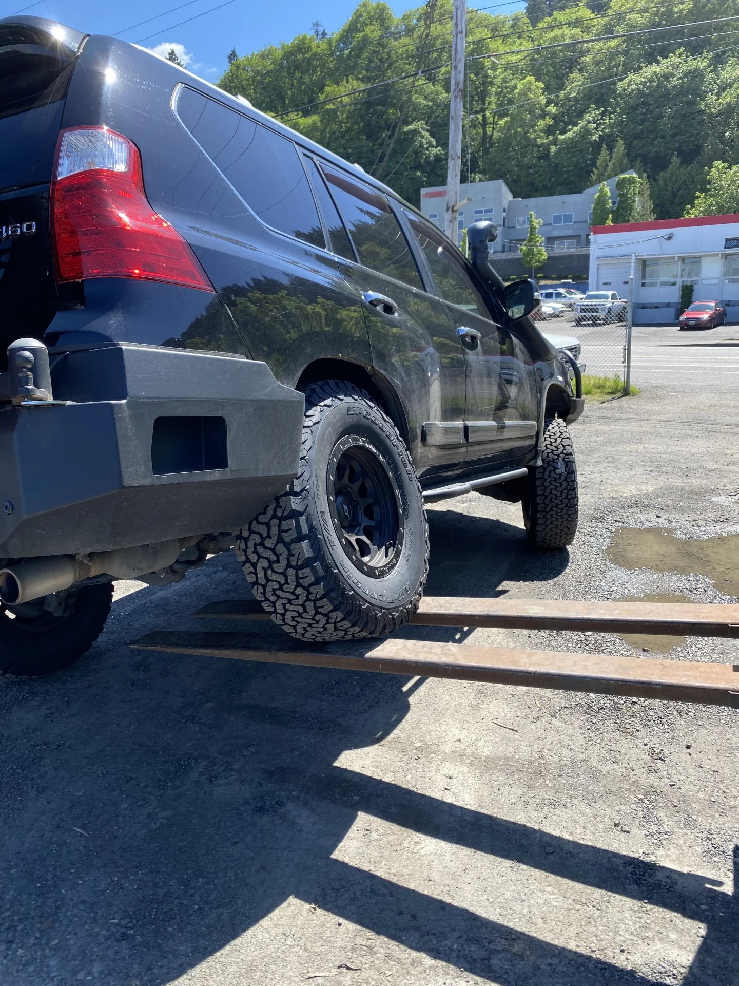

Here is a pic of my 305/70R18’s kinda stuffed.
Rear links are extended, rear bumper is trimmed.
Which links? Are they actually extended or just adjustable? How does the kdss bar play with the extended links, and do you have extended travel shocks in the back?
Last question, do you have extended bumps?
I’m about to put 315s on, and I got the metal tech extended bump brackets, but have stock links at the moment with extended travel shocks.

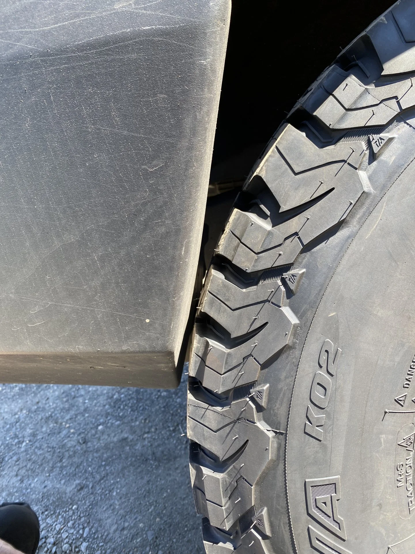

I'm running the Icon rear links (tubular upper/billet lower) and panhard bar. I pushed the rear axle back .5" to clear the rear door and trimmed the bumper. Now I hit the the pinch weld for the quarter panel.
I have the Fox extended shocks, extended durobump bump stops, Eimkeith PCK, KDSS spacers. Everything seems to work together nicely.
