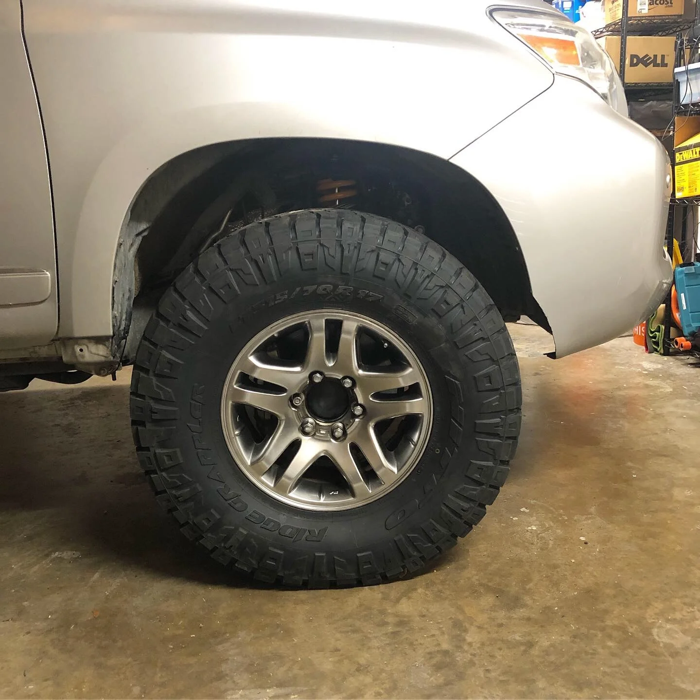

Ran 35's (315's) ridge grapplers on my previous GX460 the entire time I owned it without issue. I'm used to fitting large wheels/tires onto my vehicles so I guess the process of cutting/trimming doesn't phase me any longer.
I never felt a regear was necessary whatsoever. Would it be nice? Sure. But not "needed". I was still making 15-16mpg mixed driving like an ass per usual. The truck just takes a bit too long to downshift for me on the highway so I usually drove in sport mode and shifted manually.
Arguably, after putting the Icon and Dobinsons on, I wager I had enough room to run the next size up with a bit more cutting.
17x7.5 Sequoia wheels w/ 1.25" spacers
- Ironman FCP set up, then Icon, then Dobinsons MRA + SPC UCAs - All with the 35"s
- BMC
- Slight trim on the lower trailing edge of the front bumper
- Moving or just completely removing the fender liners - I just pushed mine out of the way and zip tied them
Hope that helps!
